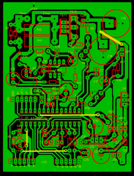

  • another refined pcb with track holes for high power mosfet.

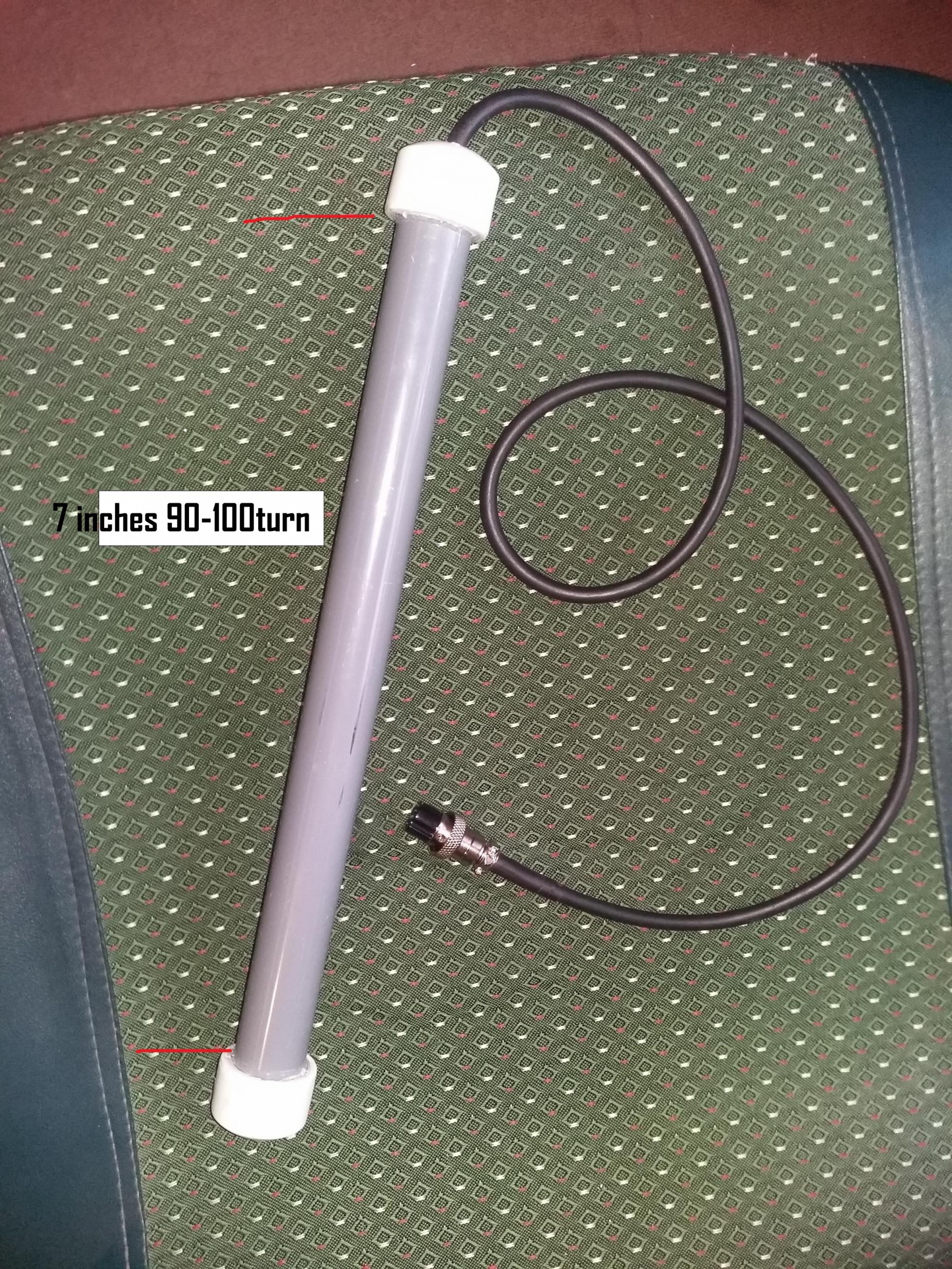

    • felezjoo pi is also a powerful pinpointer. A pinpoiner can be add to your pi just make a switch (to use the pin pointer coil and the ordinary coil)SPDT switch is reccomended). round tube with a diameter of 2 cm is between 90 to 100 turns of wire. In this case the small loop will be a maximum of about 20 cm range for highly accurate grinding point can be used. Compare to other pinpointer i've seen it has the deepest detection.

      • Nice bro JLad..nindut pang IRF460.

          mao gyud bro.. mas nindot sya kun supermesh power mosfet. maayo pud and irf460 ky ubos kaau and RDs..

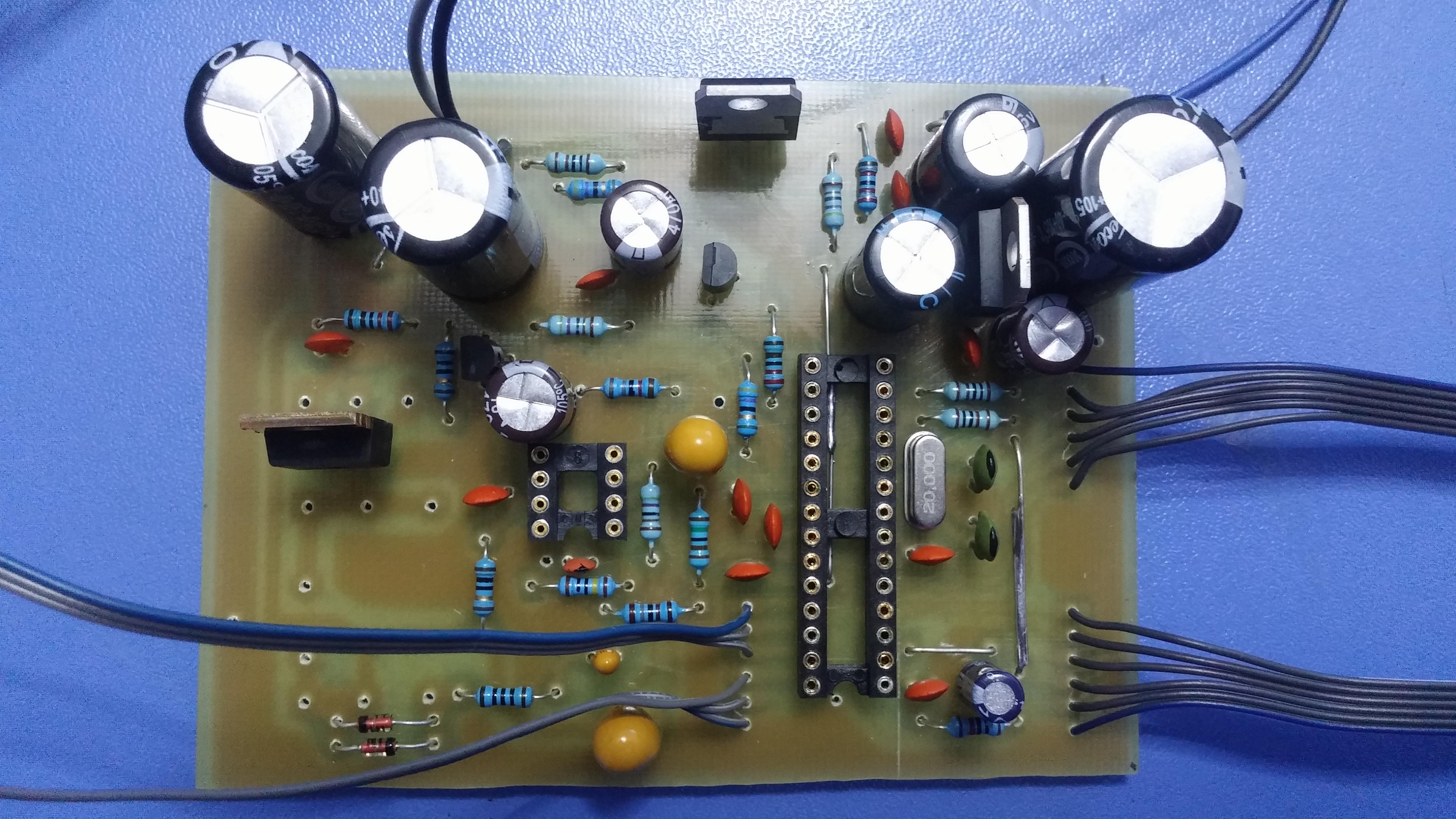

                      • hi
                        complete circuit
                        I could not write ATmega328 hex

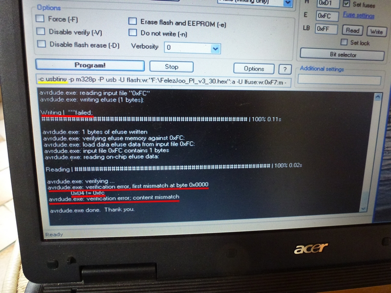

                            • Me too.

                              • Originally posted by chevesne View Post
                                Me too.
                                [ATTACH]35792[/ATTACH]
                                I'm not sure about Avrdude but it may help
                                I had a problem using extreme burner to begin with, replace the files in \program files\extreme burner AVR\data with the ones in the attachment
                                It was something to do with defining the correct oscillator and speed
                                felezjoofuses.zip
