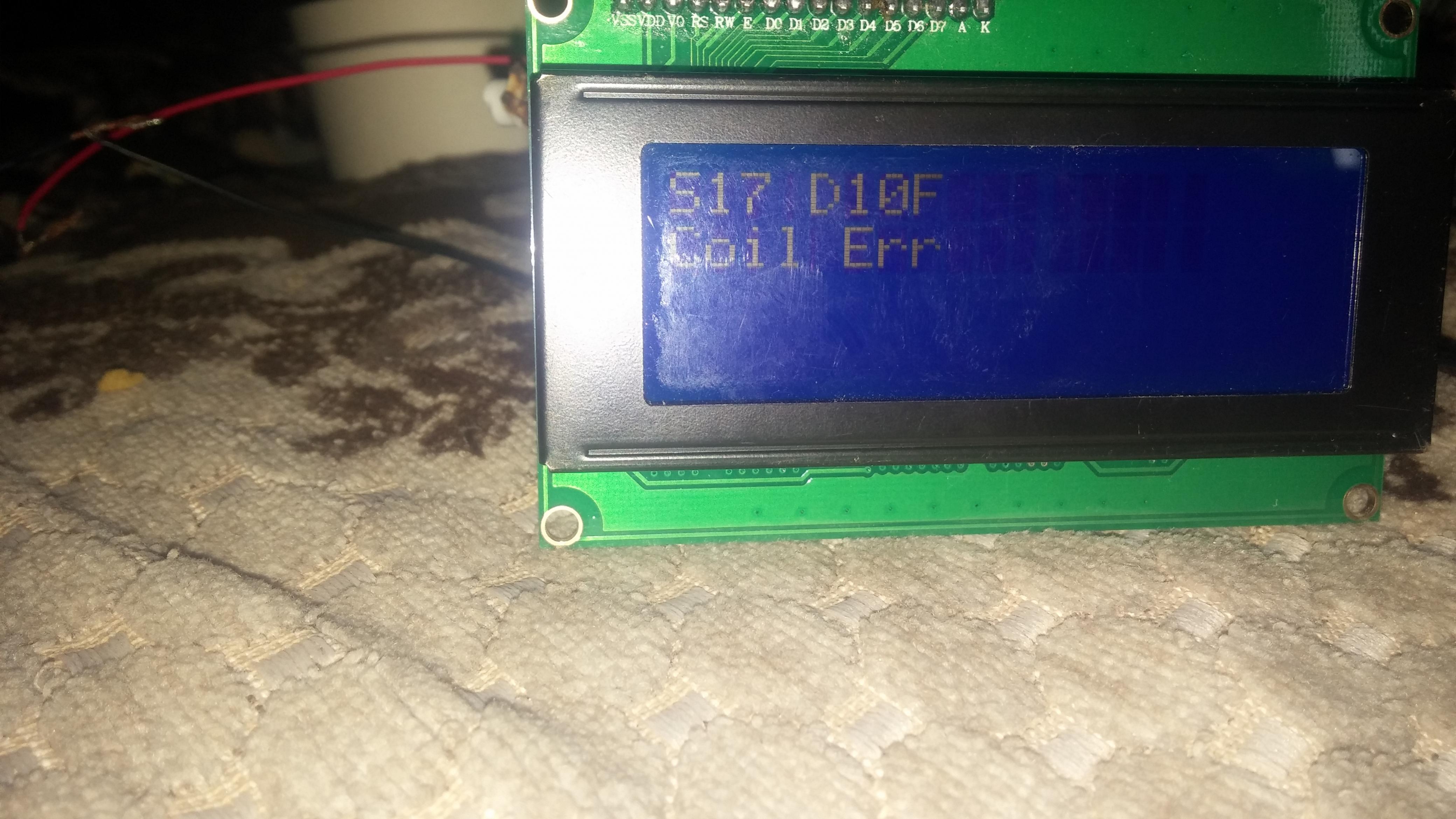

    if you will use IRF740 will not get coil error or open device first and connect coil.
    • Ihave one i will try it
      • Originally posted by basellafe View Post
        what cuse error coil. all the time with many tries lhave error coil
        The problem is from lf356 ... You have to try some lfs i have the same problem ... Or order an original lf357

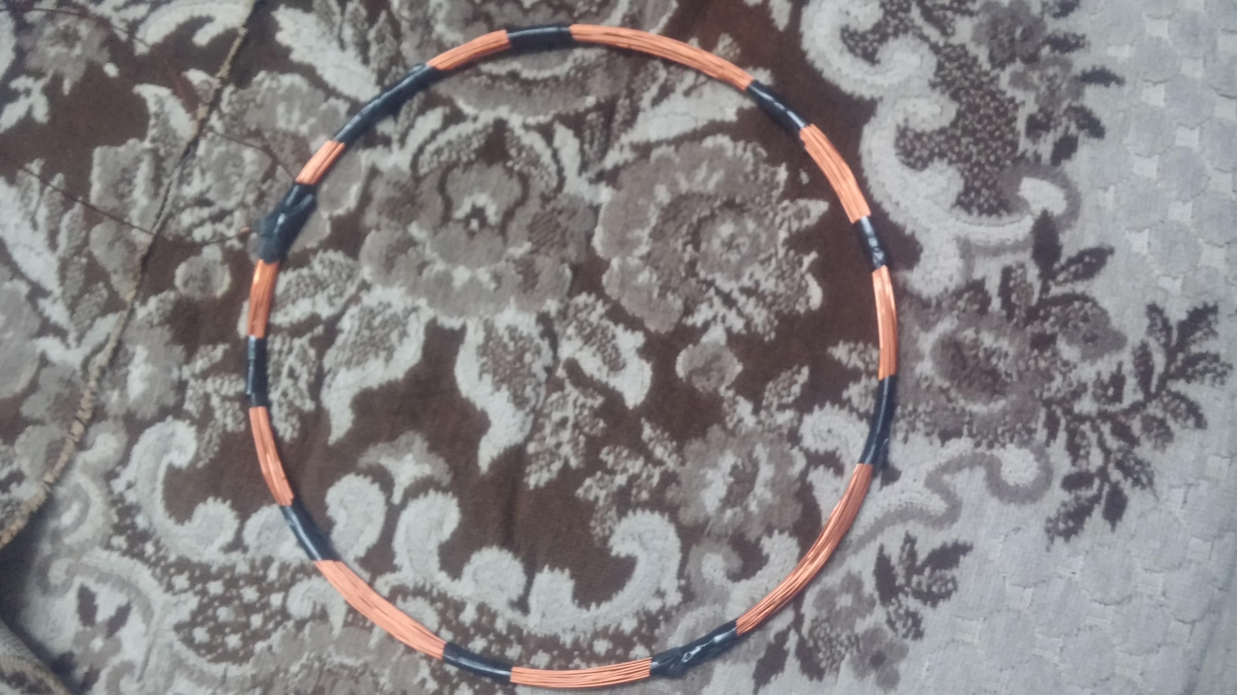

          • I cant find in my country lf357 put i have ua741 and the same result
                Even me cant find them here in my country and dont have a way to order them but here you can order original one: http://www.ebay.de/itm/2-Stuck-2-pie...YAAOxyOalTZn15. The opamp bandwidth must be 20 mhz (higher bandwidth) to get the device to detect the coil check chip pdf information for bandwidth to understand.
                • thanks freso for advice there is another point iwant to acces wich one of this have 20 mh and work perfectly with felezjoo http://www.ebay.fr/sch/i.html?_from=...f357N&_sacat=0
                  • Mybe other mumbers can show us wich one have the 20 mh i hope they make a list of all the chips that work with a url so others can try 2..... And i saw mybe jladre or another mumber said he salvage original LF357 from an old vacuum from the 80's as i remember mybe he can give the company name and pictures or the machines where we can salvage original LF357... That will be a good help

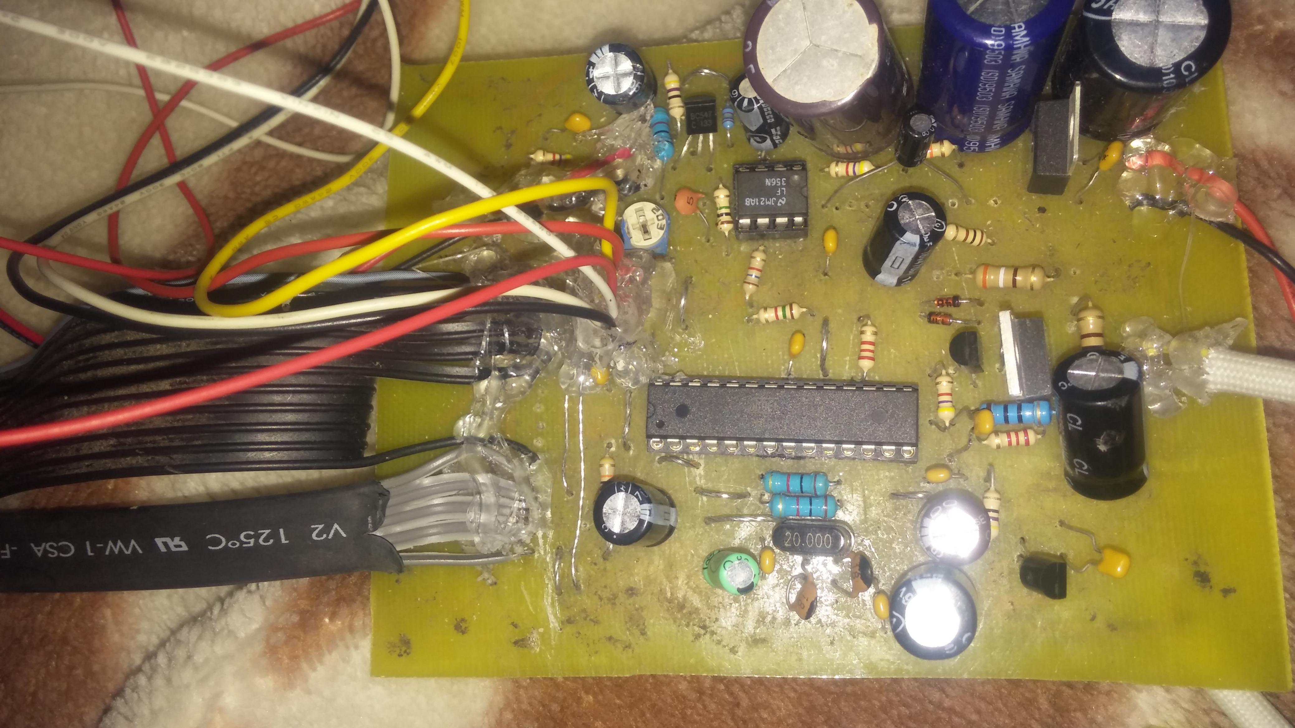

                      • did some one face this problem ihave programmed atmega with arduino r3 buad rate 19200
                        • Hello basellafe
                          maybe your 2.2 mf capacitor need reversed near 357. Negatif side needs connect to 357. positive side to 100r is correct.Connection in your picture is like wrong.
                          • U r right samii but that was in ivica board and irebiuld it in iranian baord the lcd in the first work perfectly but now ldont know what ido wrong i played with some resister and reprogrammed and thats it the coil woudnt work but early it work i resold some capaceters
                            • abaut pin number 23 with coil how much voltage it should be for aperfect signal
