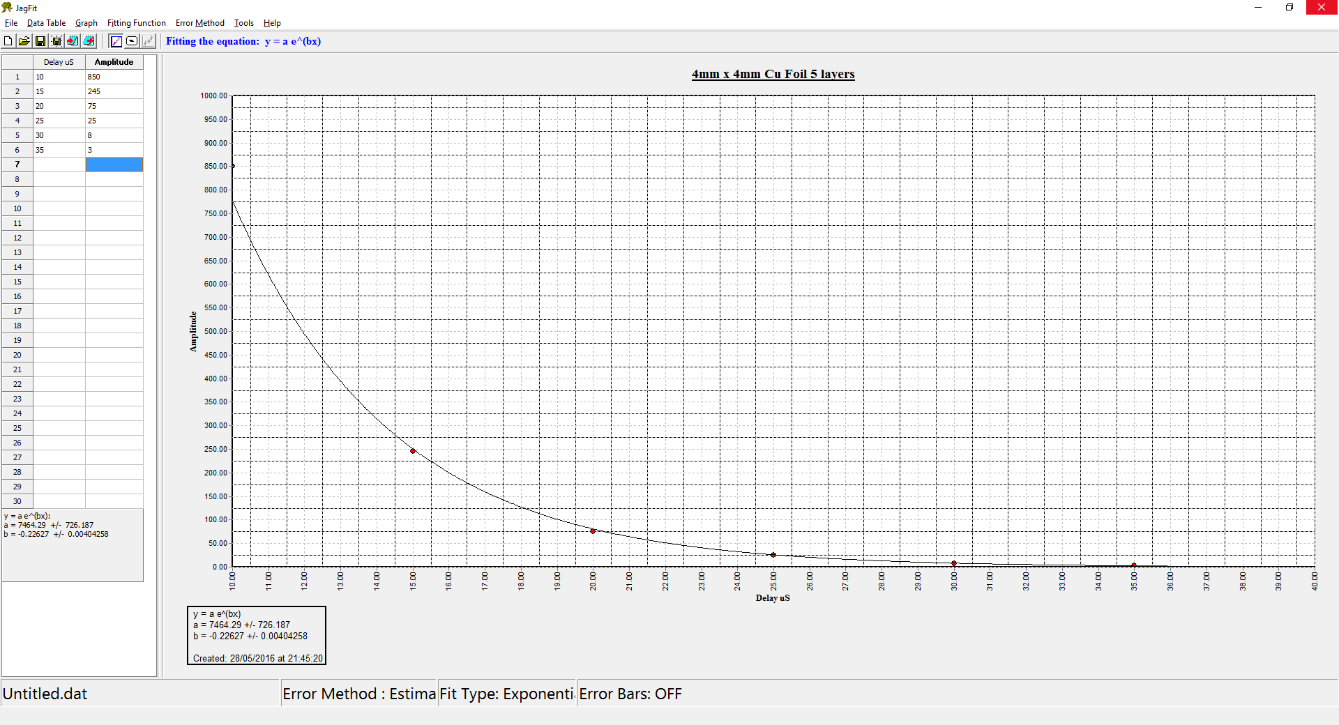

              Personally, I am quite happy with this level of small object sensitivity (4 x 4mm x 0.25mm). Even for gold nugget hunting, as chasing smaller pieces is not of great interest. I believe the Vallon would really shine on a Civil War battle site as bullets and miniballs are readily detectable at good ranges. I will post some figures in due course.

                [Yes, I have started to do similar tests myself and it will be interesting to compare results. I am using my Magnetic Viscosity Meter to plot decay from 10uS - 50uS in 5uS steps. I will do a log signal vs time as you do. I have some reservation about aluminium from cans. It is very springy and obviously an alloy. Aluminium varies tremendously in conductivity depending on what the other alloy components are, but maybe all Coke cans are the same. I cut up a can from another drink assuming it would be the same and I can detect a 10mm square with the Vallon. I will report back in more detail later.] reply#174
                Wondering why you charted linear scales. Do you see something on the linear chart that makes it better?
                  I was intending on doing a log amplitude scale but my computer kept coming up with an error signal. For magnetic soil samples I always use a log/log scale which then gives a straight line with a slope of -1.
                  Having said that, a linear scale gives a good visual idea of the scale of the difference in signal amplitude that the preamp sees at later delays. I will try and fix the computer error so that we are comparing like for like.
                  I did advocate the use of wide band log preamps some years back but other than a few experiments, didn't do anything further about it. By differentiating the linear slope you get a constant amplitude that gets noisier with time for non-ferrous. Iron still looks like an exponential.

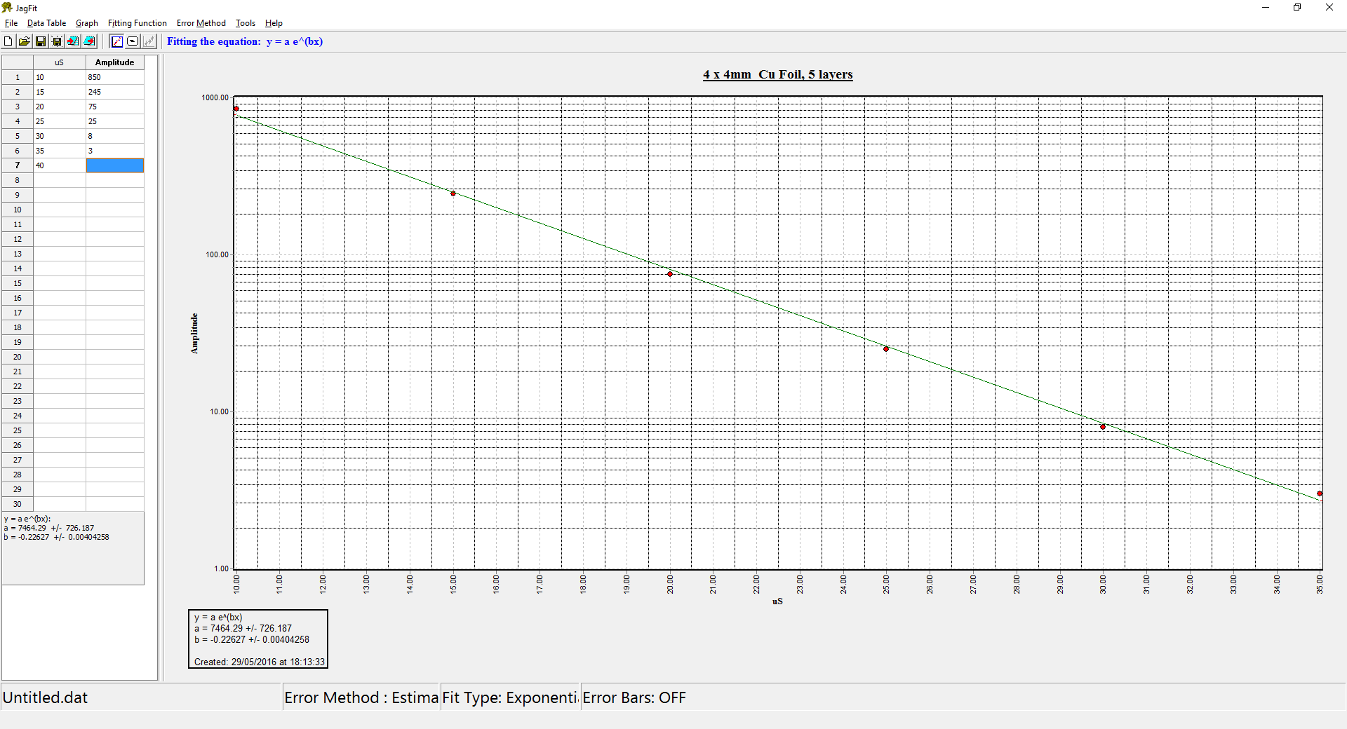

                  • Sorted the problem. Here is the log/linear plot. Click image for larger version
                      Sorted the problem. Here is the log/linear plot. [ATTACH]36329[/ATTACH]

                      • The lin. vs log. scale is tricky to use. You can't interpolate accurately on the log scale, so don't try. The linear scale can easily be interpolated, if need be. The best way is to choose two points on the straight line that cross through convenient points on the chart. Choose them a decent distance apart for accuracy.
                        Example, from Erics chart: V=90 at t=19.5 us, and V=8 at t=30.5 us.
                        Your basic decay equation is:
                        V/Vo = e^(-t / RC) for the more familiar R & C charge/discharge circuit. RC = time-constant, (which also = L/R for inductive decay).
                        So in this case: V/Vo = 8/90, and t = (30.5 - 19.5) = 11 us.
                        Take natural ( Naperian) logs of each side:
                        ln(8/90) = -11 us / (time-constant)
                        or, re-arranging:
                        time-constant = (-11 x 10^-6) / ln (8/90)
                        which I calculate as 4.54 microsecs for this test object.

                          The fine lines aren't even increments. Try counting 10, 20, 30, 40, 50, 60, 70, 80, 90, 100. Thanks for the formula.
                          • I don't really understand your statement...
                            But there is something peculiar with the scaling, it looks like there's 12 steps per decade, but there's not... is that what you mean.?
                            Maybe Eric had better chime in here, in case there's something he's done wrong.
                            The pale grey lines for 10, 100, 1000 are there to indicate where those voltages are on the vertical axis, but the actual scaling of the true decade graduations are unfathomable, it looks like the decade starts at about 9, then there's 10 steps to get to 90, etc.
                            That's what happens when you let a computer do the work. If I'd plotted this, I wouldv'e done it on paper, with a ruler.
                            So...ignore my earlier readings from the chart, they are incorrect.
                            Based on the 'computer best fit' data that says "b = -0.22627", we can calculate -1/b as 4.42 , this is the time-constant in microsecs, as Eric has obviously entered the time figures as 10, 20 etc rather than 10 x 10^-6, 20 x 10^-6, etc.
                            So the targets time-constant is 4.42 microsecs.
