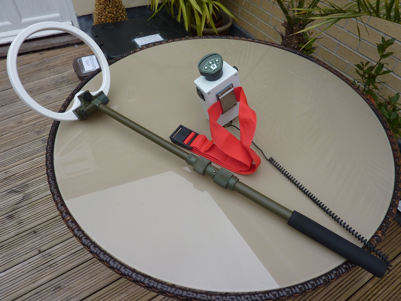

              I repackaged the Vallon to make a belt mounted beach and shallow water detector. The electronics just fits the Hammond heavy duty case, together with 3 C size rechargeable cells that will give about 10 hours per charge. The coil is wired in through a strain relief gland at present but I hope some IP69 plugs and sockets will arrive tomorrow for phones and coil.
              I'm looking forward to going to the local beach in the next couple of days to see what was left behind from the holiday period last weekend.
              Eric.
