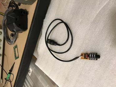

            • made up a little board with Eric's audio transformer mod. See pic
              I was about to machine a cover to to fit on both under sides of the Vallon body to give more options to route cable but it may not be required.
              Eric, does removing the single grub screw on the end near battery cap release that part?
              I'm thinking of putting the cable through as you have one but retain coil cable in shaft

              • Originally posted by Mdtoday View Post
                [ATTACH]39786[/ATTACH]
                Brian
                You need to do steps 1 - 5 on post 649 to remove the rear support. How are you planning to deal with the coil cable which at present runs through the black tube?
                Eric.

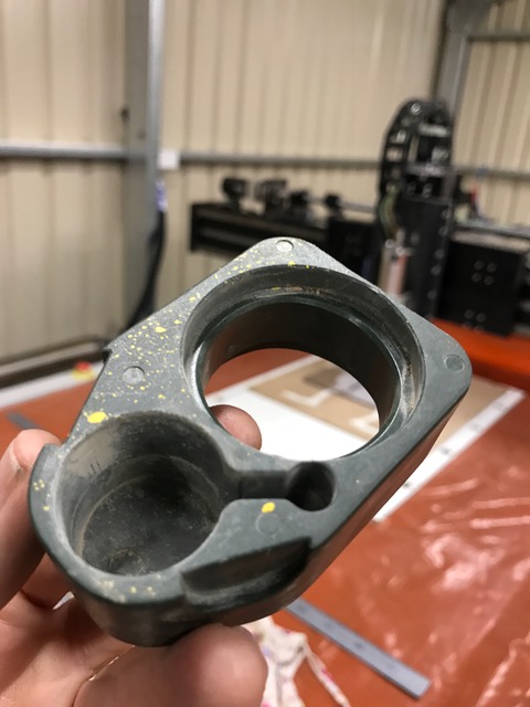

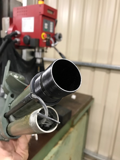

                  • Hi Eric,
                    Having removed the threaded collar and end guide assembly, I now understand what you have been talking about.
                    What I have noticed is that most of the design is symmetrical which means the arm rest has identical holes on the opposite side to the holes where the black coil cable rod passes through.
                    The end guide (attached pics for those interested) is only machined on one side to take the black cable rod, however, there is plenty of room to machine an exact copy on the other side.
Name:	Vallon bat end_1.JPG
ID:	348554Click image for larger version
Name:	Vallon Bat end guide_1.JPG
                    The idea then, is to get rid of the existing audio /data connector and run the audio cable from inside the electronics housing up through another rod and into the modified end guide.
                    I think the best thing to do is machine complete new end guide that matches the exiting for fitment but will be wide enough and deep enough to accommodate a 6mm jack socket and wireless module + support power.
                    I have some delrin laying around that will fit the bill nicely.
                    Will post up some CAD drawings once I figure it out.
                    Now to see if I can open the main housing without damage
                    Brian
                      Hi Eric,
                      [ATTACH]39788[/ATTACH][ATTACH]39789[/ATTACH]
                      Brian

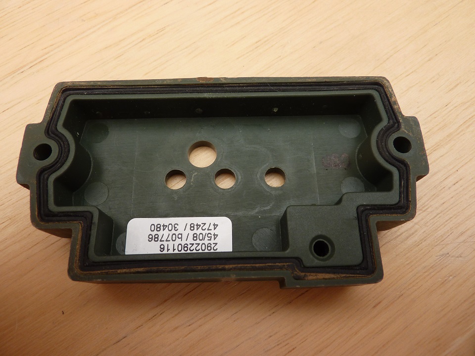

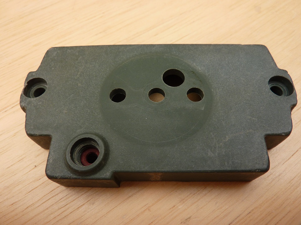

                      Be careful, as the end cap of the main box is not symmetrical. The coil cable goes in via the hole on the left in the front view. You can see a fibre washer and under that is an O ring. The black aluminium tube screws down on this to make a watertight seal. You will see spanner flats at the other end of the tube. Notice that the bottom edge of the cap steps down a bit; so now look at the inside view. The molding is full thickness where the cable comes through, to accommodate the seal and the threaded section to screw in the tube.
                      You cannot have a similar tube screw into the other side (left) as there is not enough thickness and the hole cannot be on the same level which is right on the inner lip of the end cap.
                      Eric.

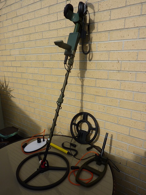

                      • The Full Kit
                        Well almost the full kit, as I have a few other ideas to investigate.
                        All I need now is an unthrashed area with lots of buried treasure. Nuggets, rings, coins or Spanish gold will do.
                        Eric.

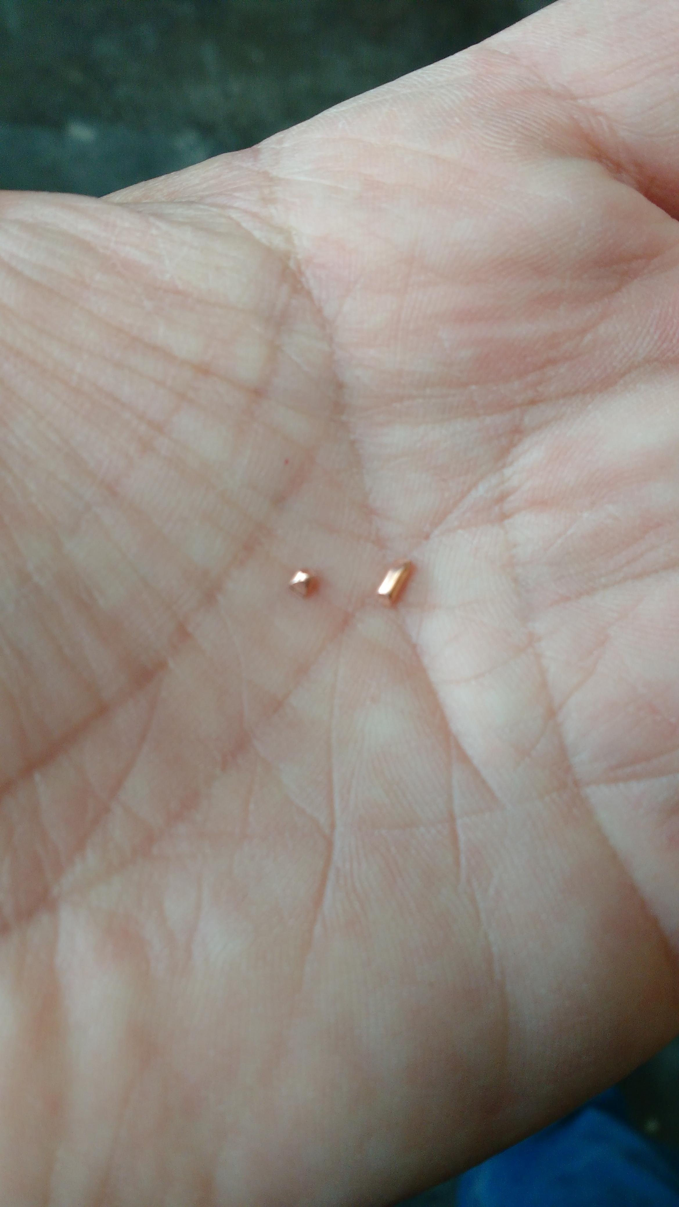

ID:	348561Last weekend i did a test with vallon, that show it can detect this two tiny copper wires, the smallest one at 1 1/2 inch, the second one at 3 1/2 inches. Very good.
                            Eric.
                            Ok, yes I see the problem, I thought there would be a bit more thickness but had not taken the end off to investigate, thanks for pointing it out Eric.
                            I will think about it and come up with a solution.
                            Does the battery tube assembly come off from the outside by first removing that screw on the outer tubing at the body end or do you remove the end panel first?
                            Brian
