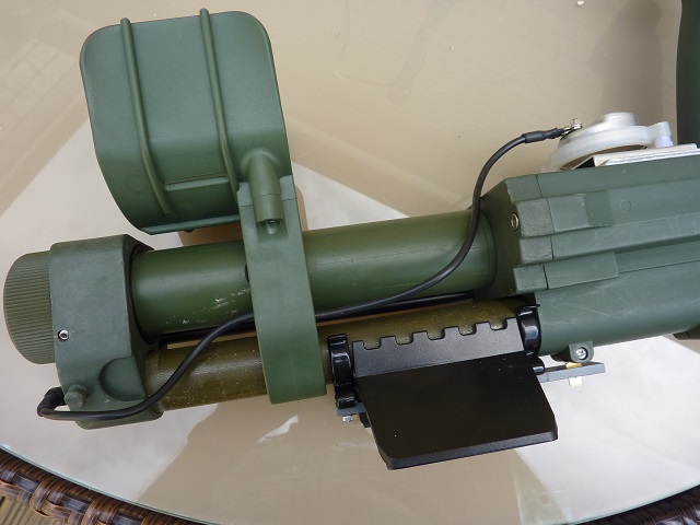

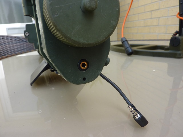

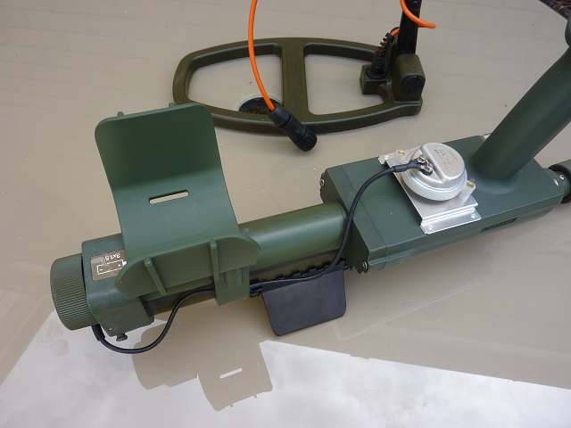

                  I have being doing a bit of further refinement on the Vallon but have not had time to go out and do any real hunting. I have tidied up the audio jack that I re-routed to the rear end and added a 'speaker' that is louder than the internal one. This can be plugged in instead of phones. There was just enough room for the step down transformer inside the main box. The speaker is an old moving armature telephone insert of 150 ohms impedance and mounted the way shown gives better air loading on the diaphragm. It could be mounted on pillars straight off the Vallon case, but I did not want to drill into that as the speaker feature is still experimental.

                    • Nice work Eric!
                      I just noticed in the photo, the arm rest top section screws on, the one I have is a single piece.
                      Brian
