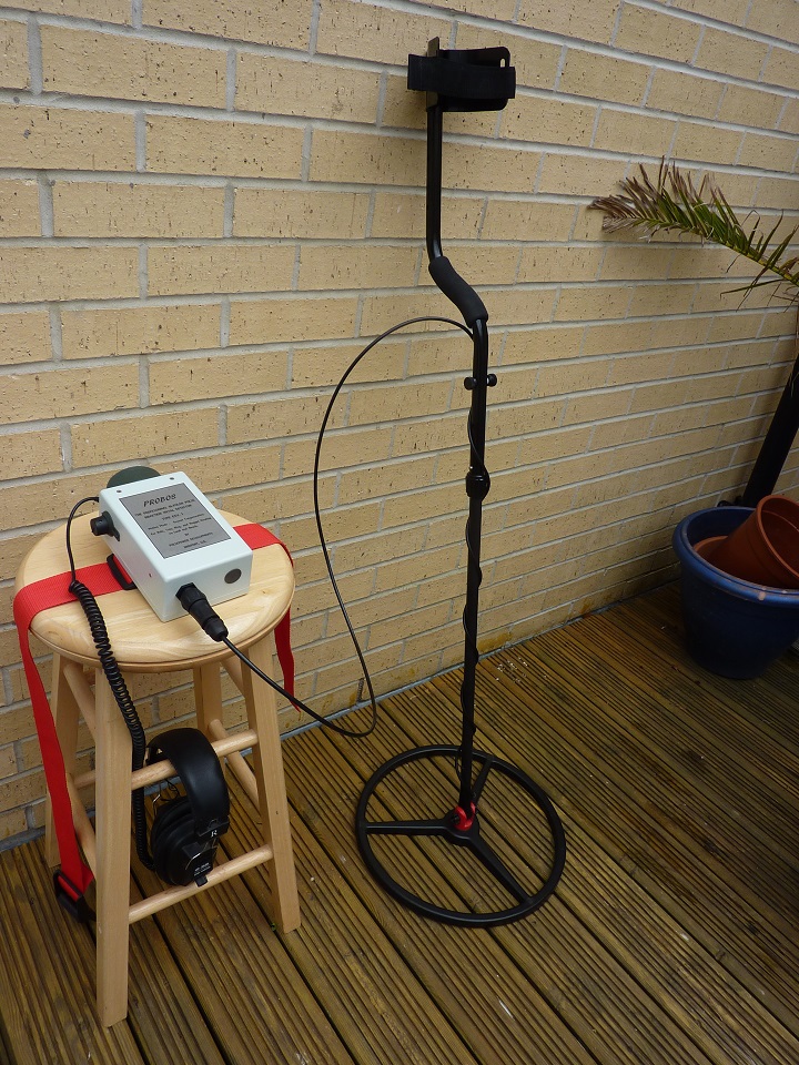

            Hi Joe,
            That is exactly what I did. With the teflon 7/0.2 wire I overlaid with spiral wrap and on top of that a woven copper screen. With 39 turns I got an inductance of 1.556uH, a resistance of 3.7 ohms and a resonant freq. of 180kHz. The stock Vallon coils average out over 10 units at 1.504 mH, 4 ohms with cable and 160kHz res.freq. With 2m of cable instead of 1.5m on my 15in coil brought the res.freq down to 171kHz. This works great and I don't anticipate any further problems. I will pot the coil over the weekend for field tests next week. I'm not looking forward to the digging I might be doing though.
            Picture shows the configuration so far. Whites shaft with long fibreglass coil shaft. Belt mounted electronics with inbuilt step down transformer and filter for standard stereo phones. these are switched to stereo so that phones are series connected to give 60 ohms. Either volume control on phones adjusts both.
            Eric.

              that looks very impressive indeed.
              • Wow Top work Eric!
                That looks brilliant!....Good luck on the beach!
