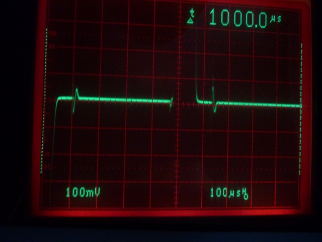

I wired up a front end amplifier, the same as I have used many times in the past, to give some front end gain. The standard input configuration is via a resistor and a couple of diodes back to back to clip TX pulse and flyback transients. What we see is a standard PI response waveform. Amplifier saturation to plus and minus rails, both 5V; amplifier recovery to flat baseline. Scope trace starts at TX switchoff.

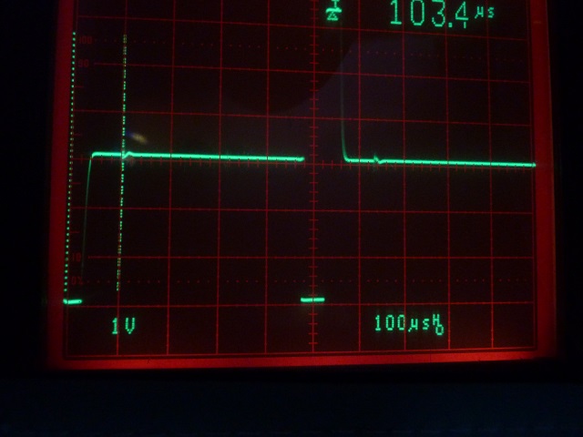

A metal can is then placed on the coil and standard decay observed for both pulse polarities.

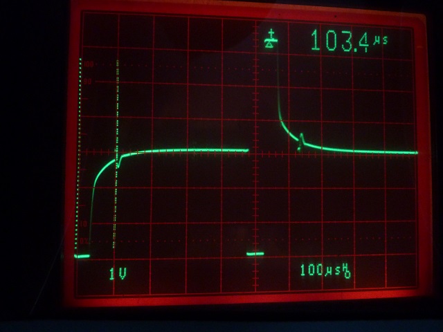

The scope sensitivity is increased and the above repeated.

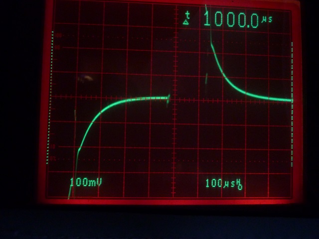

As above with metal can.
What is puzzling is the glitch at 103uS on both polarities. Is this a gating glitch or just an unimportant artifact appearing across the coil? The amplifier recovery with this high inductance coil also seems much too late to detect, say, a 0.3gm nugget; which the Vallon unit does quite easily. O.K., is this a DSP trick where you can sample into the flyback recovery period? Then there is the ground cancelling, how can that be done? Over to the experts in the digital domain, as I am not one.
Nothing changes in the above pictures if I switch to the ground cancelling position. What we need of course is a schematic, but I doubt very much if that is possible.
Eric, what are you using for the FE (I keep exploring for the better mousetrap). As for the DSP trick for sampling into the flyback, I have no idea. I can see how they could cancel out the flyback, but I can't conceive how they can sample into the high voltage and still discern minute changes. For mineralization/ground cancelation you can take your filtered input, feed it into a let's say 0.05 HZ decimating filter and subtract that output from your filtered input. This ground/mineralization filter needs to stop updating if there is no motion, again easy to do digitally, with todays accelerometers IC's.Originally posted by Ferric Toes View PostO.K., is this a DSP trick where you can sample into the flyback recovery period? Then there is the ground cancelling, how can that be done? Over to the experts in the digital domain, as I am not one.
Perhaps there is some sort of front-end sampling/integration? If so, the "late" capacitor would introduce a glitch when switched on, due to the charge stored from a previous cycle. I have no idea what the schematic may reveal, but I'd do it that way. It is a way to get meaningful samples from deep into the flyback.
Since there is no variation in the periods (iamb, staccato), Paltaglou is off the hook, and the only way to do GB is by early vs. late arithmetic.
No need for EF in a bipolar system. Another bonus.
