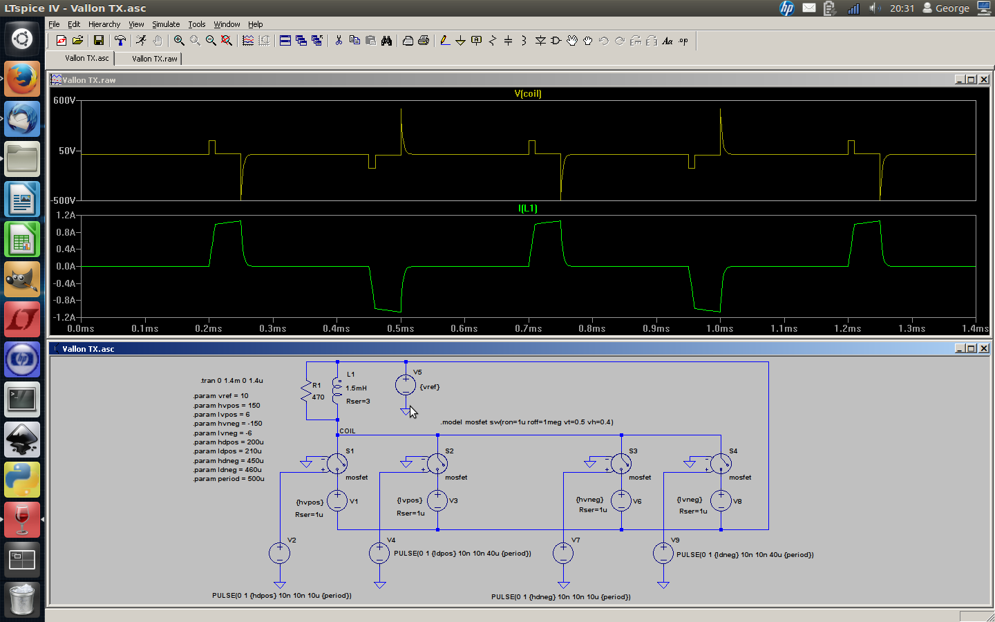

    • Here's a simulation of the Vallon VMH3CS TX using ideal models.
Name:	Vallon VMH3CS.png
      Vallon VMH3CS Simulation.zip
      I took a different approach to KingJL by using a high voltage source (150V) to force the current up to 998mA in 10us, before switching to a low voltage source (6V), which continues to charge the coil for another 40us. Therefore, after 50us the total current reaches 1.07A. The current waveform is a very good match for the scope picture posted by Eric. Also, the TX pulses sit symmetrically on the 10V reference voltage. Using this method you don't need to limit the coil current to 1A, as the selected voltages and timings do that for you. Perhaps that's why the Vallon is so fussy about the coil parameters.
      If you're familiar with SPICE, then it should be pretty obvious how this works.

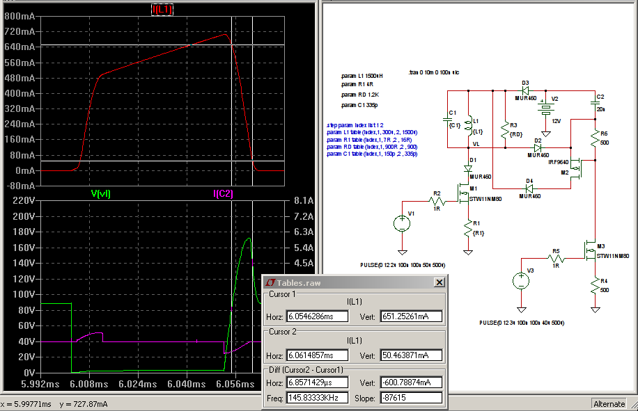

        • This is my monopolar version with energy recycling and real components.

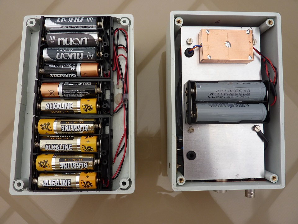

              Using the voltage MT3608 converter board now in a little screened box, I can now dispense with the 10AA batteries in my viscosity meter. The reason I used 10 was to get enough overhead to regulate at 12V for the TX so that the signal from the soil would not lessen as the battery voltage diminished. I could of course use a current regulator instead for the TX stage. This instrument is used both in the field and the laboratory with different sensors. In the lab. a wall plug 15V power supply is used instead of batteries.
              With this converter I can run for about 8 hours on two 2400mAh cells in parallel and it is much more convenient to change just two cells instead of 10. Another advantage is that one version of this converter board has a mini USB connector so that it can powered from a laptop, or other computer, with which the meter is often used.

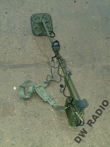

                Is this Vallon?
                • I think no. Look here http://www.vallon.de/products.lasso
                  • Originally posted by mschmahl View Post
                    Thank you !

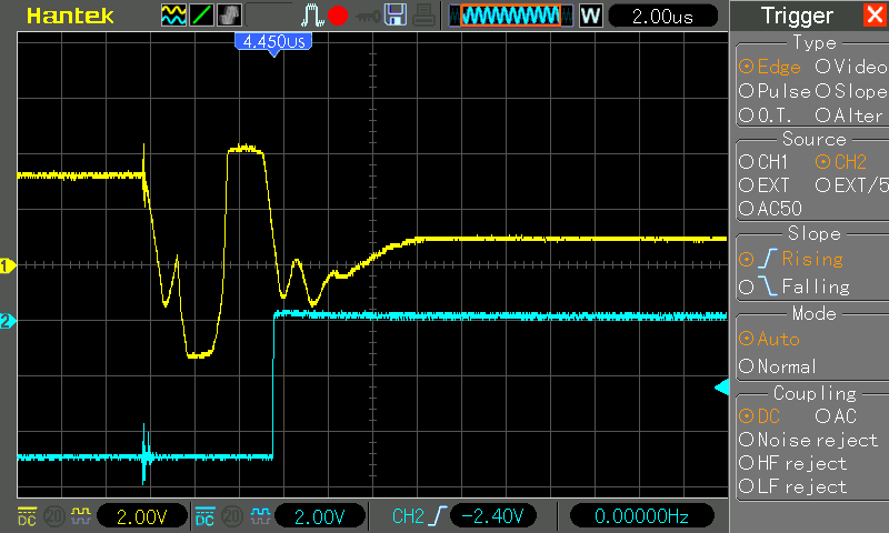

                          I'm sure you've already checked this ..... but I have to ask:
                          Is your coil actually capable of being sampled at 6us, and it's not just sampling while the opamp is still saturated?
                          Any chance of posting a scope picture showing the preamp output versus main sample pulse?
                          Hi George,
                          I finally got the time to run the scope.
                          Blue line: main sample pulse (TP7)
                          Yellow line: preamp output (TP3)
                          I'm sampling at 5.5us just as the preamp is recovering from saturation. Tx coil is slightly underdamped.
                          I've been adjusting R1 and the minumum delay for the best sensitivity to a test gold chain.
                          • Originally posted by Teleno View Post
                            Hi George,
                            It has been noted in the past that using a slightly under-damped response can lead to increased sensitivity to low conductivity targets, and your results seem to indicate that this is true. Have you noticed any undesirable side-effects from this setup?
                                There's a background growl in salty wet sand, but objects still cause a distinct beep.
                                Sensitivity is so increased that it can detect an axial resistor with its leads cut short. I tried a 1cmx1cm piece of aluminium foil and it was detectable at 2 - 3 cm.
