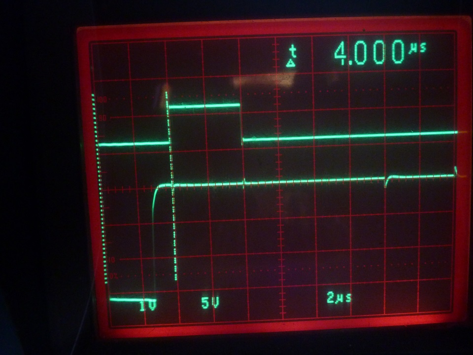

I couldn't resist getting out my ultra-fast PI and taking a picture of the response. The coil is 5.5in diameter, 330uH and wound with Teflon insulated 0.25mm solid wire. Resistance is 5 ohms and the coil is shielded with copper fabric tape spaced from the coil with polythene spiral wrap.
TX pulse width is 12uS, delay 4uS and 1st sample 4uS. pulse rate 25,000. Coil switch on TC 10uS.
Included in the the damping circuit is a cermet preset resistor for fine trimming.
This only works at such a short delay if there there is no cable to add extra capacitance. With 1m of good cable 5uS should still be attainable. Alternatively, the inductance could be dropped to, say, 200uH.

Nice looking trace. With a mono coil mine looks closer to Teleno's. Would you mind listing peak coil current, amplifier gain, amplifier frequency response, damping resistance, coil self resonance and anything else that might help us get closer to a perfect decay?Originally posted by Ferric Toes View PostThis is getting way off topic, but OK, it is relevant in many ways and would no doubt improve the detection of mines with only a tiny amounts of metal.

I can tell you what my case is:Originally posted by green View PostNice looking trace. With a mono coil mine looks closer to Teleno's. Would you mind listing peak coil current, amplifier gain, amplifier frequency response, damping resistance, coil self resonance and anything else that might help us get closer to a perfect decay?
Circuit: MPP rev-D,
DD balanced coil.
Tx pulse: 100us,
Tx Current: 1.1A,
Tx coil: 580uH - 1 Ohm, damping: 700 1Ohm,
Rx coil: 500uH - 5.4 Ohm, damping: 1000 1Ohm,
The MOSFET (IRF740) is avalanching at 400V for a few usecs. Not good. I'll replace it with a 900V MOSFET and see how it improves the decay.

Peak coil current is 0.3AOriginally posted by green View PostNice looking trace. With a mono coil mine looks closer to Teleno's. Would you mind listing peak coil current, amplifier gain, amplifier frequency response, damping resistance, coil self resonance and anything else that might help us get closer to a perfect decay?
Coil self resonance 1Mhz without cable.
Flyback volts 130 with no avalanching and Mosfet is IRFD210 (200V)
Preamp AD8055, not particularly low noise but OK for the application I did this for, which was broken off needle tips in clothing manufacture, but using a 3in coil and an even shorter delay.

Low pulse current is compensated by much higher pulse rate of 25K to give good S/N.
I'm not sure about preamp gain but I think it was 100 or less. Gain made up later on in dc amplifier stages. I will have blow off 17 years dust to examine the board with a lens to see the feedback and input resistors.

Thanks for the info. I've had it where I could sample at 4usec with a 300uH mono coil, amplifier gain 300 by connecting the coil to the -input and using the input resistor for Rd but the decay trace is no where near as clean as yours. Might have to play some more.Originally posted by Ferric Toes View PostPeak coil current is 0.3A

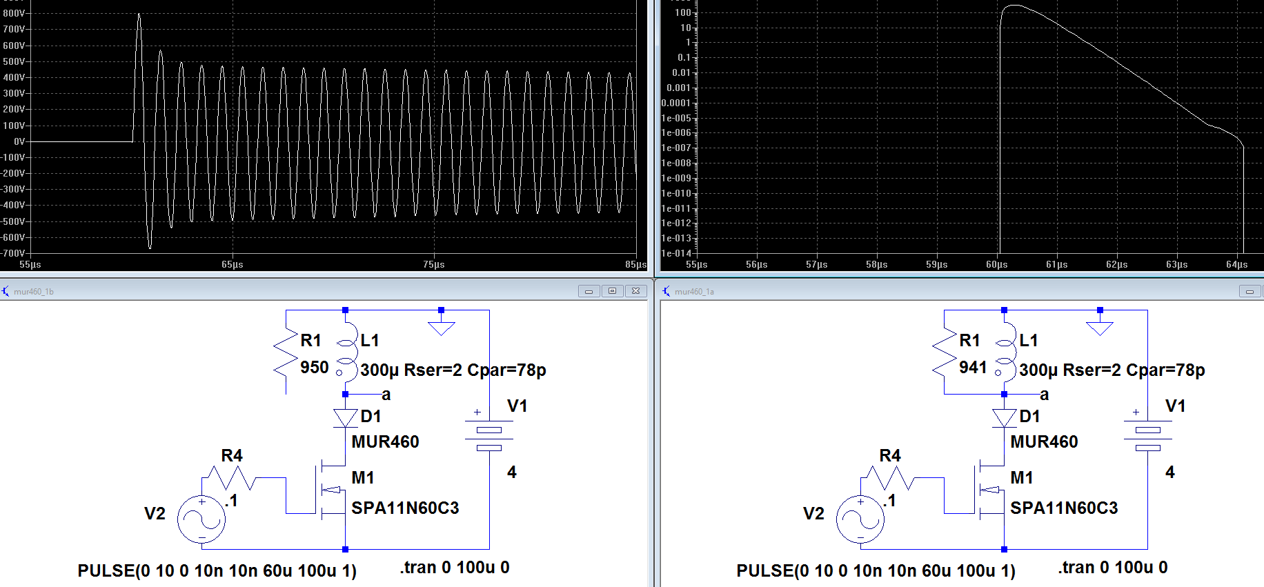

LT spice simulation of a critically damped coil. SRF(circuit resonance) about 1MHz. Takes about 3usec to decay to 100uv. Avalanche time would add to that. Traces test point a
Probably not thinking correctly but I'll try anyway. As the coil decays the voltage across the coil determines the decay rate. (I/T=E/L) The reactive signal is proportional to I/T. How low does the decay voltage need to drop for the reactive signal to not cause a problem with a PI detector?Attached Files

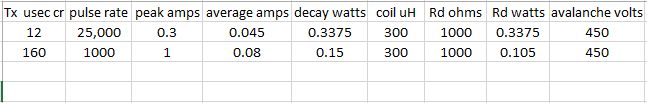

Made a chart to compare the differences with 1k and 25k pulse rate. Wasn't expecting average current to be lower at 25k. Signal is proportional to peak current. Do you have a formula for reduction in noise for pulse rate increase? 10k/1k, 25k/1kAttached Files
