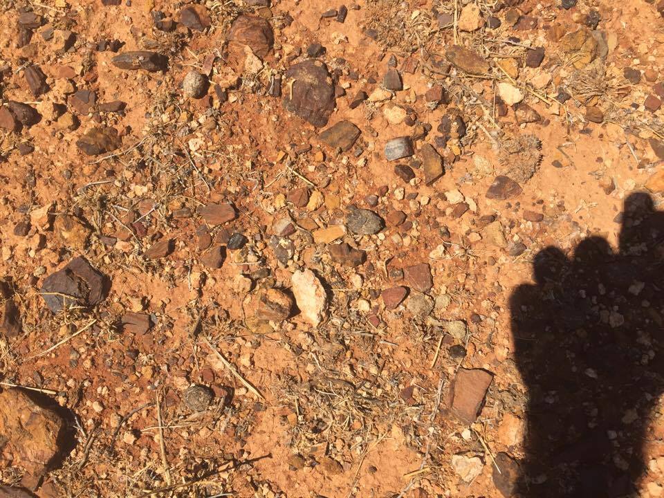

  • Day 2 report Went to a spot with a lot of ?laterite mixed in with quartz (see pic).
    Vallon ground balances okay, but I still get occasional rocks that give a signal. I am learning what this sounds like however and it is a vastly different signal to the screech the Vallon makes when it hits on something metal. I tried ground balancing directly over one of the bigger lumps of rock...managed to tune that rock out, but every other rock that I swung the Vallon over then went off !!! GB back to the ground and things went well. Had a great screech and dug up another tiny slither of tin from about 6 inches. The Vallon tells you fairly clearly if its metal!! Dug a piece of smashed up bullet lead which gave a loud clear signal from about 10 inches. Things are looking good....Just need to actually wave the coil over a nugget to see if it will actually find it Click image for larger version

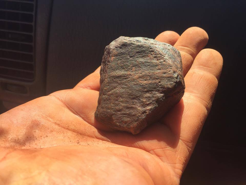

    If any one is a geologist, I have attached a pic of the black rocks...??basalt ??laterite??

      Look here -> http://www.comparerocks.com/en/diffe...rison-34-7-997
        Very good thanks....Probably some type of basalt.

            I would lean to it being Laterite. It looks the same as the rocks you get in the Victorian goldfields on which I have quite a number here. The rock was laid down in sedimentary conditions from the water erosion of previous rock that had a high percentage of magnetite. This mineral oxidised to maghemite which is what gives the troublesome signal on a metal detector. Gold nuggets associated with the rock often show signs of water erosion such as rounding of the edges. Gold originates within the quartz mineral that infilled cracks and fissures within the Laterite.
            Gold in Western Australia has more silver alloyed with it than gold from Victoria, hence a slightly brassy appearance. That means that it is less conductive and you need a bigger nugget for the same signal than for Victorian gold. It sounds counter intuitive but it is a fact. Same for gold rings. 18ct or 9ct rings are less detectable than 22ct rings of equal size and thickness.

              Thanks Eric. I have tried both the auto and the manual (fine) GB using the up/down method in the Vallon manual. I think its a case of "practice makes perfect" (if there is such a thing!).
              I did increase the sensitivity to 13 and this was okay. It didnt actually change the threshold though. I agree that not much signal is needed to get an audio response. It picks up very tiny thin pieces of tin and lead very well even when in an area with lots of hot rocks!! I have noticed that it gives a signal to the odd rock, but those signals are vastly different to the loud clear screech it gives when it actually hits a target. I think more playing will help my ears adjust. Overall, I think the Vallon has a lot of potential.
              Thanks for the comment about the rock too. Yes, it could be laterite. There are some here that are twice the size of a house brick and shiny black in colour....Easy to identify them as the signal and kick them away as they are making a short, almost humming noise, rather than a loud strong screech. Its a bit hard to describe...its like a flat tone rather than a loud clear tone.
              I did walk along the lower aspect of a hill that was basically these rocks with very little ground to be seen. The Vallon worked with less noise if I kept it 2 inches above the rocks rather than an inch. I found the tin piece there so it seems the Vallon is still able to get some decent penetration. I tried slower sweeps and I think this gave less noise than slightly faster ones (would that be normal??)
              Total detection time is 4 hours, so after 400 hours I may understand the Vallon a bit more

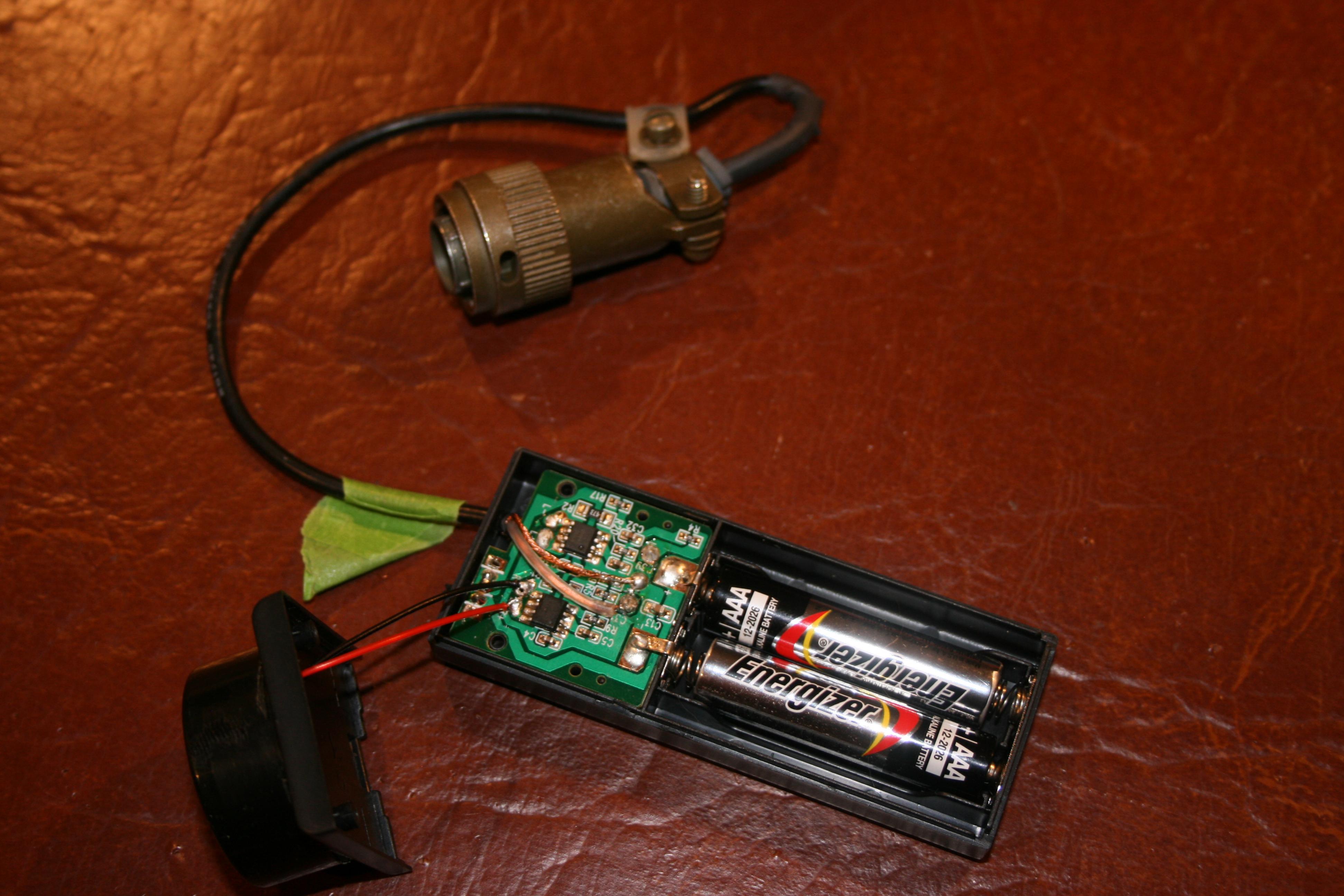

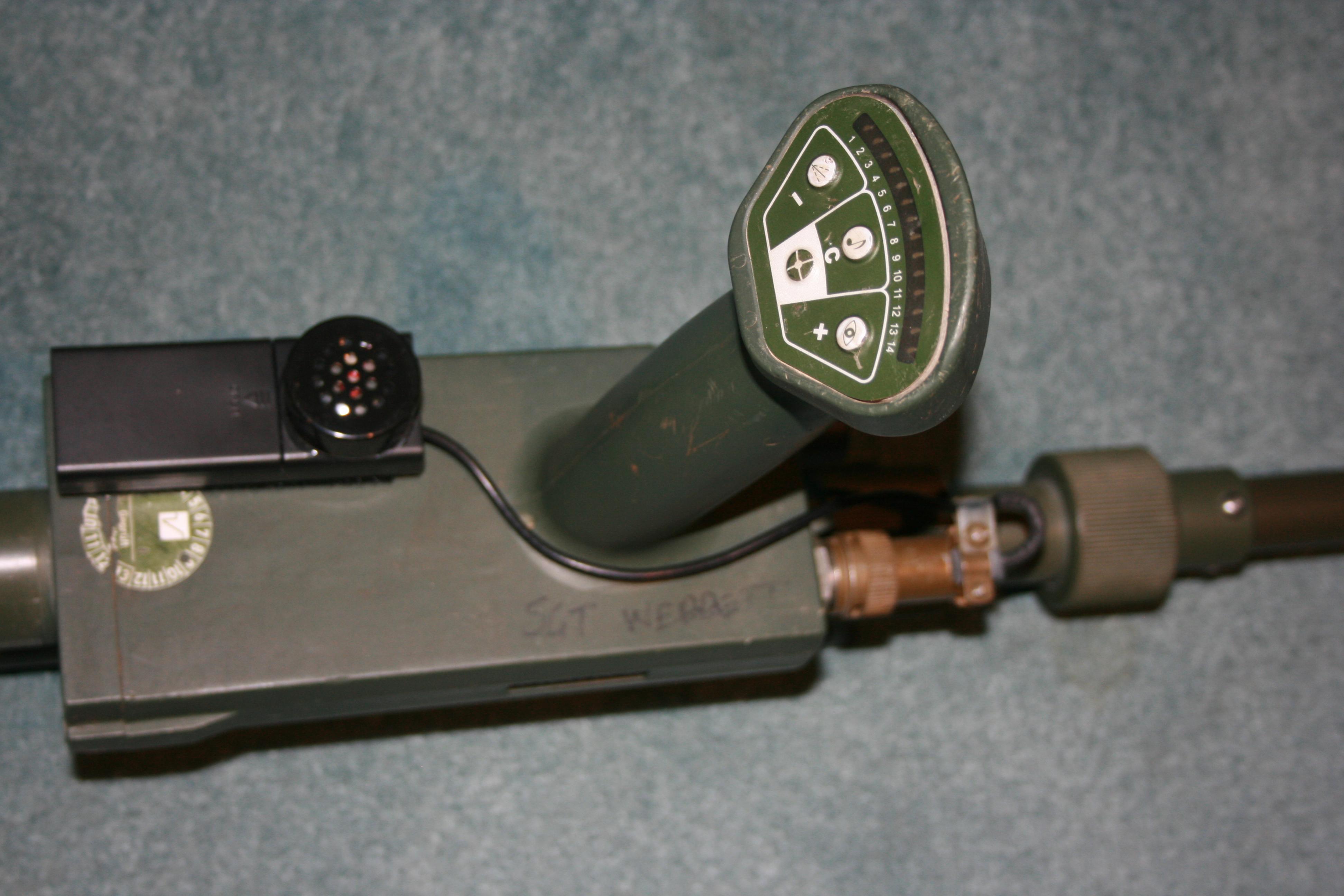

                          Did a piezo headphone come with it? I was out searching farmland a week ago and found that headphones were necessary as the internal speaker has limited volume. I used Gray Ghost piezo phones as low impedance phones do not work. The audio volume can be changed by setting the control switch to the speaker symbol and pressing + or - , to change the volume level. Another useful point I learned that day was that I got better results by searching in the 'mineralised' mode in that I was detecting significantly less small ferrous items; the search being for mainly for coins.

                          Hello Eric; My senior ears experienced the afore mentioned lack of volume on my first field trip. I have since installed, with Velcro, the modified & pictured small Amp, which delivers more than adequate volume. Was an after market Vivitar amp (stereo?) system with 8002B IC's. I removed the two hard wired 2" speakers, added my own from junk box, and connected a plug from E-bay. Amp. cost me $2.99 USD from a big box overstock store.
