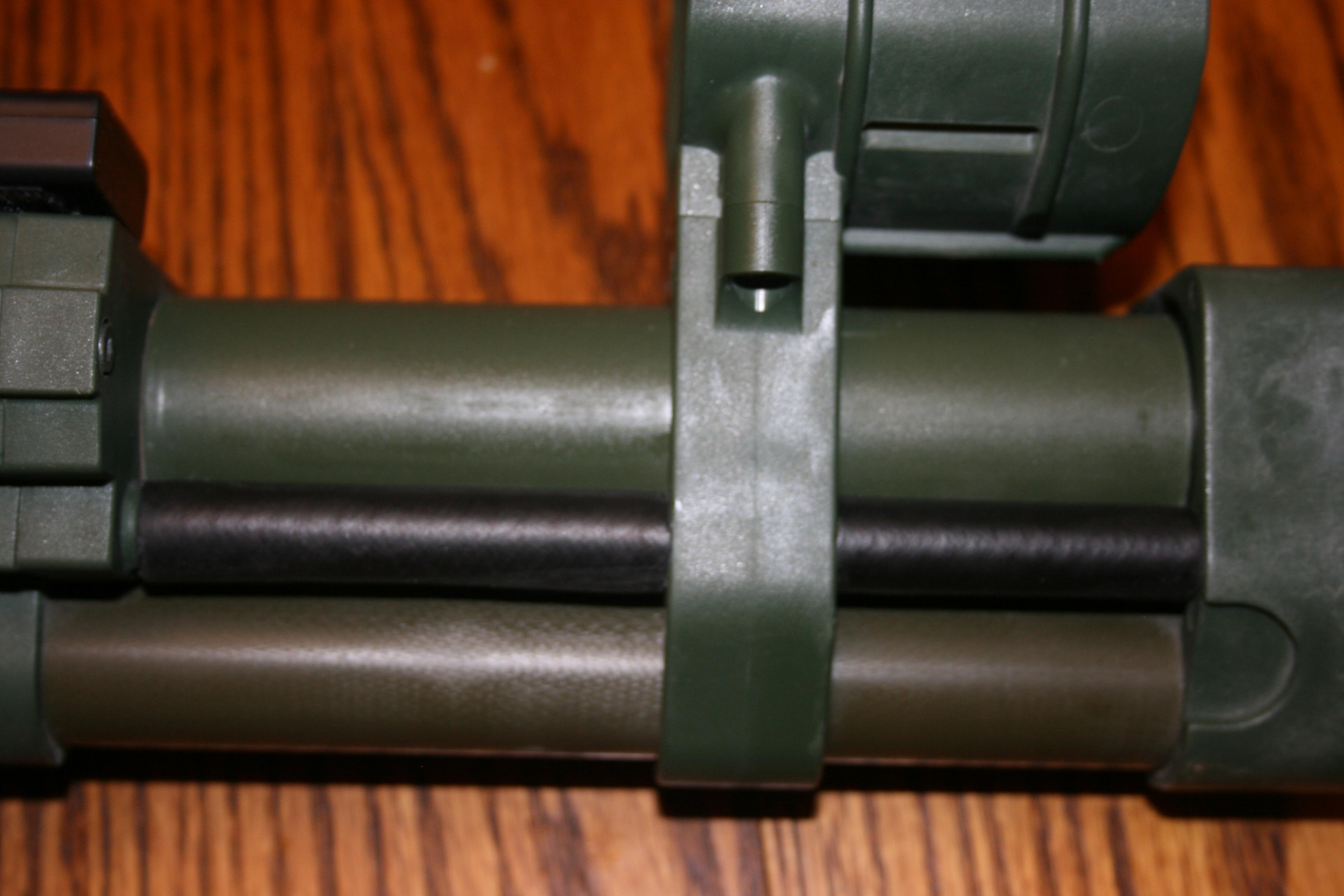

                    • Received Vallon #2 yesterday. It is in near mint condition, date is 6-10. A way to keep the arm rest in desired place. Split 5/16" fuel lines and clamshell them over the guide rod. If one piece is cut a little long (about 1/8") it will provide some compression to the system and help dampen any lateral motion as well.

                        That is a neat idea! Thanks!

                              I expect you realised this, but the guide rod is also the tube that feeds the coax from the coil back into the electronics box. It is a coiled coax in the lower shaft which allows the telescopic shaft extension. All O ring sealed too. An ingenious design!
                              Eric.
