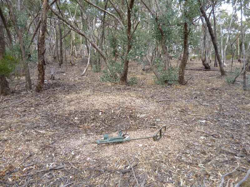

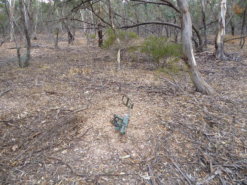

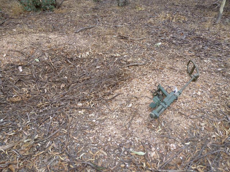

                    My day out in the Victorian Goldfields with my Vallon VMH3CS
                    Recently I said that my Vallon was a dud, that turned out to be incorrect, what was happening was the machine was ground balancing almost instantaneously on the soil in my backyard and that combined with the poor description in the manual lead me to the wrong conclusion,
                    After watching Kingswood's video, I tested my machine on 3 tubs of goldfield dirt with added hot rocks, (these hot rocks were found with my 4500).
                    THEN, I could see a difference in the time the machine took to ground balance on the 3 different samples and when I waved the coil over the other 2 then they reacted and needed re balancing.
                    But the machine only takes a couple of bobs of the coil and its done with GB, very quick.
                    These 3 samples were from Castlemaine, Beechworth and Heathcote Goldfields in Victoria.
                    So last Saturday I travelled up to Wedderburn which is over 550 Km round trip for me to test my Vallon on the hot mineralised ground there, even my GPX4500 has a hard time there, unfortunately there were hundreds of detectorists in the area as a detector jamboree was being held in the town that weekend.
                    The weather conditions are important I think, it was a hot 35' C and hotter temperature in the direct sun with a strong wind blowing the dust around, it has not rained there for some time so the ground was very dry and dusty and hot to touch with your hand, I didn’t spend a lot of time testing as it was very hot and the 25 mm March flies were biting big chunks out of me, at least the mosquito plague from the last few months has died off.
                    The machine needs to be re tested in the winter on wet ground.
                    The public Goldfields are very restricted on where we can hunt, the area I chose to test was in a flattish long gully that had extensive workings, and had been thrashed with detector holes everywhere, I laid the machine on the ground for a few minutes to let it adjust to the temperature as it said in the manual, I also used the military headset which works quite well and fits ok with the straps on it, but would look better with headphones.
                    The ground there has a lot of large and small quartz in various colours from white through to pinks and iron stone and slates, dense hard pack clay and gravels, a scattering of scrubby bush and trees which gives a lot of bark and leaf litter and a small amount of dry grasses, I turned the machine to normal and let it do the self test and then to the last position and adjusted the headset audio level, then turned it to mineral and put the coil on the ground and let it settle, after pushing the “C”button and doing the correct ground balance procedure it only took 3-4 bobs and it finished the GB, very fast, after walking around for a short distance I noticed some ground noise so I rebalanced in that area and that fixed that, I did notice a bit more noise from around the ground at the bottom of tress , so I re balanced on that area and that fixed that noise to, again only took 3-4 coil bobs. I struck one area around a big tree base that was noisy, and that took the machine about 6-7 bobs of the coil to balance, so I guess the trees bring deeper rocks and soil to the surface as they grow ? but out in the open areas the machine ran very nicely and no EMI, I keep the machine on 12 , turning it up to max 14 did bring up the ground noise so kept to 12.
                    Time for gold nugget testing, I brought along several natural nuggets all found with a detector, ranging from 14 grams down to .1 gram, they were in plastic bags and just laying on the surface.
                    Needless to say the 14 grammer blew the headset off, the 1 gram very loud and getting down to my (.2) point 2 gram gave good signals with the coil off the ground a few inches, the (.1) point 1 gram gave a very tiny signal and if the machine was running with good balance and the .1 nugget was sitting close to the surface then you MAY get a diggable signal, it was very iffy.
                    I had planned to bury some of the nuggets but the heat and hungry march flies were making the conditions unpleasant so it was time to find somewhere to camp for the night and enjoy a few cold drinks, so in conclusion I was very happy with the way the machine worked and balanced to the ground conditions, even the other detectorists with gpx5000's and the latest Evo coils that I spoke to, were complaining about the ground conditions and noise.
                    So if the Vallon handles hot Wedderburn ground then I cannot see why it would not handle ground with lesser mineralisation, when the weather cools down a bit I'll be back for some more testing, one thing I forgot to do, and that was to throw a magnet on the ground, to see how it clumps.
                    It would be interesting trying other size coils but getting the shaft fittings would be very difficult.
                    The description in the manual only gives a partial GB description and needs to be improved, at a later time I will try the GB at home and try and see what number LED setting the machine chose for Wedderburn, I forgot to look at the GB LED while I was testing there, I did not try the manual fine adaption .
                    A couple of pictures for interest. 6666

                      • Great Report 6666
                        That all sounds very promising! I noticed the max. sensitivity thing too...machine false signalled even when a tiny bit of grass rubbed against the coil.
                        I love the pics too....the Vallon looks right at home
