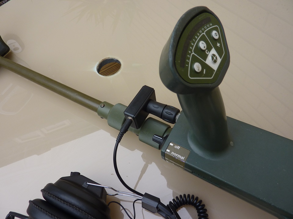

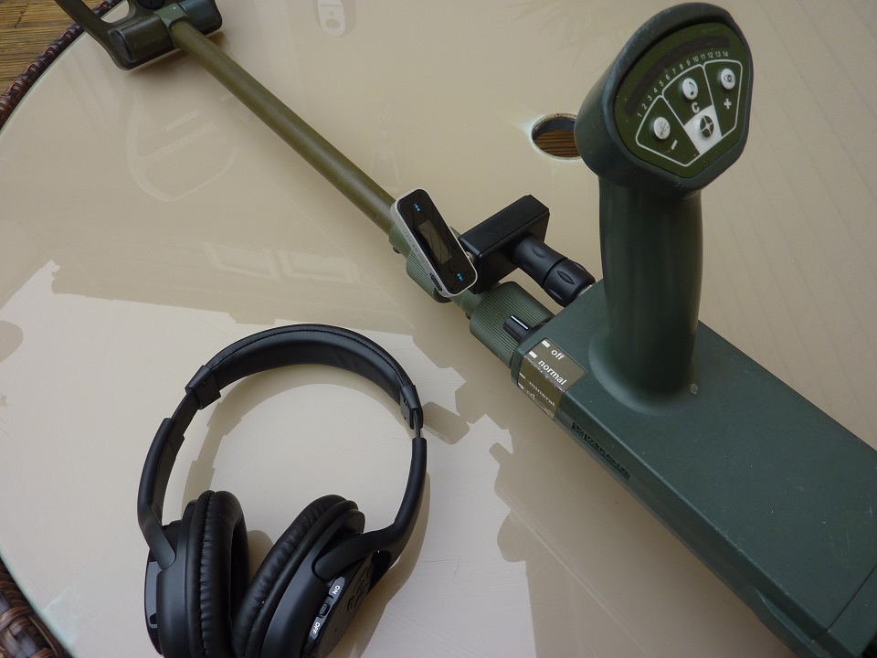

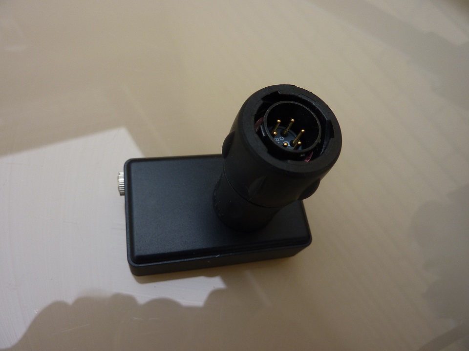

    • Standard headphones for the VMH3CS

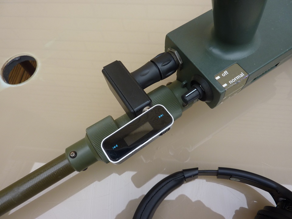

      I managed to put together a small plug in unit which enables the Vallon to be used with normal, inexpensive moving coil headphones. It also appears to work fine with an FM wireless module and FM headphones. The angle of the FM transmitter can be altered to give the best reception to the phones. I wonder how this wireless method will work on a wet beach where basically you have a huge ground plane which may affect the propagation from such small antennas.
      Eric. Click image for larger version

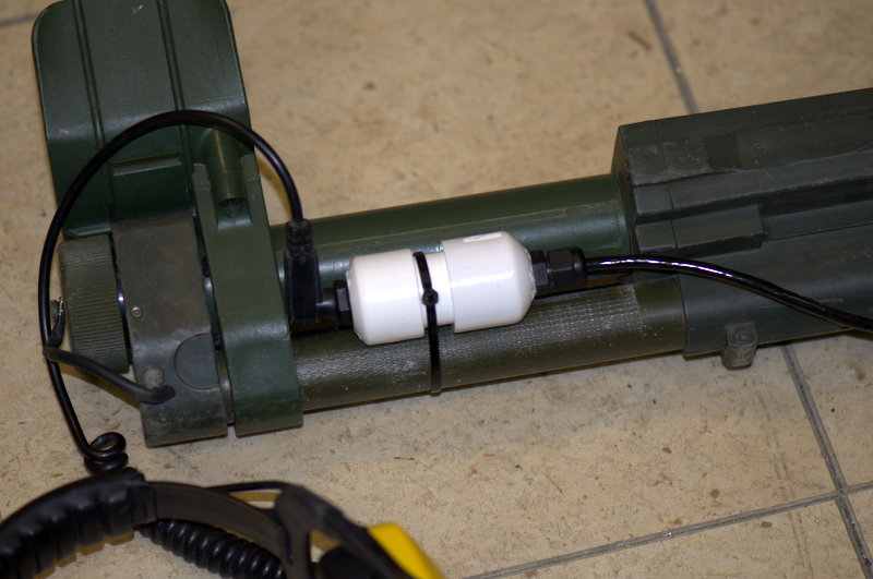

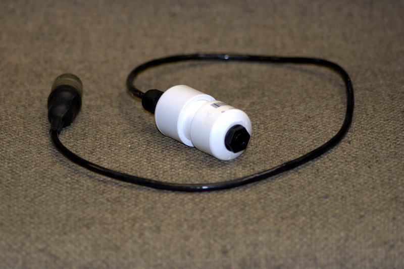

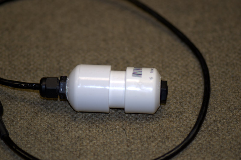

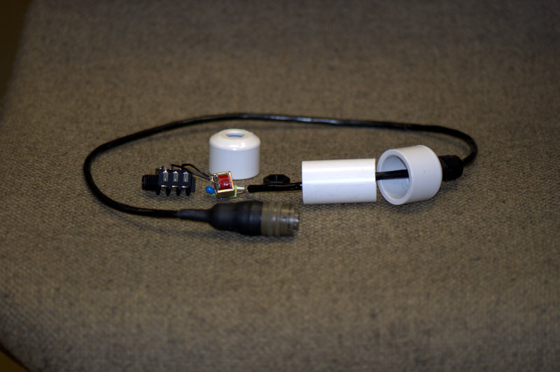

        • Based on Eric's earlier post. I used a matching transformer and some pvc pipe fittings to make an extension to 1/4in. adapter. It keeps the headphone cable out of the way behind the armrest. The pipe fittings are 3/4" and the pipe is 3/4" schd20 thin wall. The transformer is unmarked, but I believe it is about 600ohm : 8ohm. I have tested it with my "Nugget Buster" headphones and some homemade piezos. Very loud.

          • Some great headphone ideas here! Thank you
            I will get onto making similar.

                Nice invention, I picked up some piezos, one day will install in earmuffs, I've done this before with rocking armature receivers out of telephone handset.
                • Eric re your FM cordless TX, great invention, I have used a digital tuned FM TX similar to the one in your picture, I used it on my Ace 250, worked very well, had a small problem with over driving the audio , just needed a small inline pot to reduce audio, and then worked perfect, used a pocket FM rx to listen to signal.
