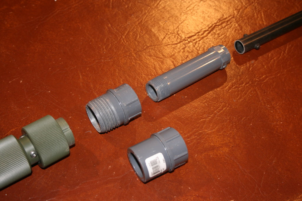

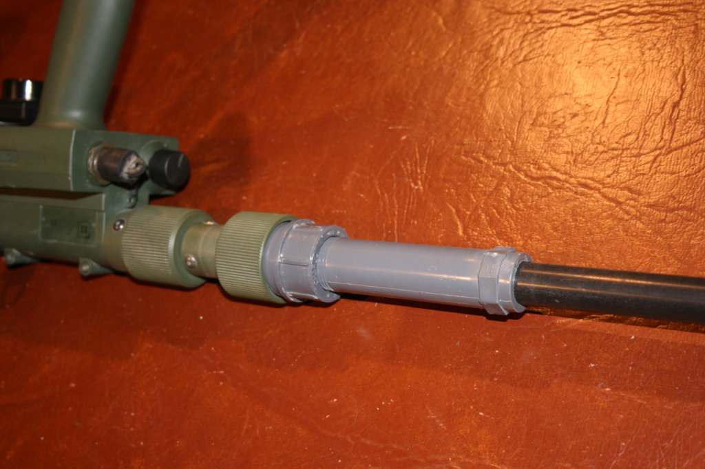

                          • Eric; Thanks for the Vallon manual link. Here I show an adapter for a White’s lower rod to the Vallon VMH3CS. It is made from two common home improvement store plumbing items, and requires some lathe work. There may be a 7 pin connector that could be potted in, but one could probably just use pins and wires, sealed out to a small external connector. Not ordinarily opening that joint again (by changing coils at the coil end). I used a threading die to cut a 1.5-8tpi thread on the adapter’s existing OD, though threading in a lathe would make maintaining axial alignment easier. Also, the ID on that end has to be opened up to 1.215”. The other part is a sawed off and faced pipe nipple with the existing hole drilled out to .75”. There is plenty of opportunity for further refinement.
ID:	348449 Click image for larger version
