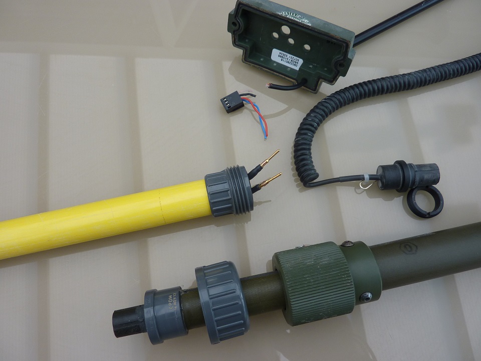

      Eric; Thanks for the Vallon manual link. Here I show an adapter for a White’s lower rod to the Vallon VMH3CS. It is made from two common home improvement store plumbing items, and requires some lathe work. There may be a 7 pin connector that could be potted in, but one could probably just use pins and wires, sealed out to a small external connector. Not ordinarily opening that joint again (by changing coils at the coil end). I used a threading die to cut a 1.5-8tpi thread on the adapter’s existing OD, though threading in a lathe would make maintaining axial alignment easier. Also, the ID on that end has to be opened up to 1.215”. The other part is a sawed off and faced pipe nipple with the existing hole drilled out to .75”. There is plenty of opportunity for further refinement.
      Hi Th'r,
      That is a good way of doing it and using the existing thread on the middle rod. Now you have identified the thread, I will look into that further.
      My way is perhaps a bit more drastic and also requires lathe work. First is to cut off the existing connector housing and locking collar. You might think that undoing the three screws would achieve this, but the screws seem to have Threadlock applied and even if you do get them out, the body is cemented to the shaft with epoxy. Be careful not to cut through the coax. Undo the locking ring securing the hard rubber connector body in the now free outer housing. Pull the plug forward and then cut longitudinal slots in the housing to free the cable.
      I can't remember the exact stages from then on, but the picture paints a thousand words. At least it shows that various parts involved and the potential to use alternative home built coils. In this instance the yellow tube contains a ferrite cored probe. The correct size pins are readily available and I plug the live one into the middle female socket and the ground one into any of the outer six. When coupled together, the pins just retract into the internal space in the yellow tube, which could alternatively be a Whites lower shaft.
      The inline connector is normally on the end of the coax, but I cut it off so that I could pull the whole cable from off the bulkhead but leaving enough to rejoin later. The red and blue wires are from the battery supply. All the latter is only necessary for a full dismantling. The connector plugs into the distribution board, which is the first thing you see when opening the main box.
      Oh yes, the pipe fittings are George Fischer pvc and available from RS Components. Heavy duty and O ring seal. Pvc parts are secure to the fibreglass tubing with Double Bubble epoxy resin, Pvc needs to be roughed up with sandpaper to give good adhesion.
      All the above by Th'r and myself are just suggestions and ideas, and requires a certain level of mechanical expertise and use of a lathe. Refinement is ongoing and it is better to wait until full instructions emerge before attempting changes that may be irreversible.
      Eric.

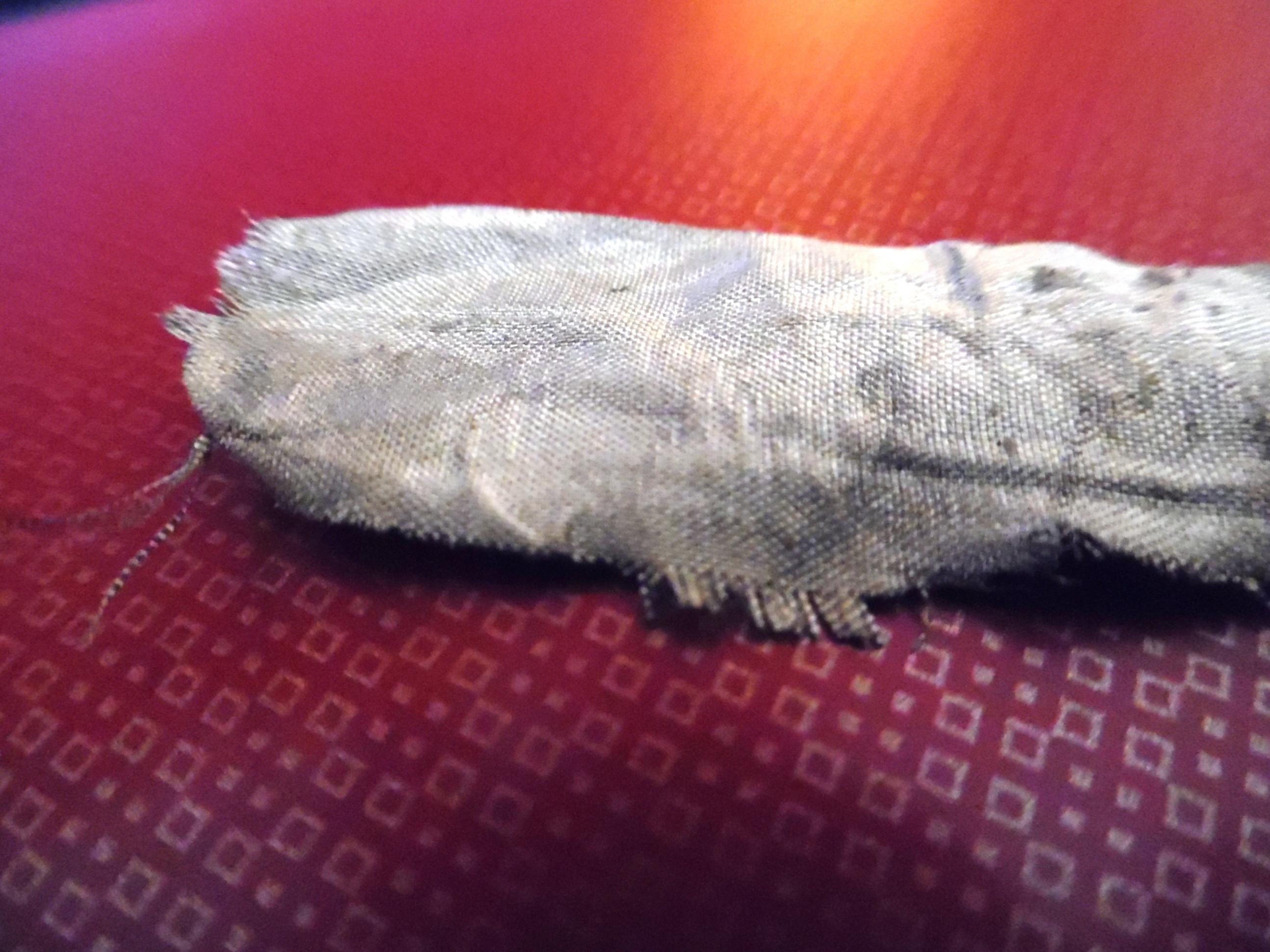

        • Hello eric
          The tape looks like this, nickel woven canvas.
          A photo piece that I retrieved on a computer
ID:	348462 ,is conductive...

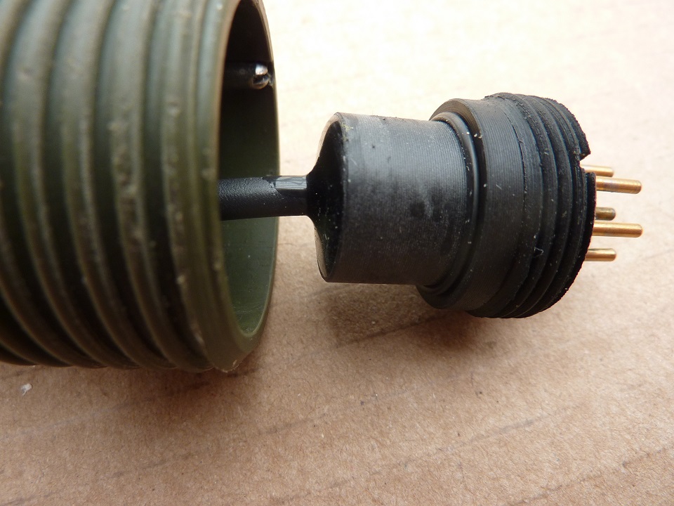

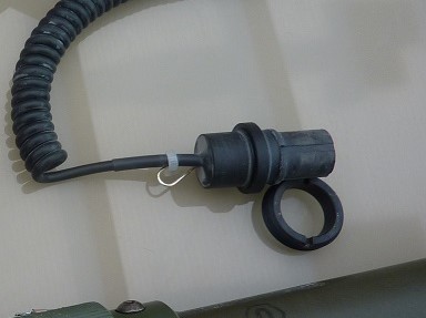

          • Originally posted by Mdtoday View Post
            Hi Eric,
            If it's not too much trouble, could you post some pics of the 7 pin connectors please.
            They look suspiciously like Conxall Mil-E QUAL series connectors with custom over mold.
            Brian
            Hear are a couple of pictures. The two inserts appear to be the same except that one is male and the other female. The bodies are a rubber type material with an additional O ring on the shaft side. Both are held into the housing with a threaded plastic retaining ring. This is seen detached from the connector body in the smaller picture. The coiled cable goes into the telescopic shaft. The wire loop connects to the 6 outer pins which are electronics ground.
            Eric.
ID:	348468Click image for larger version
