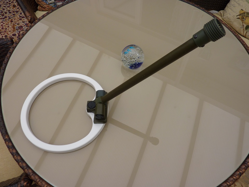

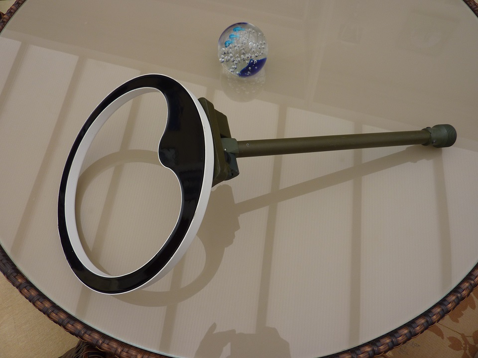

    • The 11in coil is finished and ready for action. Weather permitting, it will be down to the beach tomorrow for some tests.
      The potting was in two stages; a lightweight resin for the majority of the pot, then a hard wearing resin for the final 5mm. It seems to balance nicely around the carrying position so should be comfortable to use. All the seals in the swivel and shaft have been checked and re-greased, so it will be submersible up at least to the first coupling.

                              The primary purpose of this thread was to investigate the possibility that the Vallon pulse induction mine detector could, in its retirement from military service, be an effective hobby detector for land and beach use. After all, even 10 years after it was introduced, it has some advanced features, a major one being effective ground balance. Being designed for military use in hostile environments, it is incredibly rugged, weather proof, dustproof and submersible to the top of the bottom shaft. Sensibly looked after it should last another 10 years in civilian use.
                              Having been involved in some magnetic soil studies and attended a conference in 2008 on detecting mines in difficult soils, I have read many of the reports on the use of various mine detectors in places such as Bosnia, Croatia, Iraq, and Cambodia. The Vallon was always very highly regarded for its performance.
                              Two years ago I purchased six VMH3CS search heads and shafts which has been thrown out as unfit for further service. 5 of the search heads turned out to be perfectly OK and one was cracked. It was the cracked one that I salvaged the swivel from, and is now mounted on the 11in search head recently built. Out of the shafts, by mixing and matching parts, I have 3 complete ones with internal cable and plugs. What I was never able to get until recently was the main control box of the VMH3CS.
                              Having being absent from the Geotech Forum for a few years I figured that someone might have tested a Vallon with coin, ring, nugget hunting, in mind; hence my initial post to see what the response would be.
                              These detectors will be coming onto the market in dribs and drabs due to upgrading of mine detection technology and downsizing of military forces and maybe they have a second life rather than being consigned to the dustbin. That is what I am investigating at present. The technical side as to how they work as well as they do is also interesting, but my facilities and expertise is limited when it come to programmed DSP. Someone else can investigate that if they wish.
                              From today's beach tests I am convinced that the VMH3CS is a good contender amongst other top PI units, inspite of the beach and weather conditions not being the best. I found two £1 coins which paid for two hours at the car park, plus fishing weights and other bits of metal. We did some depth tests in wet sand of US and UK coins but that is for another post.
