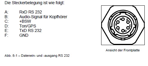

            Here is the pinout information
            • Originally posted by mschmahl View Post
              [ATTACH]38150[/ATTACH]
              The pinout is a bit puzzling as you would think pin B is the live audio connection. However, it appears that pin D is the one to choose (marked Tone). To mute the internal piezo speaker you link B to F, which can be checked with a test meter on the connector on the phone supplied with the detector. Some suppliers do not include a phone which is a one-ear job and doesn't look the part.

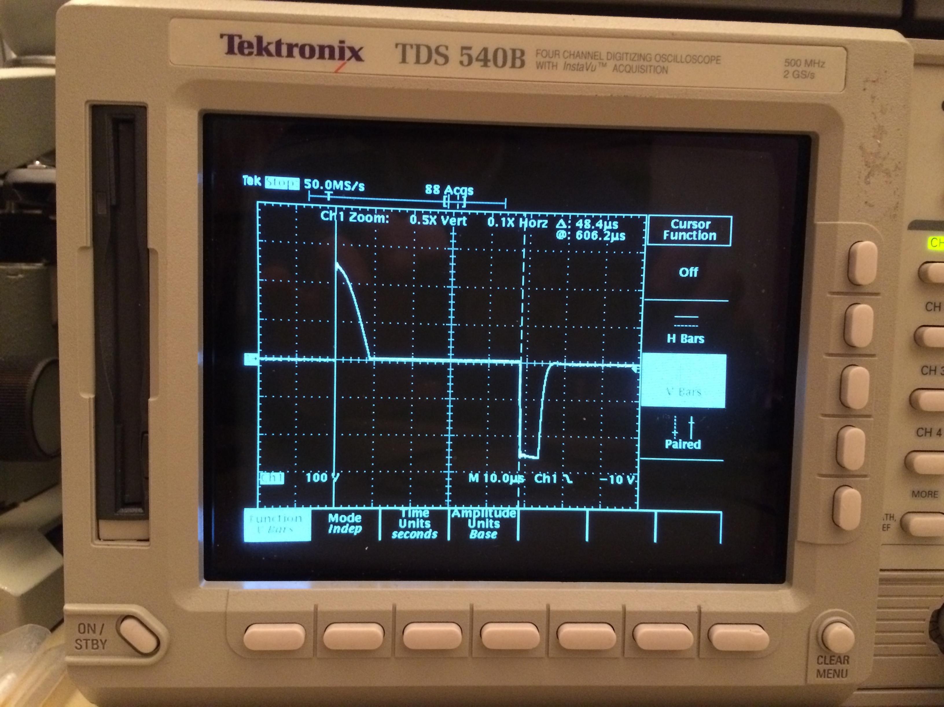

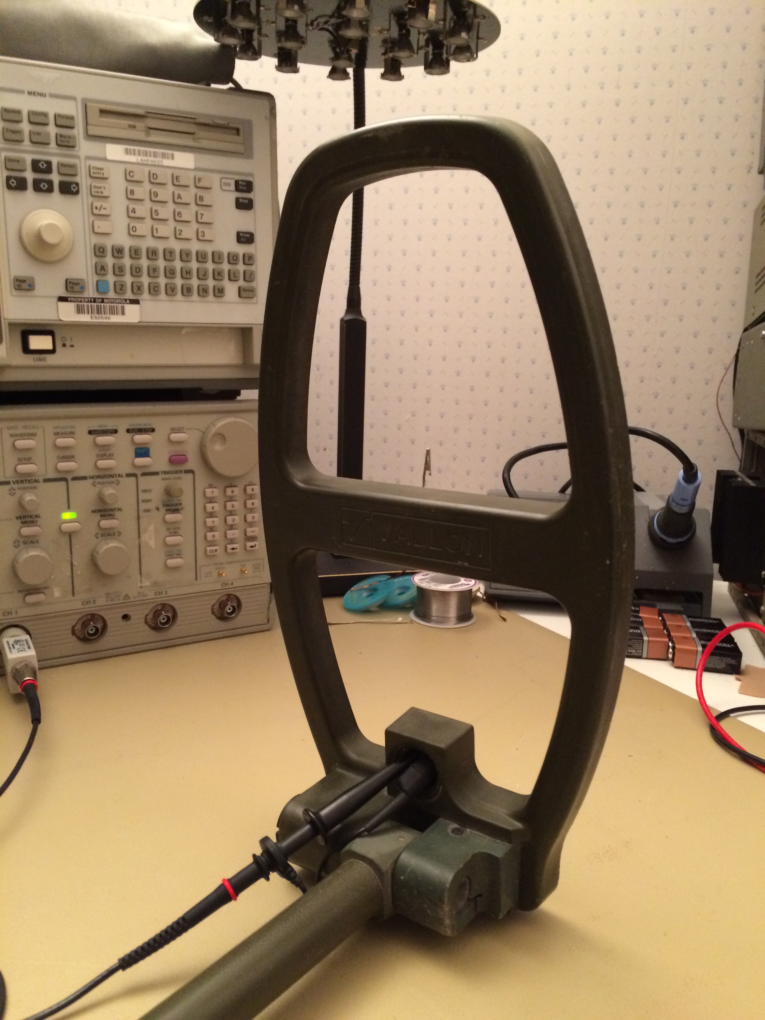

                • I had time today to make measurement by connecting a scope probe on the coil of my Vallon VMH3CS like that :

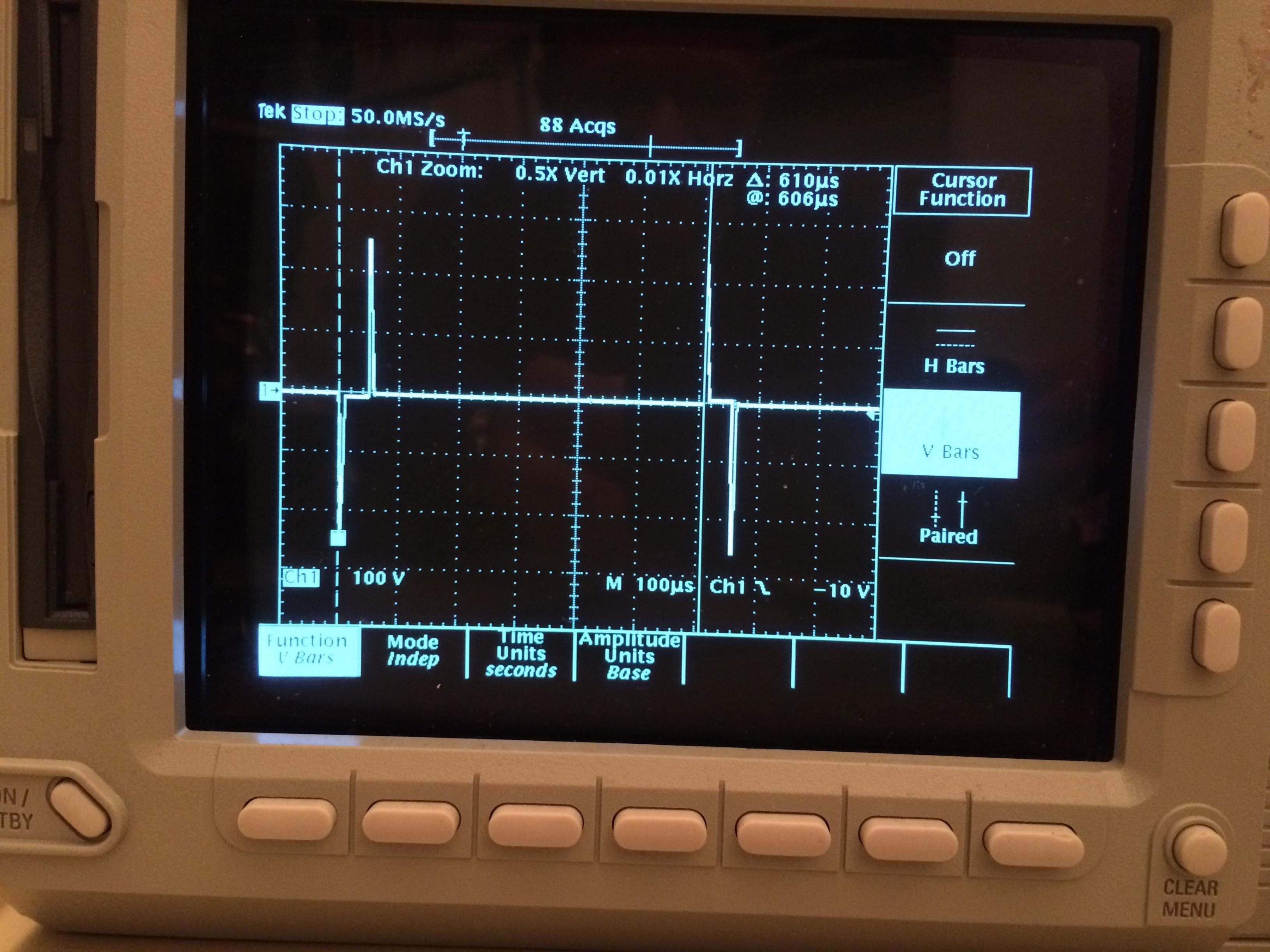

                  First a view of the two successive pairs of pulse
                  As you can see the two pairs are 610 us time spaced with a +/- 250V amplitude.
                  Now the first pair
                  The first negative pulse is unusual as a sawtooth waveform but the second one is more common. They are 48.6 us separated.

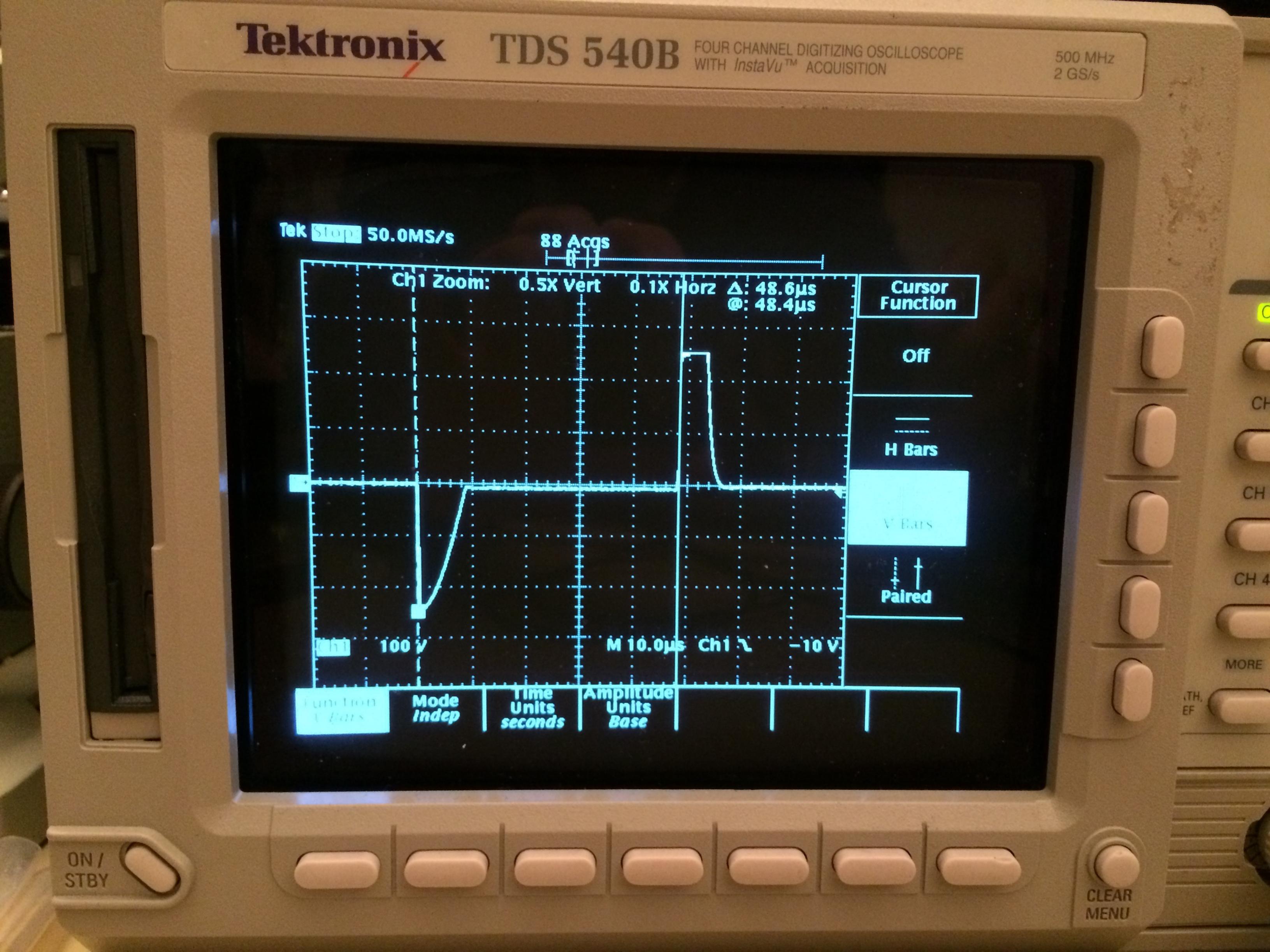

                  And now the second pair
                  The second pair is as the first one but amplitude reversed.

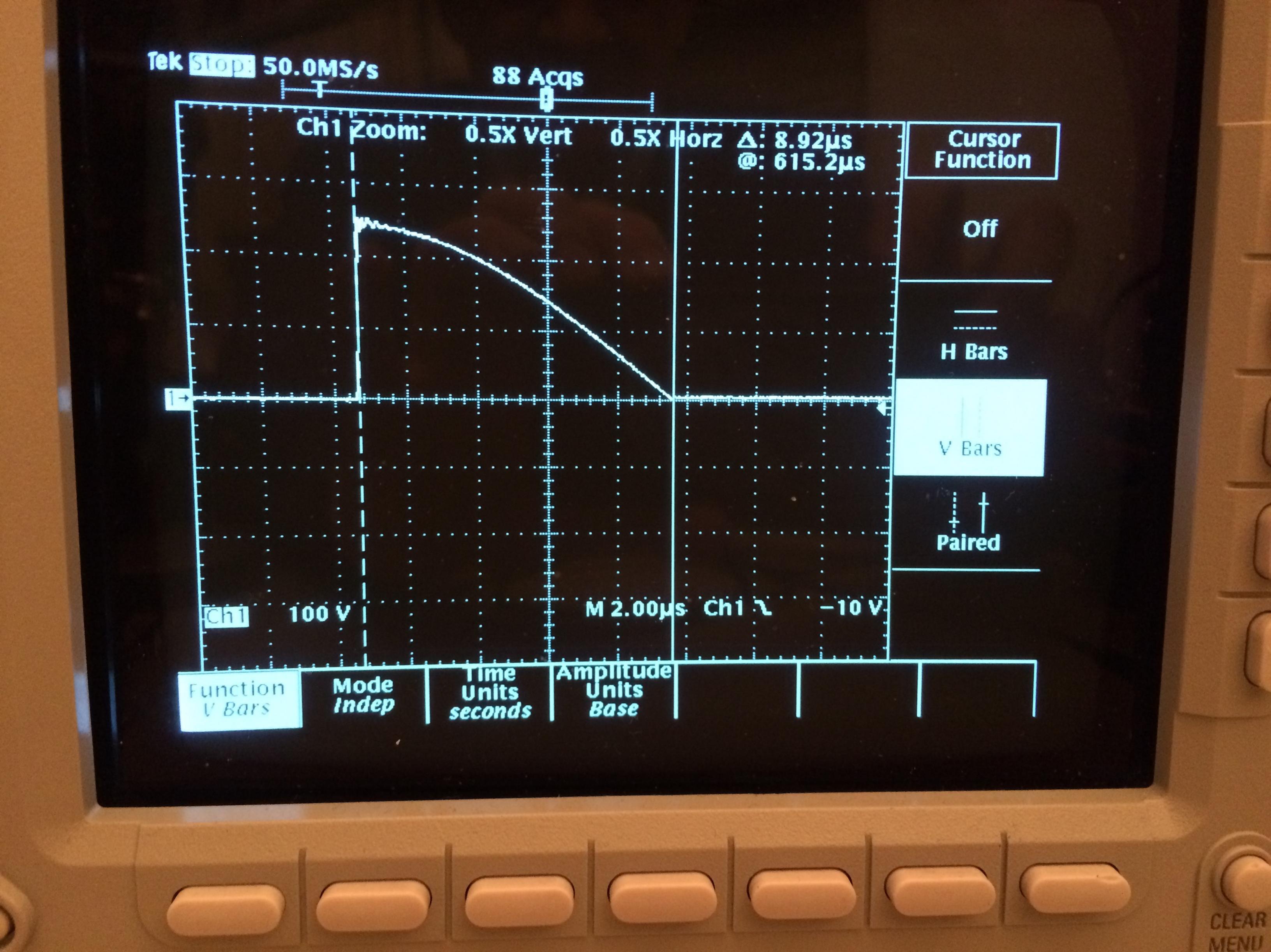

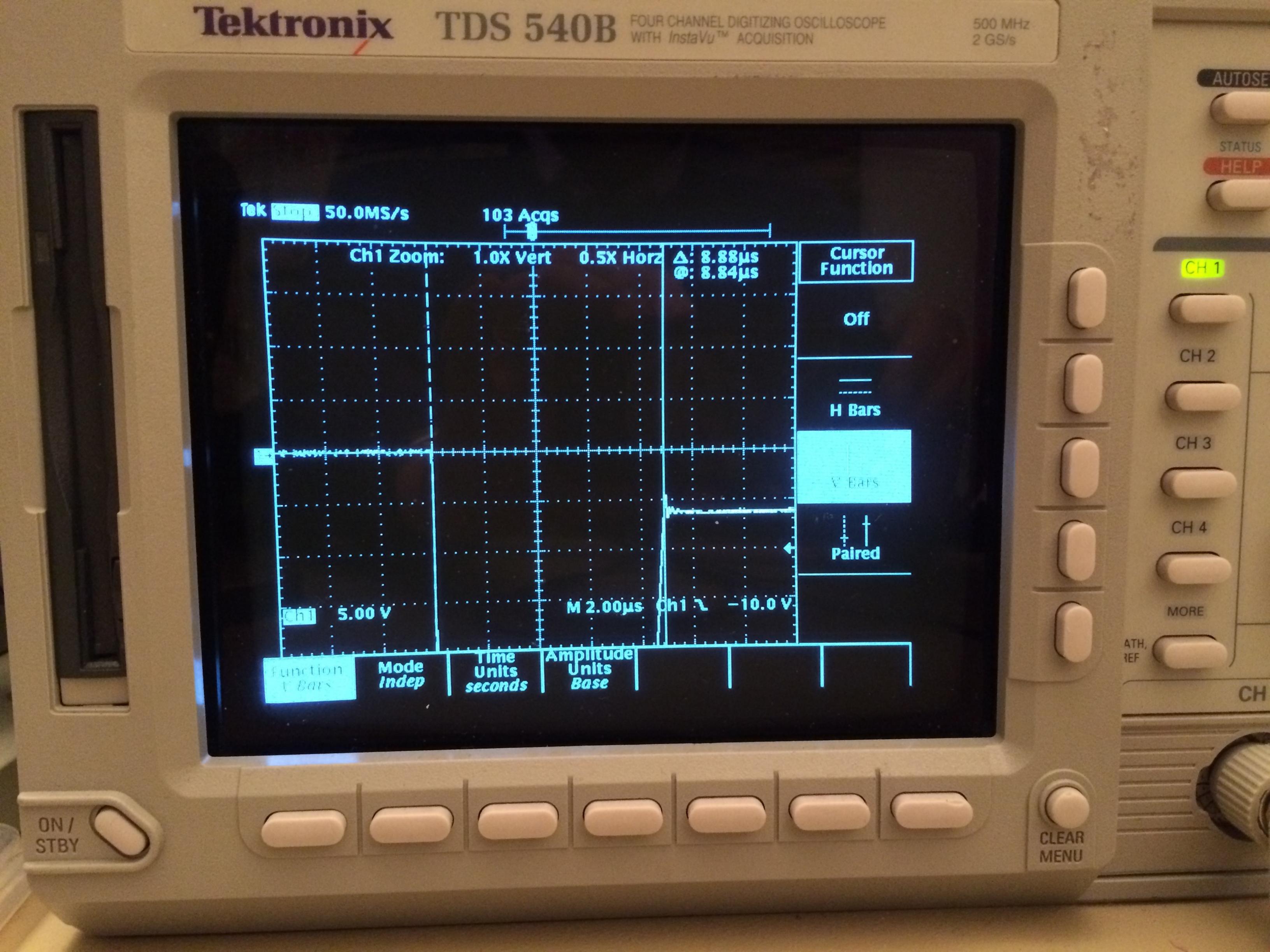

                  The first pulse of the first pair about 9us long:

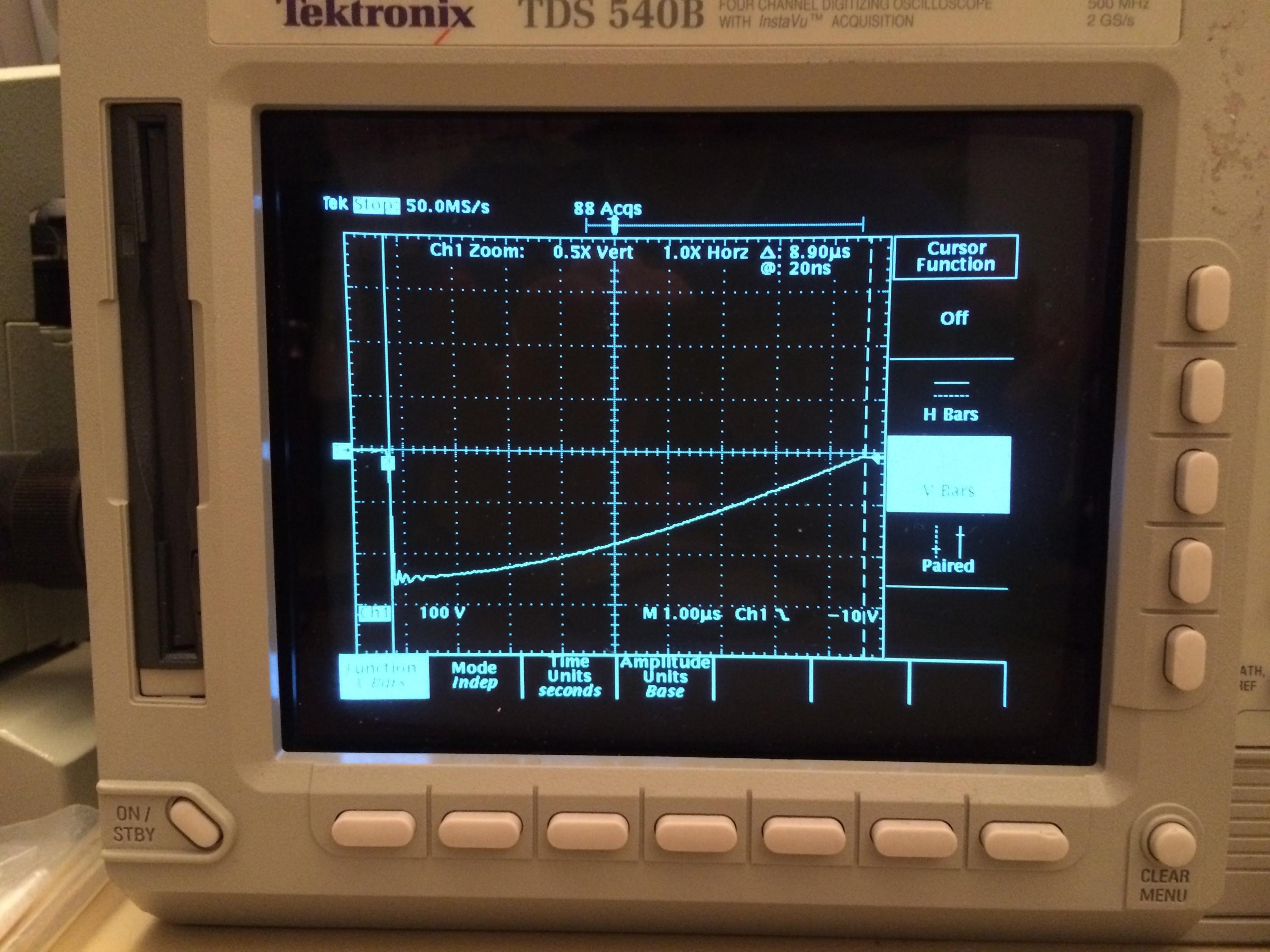

                  The second pulse of the first pair about 8.2us long :

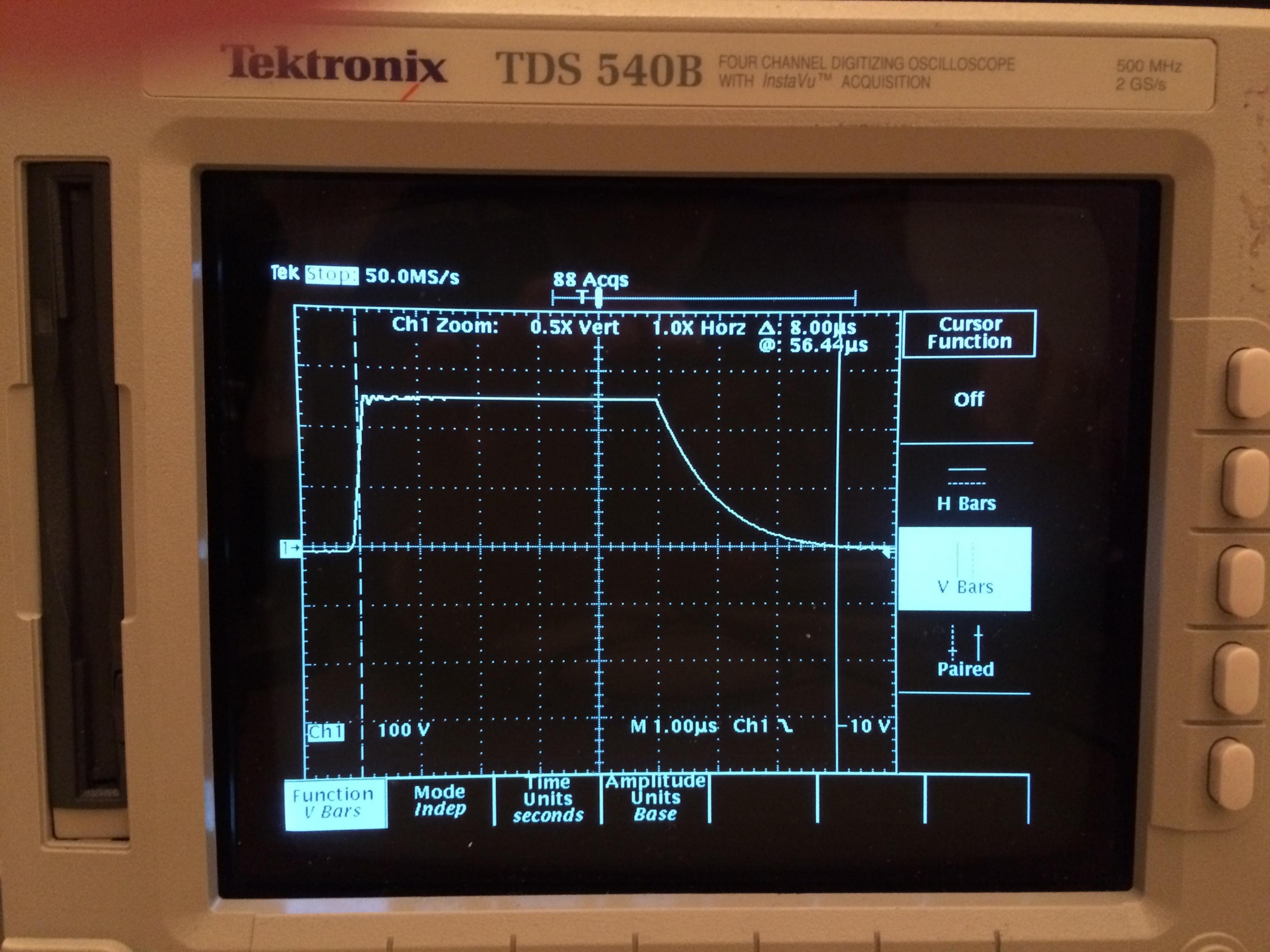

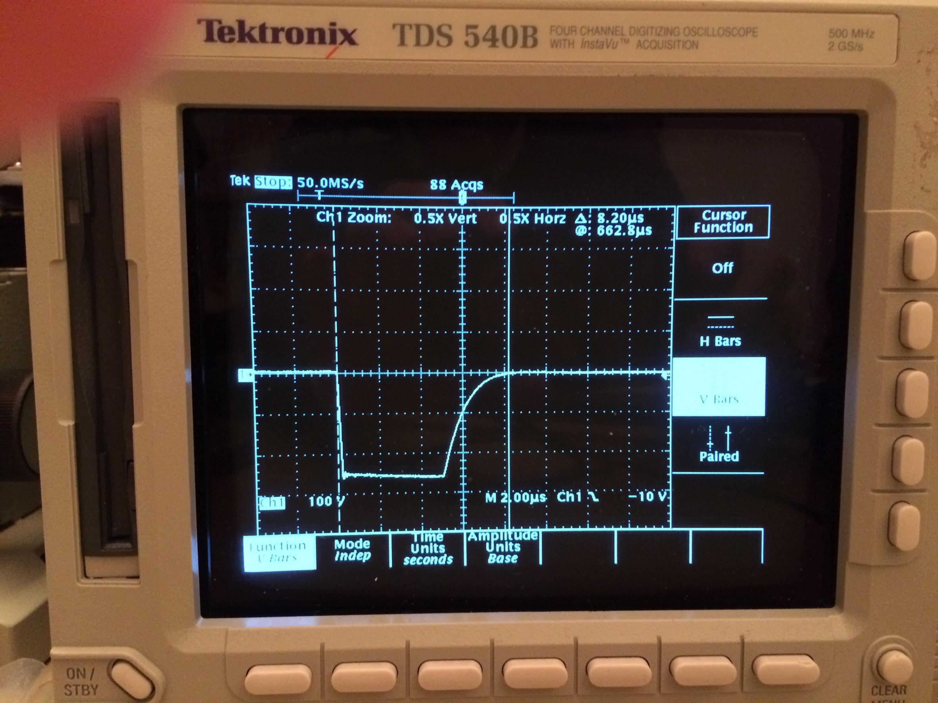

                  The first pulse of the second pair about 9us long:
                  The second pulse of the second pair about 8us long :

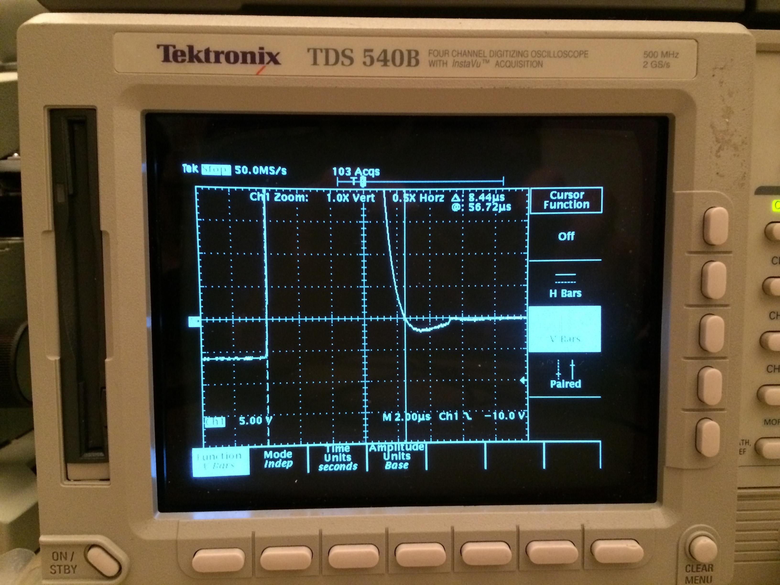

                  Now some more amplitude details. First, the end of the negative sawtooth signal
                  It finishs at -6V.
                  And finally, the end of positive pulse. There is an undershoot of about 2 V. It doesn't seem to be well damped.
                  What do you think of all that stuff ?

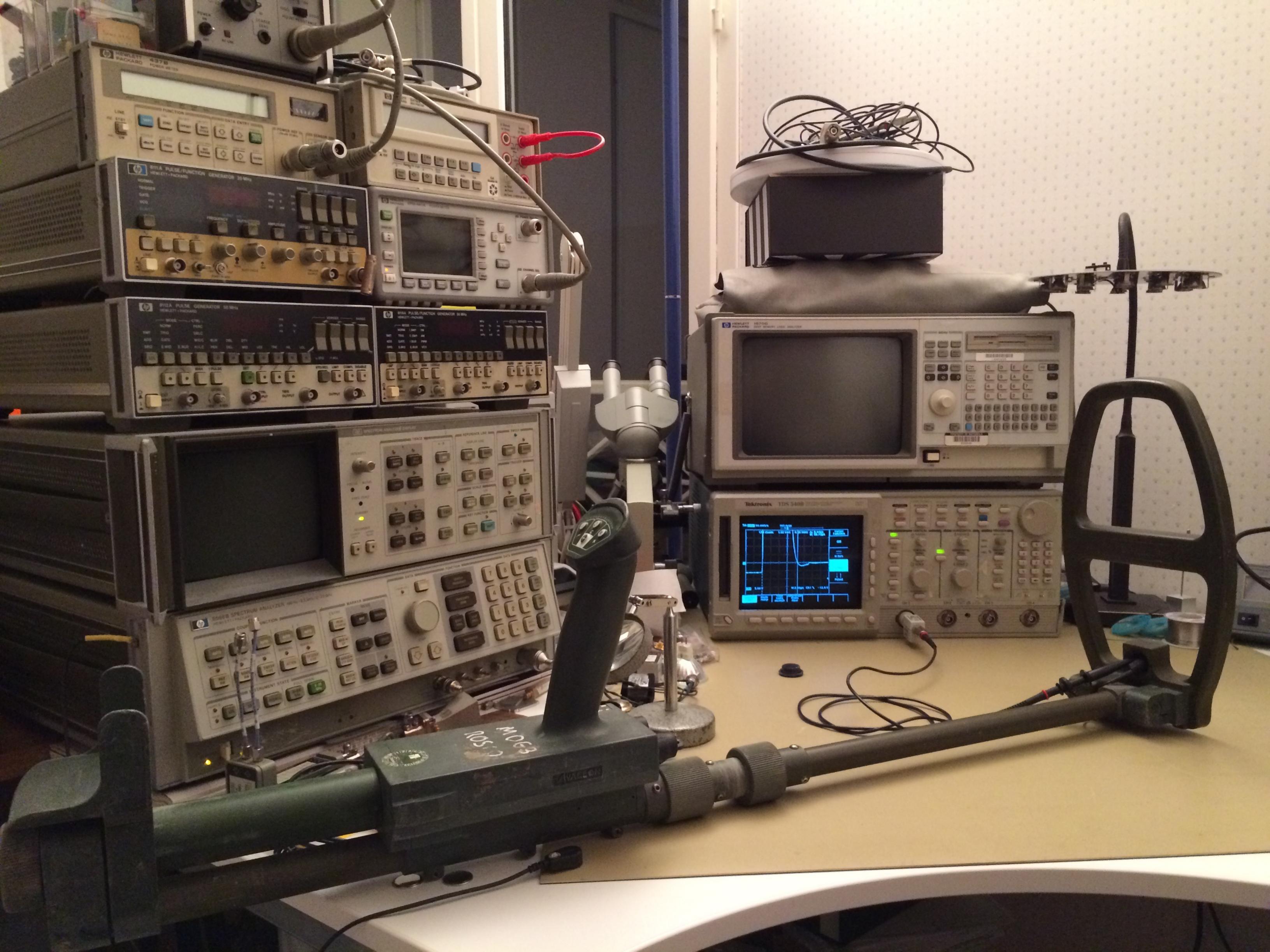

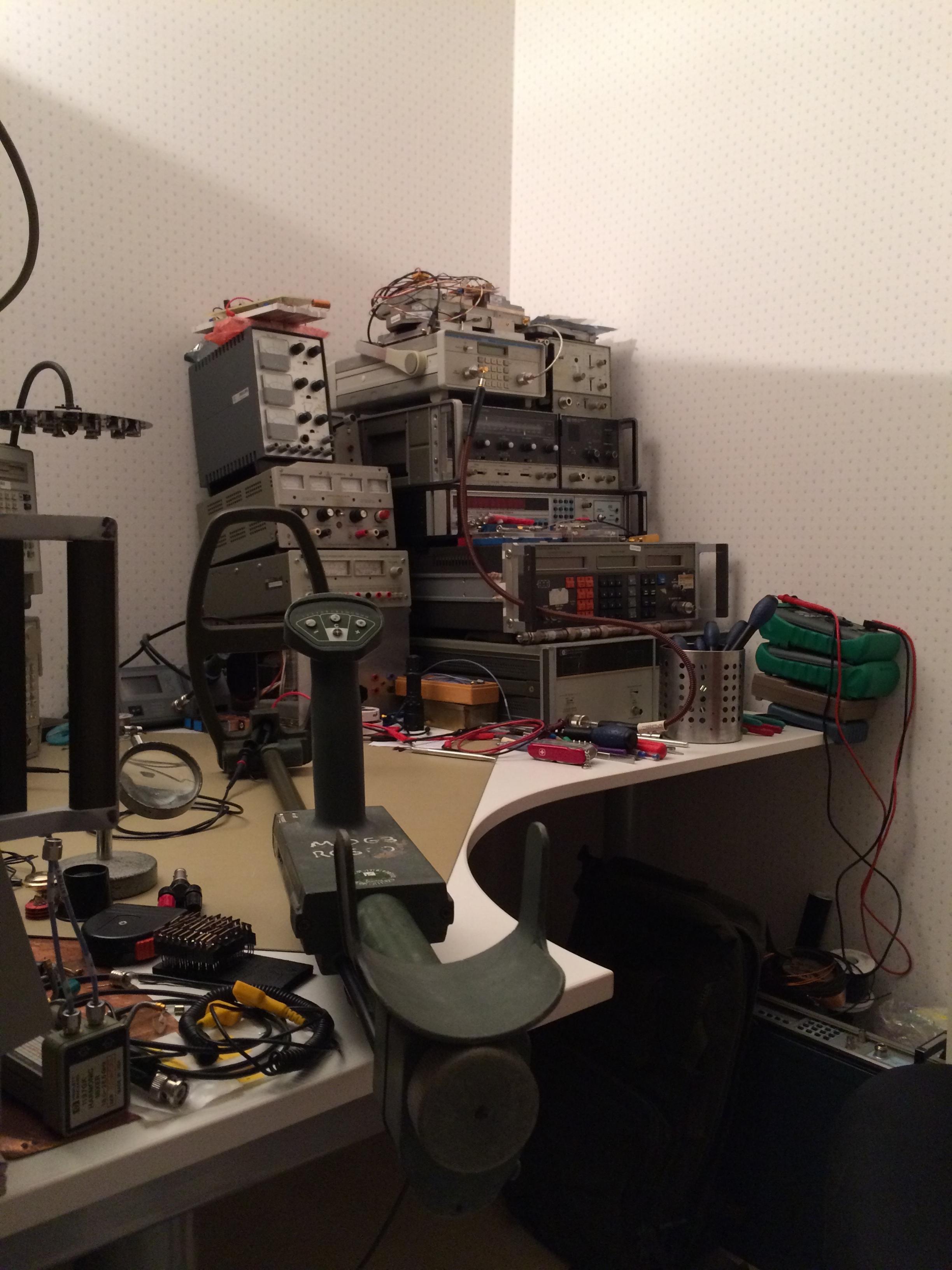

                  • There wasn't enough room in the previous post for two pictures of my lab with the Vallon on the bench !

                      • Hi Phiphi,
                        The duration of both TX pulses should be 50uS. I suggest that you may be looking at the back emf of the front edge and the back edge, and your 48.6uS is the duration of one pulse. This would also account for the difference in your pulse shapes.
                        Eric.

                            • Hi Phiphi
                              Looks in fact that your pulse duration is 48 uS
                              They are recycling a portion of the previous flyback and kick stating the next but in the opposite polarity hence the 1/4 sine capacitor
                              discharge cycle at the start of the pulse, then the cycle is repeated in the opposite polarity
                              Cheers Techo_bob..
                                Hi Phiphi,
                                Eric.
                                Hi Eric
                                I had a bad and a good night : a bad night because I didn't sleep well but also a good one because I think I found why I have so strange waveforms !
                                I have measured the voltage across the coil and everybody knows that V = L di/dt so di/dt = V/L.
                                You have written that the final current is 1 A. I see that the last 40us of the pulse are at 6V so it means 4mA/us (6/0.0015) or a 160mA variation in 40 us.
                                The pulse is 48.6 us long so after 8.6 us the current is 1000 - 160 = 840 mA. So in the first part we have about 100 mA / us average slope or 150V average voltage.
                                We have a sawtooth at about 300V decreasing in 8 us to 6V : that's about 150 V average or 100mA /us.
                                In the first 8 us, the current as a parabolic shape with a slope decreasing from 200mA / us to 4mA / us and the last 40 us a linear variation from 840 mA to 1A.
                                Maybe they do that by polarizing the Mosfet with a decreasing voltage from 300V to 6V by discharging a capacitor or something similar ...
                                Philippe
