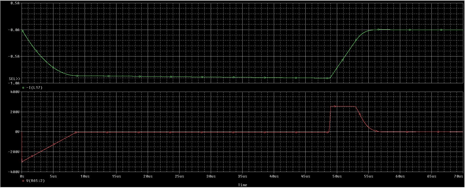

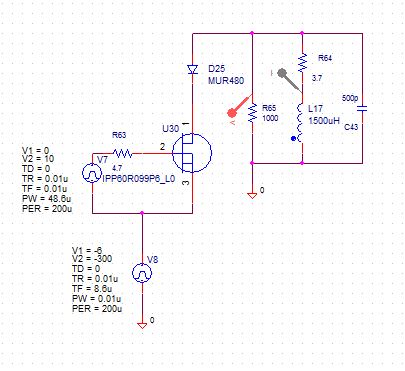

          • I have made a simulation with PSPice trying to get the same current and voltage coil waveforms than those measured by Eric for the first one and by me for the second one.
            Here is the schematic :
            That's the classic one but the Mosfet source is polarized with a signal going from -300V to -6V in 8 us instead of a constant voltage.
            The result is shown below
            On top is the current in the coil increasing quickly to about 850mA in 8us with a parabolic shape followed by a linear increase to about 900mA in 40 us.
            On bottom is the voltage across the coil with the first part with a sawtooth shape and the second one with the classic back-emf.
            So now we have to imagine how to realize practically the source polarization.

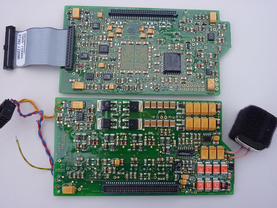

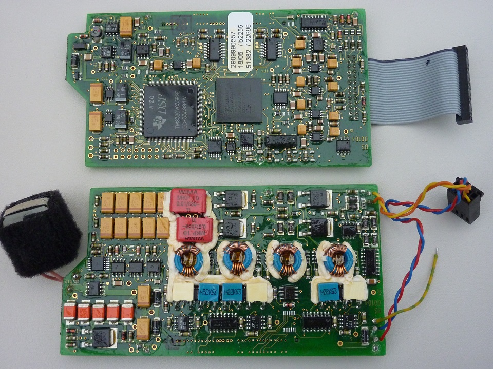

                    • These are the boards referred to in 443. The boards are plugged together and the first picture shows what you would see on top and bottom side when you turn it over in the plugged state. The second picture is what is inside (middle layers) when unplugged. The furry component is an inductor which is later versions is slightly smaller and mounted on the recessed end of that board.

                      The four IRFR320 mosfets are at the top of the board with the OPA627 preamp on the right near the yellow/orange twisted lead.

                      Four more IRFR320 mosfets on the underside and the 4532 P/N cmos gate almost under the OPA627.
                      Eric.

                            I am still studying that... It seems the arrangement is different between the MOSFETs on the bottom vs the top. The 4 on the bottom of the board (the side without the torroids) are arranged in pairs with the drains connected together and sources tied together thru resistors to the same point for each pair (can't tell where the gates are connected), whereas the 4 on the top are arranged in pairs with the source connected to the drain and gates tied together for each pair. The torroid transformer windings appear to use awfully heavy gauge wire for use a pulse transformrs. There needs to be a means of generating the HV for driving the leading edge of the TX for ~10us. I had assumed that the HV kick was from capturing the HV flyback, but the TX voltage waveforms seem to refute this... capturing the HV flyback reduces the voltage significantly from the 250v that is indicated by the TX coil waveforms. Also capturing the flyback of 1 amp coli current will only kick start to about 750 ma. I suspect there is an addition HV being generated to kickstart at least 1 MOSFET in each TX cycle to 1A with the other MOSFET working off LV with total resistance set to limit current to 1A. I agree that the gates are most likely transformer driven. My experiments with driving MOSFET gates with pulse transformers suggests a 2:1 ratio with a minimum 500uH in the primary (preferably 1mH).

                                Yes that is correct. The red and blue wires are the supply volts. That connector plugs into a third pcb which is basically a distribution board with cable runs to the control switch, display/push button, and data/headphone connector. There appears to be a small switch mode psu on that board also. Maybe for the LED display.
                                On that third board there is a second 8 pin connector where the raw battery supply comes in (red and blue wires also) and the coax cable to the coil goes out from that. The coax links by pcb tracks to the orange/yellow wires, with the orange being the coax braid.
