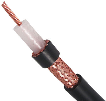

                      • Eric,
                        Inside the electronics housing im using the standard coax cable.
                        For the coil im using this kind of coax:
                        What i have is a 3-pin connector, the inner wire is connected to one pin and the outer woven to the other. So one pin is not used. So what i will do is connect the woven shield also to the outer shell of the connector and from the outer shell of the connector i will connect it again to the battery ground?

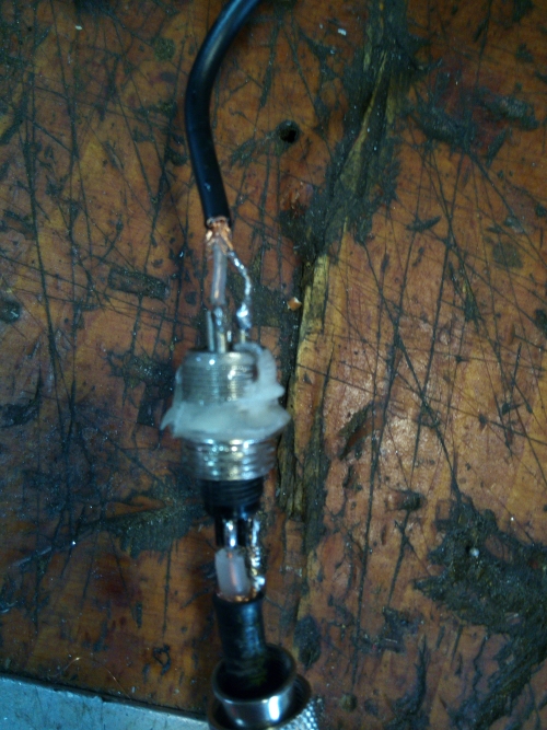

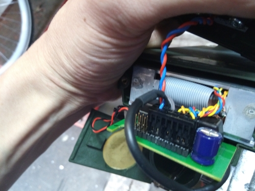

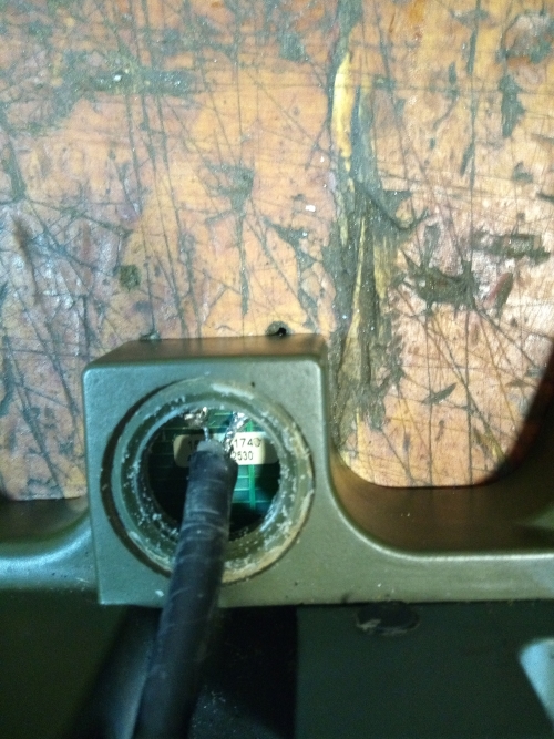

                          • Hi Stefan,
                            Can you post a photo showing your coil wiring and connections, it will help.
                            Brian
                            • The coil with the 6mm coax:
                              The coil cabel connector and the conector from the electronics enclosure stick togeteher. As you can see the 6mm coax comes from the coil and the original Vallon coax is connected to the connector which is fitted in the enclosure.
                              Here you can see the original vallon coax who is comming from the connector in the enclosure and is fitted with the original connector on the board
                              This is how it is now (with the problems)
                              • Hi Stefan,
                                Thanks for for sharing the photos. Am I correct in saying you have 2 Vallons and both are modded and both exhibiting the same problem?
                                Have you tested with the internal coil cable section out of the enclosure?
                                eg not running under the PCB and if so, did it still have the problem?
                                Did you remove the coax cable pins from the internal black socket or just cut the cable and fit the new 3 pin end?
                                The coax seems quite large, diameter I'm wondering if this is causing an issue?
