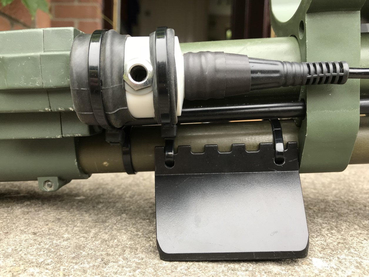

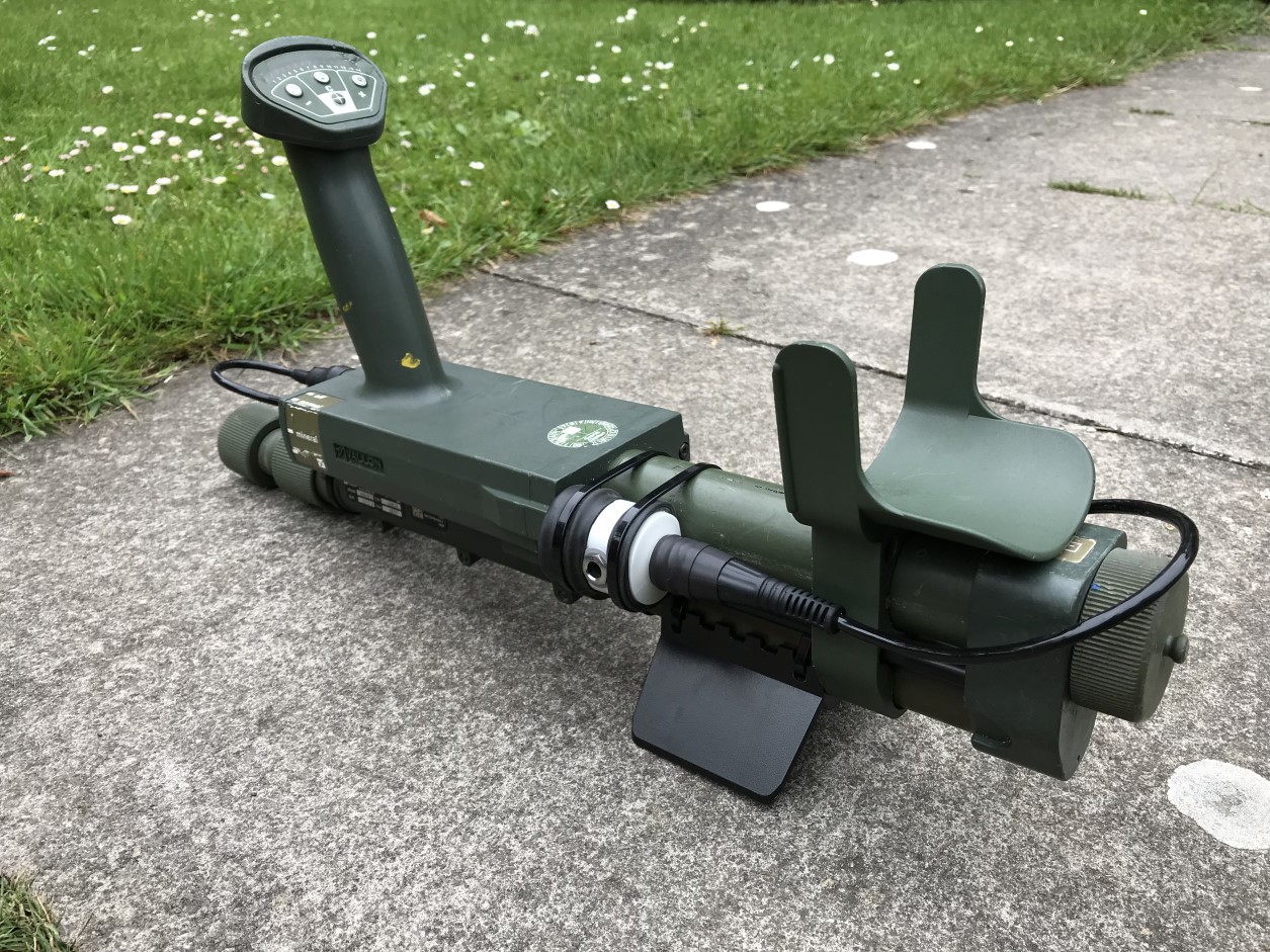

          • Bottom rest for Vallon VMH3CS
            As Eric did I have added a bottom rest, sourced from a well known American device.
            Drilled 4 holes and attached with cable ties.
