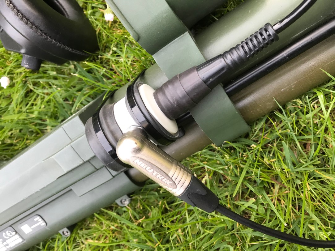

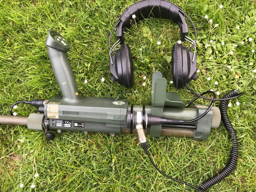

        • My version of Eric's headphone mod using LT44 transformer, empty conditioner bottle, bits of bicycle inner tube and an old microphone rubber grommet, works a treat!

          • I lied! There was a bit of heat shrink tubing as well!
