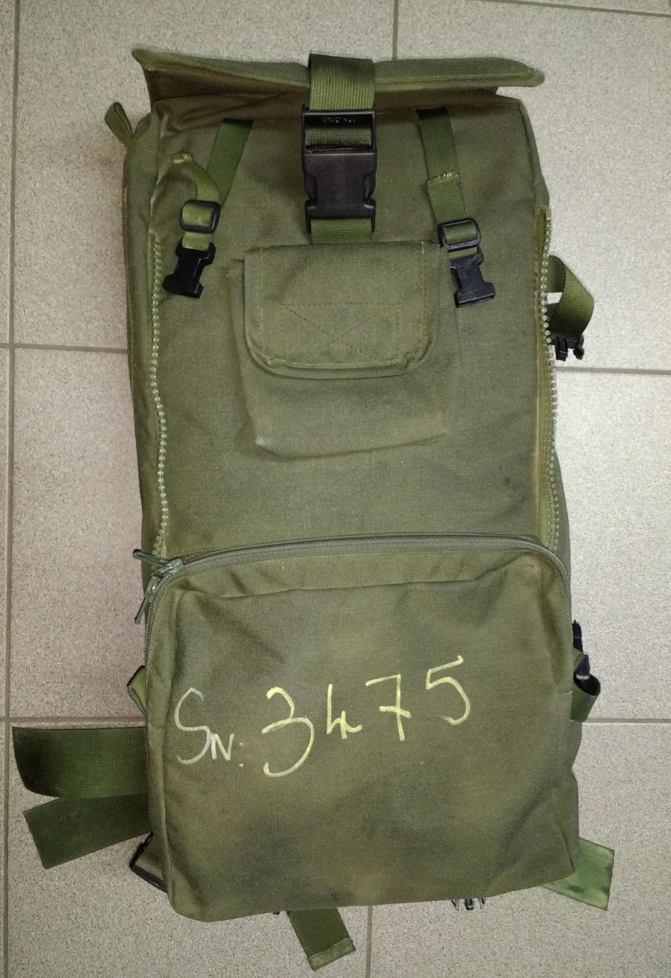

        It came with the backpack, earphone, test piece and field card. The ebay seller had also added a printout of the manual in the backpack.
        After having cleaned the detector and verified that it worked in both normal and mineral mode, I turned my attention to the backpack. It was very dusty and looked worn (meaning it had seen some action already).
        I cleaned it first with water and washing liquid and let it dry.
        Next, I started lubricating the zippers with vaseline spray.
        The primary usage of this spray is to protect car batteries from moisture. I had bought the can once in an idle attempt to protect a Pickini PCB inside a waterproof housing.
        When I accidently sprayed the vaseline onto the canvas next to the zipper, it started looking bright green and shiny again.
        I then proceeded to spray the entire backpack. The result was a backpack that looked like new again.
        Note: the serial number written on the backpack does not match the serial number of the detector.

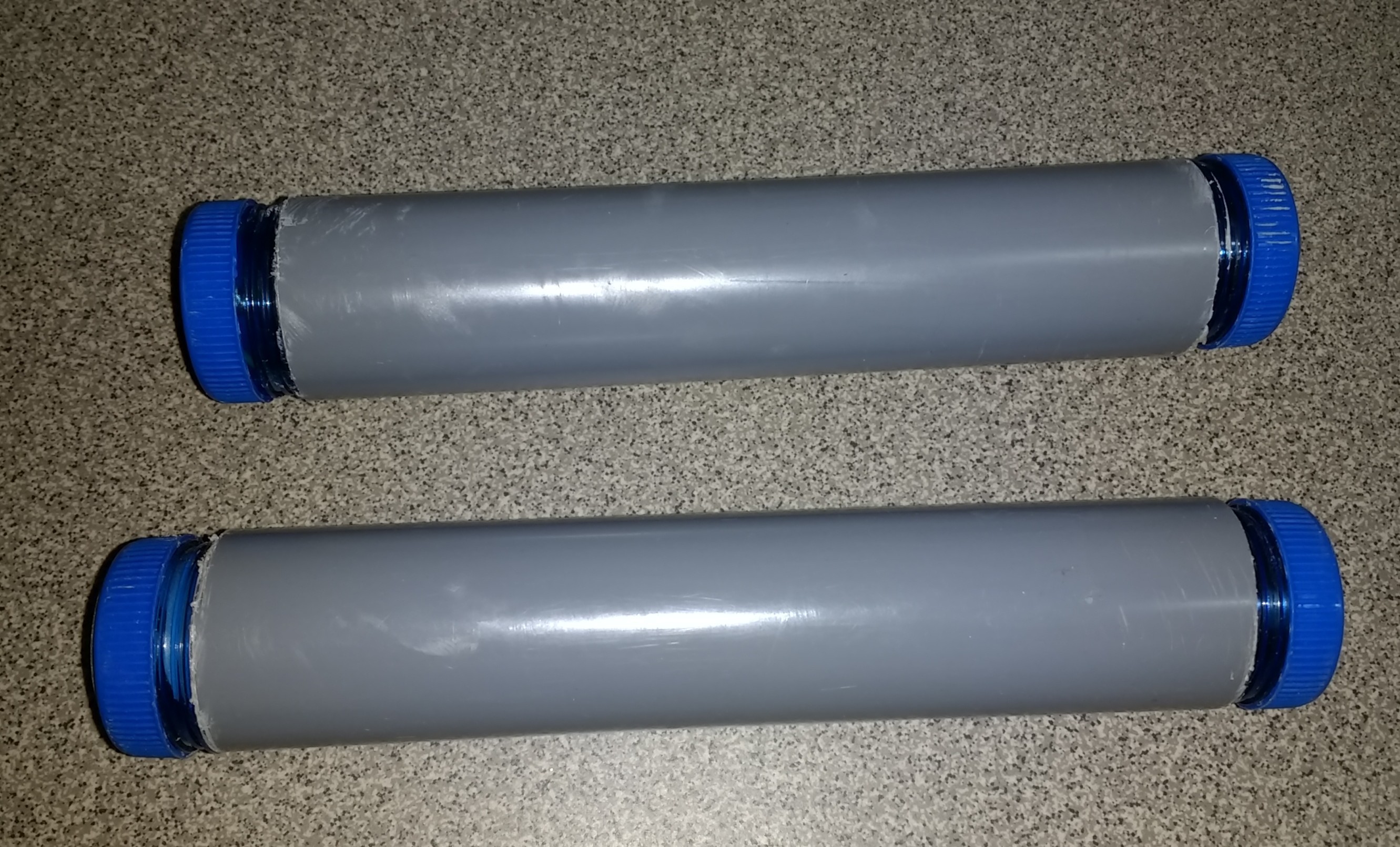

          As already described here in detail in this thread: the 3 x D-cell batteries can better be replaced by 2 x 16850 batteries in parallel. Less weight and more capacity ( > 5000 mAh ).
          The diameter of the D-cells is 33 mm and the overall length of 3 batteries in series is 183 mm.

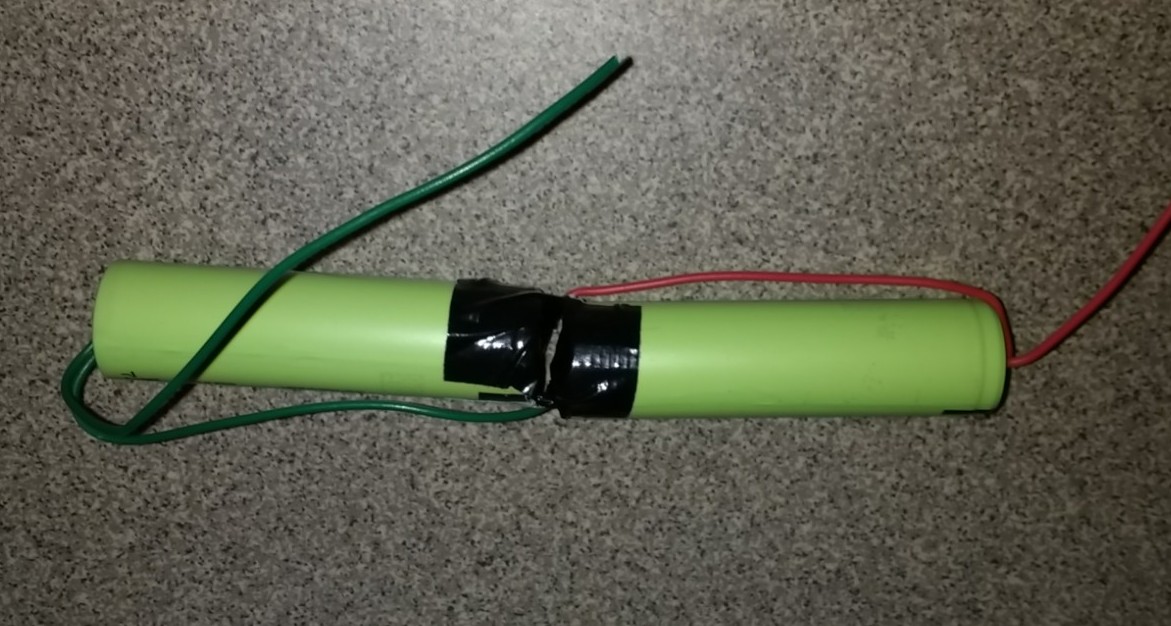

          1/ Connect the 2 Li-Ion batteries in series:

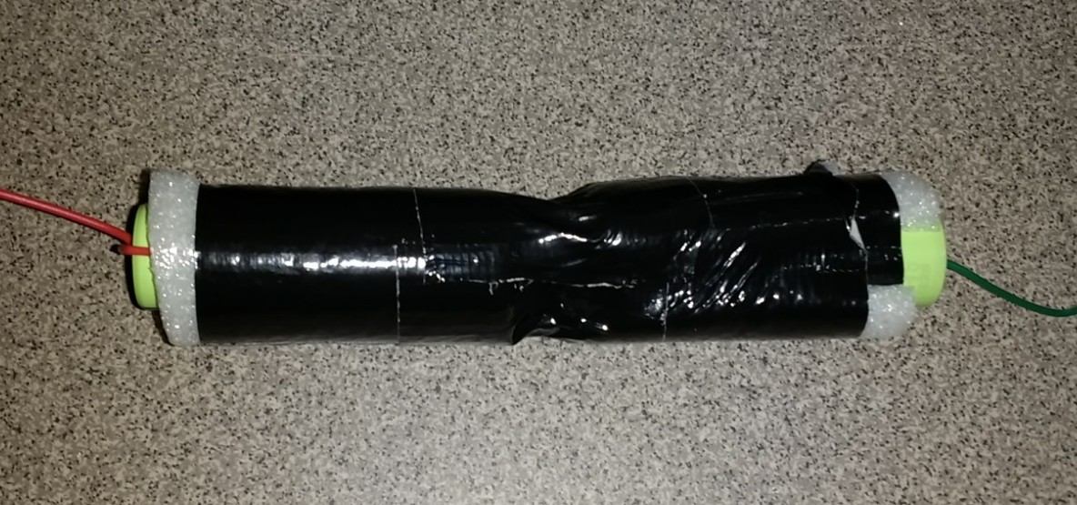

          2/ Wrap them into a sheet of packing foam and cover it with duct tape:
          3/ Slide them into a 30 mm diameter drain pipe - length 150 mm

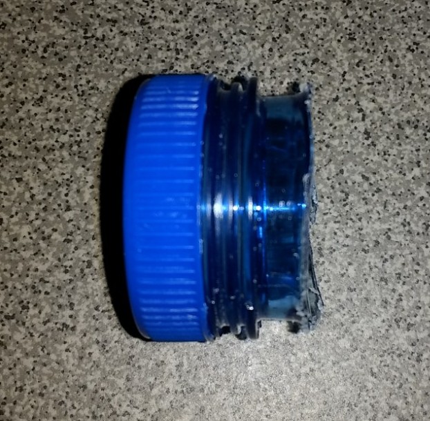

          4/ Cut 2 PET bottle necks - this is hard plastic ( not thermo formed ). I used the tops of 2 liter water bottles, but basically any bottle neck will do.
          The reason why I thought of bottle necks was because in a previous life, I got carried away by water rockets:
          5/ Glue the bottle necks on both sides of the drain tube.

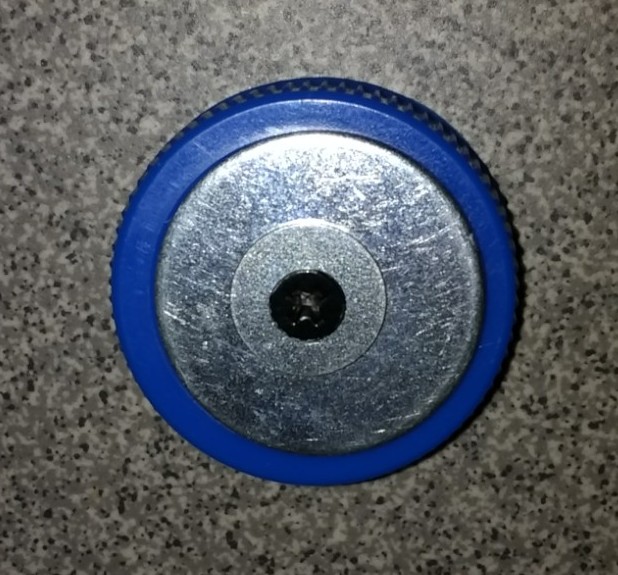

          6/ Add a washer and screw on outer and inner side of the bottle top: a small one for the positive battery side, with a protruding screw head and larger washers for the negative side with a flat sunken screw head:
          7/ Connect the plus and minus leads of the 2 batteries in parallel to the screws of positive and negative bottle top
          8/ Screw on the bottle tops - the overall length should be about 180 mm:

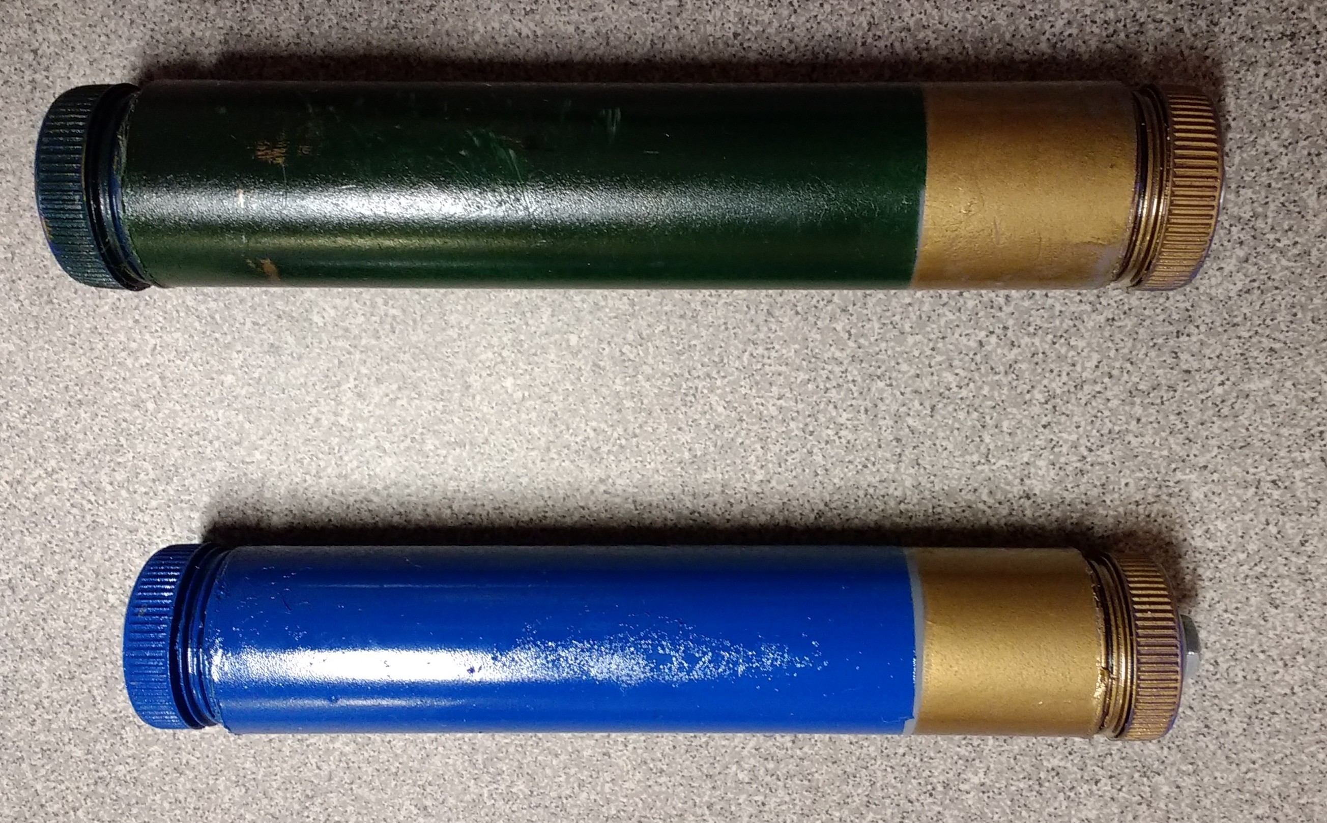

          9/ Spray paint them in your favorite colors. The result is much better when you have more patience than I do:

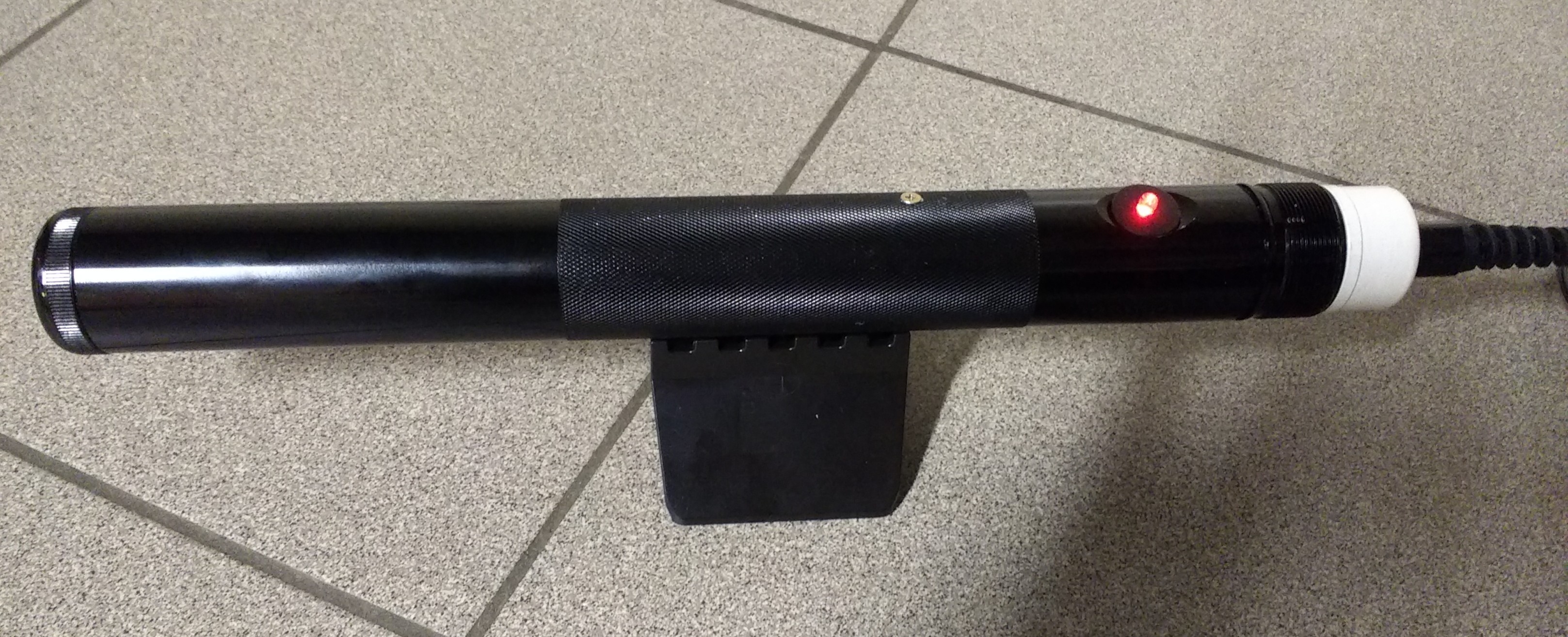

          10/ Build a matching charger:
          I used the battery tube of a 4 x D-cell Maglite torch. It was discarded as it still had the classic bulb lamp instead of newer LEDs. The extra room in the tube houses a small charger PCB and an intermediate bulkhead for the positive terminal of the battery ( that is the ugly screw head you see next to the LED).
          I then used the switch hole for the "charging" LED indicator. Power supply is a 7.5V mains adapter. There are also charger units that work with a USB connection:
          It may not come unnoticed to the trained eye of a detectorist that the charger stand is part of the Garrett AT armrest that I used to replace the detector armrest with.

            1/ Connect the 2 Li-Ion batteries in series: ==> should be : Connect the 2 Li Ion batteries in PARALLEL.

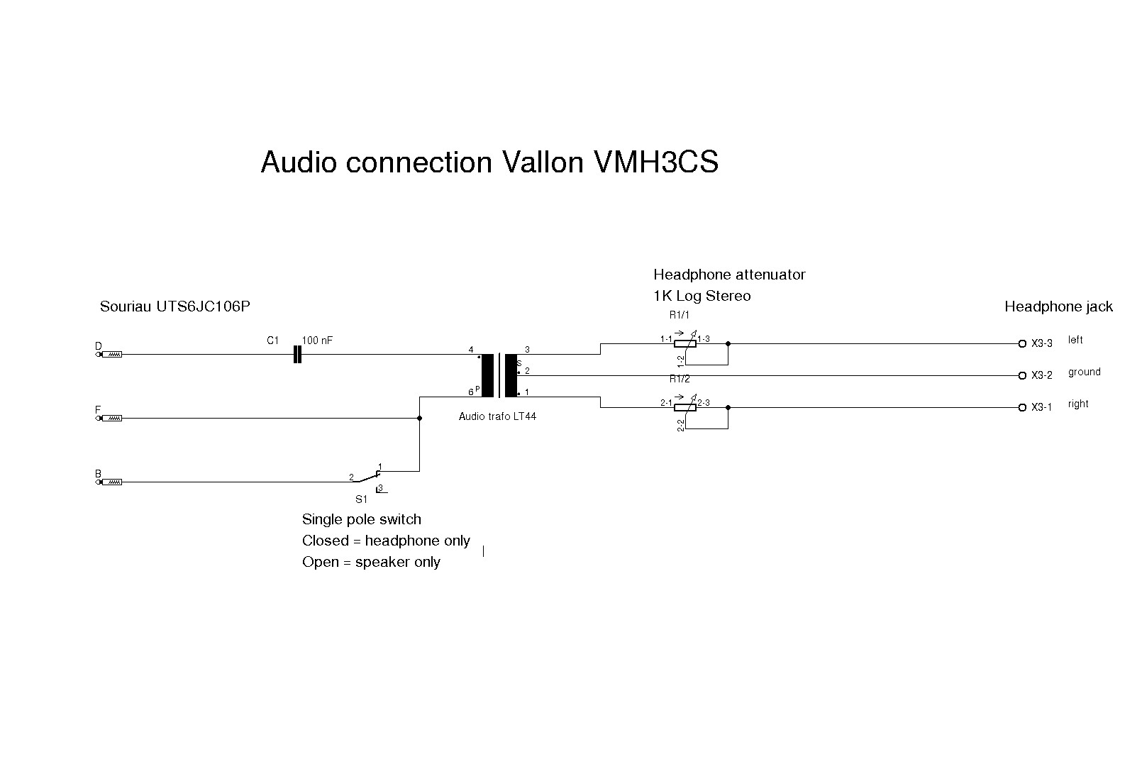

                • Audio mod
                  The audio mod to connect a normal low impedance headphone to the 6 pin connector was already described here in detail.
                  This is the schematic that I implemented:
                  After cramming all this stuff into a long small plastic housing, the connection with the Souriau 6 pin connector was made with a piece of USB cable. Only 3 connections are needed: Gnd, Signal and "Speaker/Headphone" switch:
                  Now any "normal" headphone can be connected and attenuated when needed ( the audio is really loud ! ).

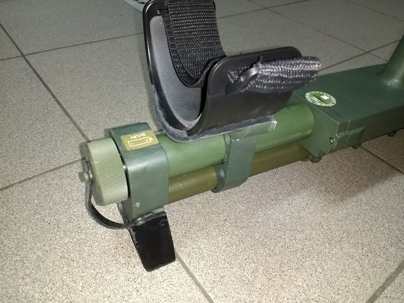

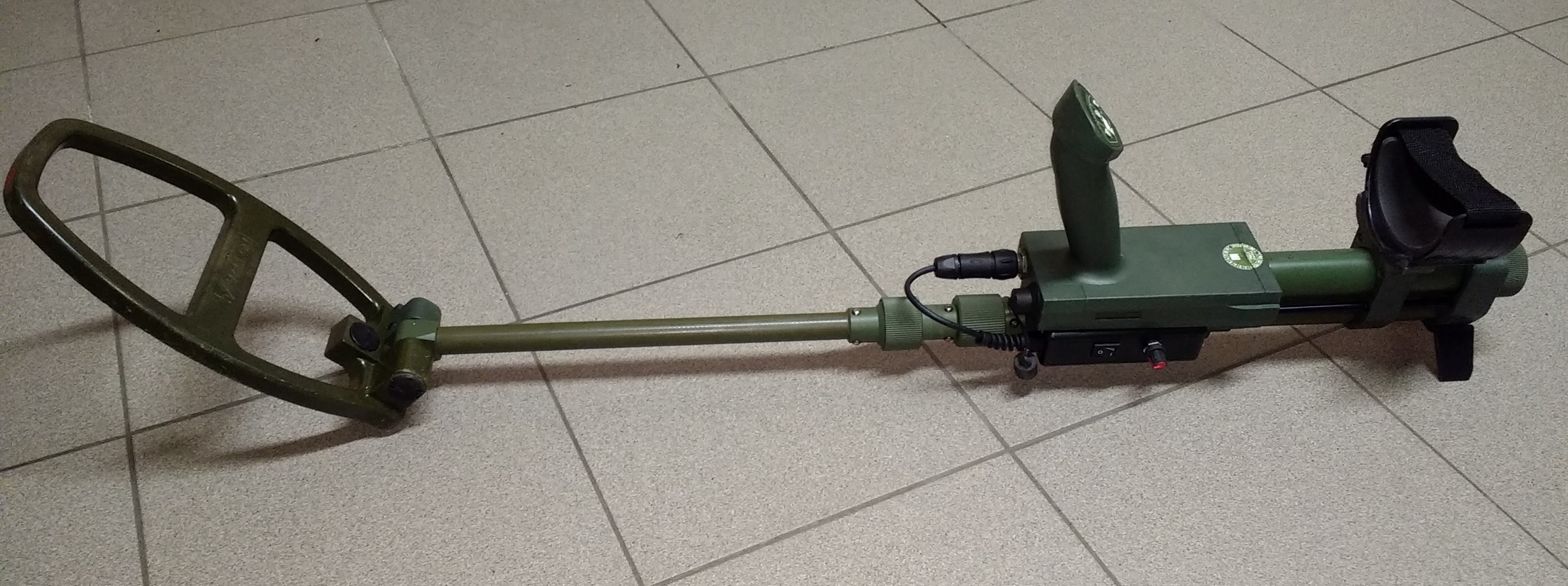

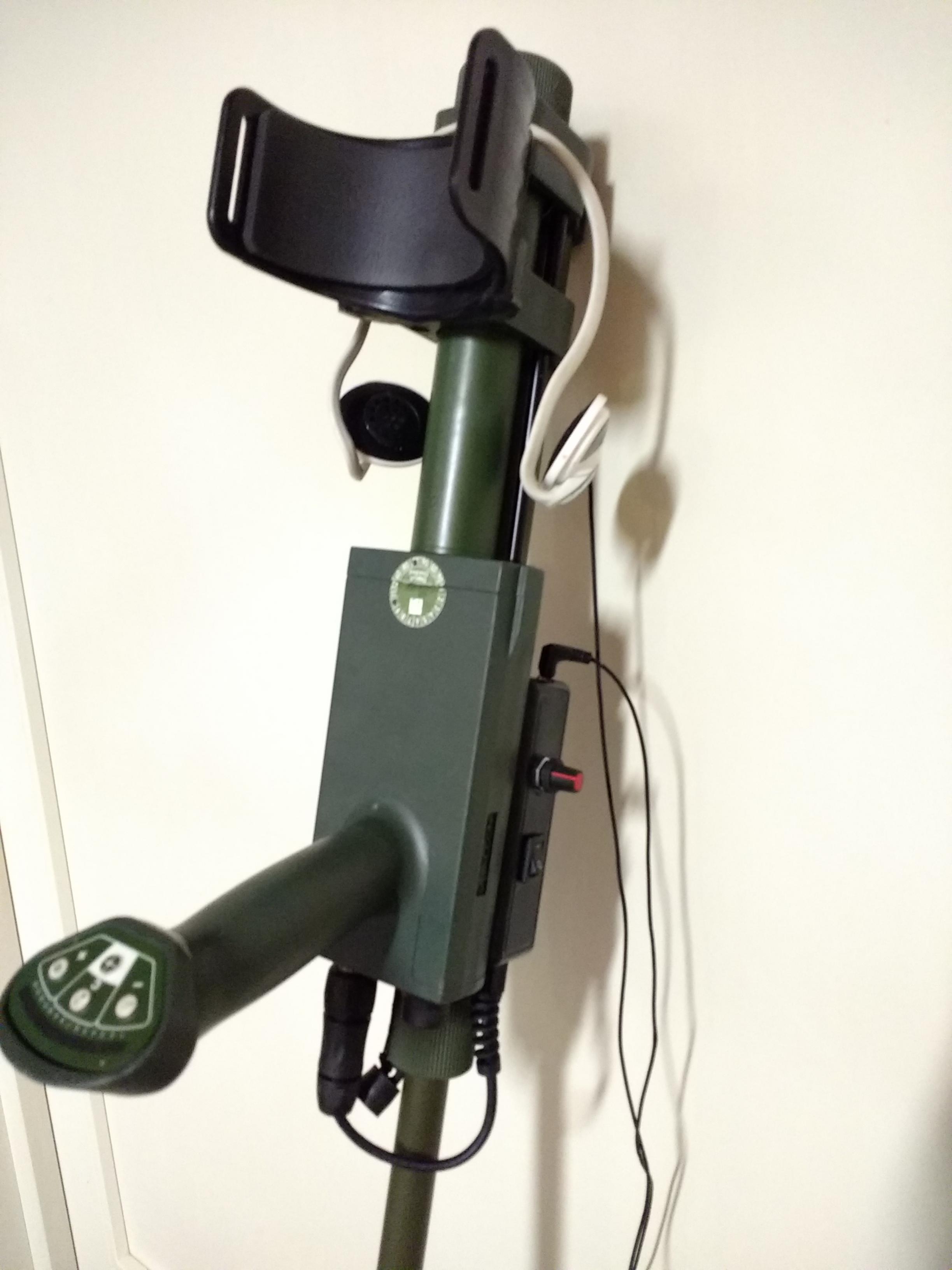

                      • Made a detector stand with part of the Garrett AT armcuff stand.
                        This way, it does not interfere with the travel of the armcuff:

                          Thank you so much for the info, I've been looking for ages for somethibg like this- I also have a gamma radiation meter with high impedance 'phones I wish to make an adaptor for.
                          I see two versions of the LT44:
                          Yellow coloured, Inputs: 20k Ohm, Outputs: 2 @ 1k Ohm
                          And
                          Blue coloured "This is the same as the one with the yellow tape but has the more usual blue winding tape and the untapped primary side has a higher d.c. resistance at about 1.08K. If you're looking for low internal resistances to minimise losses, you would prefer the yellow type.".
                          Can anyone point me in the correct direction?
                          Would the circuit be fairly universal in its application? (Ie, can I build two and use the second on the radiation meter which currently uses, what I assume, are piezo headphones)?
                          Thanks!
                          • The transformer I used for the VMH3CS mod was the yellow taped one:
                            • This is a link to the original audio mod done by Eric Foster:
                              This is the blue transformer.
                              I guess both can be used, but I am no expert on audio transformers.
                              Maybe someone with more knowledge about them can elaborate ...

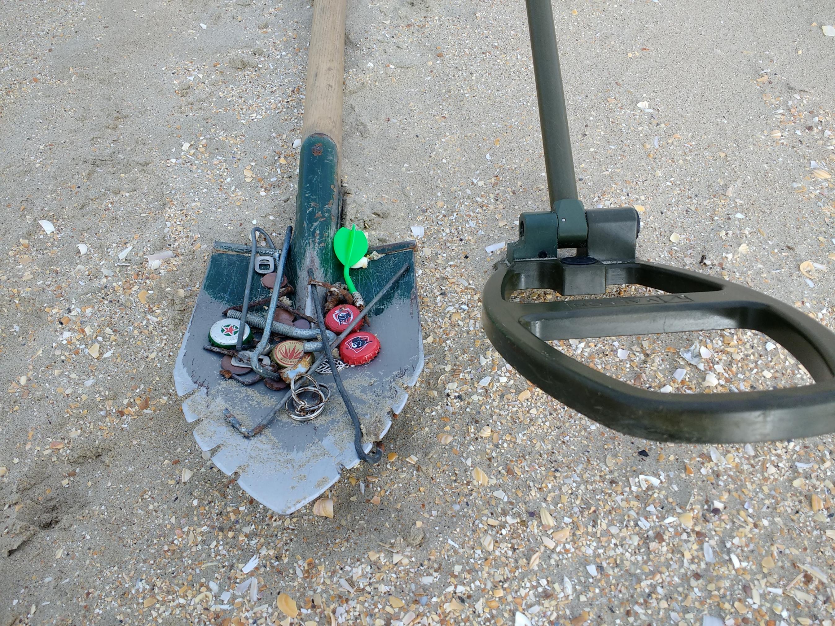

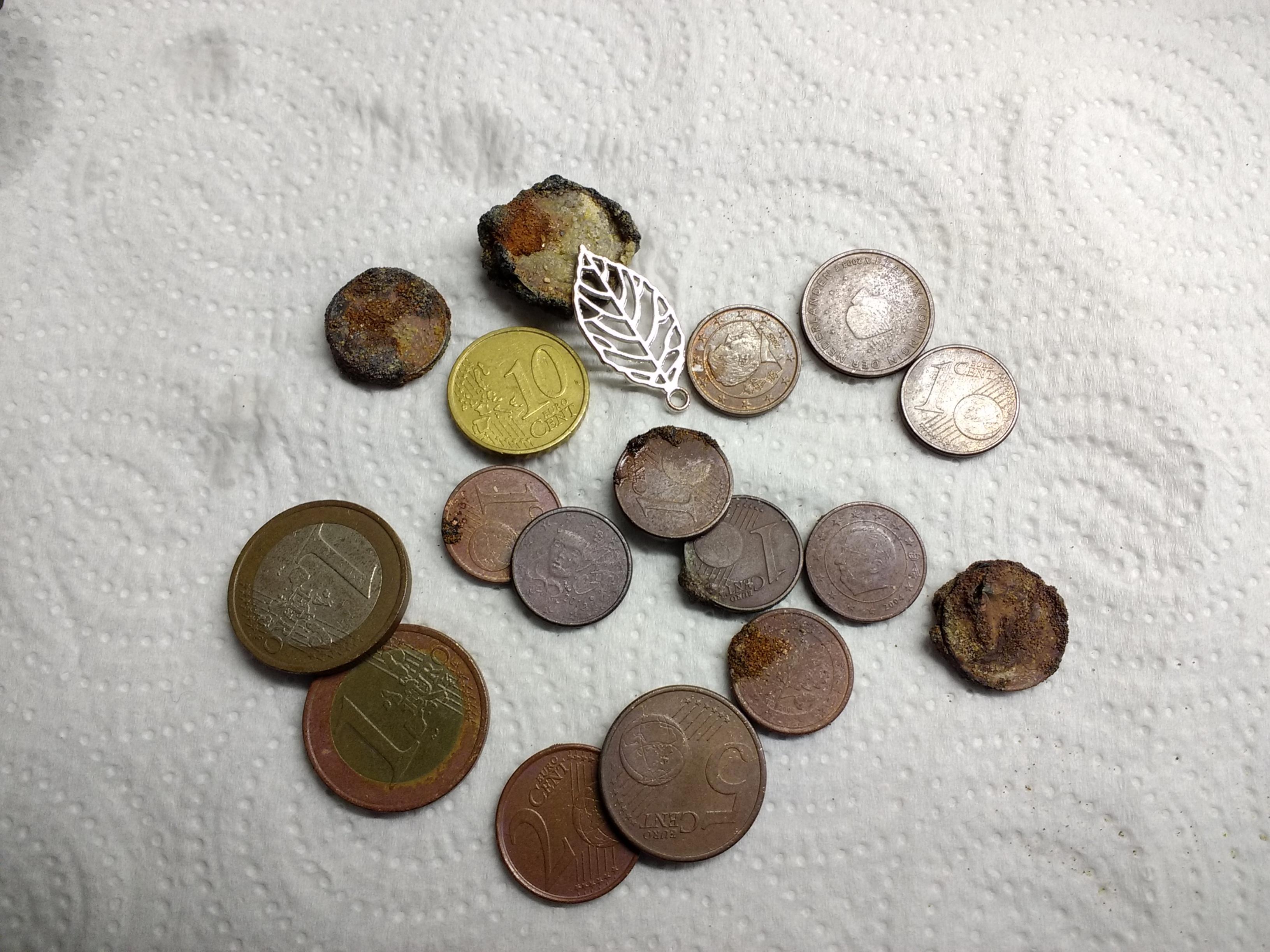

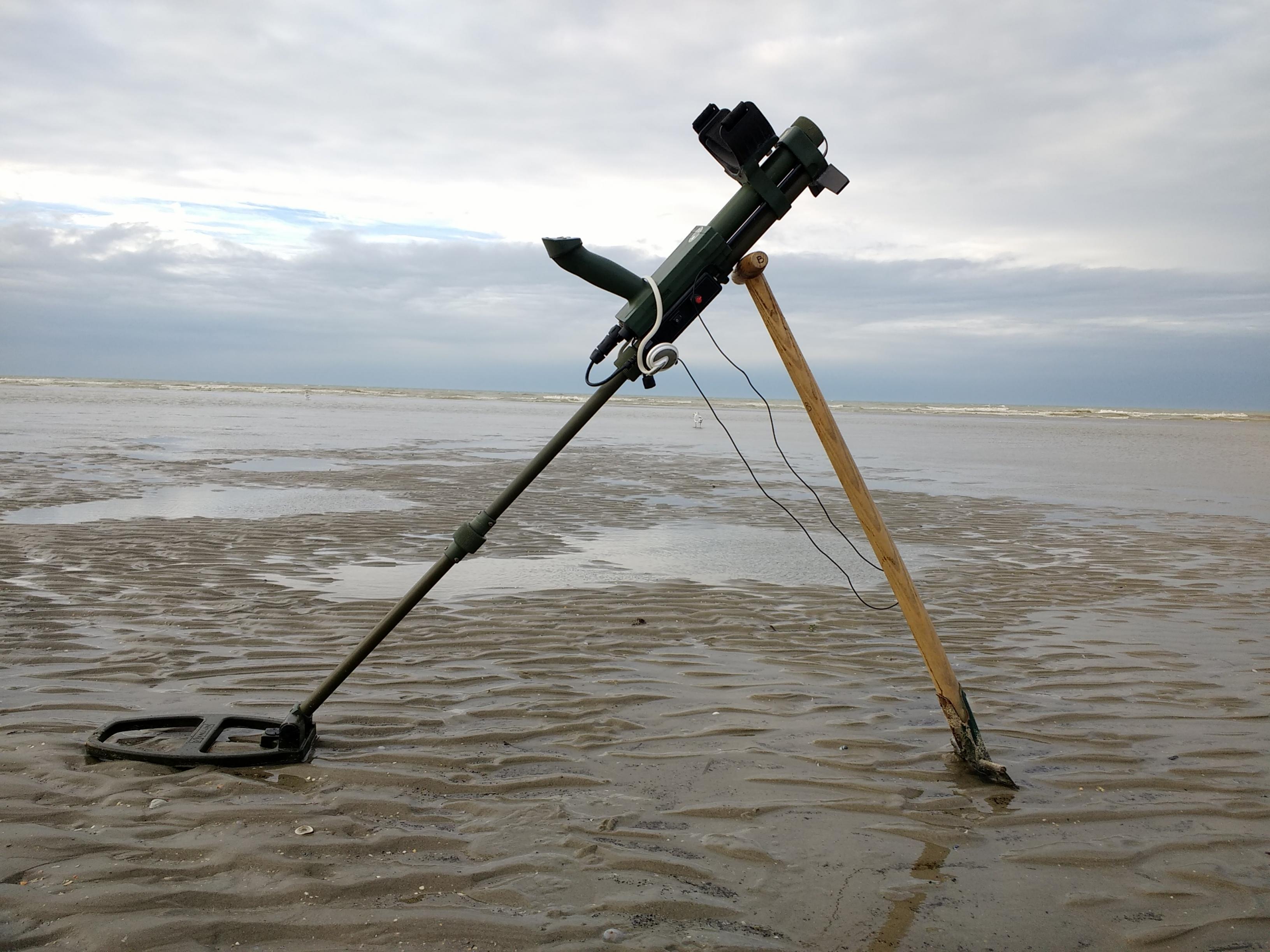

                              • 3 hours on the beach with the Vallon.
                                Normal mode, not mineral.
                                Wow! It picks up Everything !
