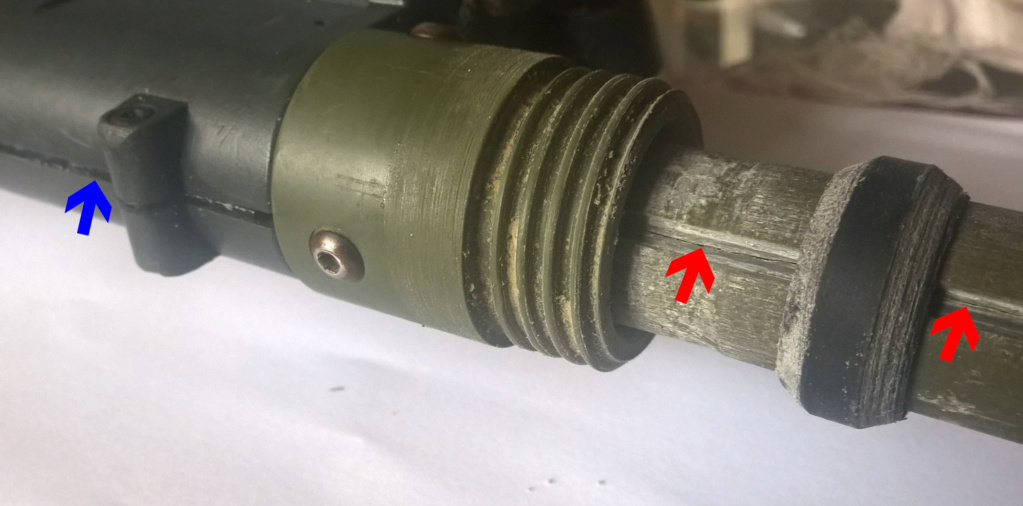

    • Hello to all VHM3CS enthusiasts. Long time no post.
      Two days ago, I succeeded in breaking the pin which prevent the upper telescopic shaft to rotate. Yes, I did it ! This detector survived
      Did any of you experience the same problem ? Do I really have to dismantle the whole machine, or is there a simpler way to solve the issue ?
      Best regards.
      Brinbrin
      • There is an image of the pin on post #1388 by Mr Foster. After a loser inspection, the top part of the telescopic stem is completely sanded out and shows a longitudinal crack. the seal ring is worn out. Not good. *** If anyone has spare parts (or even a whole dead machine), please make an offer. ***
        Can't believe I totalled this machine that had survived years of battlefield Looks like the sand on the beach of Boulogne-sur-Mer is harsher than Iraq's or Afghanistan's...I got it used, not in pristine condition, but way better than it looks now.

          I have quite a selection of mechanical parts for the VMH3CS but need to be clear on what you need. There is a metal pin in the housing for the male plug on the lower shaft to stop it rotating, but you mentioned the top part. This is prevented from rotating by a flat plastic part held by one of the bolts on the underside of the main housing. You mention a longitudinal crack. What is that in? The shaft? Is the seal ring the slotted tapered ring that grips the shaft when you tighten the collar? If you can photo the damaged or broken parts on your detector and attach them to a post, I will see what I have that may help. Eric.
          • Hello, Mr Foster.
            I guess the pin I need is the flat one located under the body and fastened by one of the three black bolts. I put a blue arrow on the picture.
            As for the crack, see by yourself on the picture (red arrows). This part is fibreglass and I can't see how this crack can have opened itself.
            Best regards,
            MC

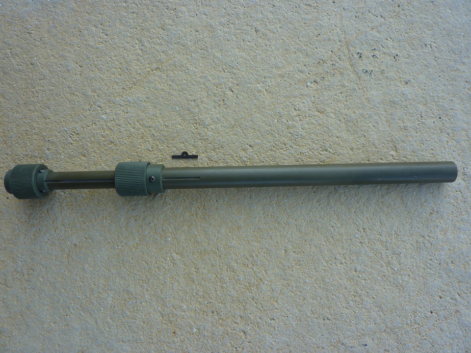

              Hi brinbrin,
              At last I find that I can answer on the Forum. I found that my reply contained 'auto-saved content' with pages and pages of data which locked up my system. I could not upload any pictures and it seemed to slow the whole Forum down to a snails pace. OK on everything else. This is why I have gone back to an earlier post of yours to test if it is working properly.
              Attached is a picture of a spare telescopic shaft I have available. They are impossible to separate, so you will have to change the whole thing. This one is in very good condition and comes with the T shaped pin to stop it rotating in the main box. In one of the detectors I bought, the inner shaft was jammed solid and the groove was cracked. The user had tried to rotate the shaft to free it, which sheared the T piece and cracked the inner groove, similar to yours. This inner shaft must never be rotated if it sticks. To prevent sand and water getting into the shaft, block the drain hole in the molding just below the battery cap. Wash the detector down after use, particularly where the shafts telescope.

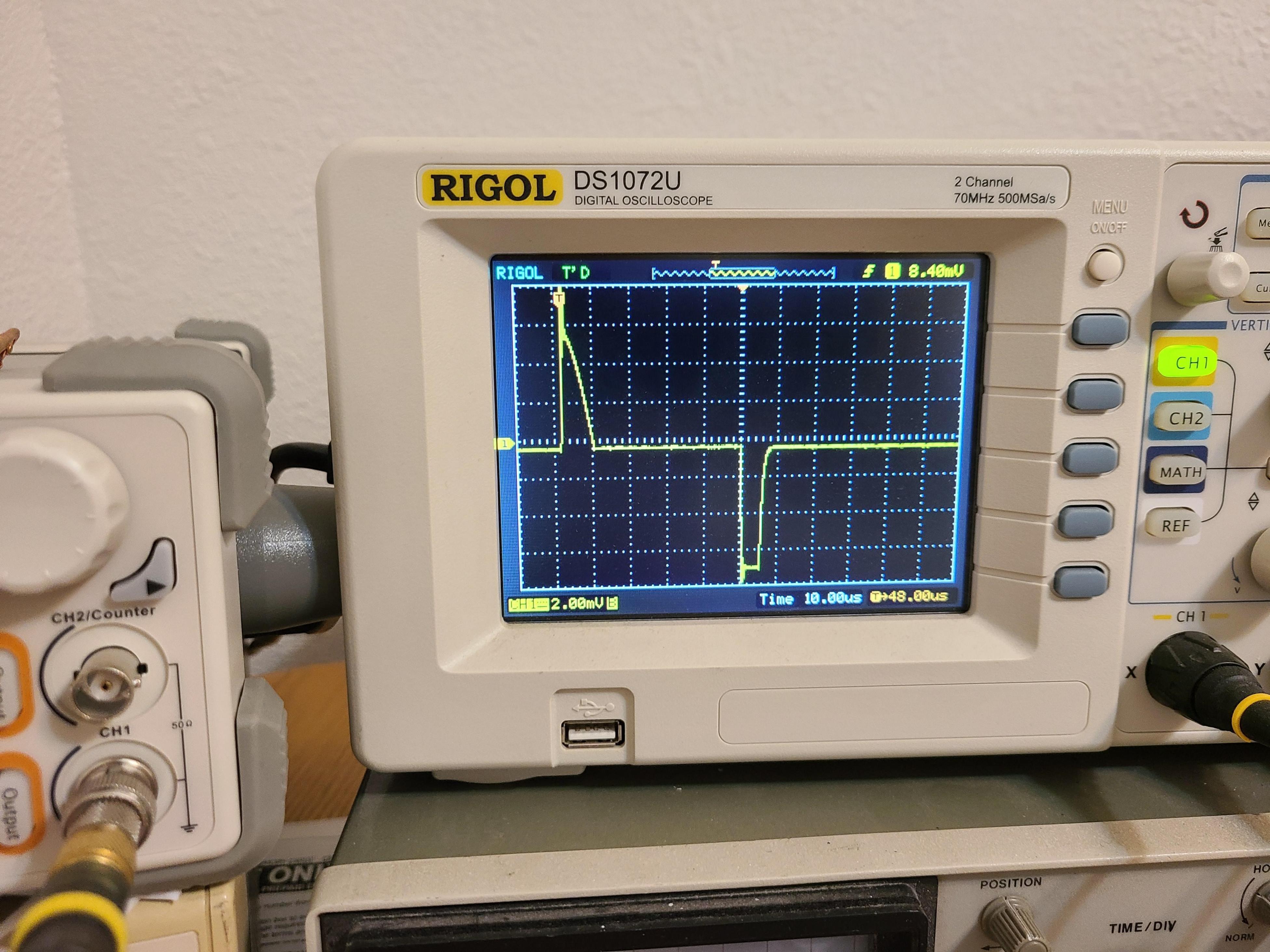

                          • HI ,
                            I know this thread is about the VMHS3 and sorry for posting about the gizmo here but this seems to be the source for vallon info. I thought the 3 and one would be the same as the only difference in the ability is UXO due to the changing of the coils on the VMHS 3.
                            But looking at the Tx on the gizmo they are different.
                            Here is the tx,

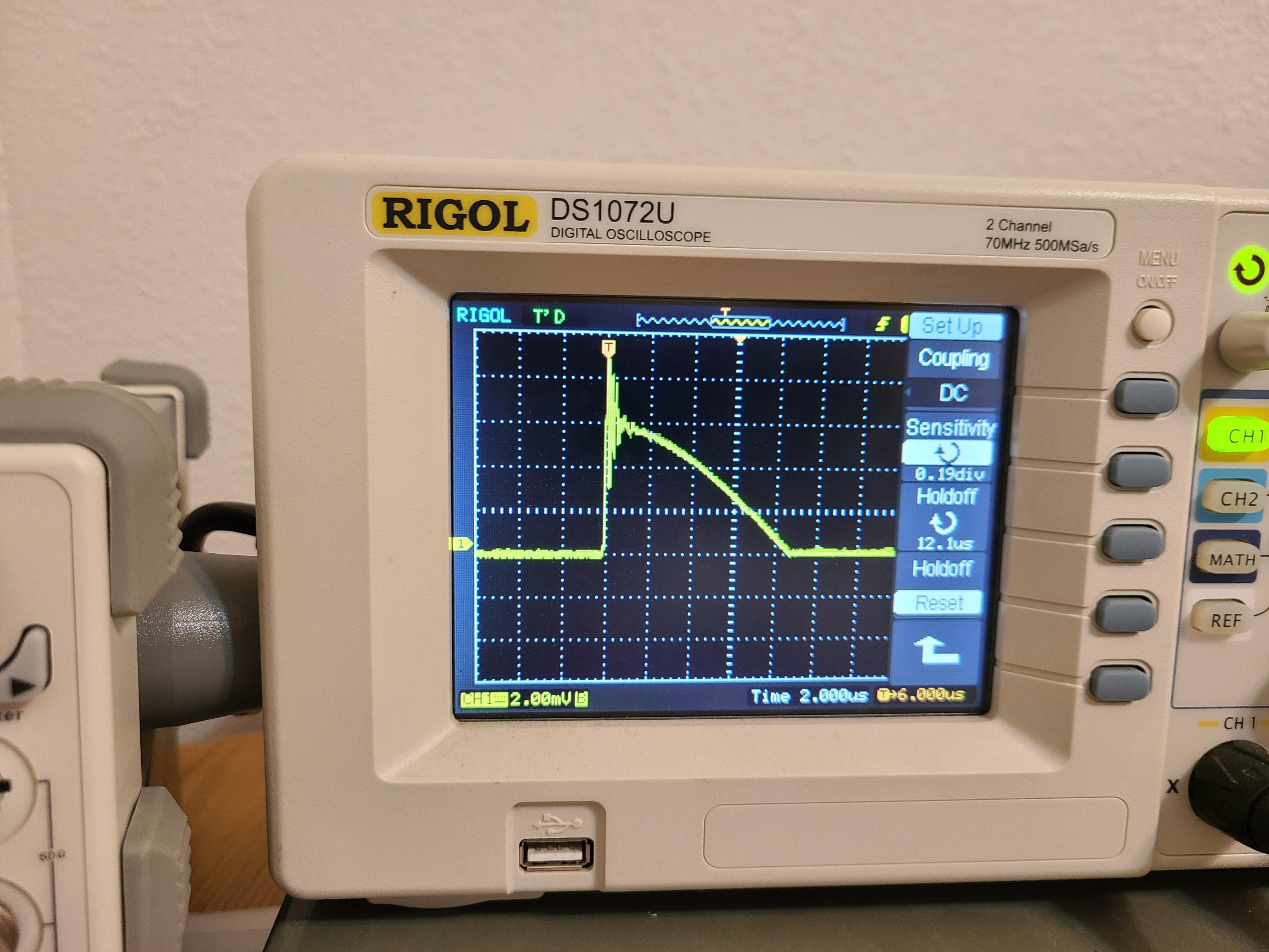

                            the Pulses are only 8 us wide and still 528 us between pulses.

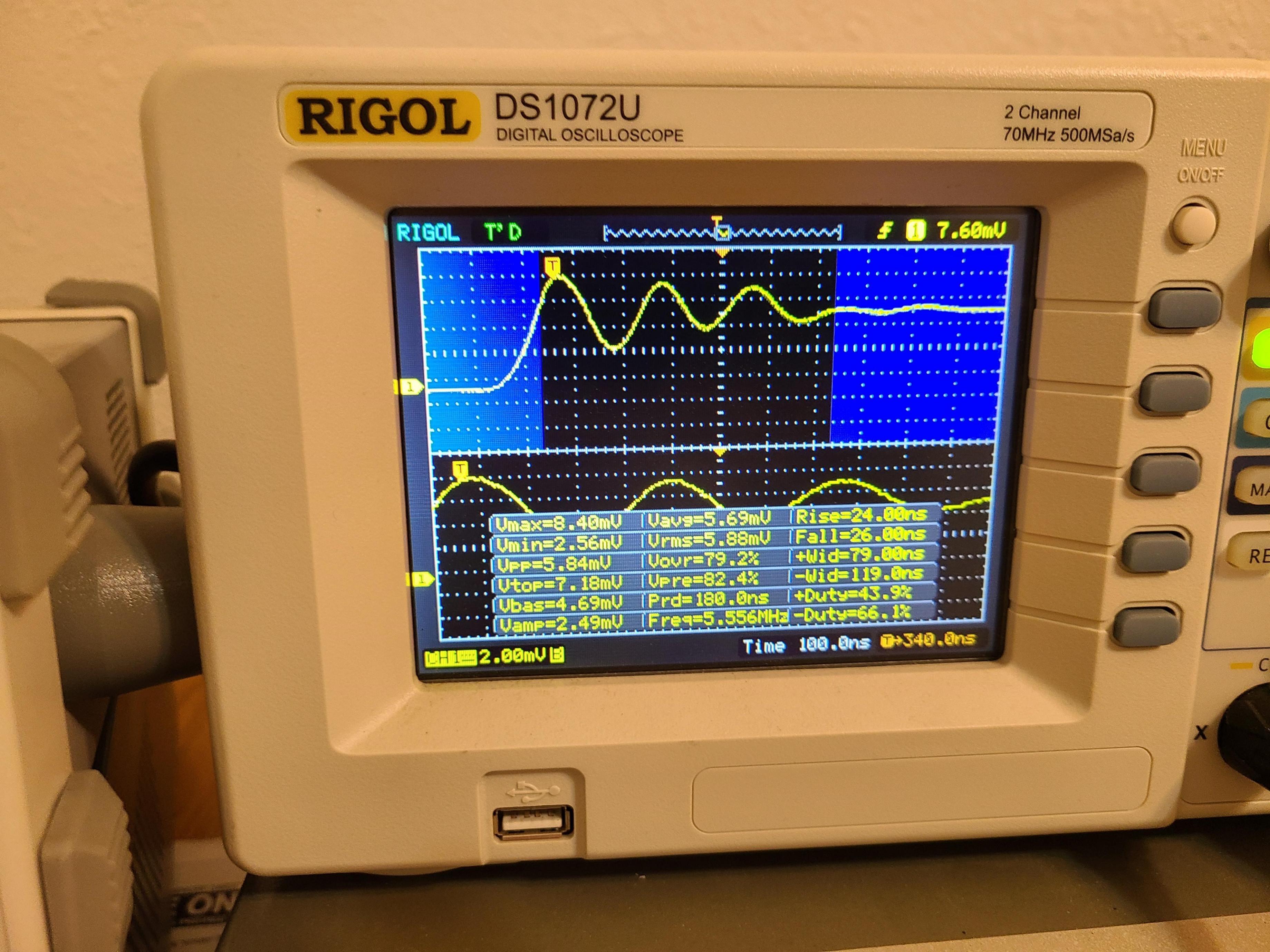

                            Im not sure if the ringing at turn on is my probe or the machine.
                            ringing
                            I tested the gizmo against my TDI pro on a nickel at 12 " and 1.2 at 6 gram Nugget on a hot rock strewn beach.
                            Both could get my targets but the gizmo could do it without being switched to mineral mode and Tdi had to be Ground balanced and backed off to 15us to avoid the hot rocks better.
                            I then hunted the vallon for a while its very deep and got gold first time out a small 14 k toe ring or your ladies ring weighing only 1 gram at 8 inches with a crisp clean signal.
                            If The V3 is better I have to have one and intend to pick up the first one I see.
                            Just wanted to share a positive comment on the gizmo and the wave forms so unless anyone is interested I will not dillute this thread any more.
                            Best Regards
                            Jim

                              • Hi godigit,
                                what are you connecting your scope to, to measure the above waveforms? I know that if I use a series resistor of 0.1 ohms to measure the current waveform, I get ringing at the beginning and end if I use a wirewound resistor, due to the small inductance it has.
                                To get a clean waveform, I use a thick film resistor. It is odd that the two waveforms are not identical in shape.
