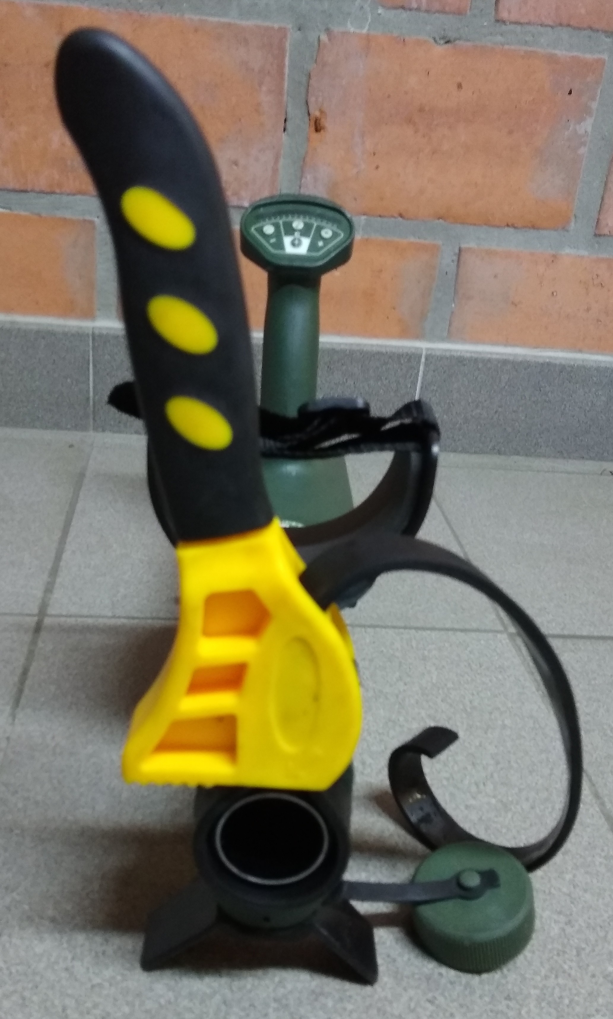

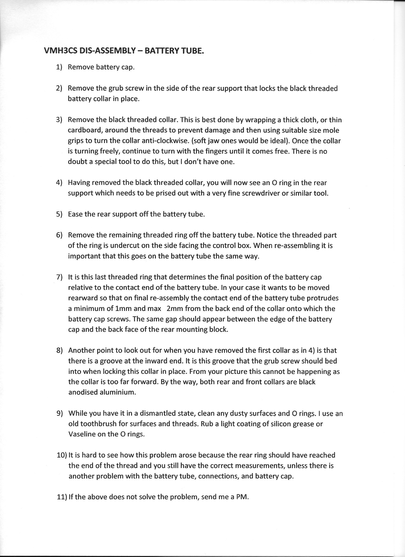

                              • Battery tube disassembly
                                I recently had to do the battery tube disassembly to add a screw to the armrest ( to prevent it from sliding ).
                                The procedure on how to do this is excellently described by Eric in this document:
Name:	battery tube positioning.jpg

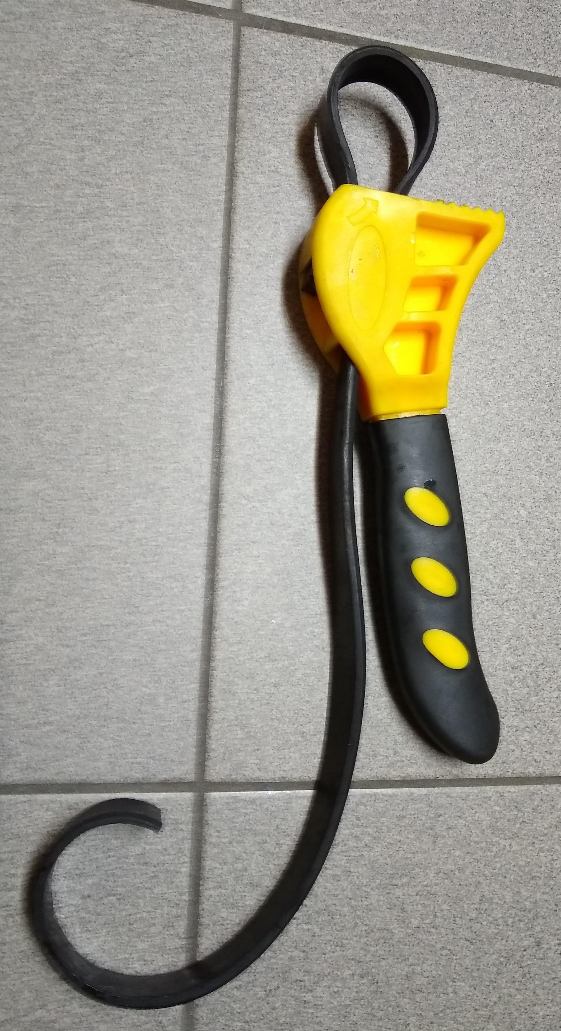

                                For step 3, to prevent damage to the threaded collar, I used a so called strap wrench.
                                I acquired this recently to do some threaded PVC pipe plumbing.
                                Just wanted to mention this because it worked perfectly.
                                Before this, I had never even heard of a strap wrench, so here are some pictures:
                                My apologies if this has been posted here already.
                                The 2 "wings" at the bottom of my detector are a detector stand to keep it upright and it is made from part of the bottom piece of the Garrett arm rest that I used to replace the original broken ears.
