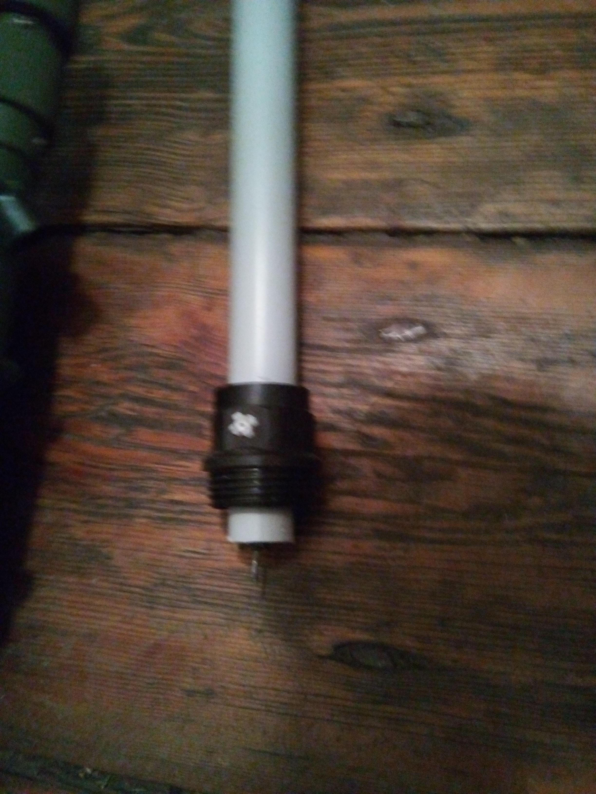

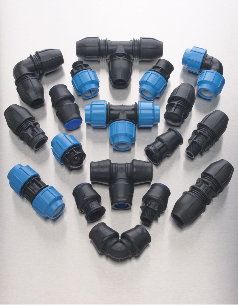

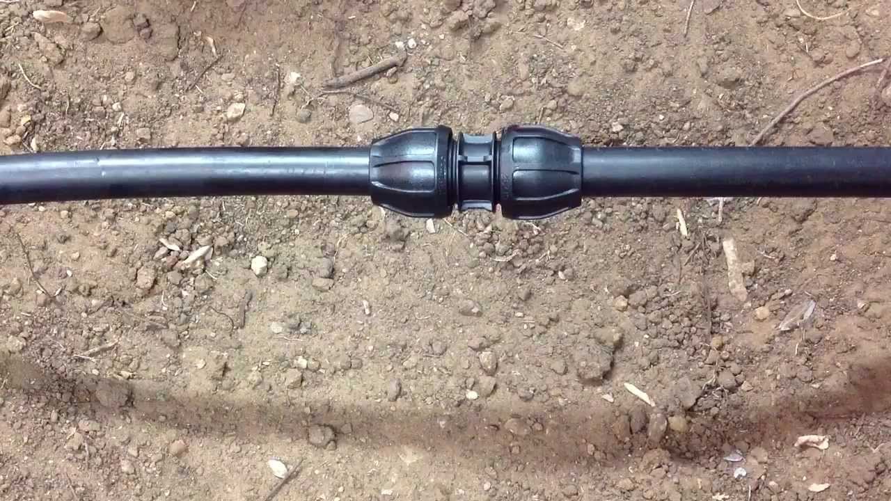

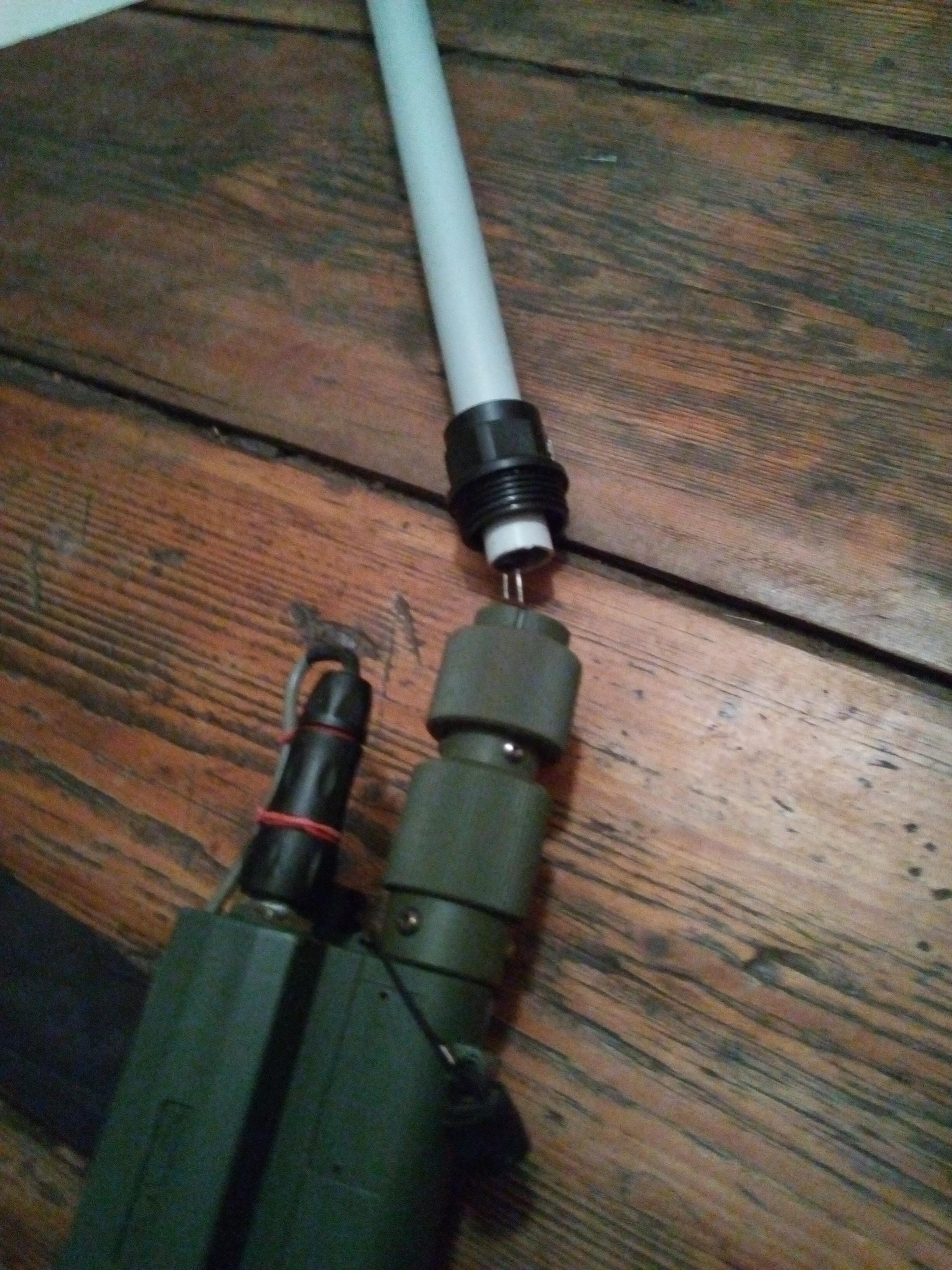

          • Hello,
            Just came from my field. I live in a small wooden manor all my summers. Manor was founded in 16th century. Before that there was a convent so cnalled "table manor". Village itself dates back to 7th century. Detecting on nearby fields with Vallon today with that small rectangular coil I made. made tests on different targets I found. Mostly nails, but found also small round brooch from 16th century and a button. Nails sounded all like described in manual, even small nail points. I use that PVC 25mm poly waterpipe pipe coupling and 25mm cable pipe where I insert 20mm cable pipe for connector shell. 20 pipe coupling fits inside Vallon connector. Make it right size and that it. It is pretty good idea to use inner shell as small probe with separate switch sounds interesting. Use PVC polypipe and drill out all obstacles with 25mm drill to fit..Click image for larger version

              • Hello Eric,
                I hope that my explanation on shaft construction was enough detailed. To fix PVC poly fitting to the shaft I used plastic cable holders 6mm with the cut head. Otherwise the pipe will slip. Please tell what would be your design idea on proposed dual coil on Vallon. Detector switched in between. Can it be done? Dont they detect each other?

                    I need to go to the local plumber's store to see if they have those fittings. If the parts don't solvent weld, I will use stainless steel screws which are undetectable.
                    Outer and inner coils need to have the same inductance and resistance. Switching and damping would best be done by a double pole, double throw switch with centre off. Centre off is needed so that the Vallon temporarily senses no coil, otherwise it goes berserk if switching directly from one coil to the other. Unused coil needs to have sufficient resistance switched across it to prevent ringing. There will be no coil interaction when this is done. I would put the switch and resistor in a small plastic box mounted on the lower shaft.
