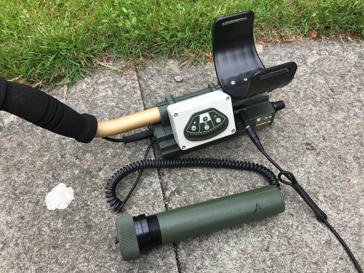

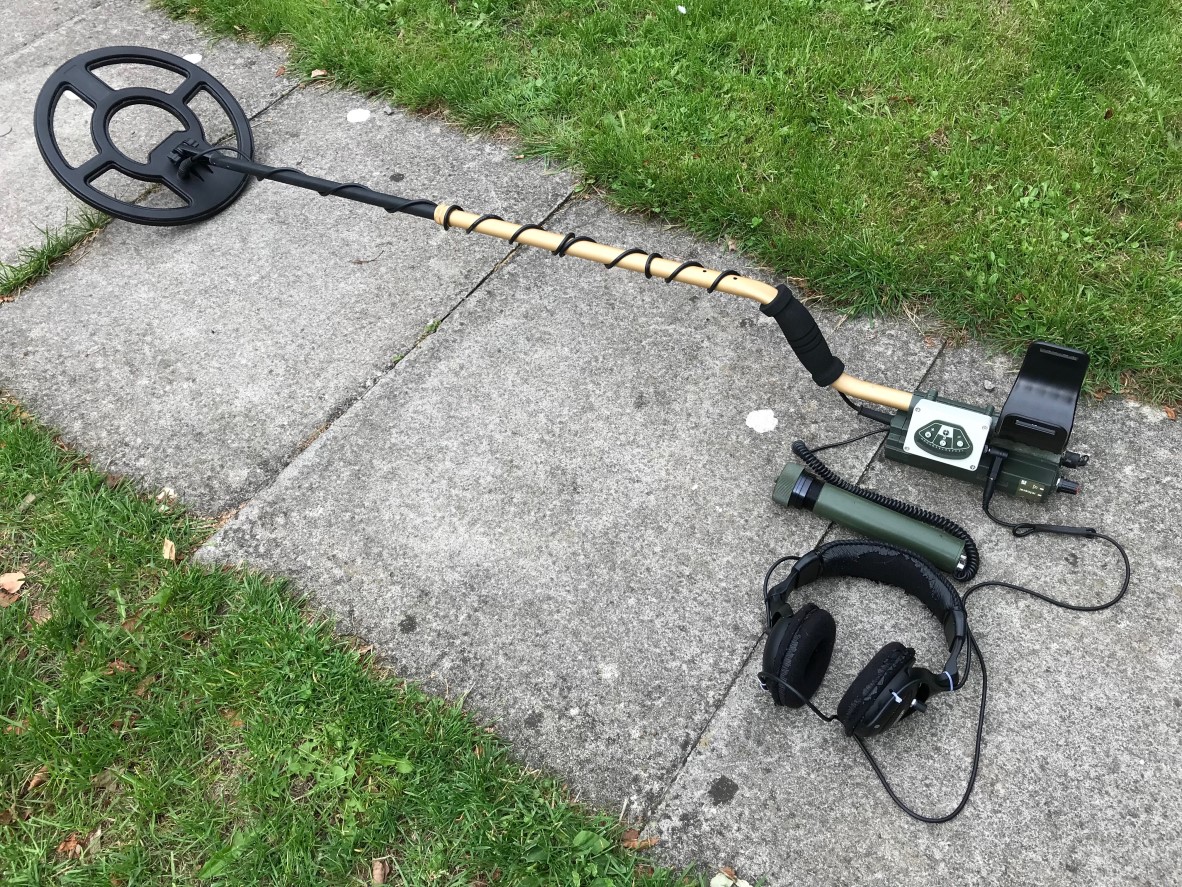

              • My Repackaged Vallon
                Here is my latest project, all working very well, used the shaft from an old Fisher 1210-X.
                Audio transformer is in the project box.
                Coil is temporarily sealed in place using a Whites coil cover using silicon sealant, will soon be testing her down the beach.
                Could anyone in the UK suggest a part number or make of Epoxy Resin I could use to permanently seal the coil up with? That's not using the coil cover, the epoxy would provide the bottom surface/finish of the whites former.
                Pete

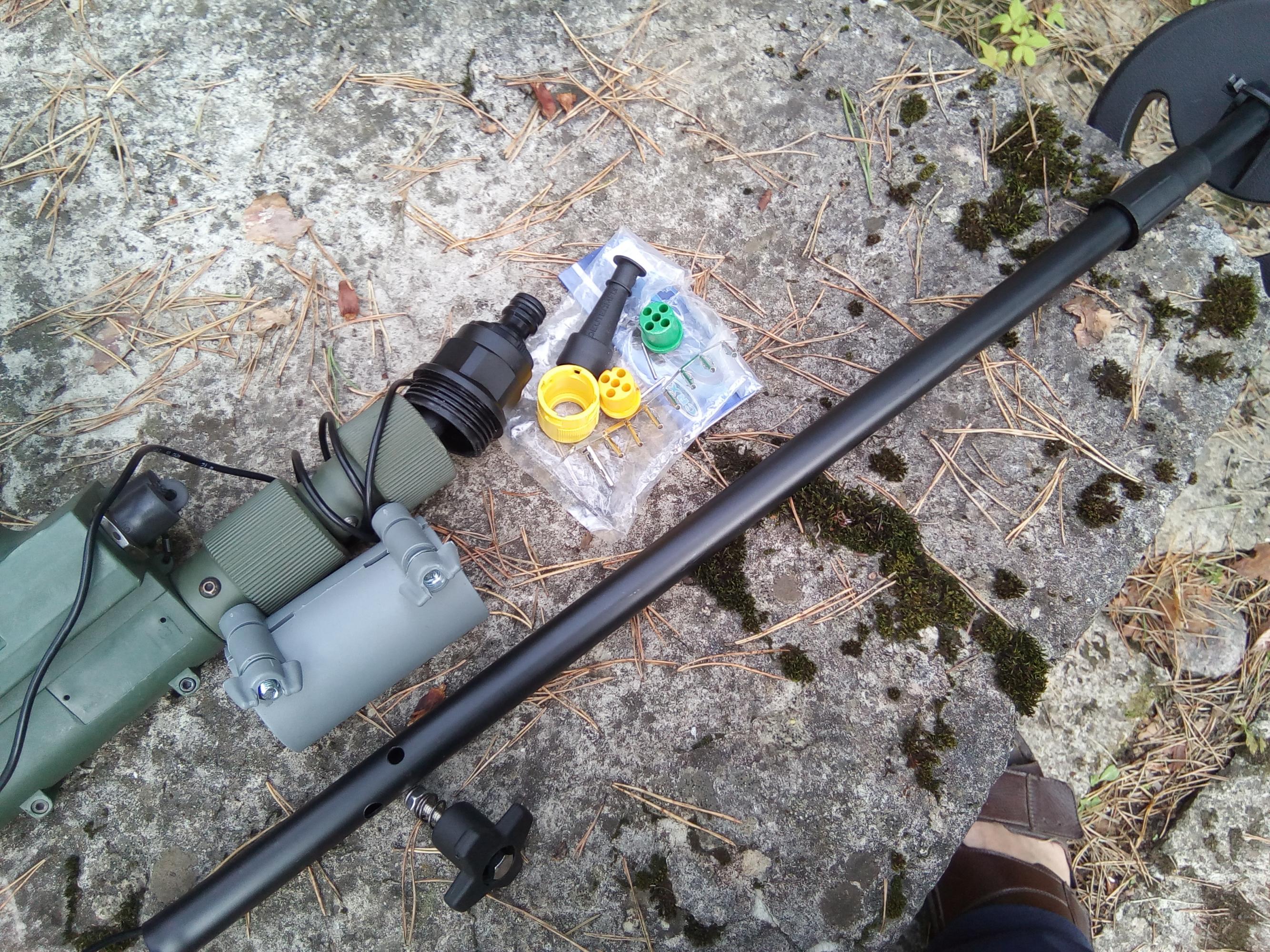

                        Hello!
                        Connector coupling for the coil and shaft i figured out. PVC 25 mm water pipe connector and garden water hose coupling. Threads accordingly 37mm and 2/3" two pin connector made from automobile electricity connector kit. For coil housing used Chinese kids detector. Whole project 50 euros including copper winding, coax and copper tape.And my prefered setup for detecting with Vallon using colour marker and VLF for disc. I work mostly at the archaeological field work.
                        BR
                        Mihkel
