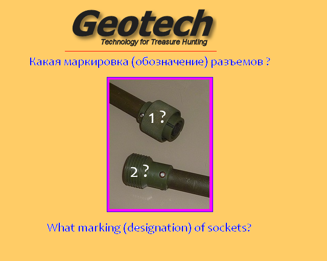

      • Privet Helo !
Name:	Vallon VMH3CS.PNG

            If you mean the electrical connections; the centre pin is to the live side of the coil, and all six outer pins are connected together and are coil and electronics ground via the coax braid.
            Eric.

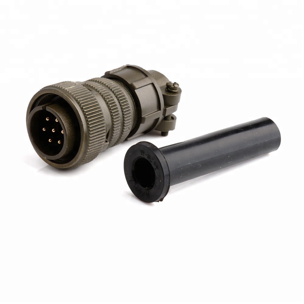

                Thank you Eric.
                I mean name/marking sockets !
                Which name 7pin bayonet military connector use Vallon ?
                https://www.alibaba.com/showroom/7pin-bayonet-connector.html
                https://www.alibaba.com/product-deta...474d48Pl47&s=p
                Thank you

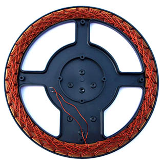

                          • Hey Mr.Foster
                            Could you do some tests of this kind of extreme low capacitance, parts of usec delay, hyper fast samplng basket coil with your VNH3CS MD ?
                            On the picture solid copper wire was used, but i think there should be used only multiple strands insulated litz wires. Also multi-layered dielectric waxed cardboard insulator should be used between two successive layers of coil and plastic housing. Mr Foster you have already done all impendance measurements of original VMH coil. so i think it woudn't be problem for you to test this type of coil. Also would be great if somebody could meassure big diameter Vallone coil fro 3CS.
                            Thanks in advance. If any case i want to hear your oppinion about.
                            ps: Please check your forum's e-mail.
                            Thank you !

                              This looks to be a super low capacitance coil, but I am sure that it would not show any improvement over the solid wire that Vallon used. The reason being that the Vallon electronics works in a rather different way to that of a conventional PI. Looking at JLKing's posts will give clues to some of the reasons, but a couple of important technical points are that nothing can be changed, except by Vallon, in the electronics to take advantage of a superfast coil. The performance they already get from a coil with a low resonant frequency and a lot of capacitance from a long retractable curly cable is quite surprising. I have tried stranded wire with Teflon insulation for a Vallon coil, and which works fine, but it is no better in performance than one made with the solid wire.
                              Eric.

                                Thank you Eric. You are the best here.
                                Take care and good luck !
