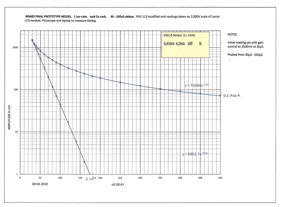

Here is the confirmation on a log/Lin graph with the 1 Lev giving the expected exponential decay and the ironstone power law decay.Originally posted by waltr View PostYes, good work and I enjoy reading all posts by you guys.
The curves Eric posted are expected. The three metal target look to be Exp^(-t/Tau) whereas the Ironstone looks to be -1/t.
If plotted on a Log/Lin and log/log graph this should be obvious.
Very interesting that even this Vallon detector has a GB hole.
Eric.
I see the 1 lev has a TC about 19.5us. I have a 1963 20 centimes francaise with a TC about 17.5us that falls almost to the bottom of the hole with my detector with the time settings I used.Originally posted by Ferric Toes View PostHere is the confirmation on a log/Lin graph with the 1 Lev giving the expected exponential decay and the ironstone power law decay.
Eric.

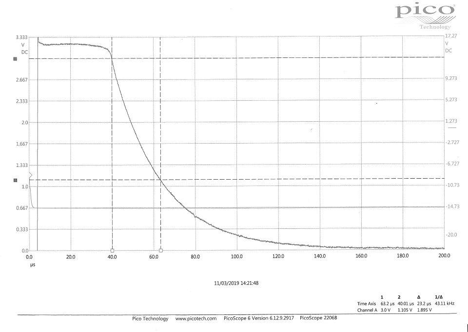

I measured the TC of the 1 Lev by the method in post 223 in the 'target response tester' thread. I get 23.2uS, which is not far removed from your 19.5uS. My measuring window was between 40 and 63uS where signal/noise ratio is still very good 3.0V and 1.1V.Originally posted by green View PostI see the 1 lev has a TC about 19.5us. I have a 1963 20 centimes francaise with a TC about 17.5us that falls almost to the bottom of the hole with my detector with the time settings I used.
The detection ranges I get with the VMH3CS and stock coil are 14" (35.5cm) in Normal and 7" (17.8cm) in Mineral. Mineral being balanced on Australian ironstone. My 11.5" circular coil does better at 16" (40.6cm) and 10.5" (26.7cm). All measurements are for 2 LEDs lighting consistently. I'm not sure why the 11.5" coil does better in the Mineral mode, but it definitely seems to.
With this Vallon the coin is in the hole but not at the bottom. With a TDi detector, I once filed a piece of lead so that it was not detectable in the GB setting for ironstone. However during testing it slowly started to react, which I found was due to the slight heating caused by my fingers holding it. The hole, or notch, must be quite narrow.
Eric.

-by raising the target temperature its conductivity decreases. This causes the decrease of the time constant of the target . And respectively to emergence from the bottom of the hole GEB .
You got it! It also happens with non-conductive ironstone resulting in noisier ground on a hot sunny day. Stones on the surface heat up while those underneath stay cool. This temperature difference give a small shift in decay rates between those in the sun and the shaded ones. Best times to search are at night or after a rainstorm when temperatures even out and ground noise is quieter.Originally posted by Riss View PostTo leave the jokes . My compliments
Eric.

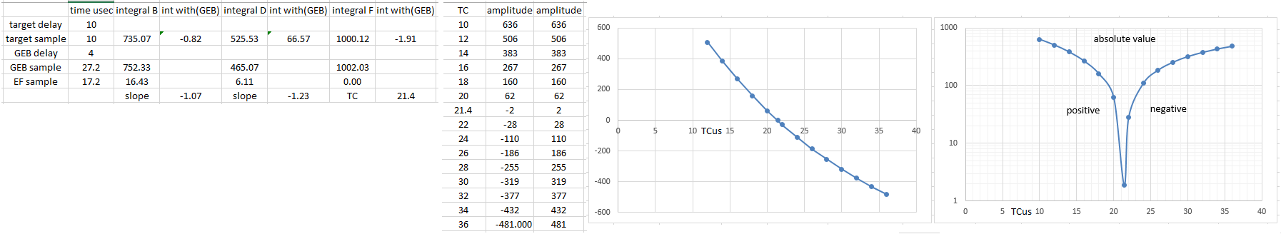

I have a Excel program that simulates a PI with GEB. Charted TC vs amplitude for different TC targets. Data on left is output from simulator. Ground with a -1.07 slope was balanced by adjusting GEB sample time until integrator out with GEB on was near zero. First column is PI timing with 1000samples/second. Second column is integrator out with GEB off, third column is integrator out with GEB on(slope=-1.07). Last two columns are the target, GEB off and on. GEB off amplitude was adjusted for 1000 for each TC. GEB on is reading when GEB off is 1000. The hole is quite narrow at the bottom. Different timings and ground slope could or would effect hole shape.Originally posted by Ferric Toes View PostI measured the TC of the 1 Lev by the method in post 223 in the 'target response tester' thread. I get 23.2uS, which is not far removed from your 19.5uS. My measuring window was between 40 and 63uS where signal/noise ratio is still very good 3.0V and 1.1V.

I have noticed that there are several alloys which behave in similar way in mineral and normal mode. So in my opinion this GB hole in case of Vallon is quite wide. Fortunately old bronze and most hammered coins will not fall into it.Originally posted by green View PostI have a Excel program that simulates a PI with GEB. Charted TC vs amplitude for different TC targets. Data on left is output from simulator. Ground with a -1.07 slope was balanced by adjusting GEB sample time until integrator out with GEB on was near zero. First column is PI timing with 1000samples/second. Second column is integrator out with GEB off, third column is integrator out with GEB on(slope=-1.07). Last two columns are the target, GEB off and on. GEB off amplitude was adjusted for 1000 for each TC. GEB on is reading when GEB off is 1000. The hole is quite narrow at the bottom. Different timings and ground slope could or would effect hole shape.

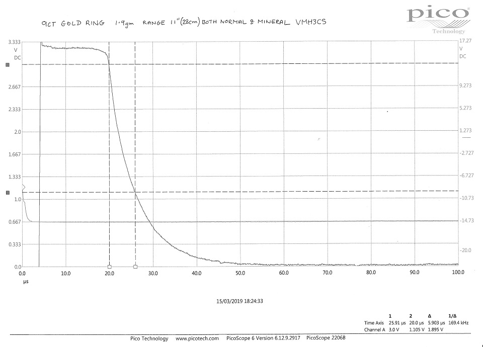

My grandaughter has a small 9 carat gold ring with 4 red stones with a total weight of 1.9gm and diameter 18mm. I checked the detection range on VMH3CS with both the Normal and Mineral settings. The Mineral setting was GB'd with a lump of Australian ironstone the same as with the tests on the 1 Lev coin. The range was the same in both settings at 11" (28cm), so there was no loss with this target. The TC of the ring was measured at 5.9uS.
Eric.
Interesting that you don't loose any detection depth. Wouldn't expect much signal lose in mineral setting with the ring. I loose a little when not in the hole because of noise increase with GEB on. Maybe Vallon doing something different?Originally posted by Ferric Toes View PostMy grandaughter has a small 9 carat gold ring with 4 red stones with a total weight of 1.9gm and diameter 18mm. I checked the detection range on VMH3CS with both the Normal and Mineral settings. The Mineral setting was GB'd with a lump of Australian ironstone the same as with the tests on the 1 Lev coin. The range was the same in both settings at 11" (28cm), so there was no loss with this target. The TC of the ring was measured at 5.9uS.
