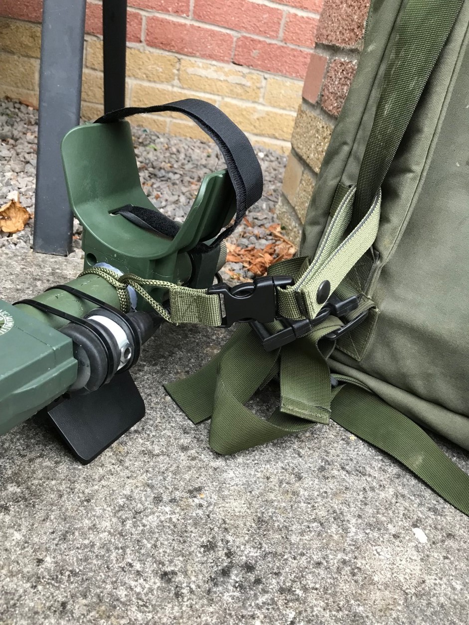

                  • i have that strap fitted to mine, the parachord end loops around black metal bar under the arm rest and the webbing loop fits onto backpack padded shoulder straps, there are lengths of webbing sewn onto front of the padded straps, the webbing end loops around these, then simply press quick detatch and the detector can unclipped, will try to post a pick of my vallon with it being used.

                    • to clarify, the detector strap uses the backpack shoulder straps as a kind of harness, can be adjusted for length with the webbing buckle on strap, it a fantastic addition, just kind of swing your hips a bit and your arms dont need to do any work,
                        Yes your dead right and its very comfortable! I am going to try that next time I am down the beach...Cheers horus1970
