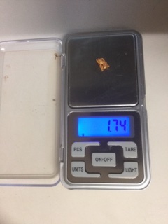

                              • My largest nugget to date 1.74g. Found with the 7000 in some colluvial wash....Annoyed because it was literally 1cm under the top soil....If I had of been using the Vallon it would have screamed on it!! Its a new spot that my research identified.. There are quite a lot of broken branches and leaf litter....Planning to take the Vallon after exploring with the 7000 to use the neat Vallon coil to get in and under where the 7000 wont fit Click image for larger version
