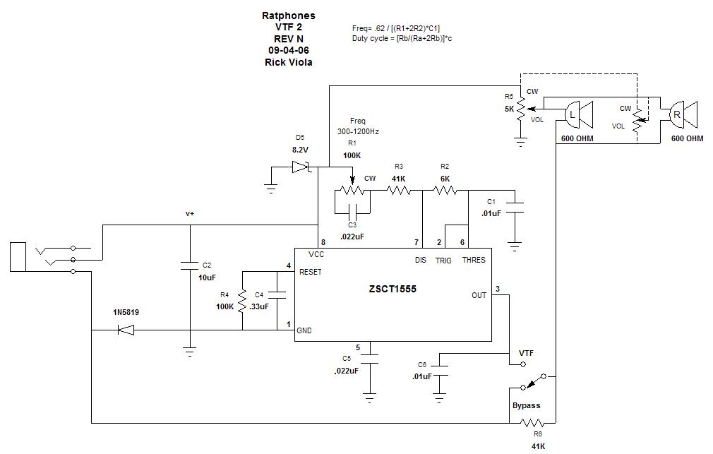

      • A long time ago. There were frequency changing headphones marketed as "Rat Phones". When the inventor went out of business he posted the schematic. It uses a cmos 555 timer and is self powered by the audio signal. I never built it but this may be perfect for the Vallon.

          Thanks for that: it looks very interesting and easy to knock up and try.
          Looking at the output of the stepdown transformer I use to drive standard phones, I get a rectangular pulse of 2V amplitude which goes up to 3.5kHz on full signal. Personally, I think a max of 1.5kHz is high enough.
          Eric.

              He used to post on this forum, don't remember his forum name. Another innovation on the Rat Phones was the interchangeable cable. Which is what usually fails in headphones.
              After posting the above schematic, I recalled that the tone shifting headphones are different than what you have and may have been an experiment which were never marketed? Those 600ohm speakers are rare these days.

                  It will be interesting to try. I built a similar circuit using just the VCO portion of a CMOS 4046 PLL with a low pass filter from audio signal input to VCO input and it worked OK except for 2 things, it inverted the frequency response and also produced an elongated tone of the confidence beep to a point where it was way too distracting. I set it aside to look at again at some stage.
                  Maybe this little circuit will work better, hope so.

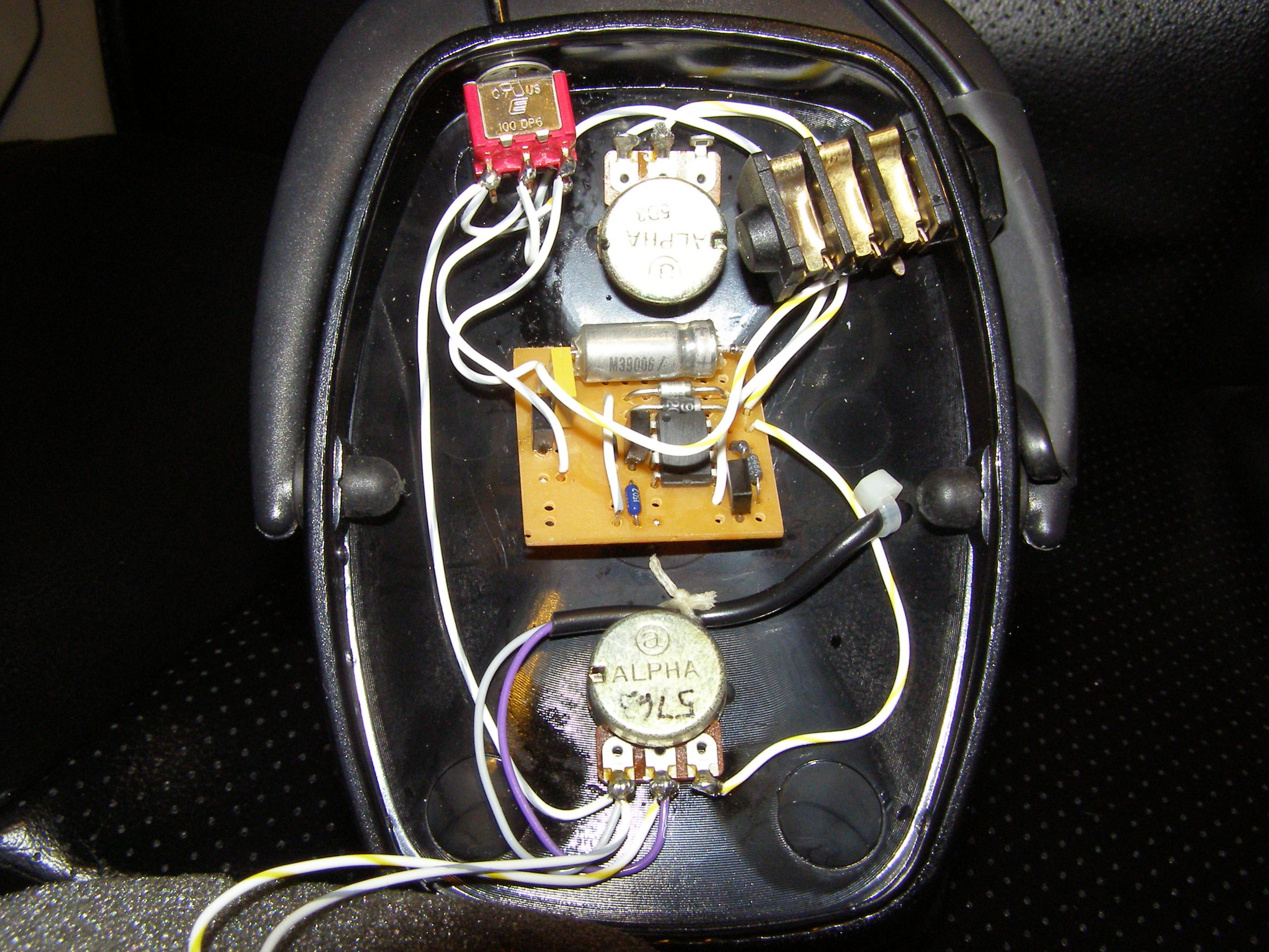

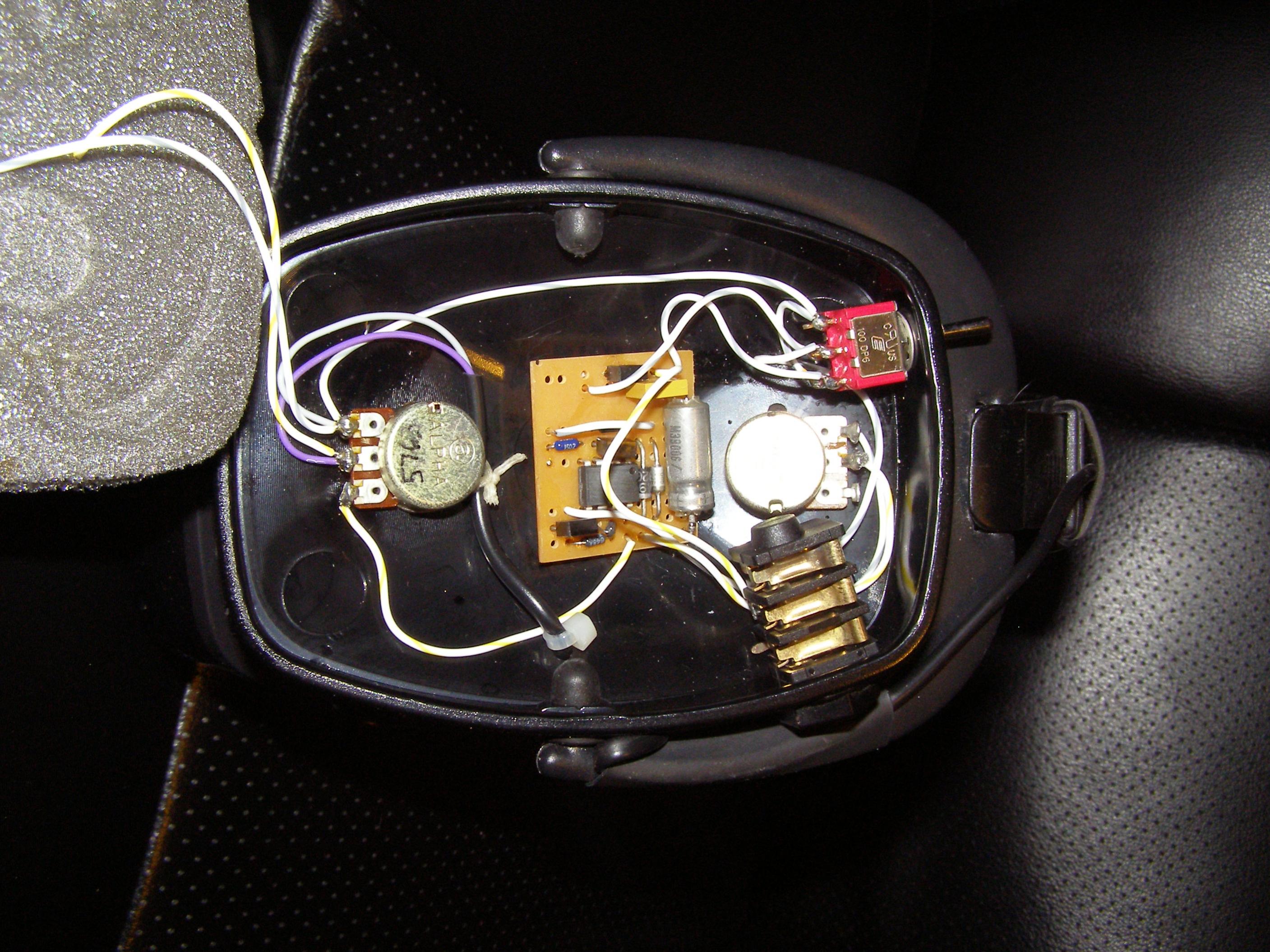

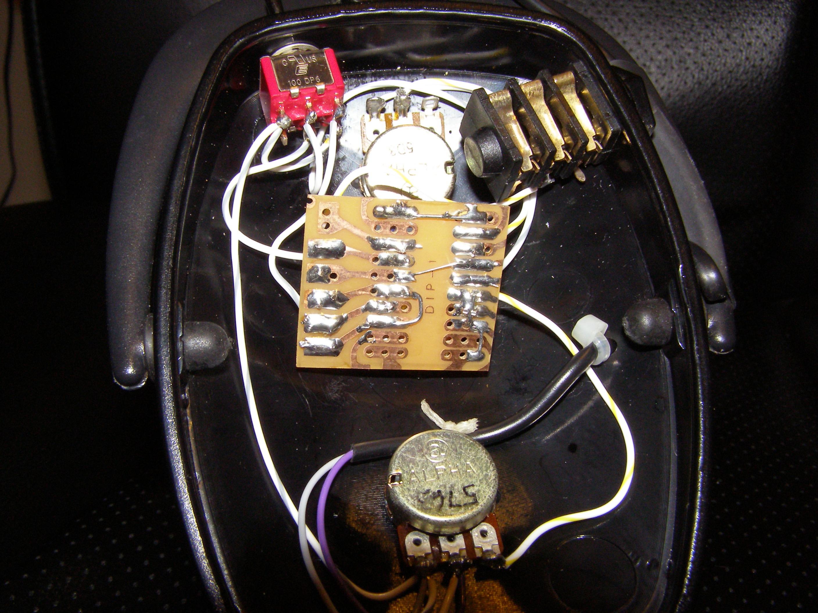

                  • Here's some photos from my archive:
                    • Thanks for posting the photos. The more I think about this circuit the less I believe it will work with a vco as an input. It is probably just a self powered gated oscillator. Which would work good on coin machines like Tesoros or a Garrett Ace250. Better to follow Eric's original idea of using a divider. Maybe a cmos flip flop to divide the audio by two and if possible power it by the signal?
