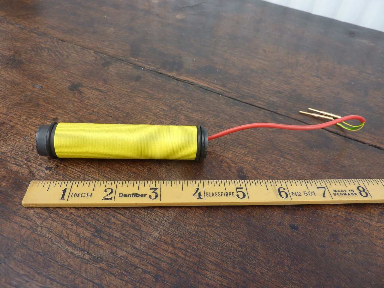

                            Hi Chet,
                            All of the rods that worked for me are MnZn type so I think you could discount type 61. That leaves 33 and 77; however, 78 looks interesting for higher power projects.
                            The first rod that I used was FX1040 and was 3/4in diameter and maybe 8in long, but I can't find any data on that now. I seem to remember using F4 ferrite when I used Neosid UK rods. That is what I have most of now, but in 3in x 1/2in size. I did find a 6in rod and a 4in x 3/4in one which I am going to wind and compare performance. Also to try are 2 x 3in x 1/2in superglued together and also adhesive heat shrink sleeve over the two rods. Past experience has shown that the slightest movement, or crack, that develops, makes the probe useless.
                            My various rods measure 10k ohms up to nearly a Megohm. The ones I know work are nearer the lower end of the resistance range.
                            I have also successfully used pot core halves as PI sensors, usually for industrial use when you want the detection field to be only on one face of the coil.
                            I'll report more when I have done more tests.
                            Eric.

                              • 4in x 3/4in probe core test.
                                For the first test I wound the 4in x 3/4in rod with as many turns as I could get on and achieved 1.8mH straight off. Resistance was 3.5 ohms so, we are in the right ballpark straight away. I left off the outer shielding at this stage, but had the core grounded with a drain wire running its length. Plugged it into the shaft connector of the Vallon so that it had all the cable capacitance and additional resistance. It ran through all the startup checks and the detector settled down with no problem. The difference I noticed was that it seemed quieter than the other probes I have made. My home workshop is quite noisy electrically, much of it from surrounding shops and light industry. I'll have to check it out away from the premises to be sure, but I definitely gained a couple of inches on a nickel. 10in instead of 8in. Over the weekend I will add the outer shielding and house it in a spare Vallon shaft tube; which happens to be just the right diameter. Click image for larger version
                                Eric.
