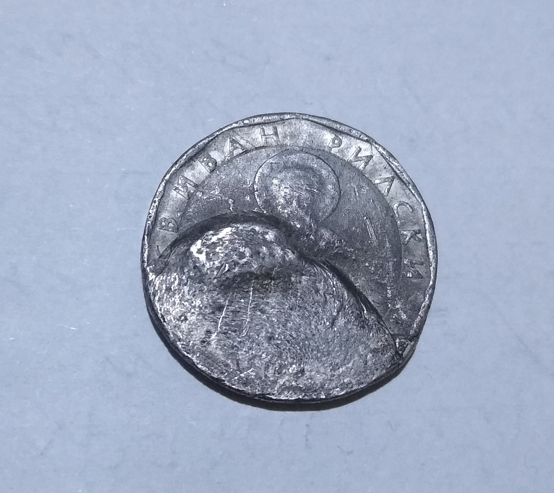

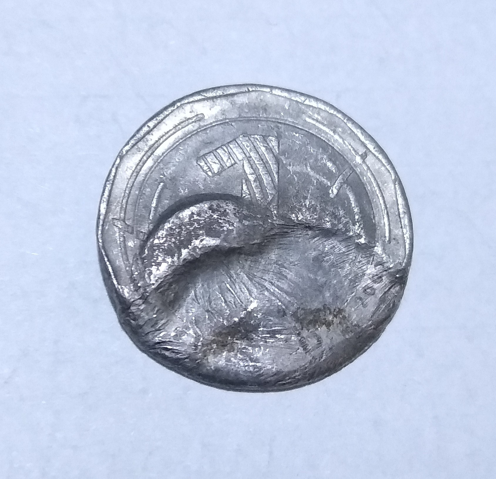

              Hi Green, That is a possibility and I have the coin now and will test it tomorrow. I will also plot its decay curve and see if it comes close to that of iron mineralised rock. Luckily, I haven't packed my tester away yet, prior to moving.

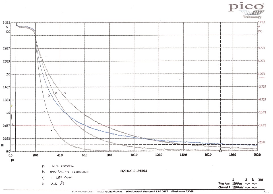

                    • Yes, Green was correct. The loss in range is due to the GB 'hole' in the response. In the attached plot, B (blue trace) is Australian ironstone. This will have a similar decay to earthenware pottery, volcanic basalt, iron mineralised soil, etc,etc. The only major difference will be the amplitude. For convenience all amplitudes were set at 20uS to the same starting level. One can see that the Lev (curve C) is close to the ironstone decay and at one point crosses it. If GB sampling was taken here then the 1 Lev coin would not be detected at any range. I have no information about the method of GB used in the VMH3CS or the timing of GB and signal samples, so cannot comment further.
                      For comparison, curve A is a US Nickel and D is a UK 1 pound, which has a similar construction to the Lev except the diameter is slightly smaller but thickness is a bit greater. For objects such as A and D whose amplitudes, either positive or negative which are well clear of the ironstone trace will not suffer significant loss in range. Previously I had not noticed a 'hole' in the Vallon's performance and that must be the reason for the severe loss in range on the 1 Lev coin. Perhaps Riss will test other more, or less, conductive coins to compare performance. Note that the ironstone decay starts fast, but slows down with time so that even at 200uS the signal level still has not reached the zero. I will measure the actual detection ranges in 'normal' and 'mineral' for the 1 Lev in due course. Thanks to Riss for bringing this matter up, and Green for his post, as otherwise I might never have come across the hole in the response. .Click image for larger version

                      PS the 1 pound coin should be trace D, not a second B.

                          The curves Eric posted are expected. The three metal target look to be Exp^(-t/Tau) whereas the Ironstone looks to be -1/t.
                          If plotted on a Log/Lin and log/log graph this should be obvious.
                          Very interesting that even this Vallon detector has a GB hole.
