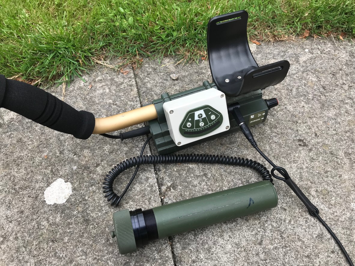

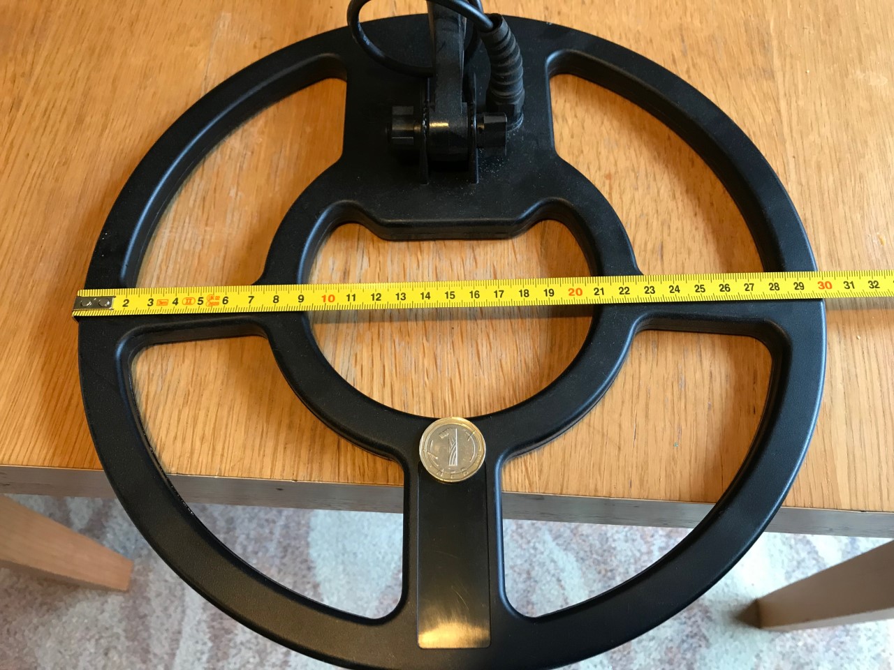

                    • Well for all its worth I acquired a 2002 1 Lev coin and tested it in free air against my Vallon fitted with DIY 12inch coil inspired by Eric, it does work extremely well! See photographs below.
                      Anyway I could get 2 LED's at 42 cm with my set up just for the record.

                        Thank you, you gave me hope ! And how quickly did you get with a coin of 1 lev ?- congratulations ! I would use 2 cells Li-ION connected in parallel , standard, from a laptop .Li-Po batteries from a crashed dron are an even better option - they have extremely low internal resistance . You have very well done the staff (stick ) on Vallon. And now, please , Find a well-baked brick or tile for the roof . Or a thick piece of ceramics. Ceramics changes its magnetic properties in the baking process . - in Mineral mode , after passing the procedure in point 3.3.1 ?Automatic Fine Adaptation to Mineralized Soil (http://www.vallon.de/download/Vertri..._soft_1_14.pdf ) . Adjust Vallon to ceramics . Then again perform an air test . You in the United Kingdom you have extremely light soils- with very low reactive components . This makes you mislead about the capabilities of Vallon in Mineral mode . Оn English territory, the detectors have almost no depth loss in the soil . Measurements of my soil showed : - in the air at 36 cm ,but in the soil at 28-29 cm - coin 1 lev , VLF detector with working frequency -12 khz . The coin from 1lev to 21 cm deep in the soil is indicated as an iron target in this soil , of all detectors on the market .. Now, with eliminated ceramics-say please , what is going on with sensitivity ?

                          There just happened to be one on Ebay in UK for 2 pounds with free postage, I couldn't resist it! I am happy with the D cells, yes thanks - shaft is from an old Fisher 1210.
                          I 'll see what I can do for you but no promises, I only use my Vallon on the beach and never use mineral mode.
                          I am no electronics design engineer, all I know is that my Vallon with a 12 inch coil works very well on UK beaches! Thanks Mr Foster!
