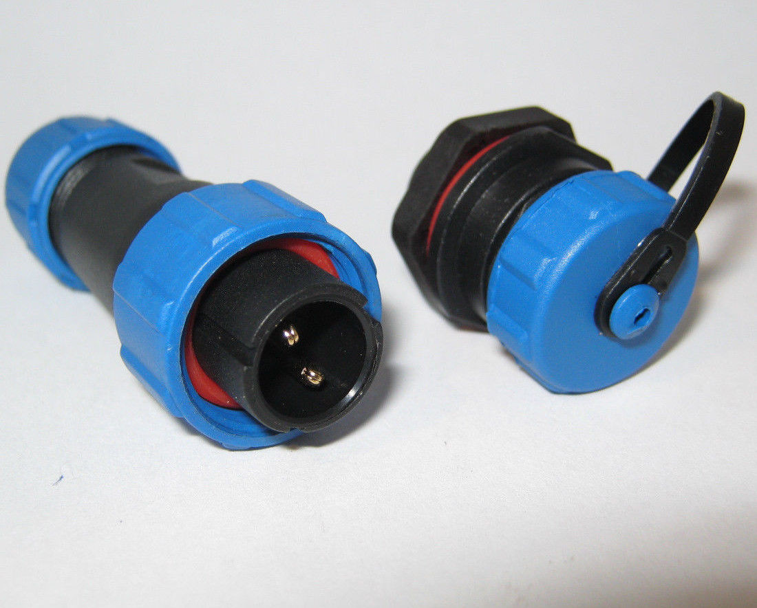

            • Originally posted by tifred View Post
              Hello everyone
              here is my modified vhm3cs.
              housing coil of minelab explorer modified.
              one baterie 26650
              I have stick minelab xs label on my vmh3cs to annoy my friends!
              thank you for the many council Eric
              [ATTACH]41260[/ATTACH]
              [ATTACH]41261[/ATTACH]
              [ATTACH]41262[/ATTACH]
              Could you please tell us what you used for a battery holder? I am thinking of using two 26650's 8800 mAh in Parallel. Any comments Eric or Tifred ?
              • Originally posted by Sampler_one View Post
                And the coil connector please ? is it the original socket ?

                          • hello
                            for my modification ,
                            I opened an old coil of minelab explorer that was not working anymore.
                            I put inside a mono winding, I used the parameters of Eric Foster, shielding and SCOTH24. I used the original cable of the vallON for the coil.
                            The connector used is:1Pcs SP16 Series 2Pin IP68 Waterproof Circular Cable Plug & Socket Connector BS2 buy on ebay china.
                            for the battery it's a one 26650 ,I shortened the tube of the battery, I will make photos of the modification.I am very satisfied with the result and a big thank you to our Friend Eric foster !
                            • Thanks for the information on the coil socket modification.
