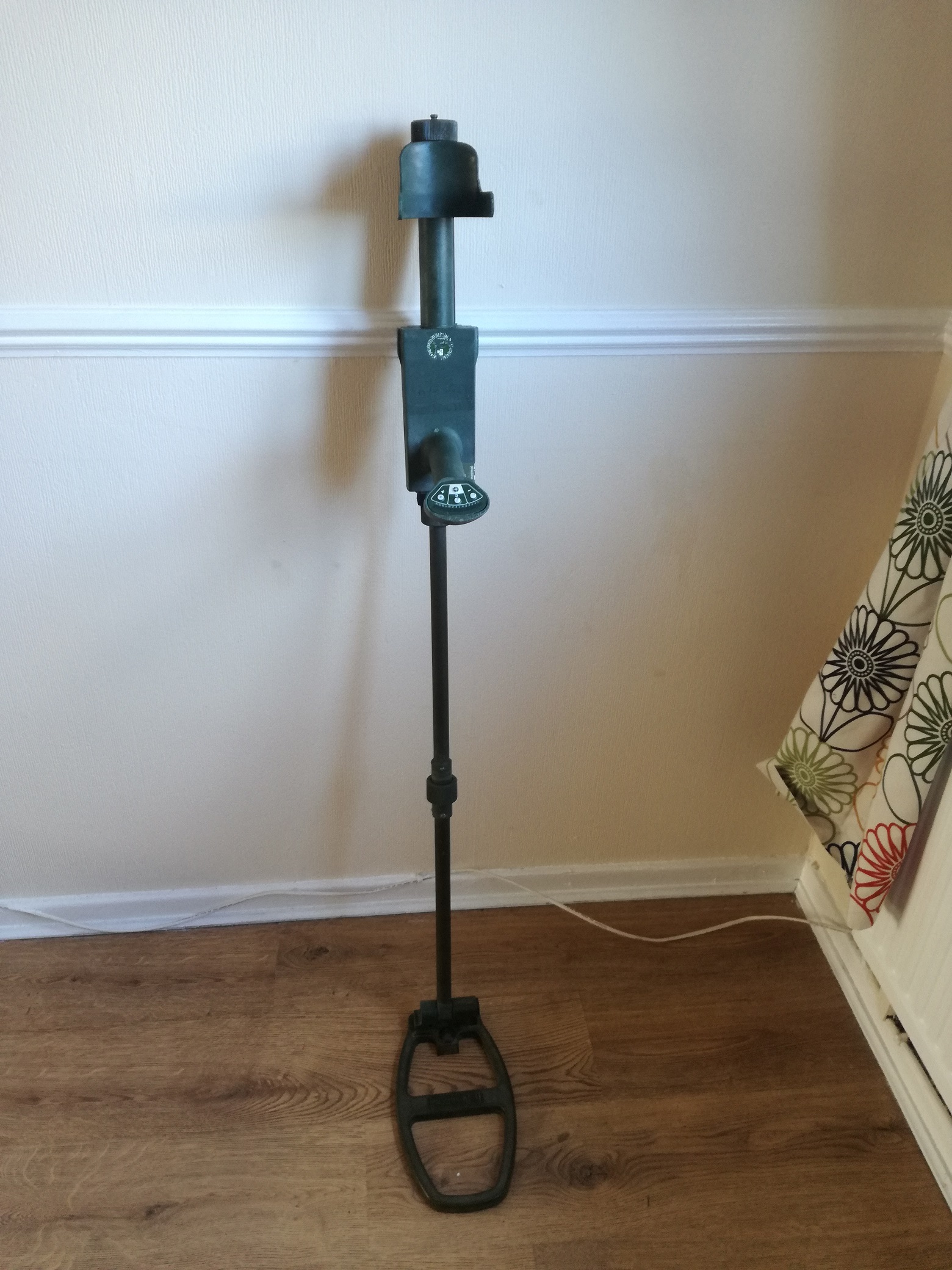

        Can you post a picture of your machine? It is rare to get one in good condition. Perhaps your's never saw active service on the battlefield.
        Eric.

            I don't think my detector is free from service (dust in nooks and crannies etc. and wear to the housing and coil). It does have wear and tear but structurally and mechanically it's solid. The hard and soft case were immaculate when I received it. I'm unsure how long the previous owner had it but I certainly put it through some extensive beach use (hence the wear) and it holds up really nice. Just yesterday it picked up a 10mm musket ball at about ~13 inches! This machine never ceases to amaze me.

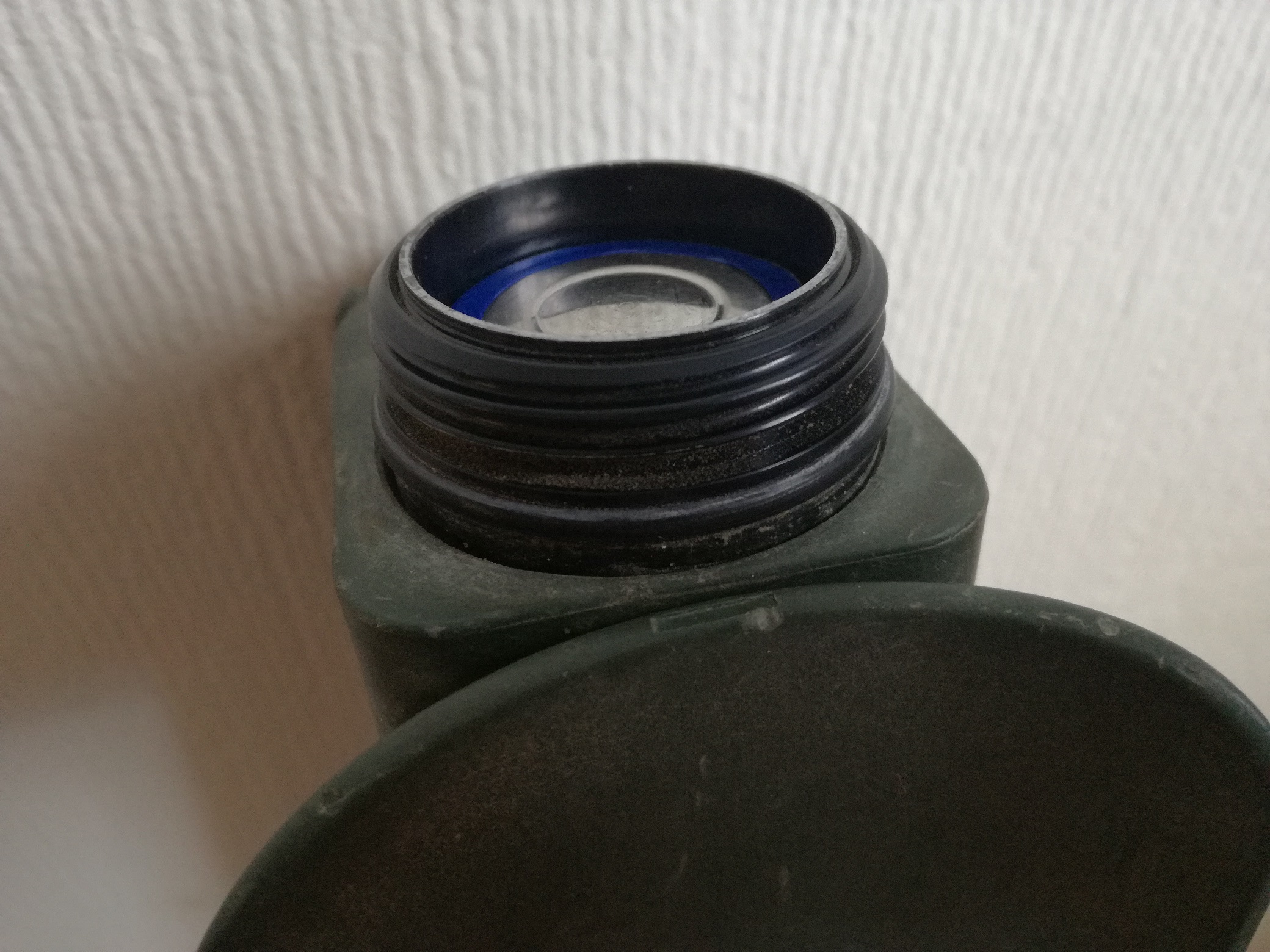

            Whilst I'm posting pictures please could you answer me this. The back of the housing is held together by three screws. The bottom one has a seal in the groove but the two above don't. Is this a problem for water tightness?

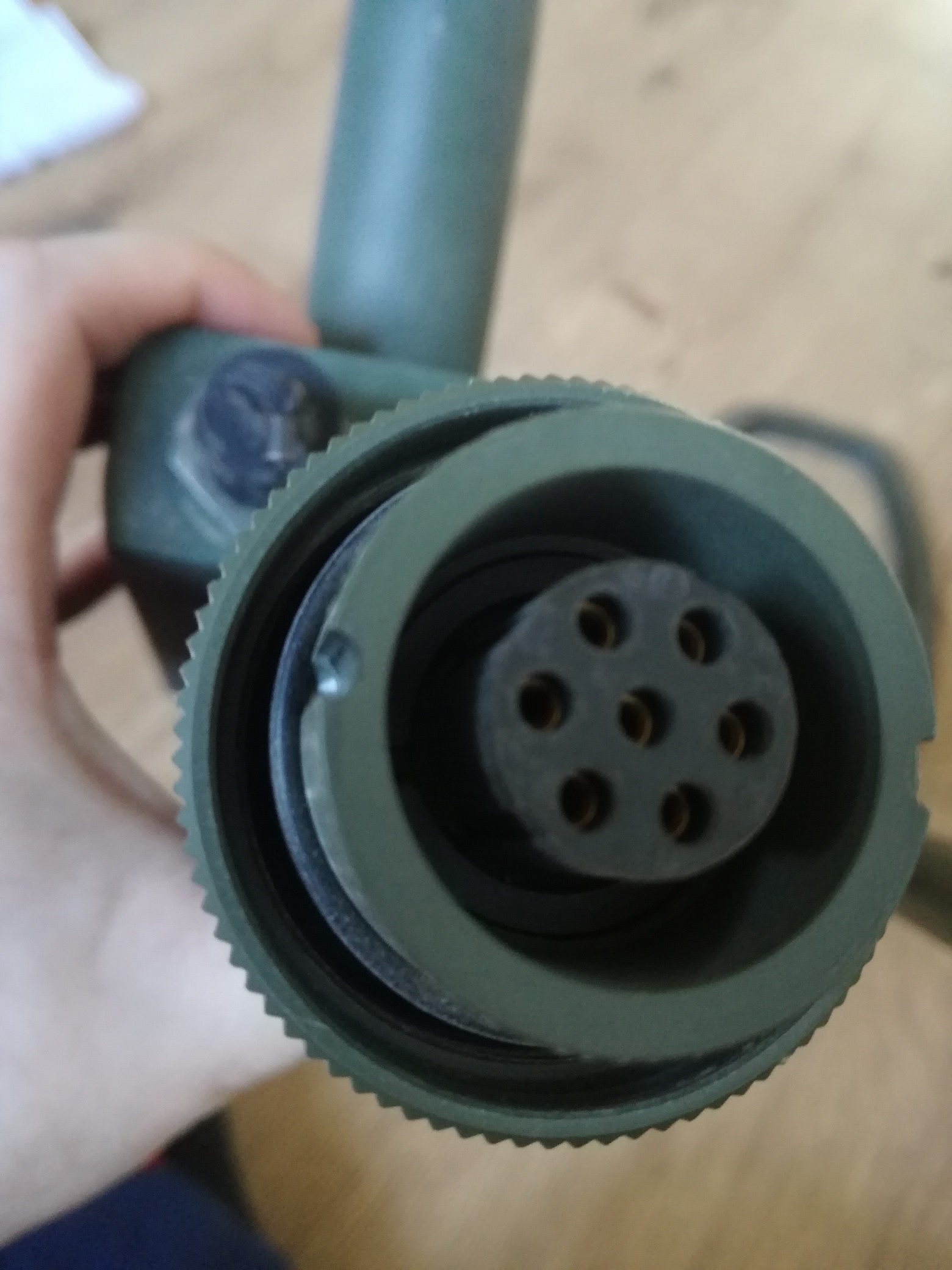

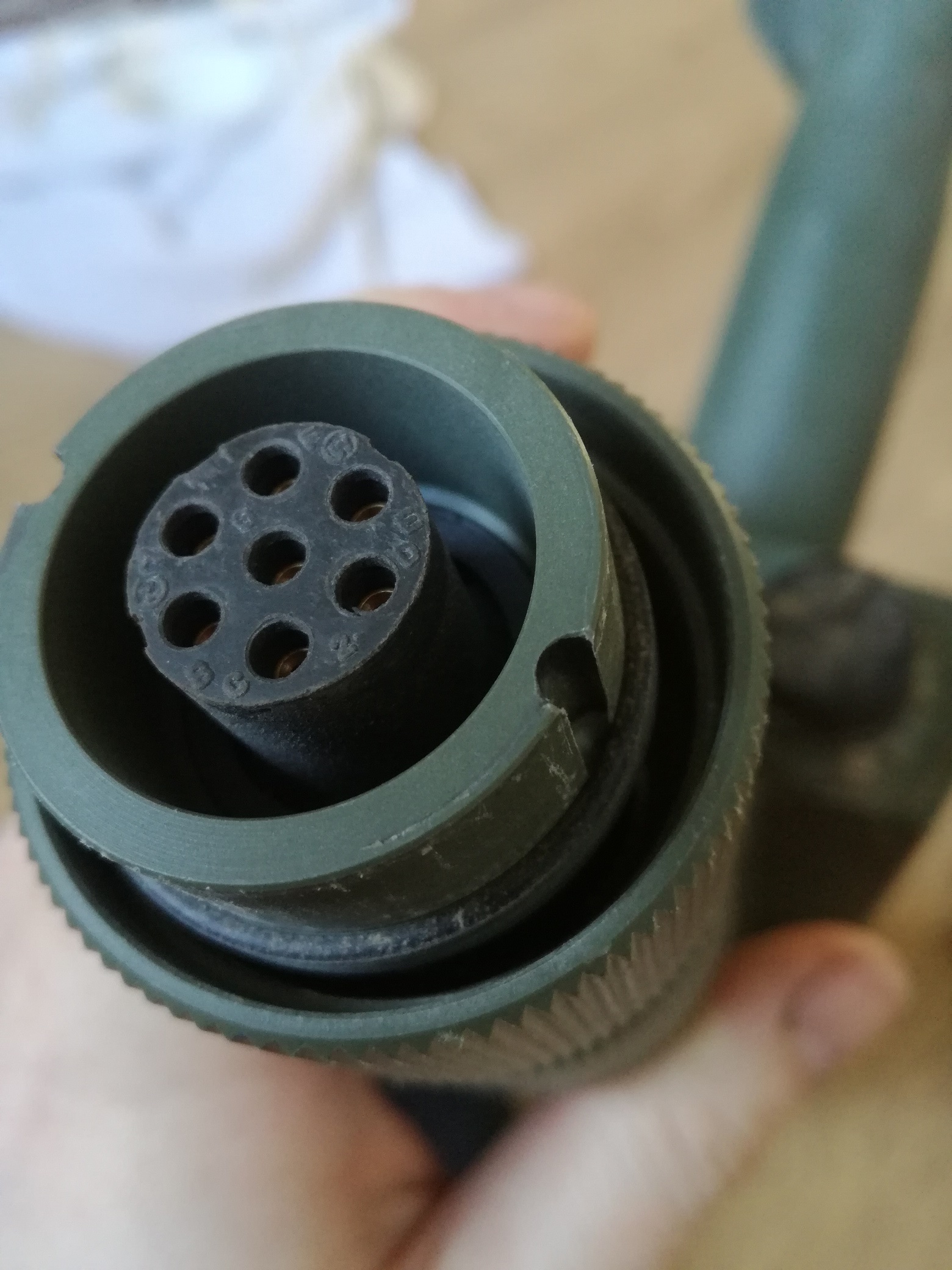

            • James, The drop box pictures did not load for me. Many of the cases come new as it is apparent they were not used. What you are calling a seal is what I would call a guide/lock for the upper shaft. You can see the groove in the bottom of the upper shaft. Eric & I have discussed all possible points of water entry above. I do not see where you live. If in the USA I can give you an address to have your machine checked and serviced. Otherwise I would not advise you to take your machine in the water past the lower shaft coupling. To answer your question, no, this has nothing to do with water tightness.
              • Apologies, here are some below. I can see the guide pin grooves that allow the coil to be locked in front or backward facing for kneeling purposes. The O ring is visible on the images too. I've already taken this detector past the lower shaft but not past the housing and it's survived thus far. I picked this up for £150 and live in Liverpool, UK, so the cost to send for servicing is probably not something I'm keen on currently.

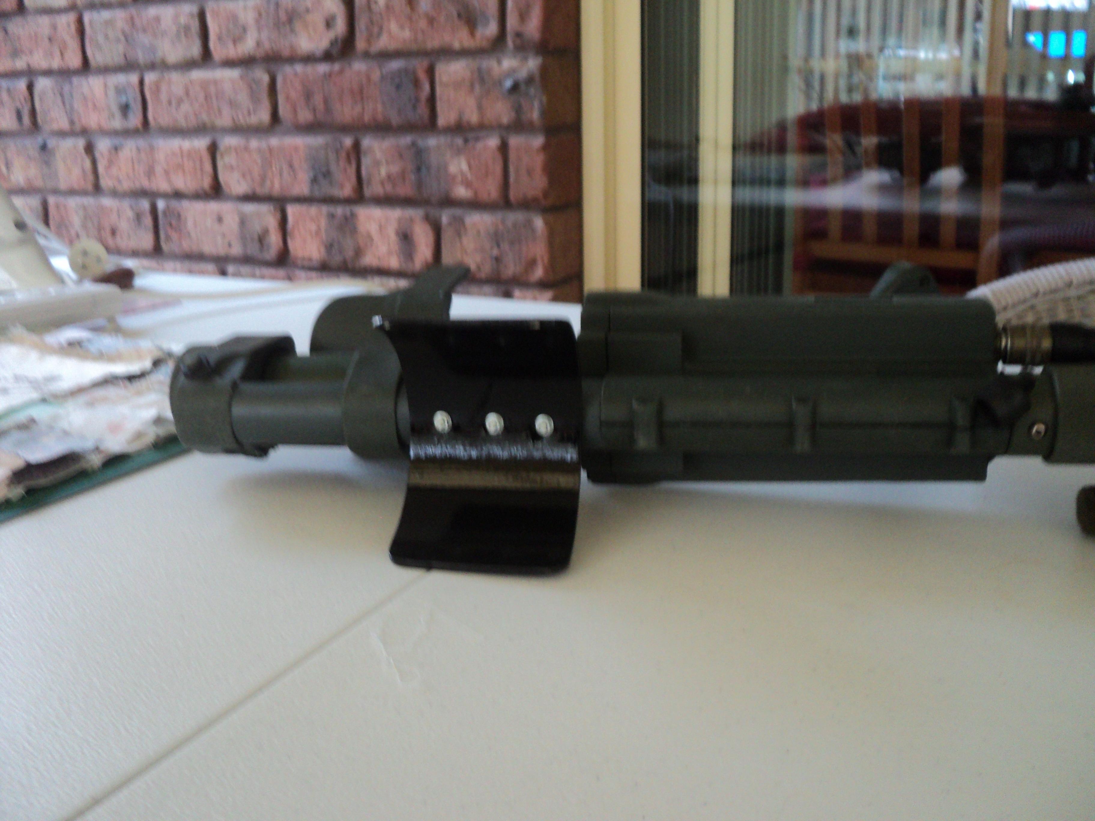

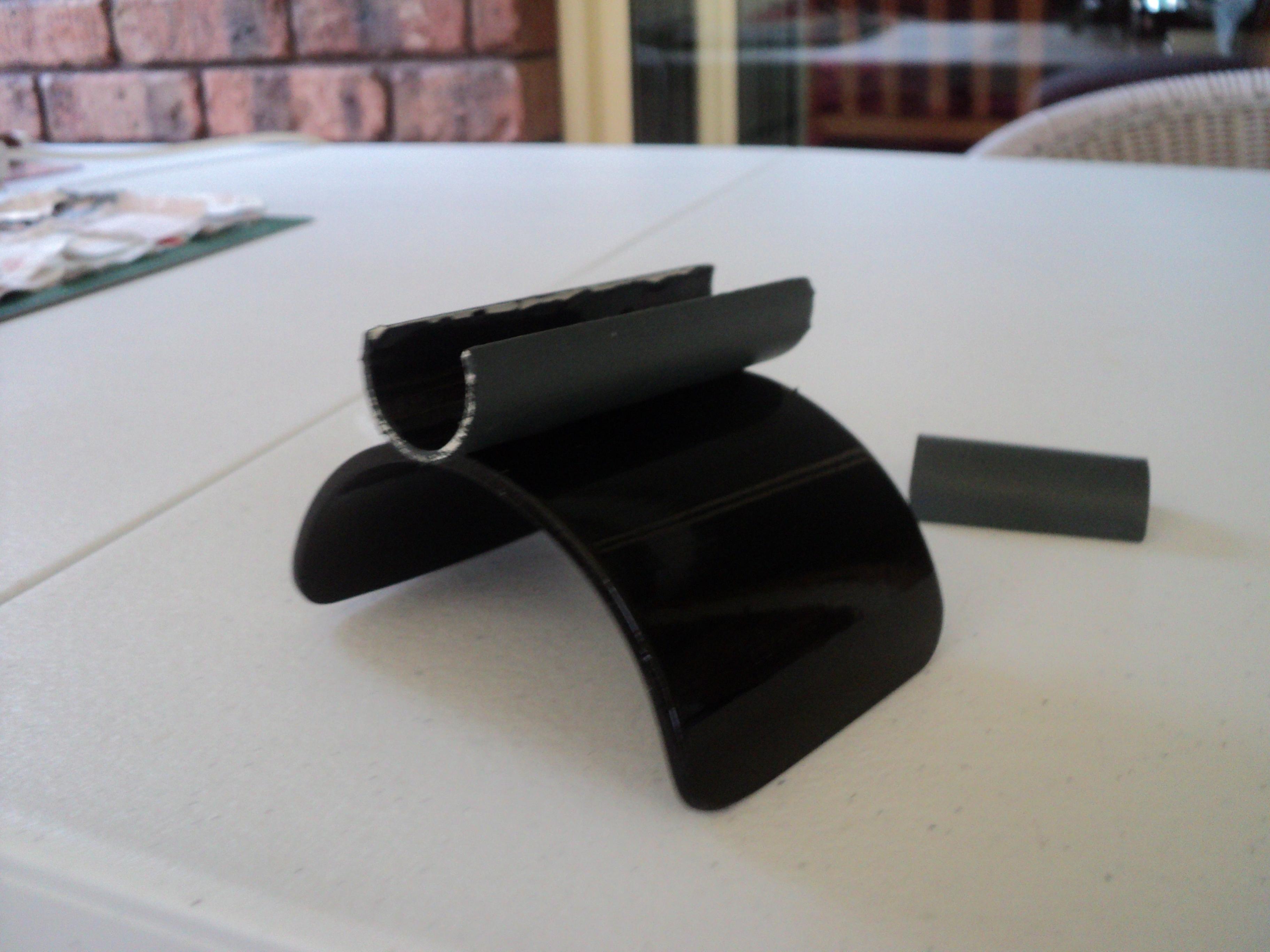

                          • Hi Guys.
                            Heres is the detector stand i made out of 1 inch pvc and 4 inch. The short piece goes behind the armrest and stand locks on in front of the armrest so the arm rest is tight with no movement.
                            Regards Ray Below2doe.
