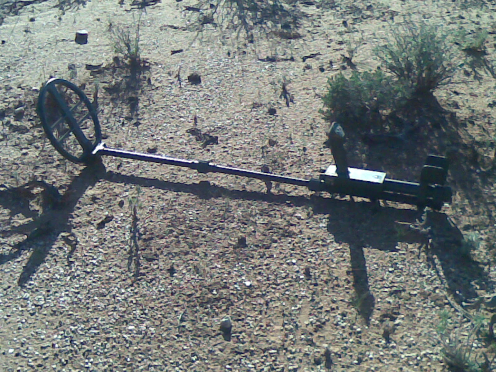

                    No sorry...here is a pic I did post earlier of the 30cm laying on our block Click image for larger version
                    • Thanks for the pic. Is it elliptical or round? Picture may be misleading or my old eye's.
                      Thanks again
                      Thomas
                      • Round coil

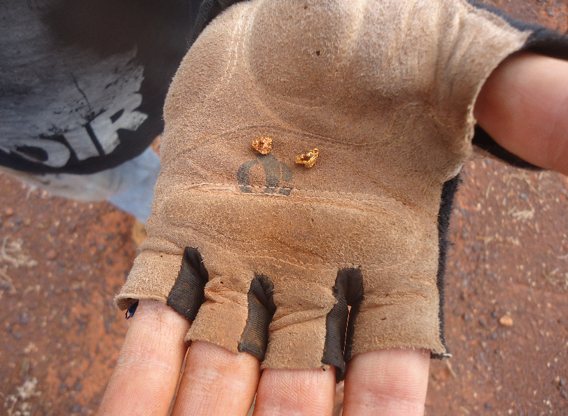

                        Had an interesting day out with the Vallon today and my friend with his GPZ 7000.
                        Vallon gold = zero.
                        GPZ7000 = 2 small nuggets, maybe half a gram each.

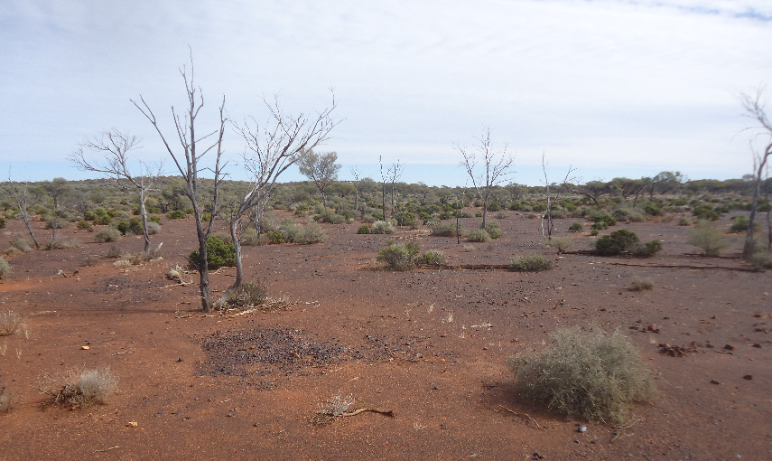

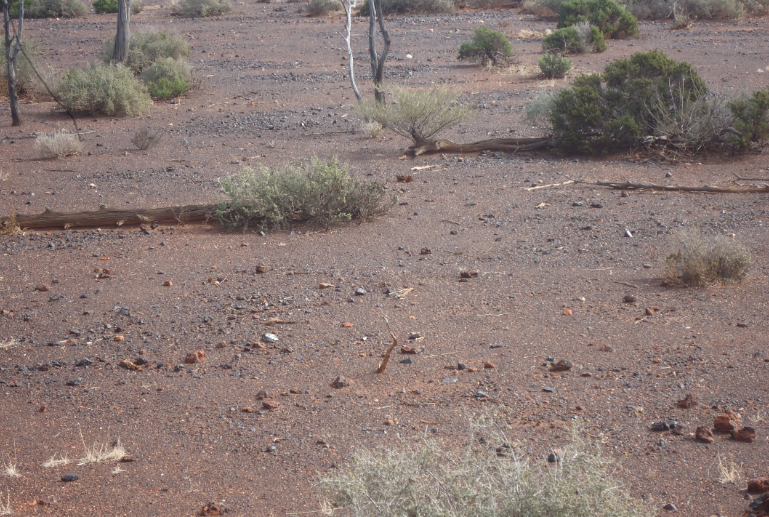

                        Went to 2 areas...first one laterite gravel with ironstone and quartz. Vallon was no issue here. Few hot rocks.
                        Second area, gave up on the Vallon and went to the 2300 as the Vallon would not GB on the magnatite. Constant signalling despite numerous efforts to GB. Was unstable and couldnt use it all
                        Only had one opportunity to test the Vallon and the 7000 side by side....I had an awesome signal and dug down...and down. Signal was still there !! The GPZ waved over it and nothing We put it down to ground noise.

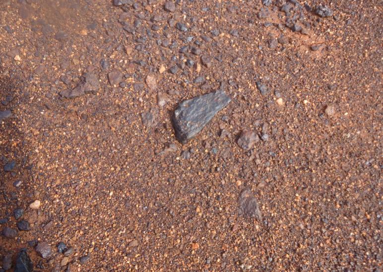

                              A few questions as I have come across these issues in the past. Was the GPZ switched off, or at least a considerable distance away to avoid any intereference? Was the Vallon only unstable when the coil was close to the ground? Did you raise the coil in the air to check stability in case electromagnetic interference was the problem?
                              If either of you had mobile phones, were they switched off?
                              Did you use both coil sizes?
                              I would like to know more about the 'magnetite'. Is that the general ground, or just scattered lumps on a more normal ground? Magnetite normally only has a weak effect on a PI detector, whereas maghemite is the mineral that is the cause of problem ground signals, and is unusually strong in Australia.
                              If you had an 'awesome signal' perhaps you should have continued digging Look forward to the pictures.
                              Eric.
                                Eric.
                                Thanks Eric.
                                Yep the 7000 was turned off when we were close.
                                I didnt try the large coil in the "bad" area....Used the standard coil and and it was signalling on every swing in this area. I raised it and it actually improved a bit, but was still unstable. I was a long way from the 7000 and the other guys with a 4500 so it wasnt EMI from them. My phone was in the car too
                                The other guy who took us out there said it was magnetite, but it could well be maghemite. The ground was littered with it!! I have attached pics

                                EDIT: Looked at the geo map of the area and it does say magnetite.
