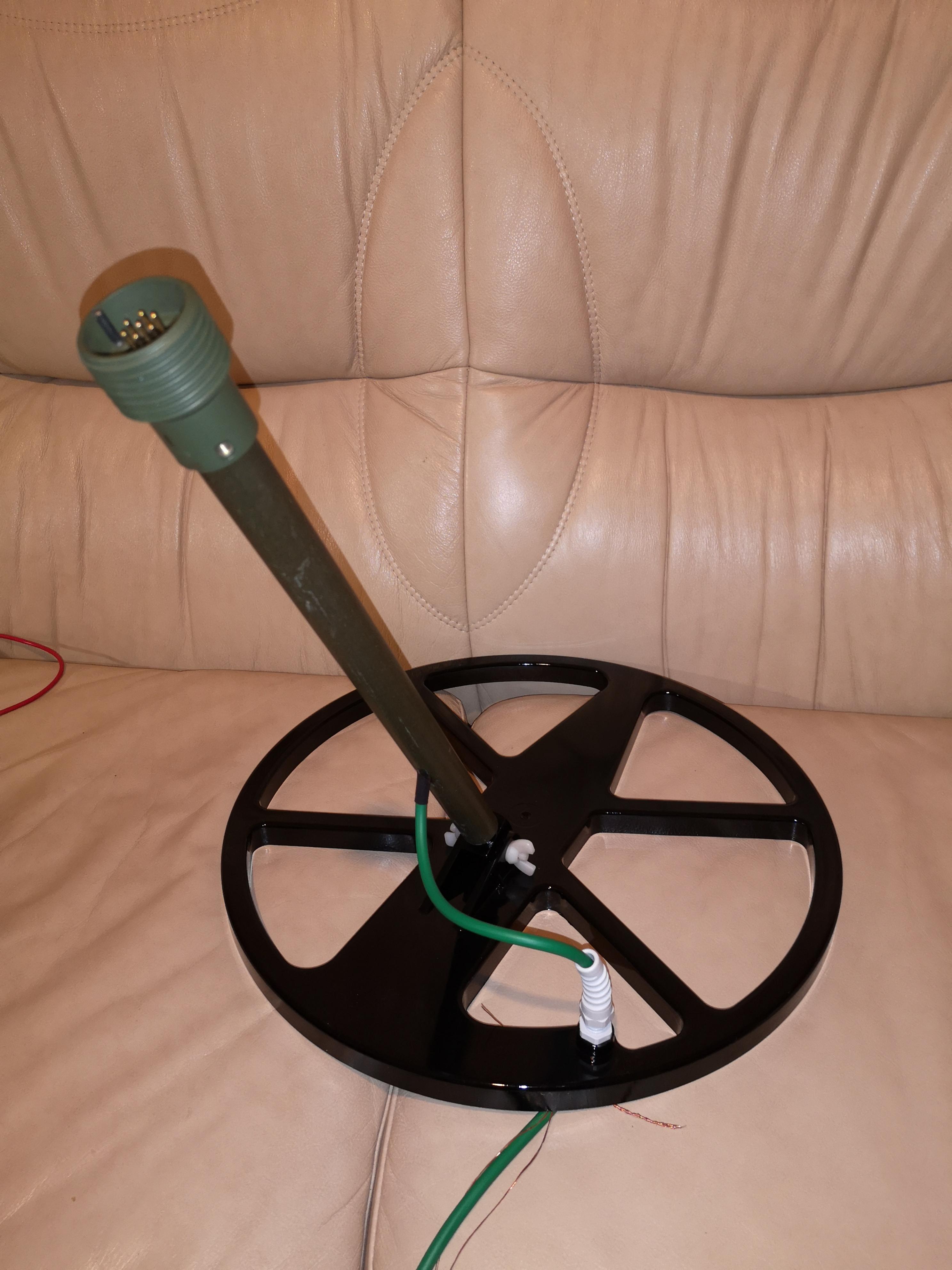

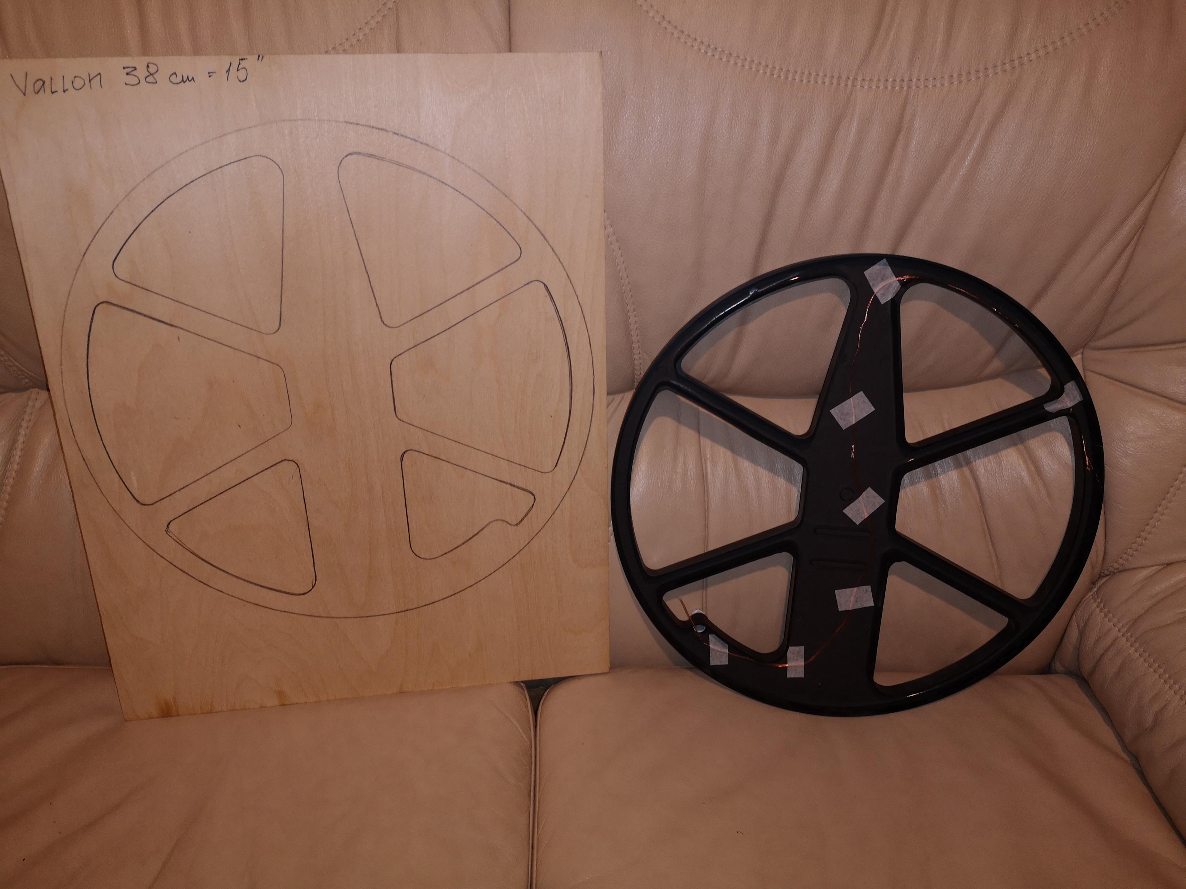

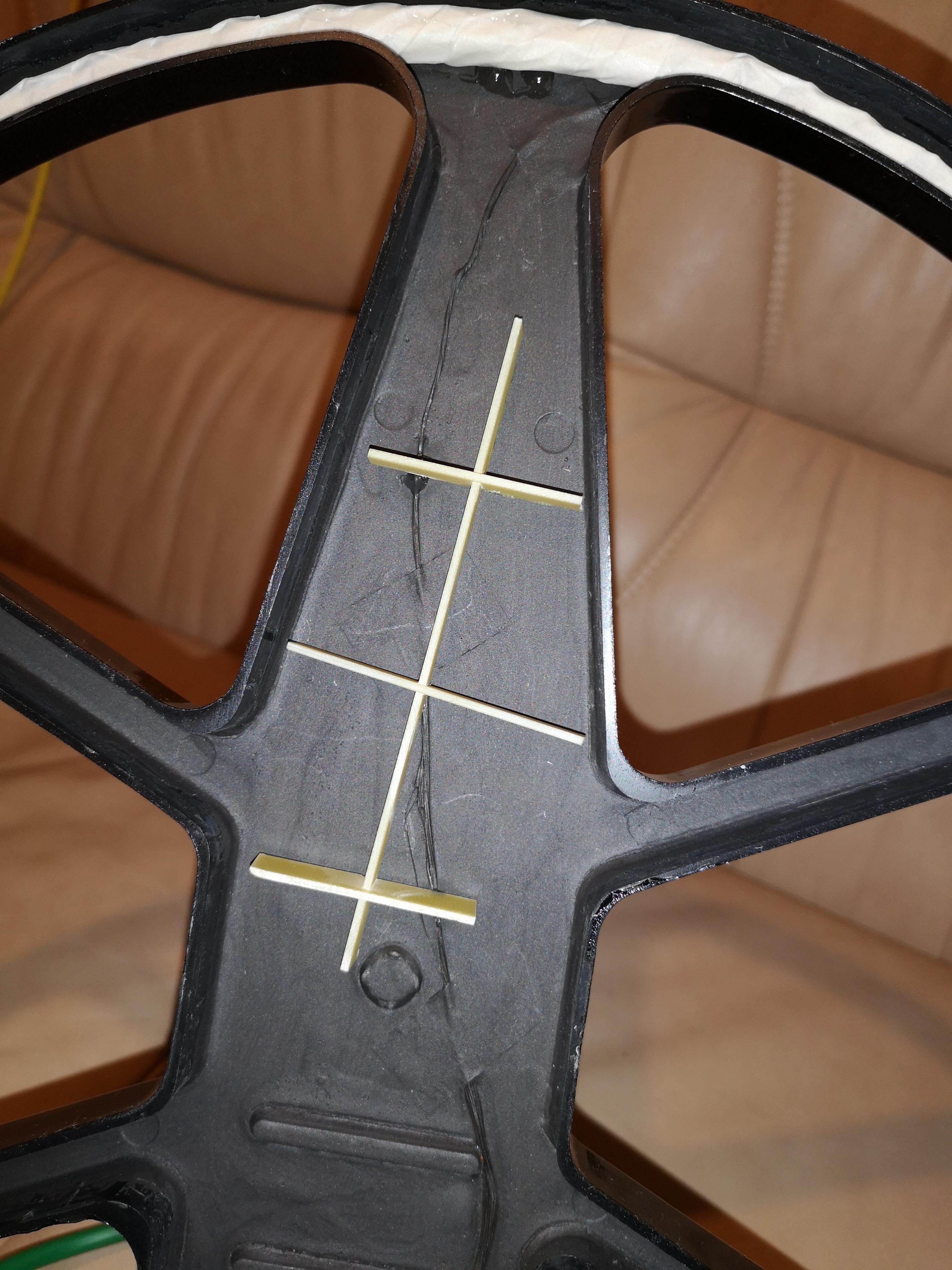

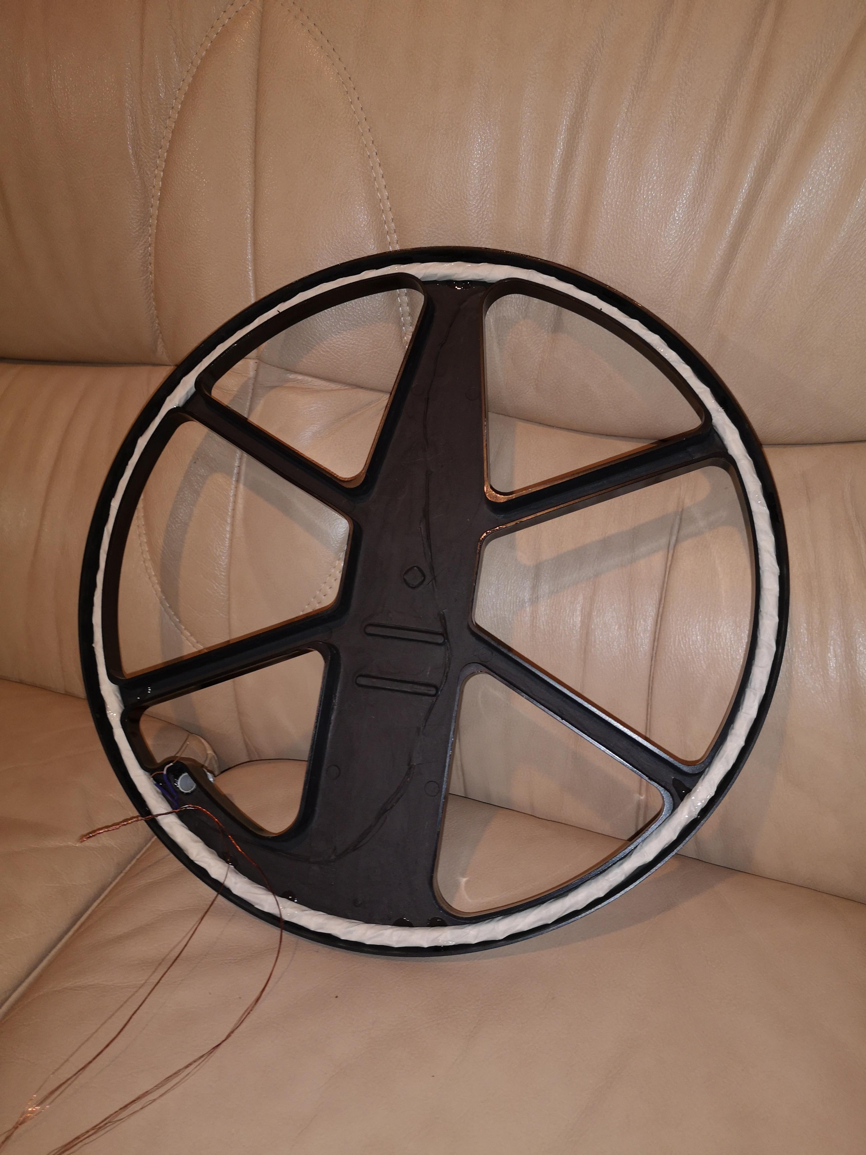

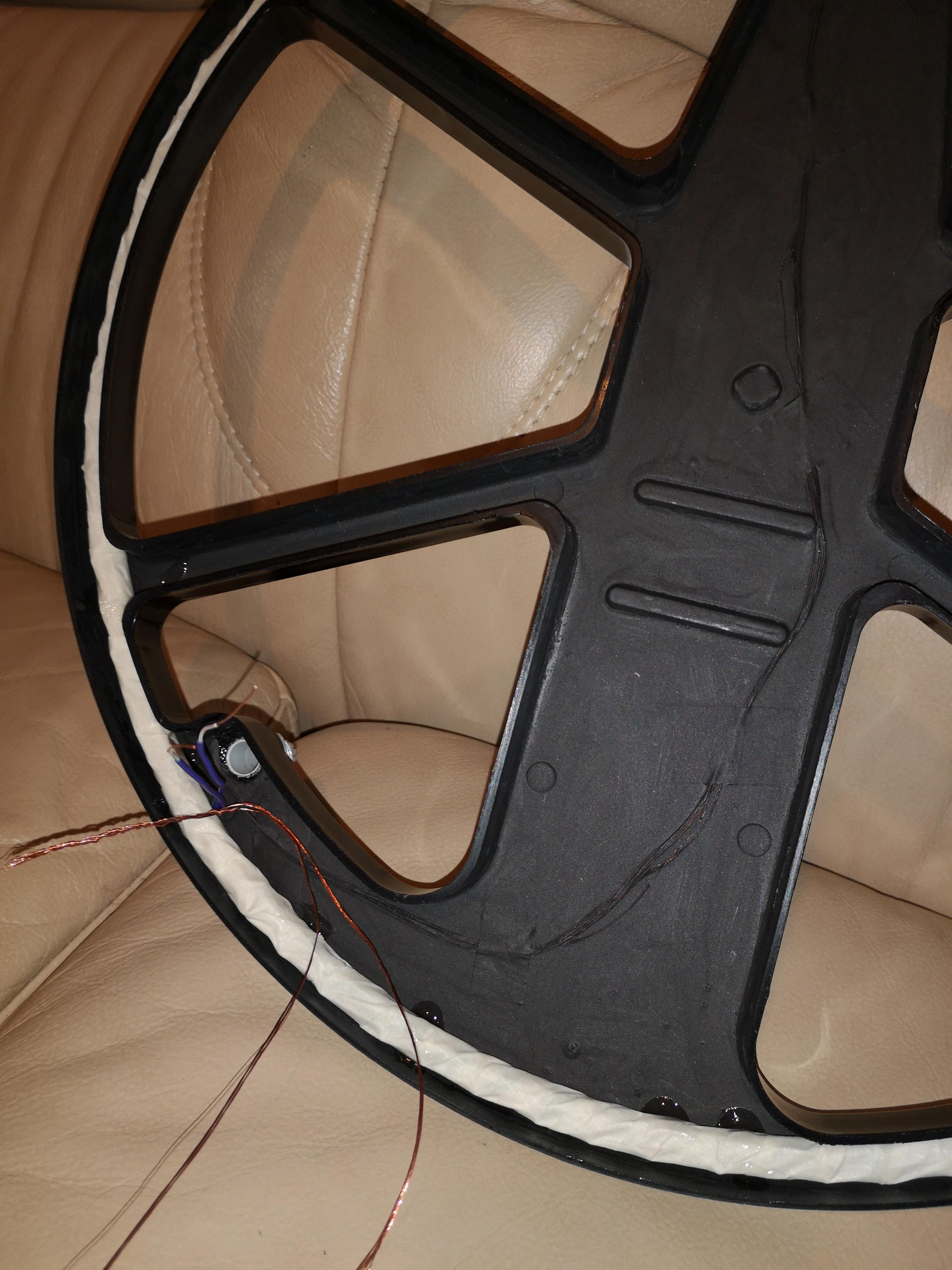

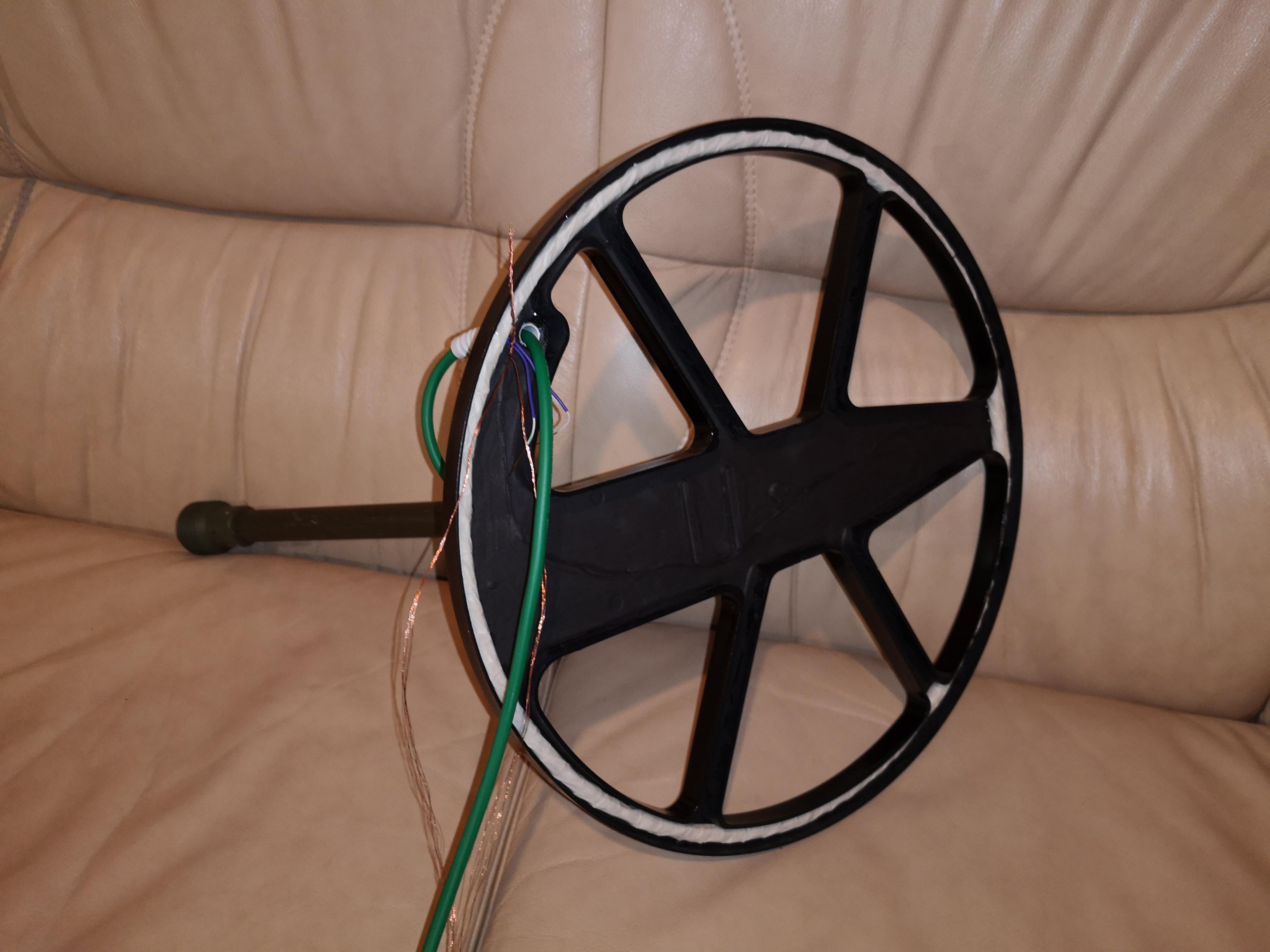

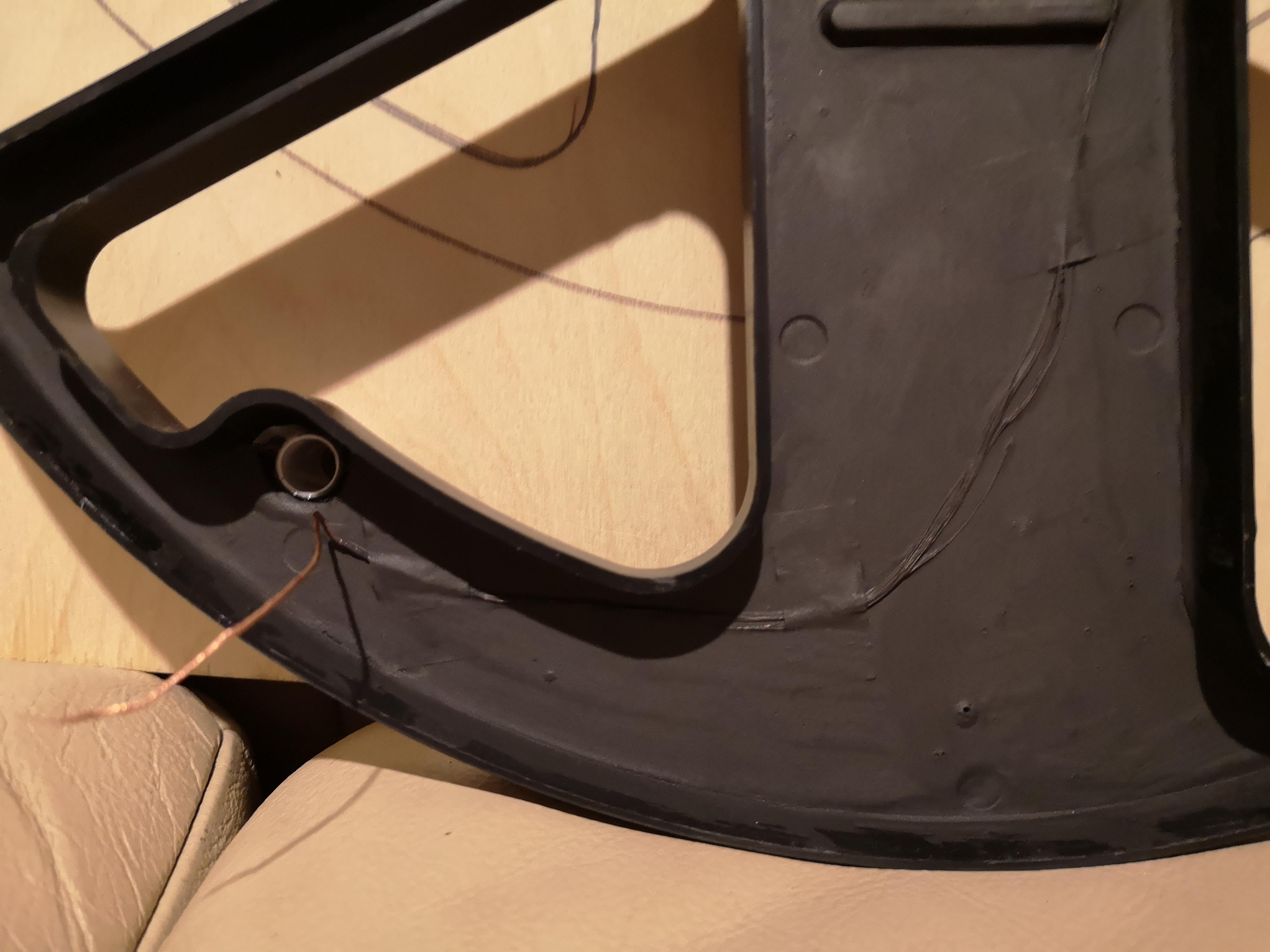

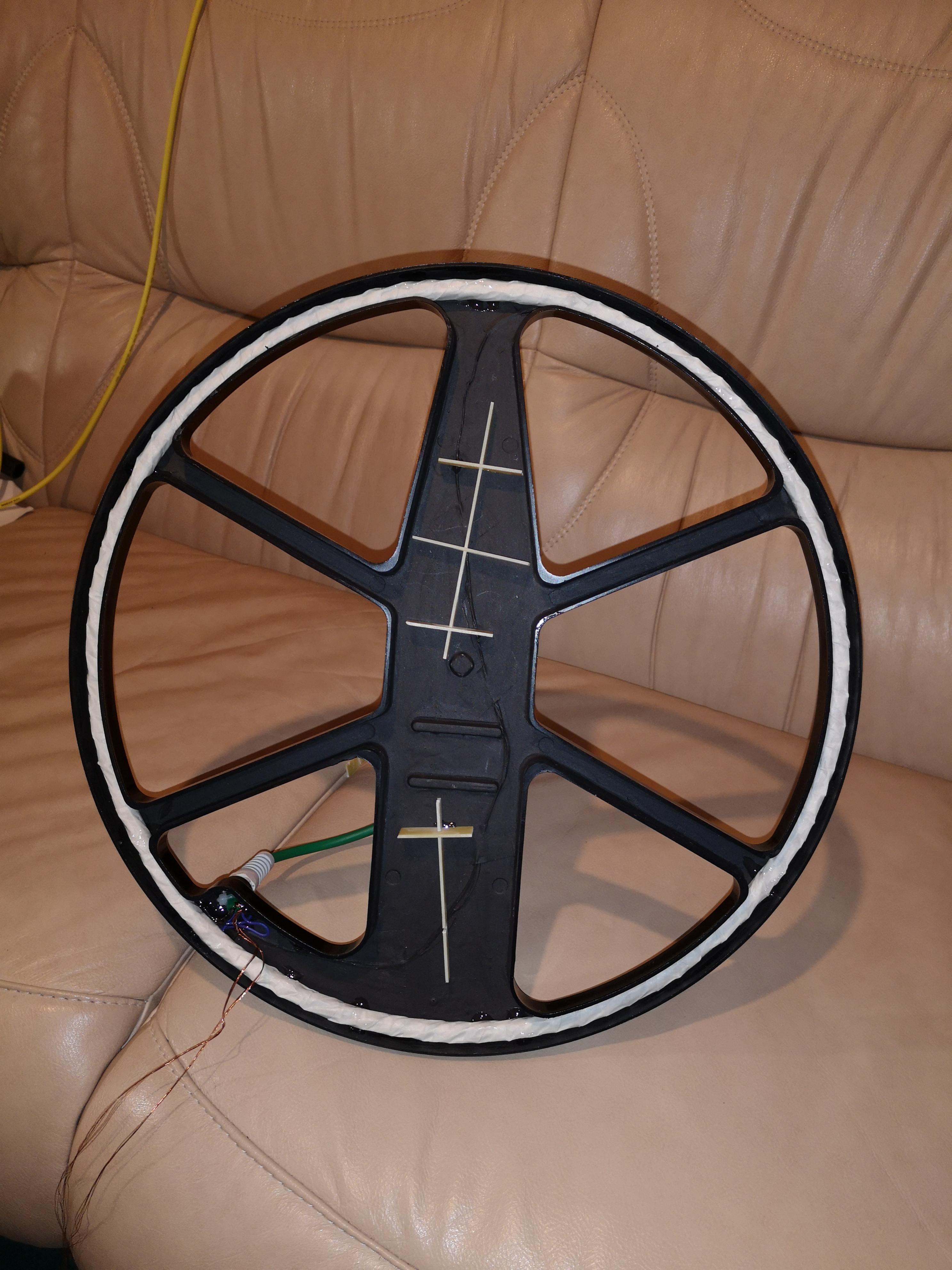

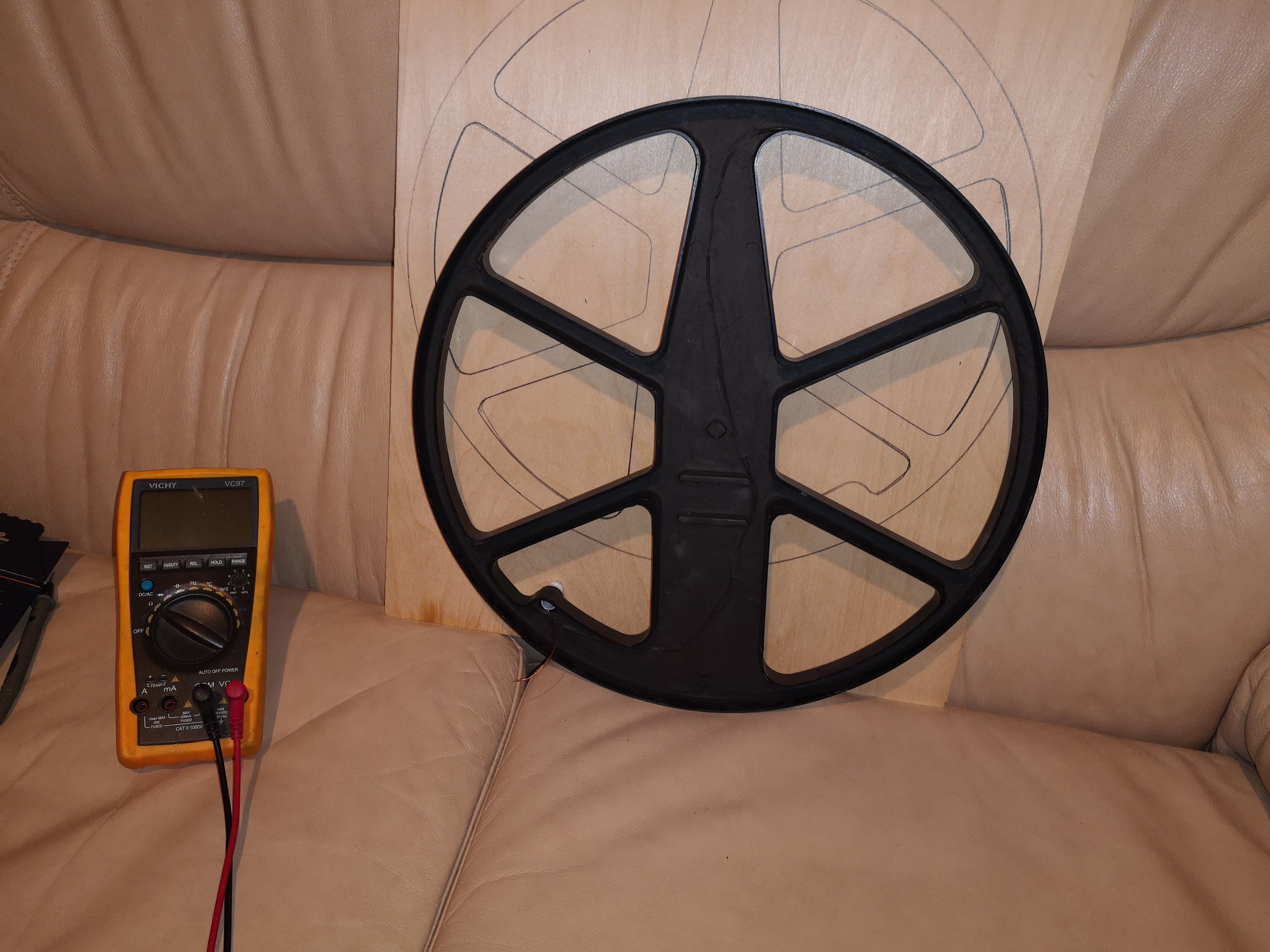

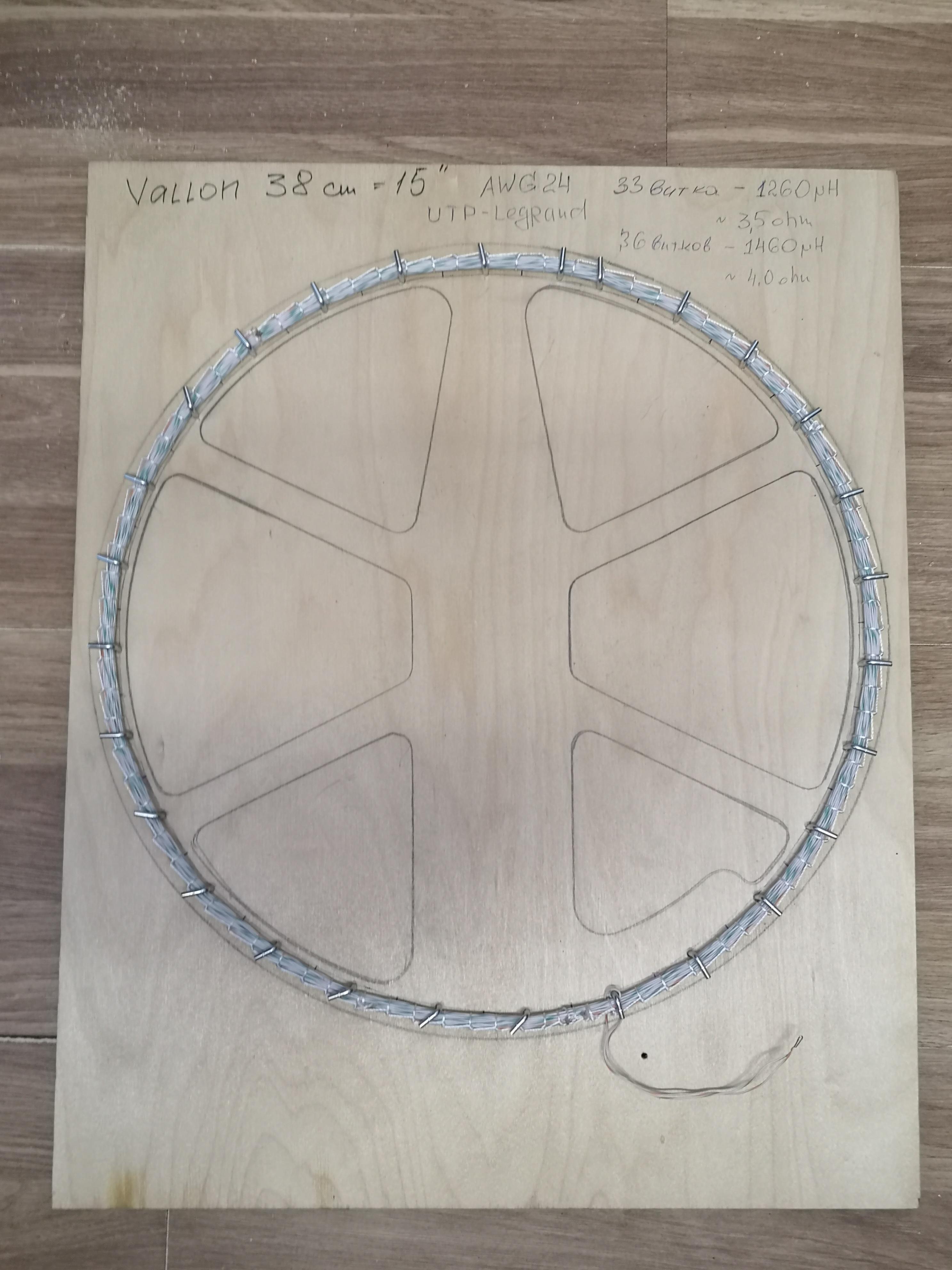

                • The manufacturing process of the coil is 38 cm. = 15 inches for Vallon.

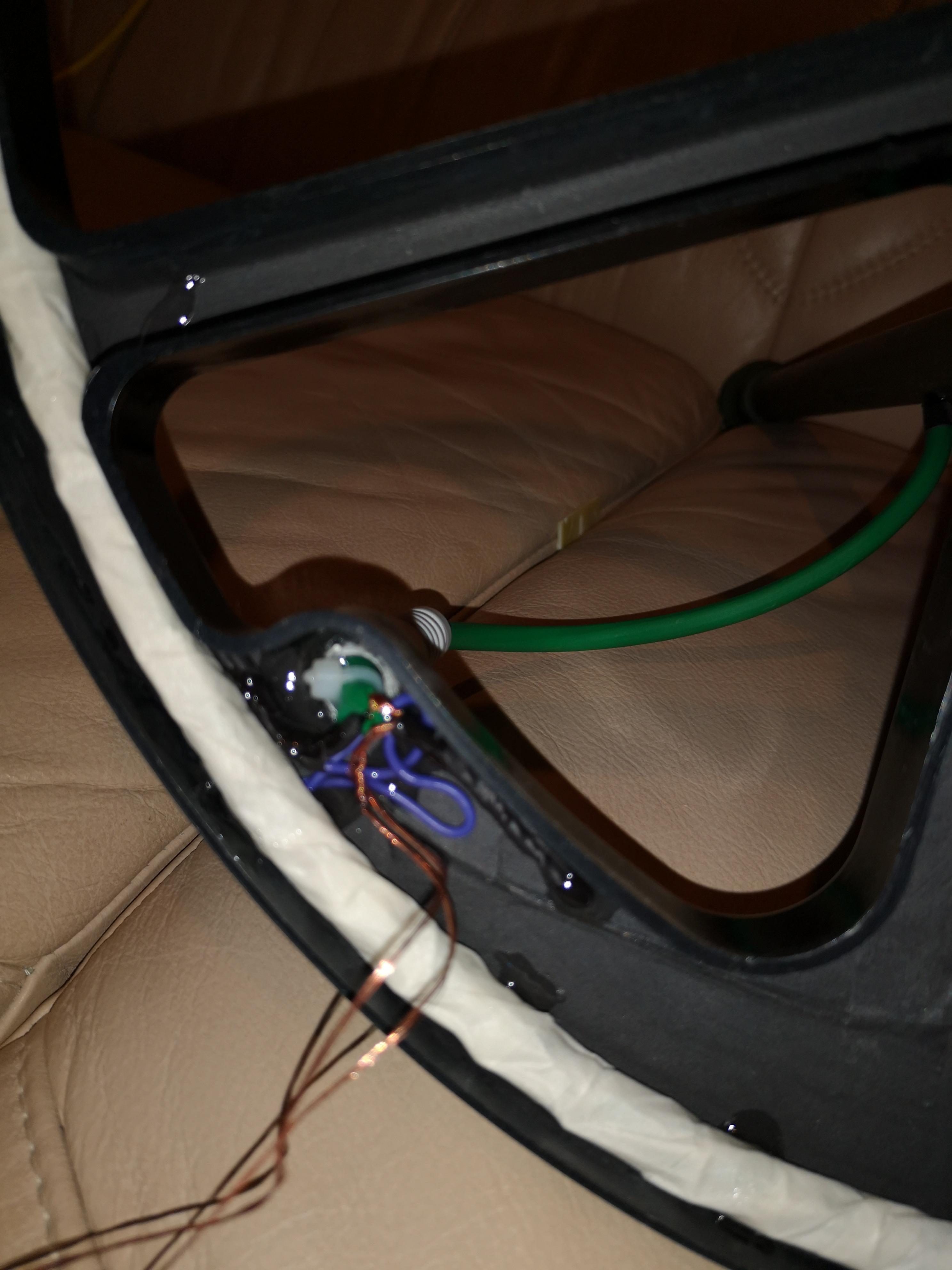

                  • Thank you Myntmaster

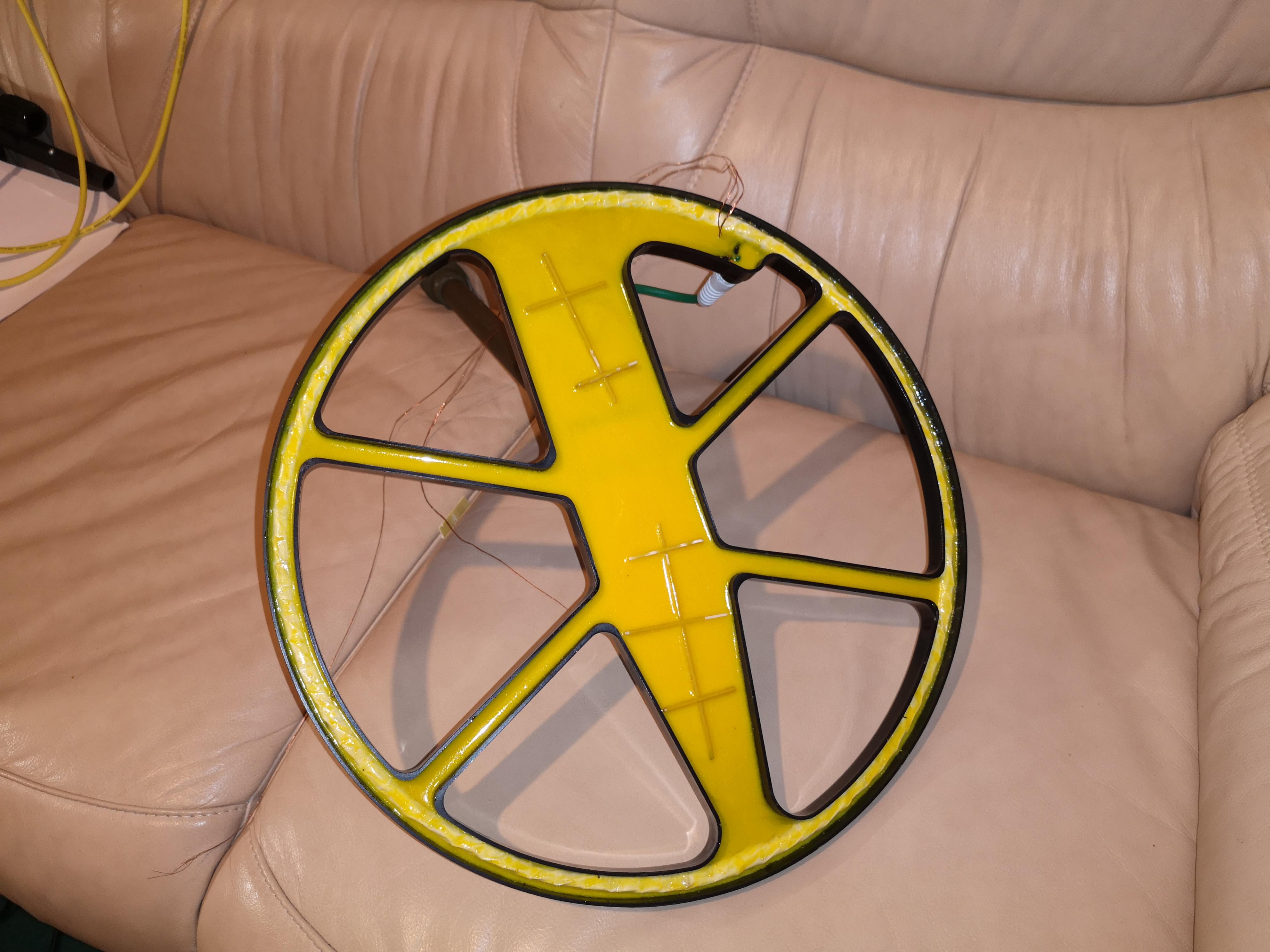

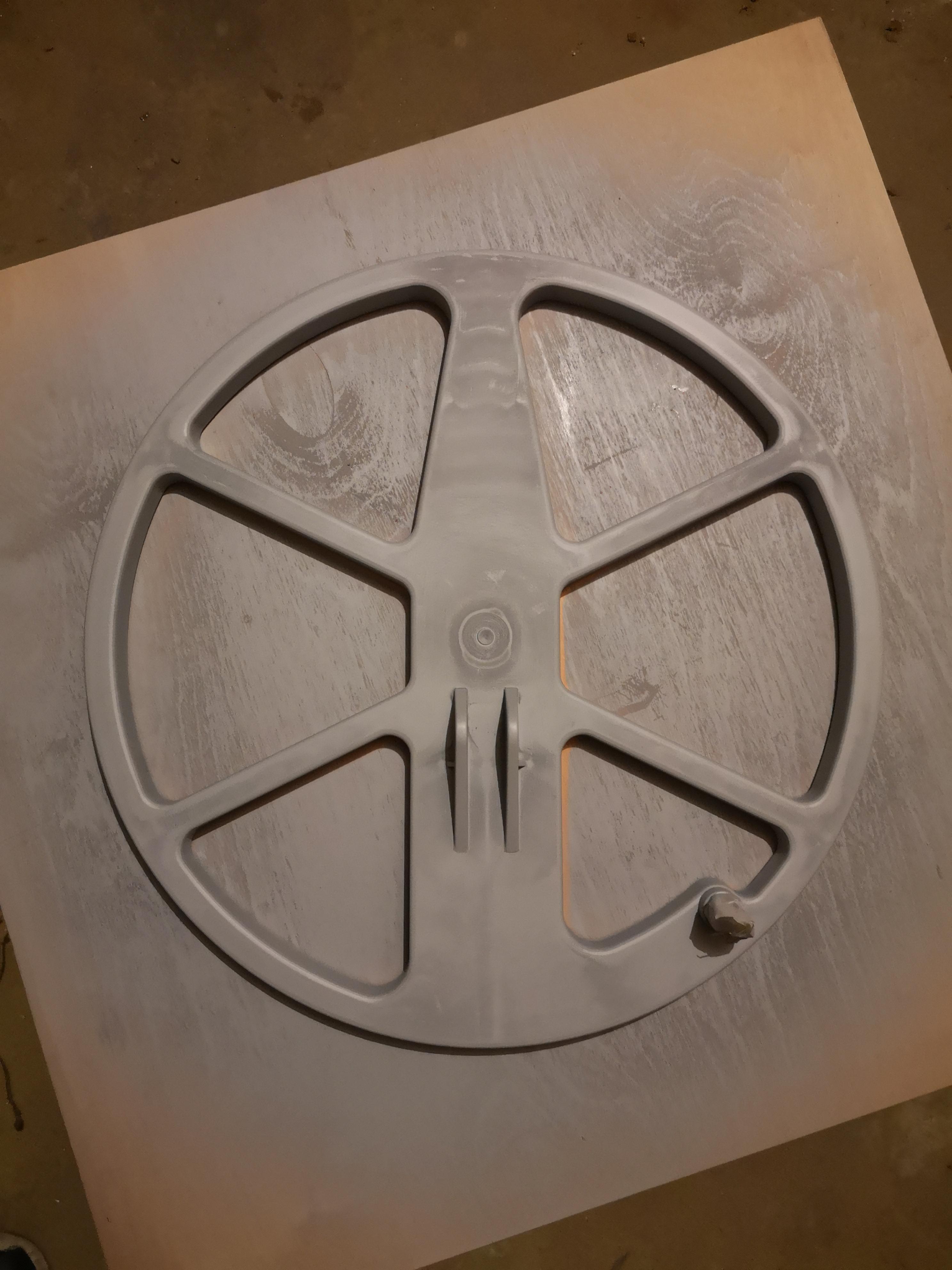

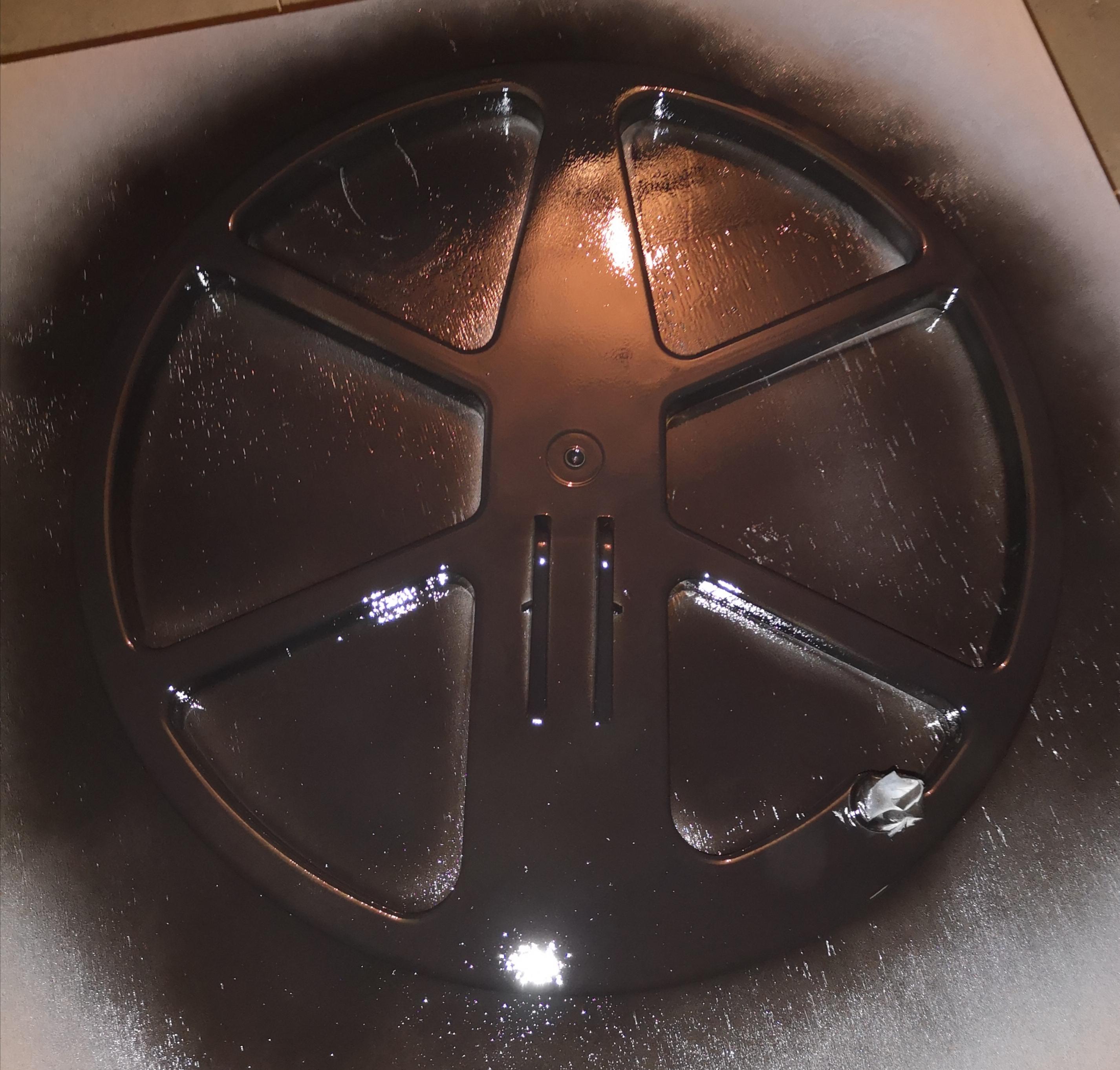

                    • A couple more photos.
                      The longest in all of this is the drying process.
                      You can’t rush absolutely.
                      The graphite layer dries for at least 2 days. Epoxy up to 5 days.

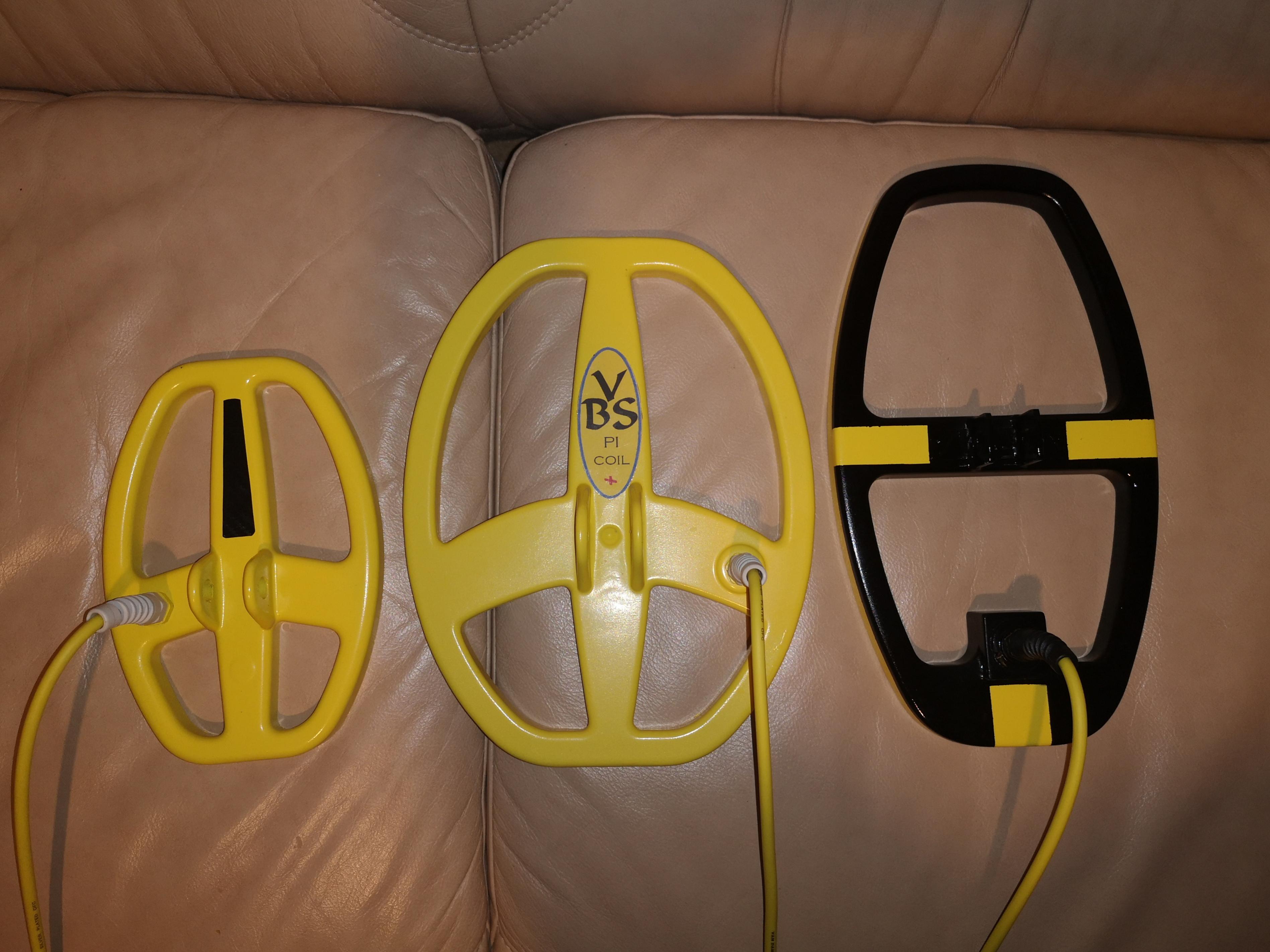

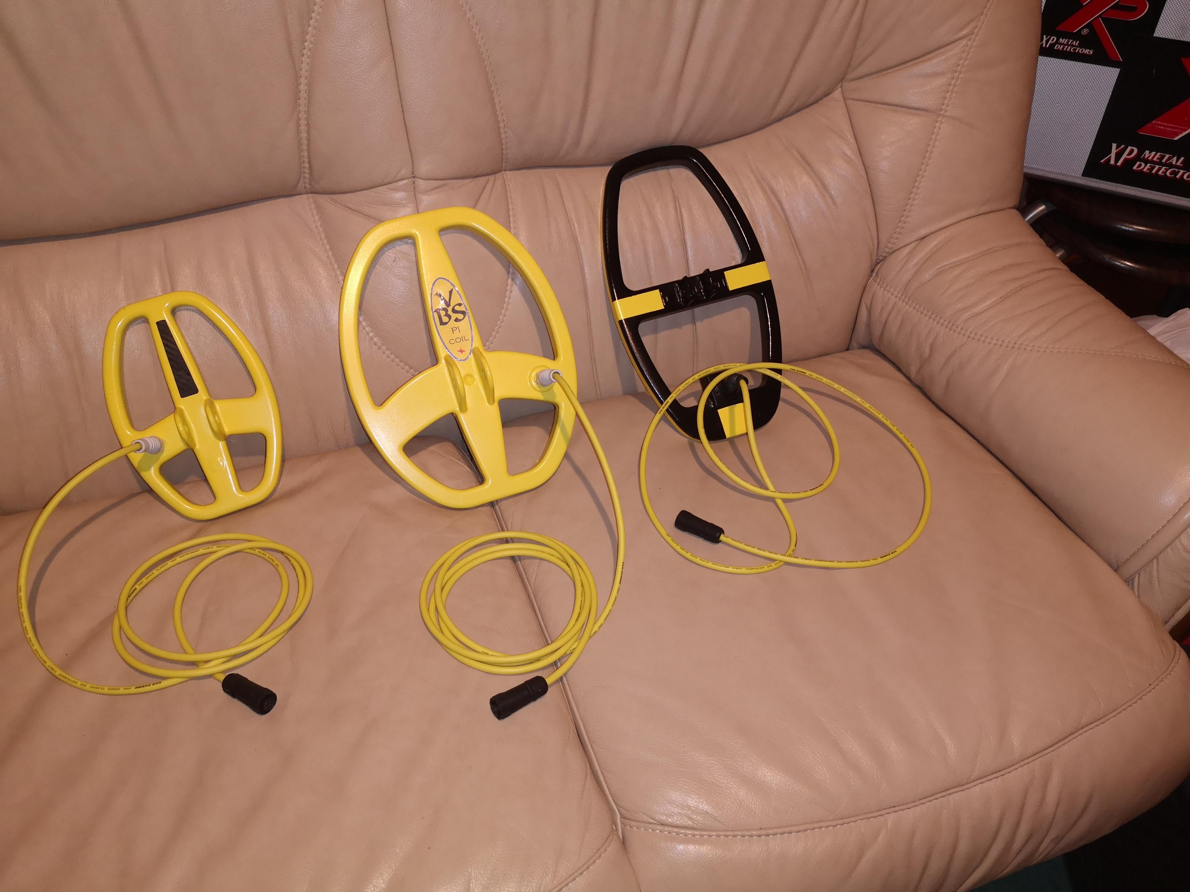

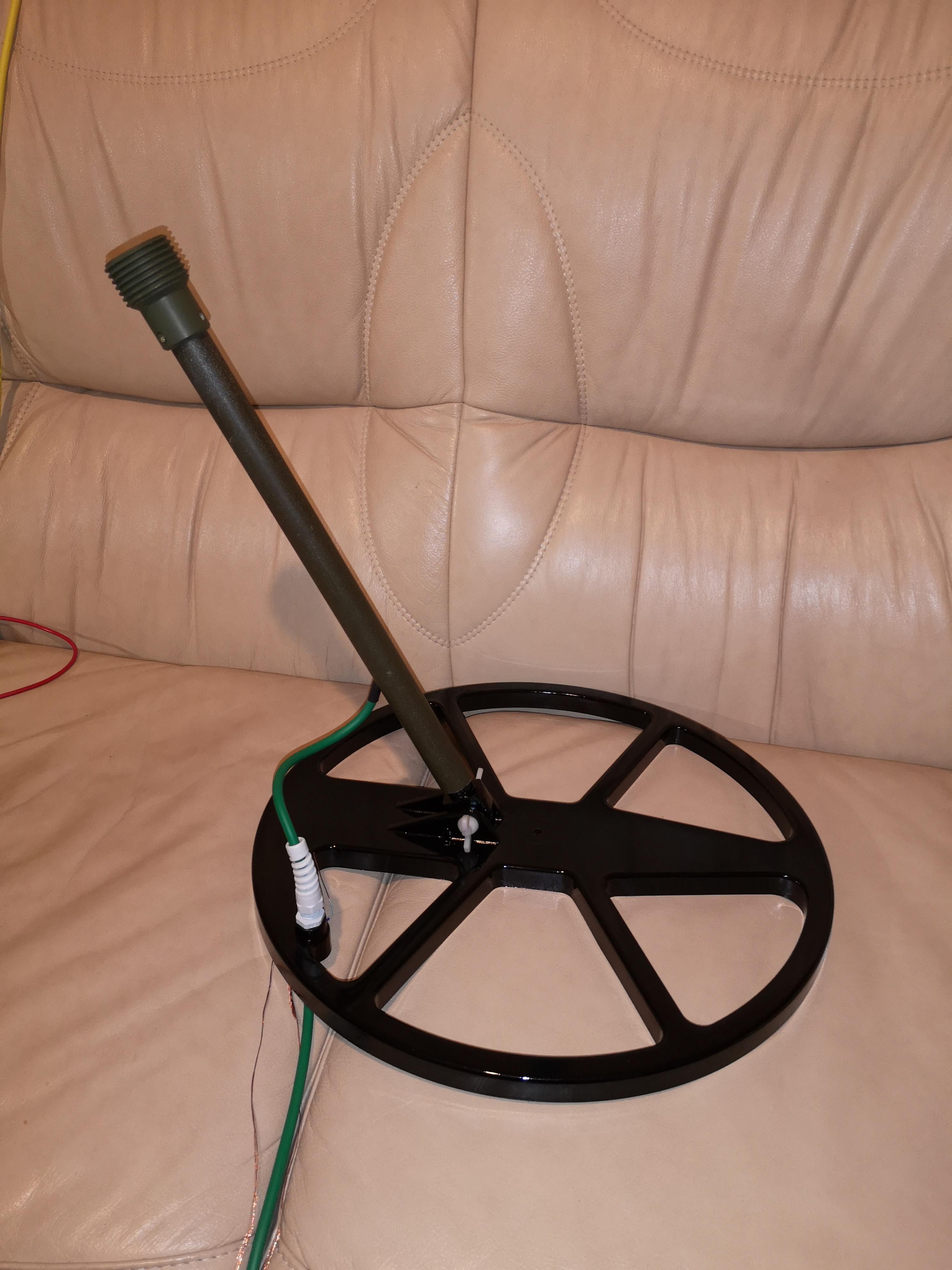

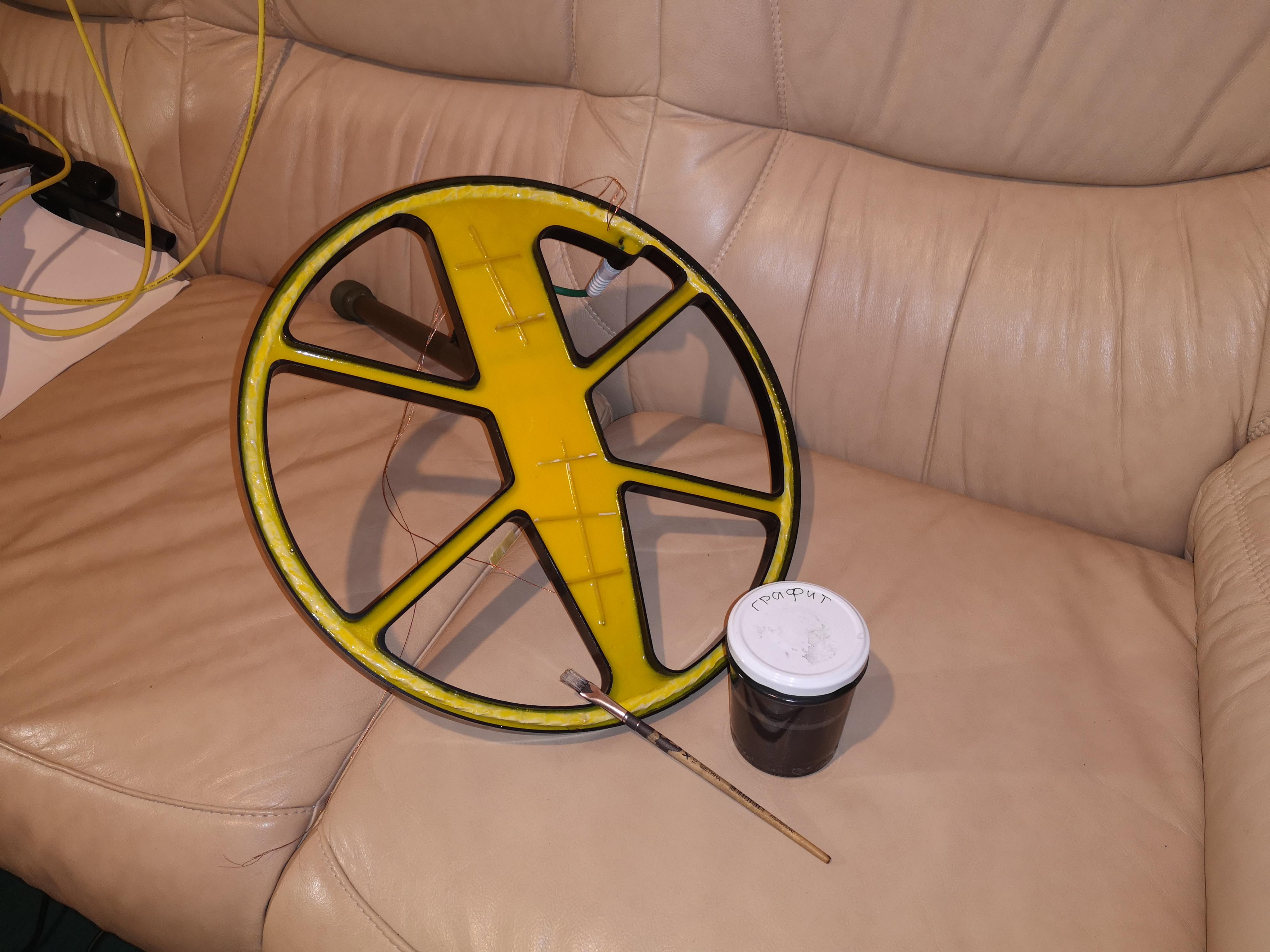

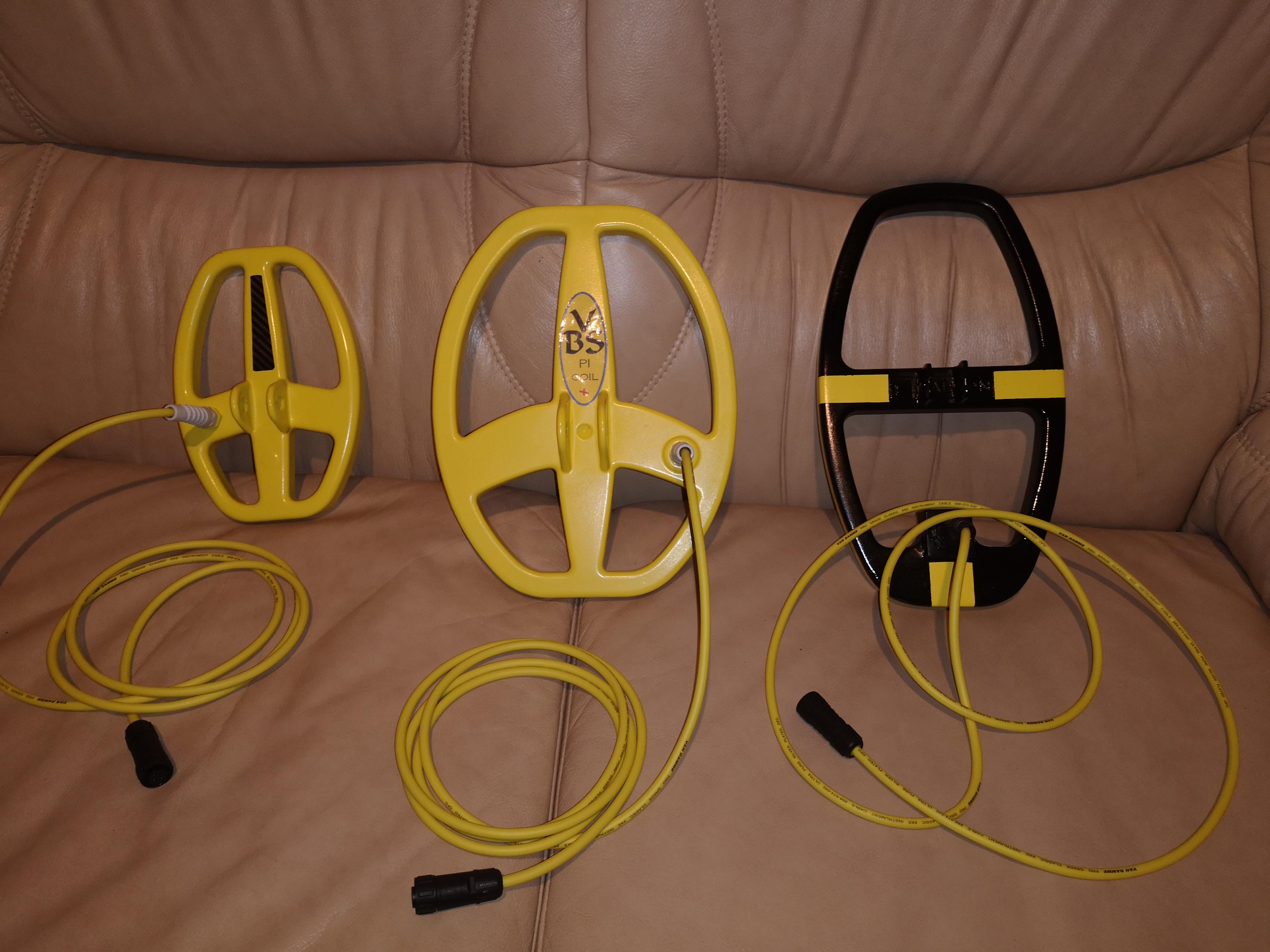

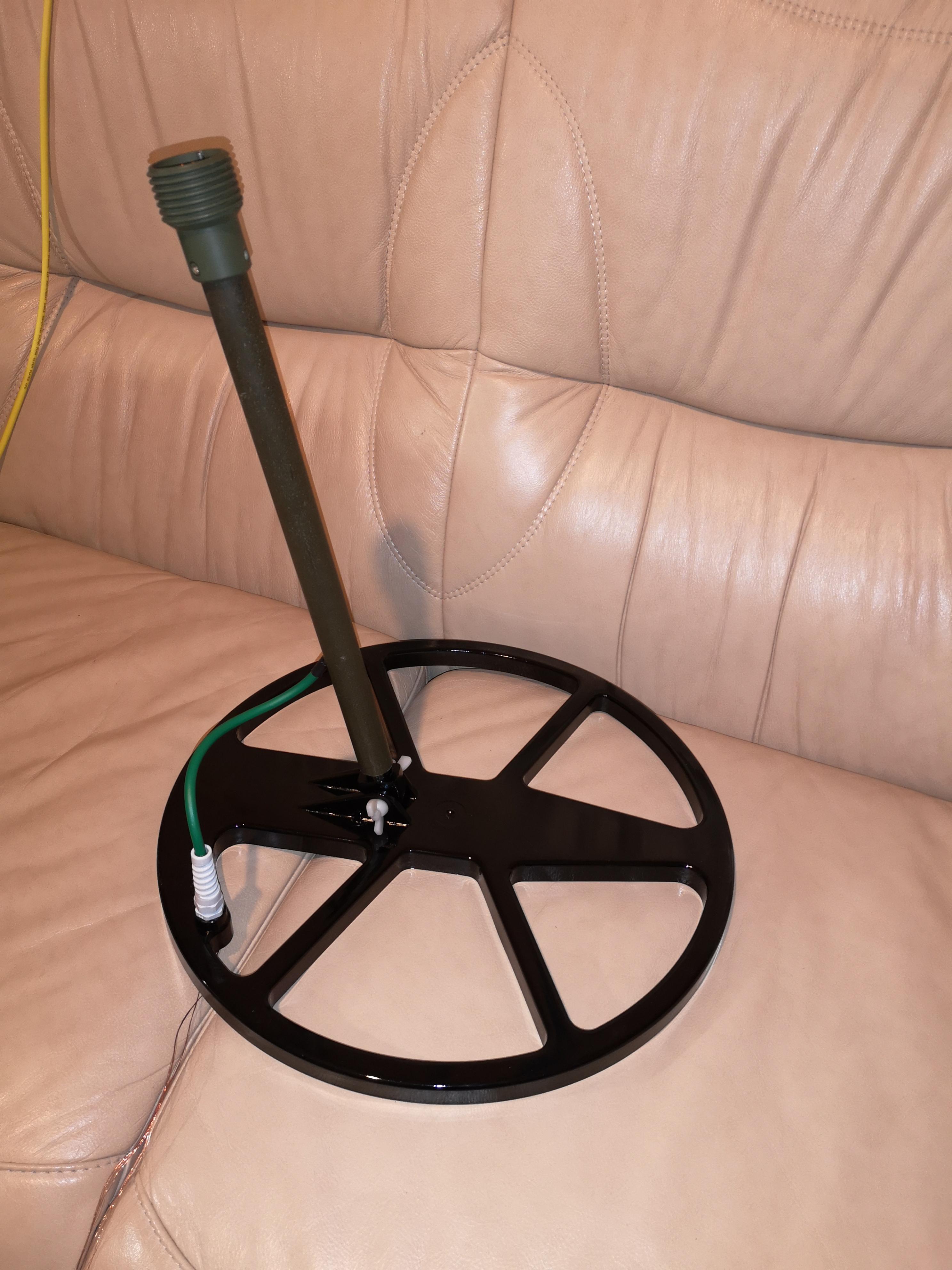

                      • Three coils are completely ready and are waiting for the opening of the hunting season.
                        The average coil 27x21 cm is more sensitive than the original 30.5x17 cm.

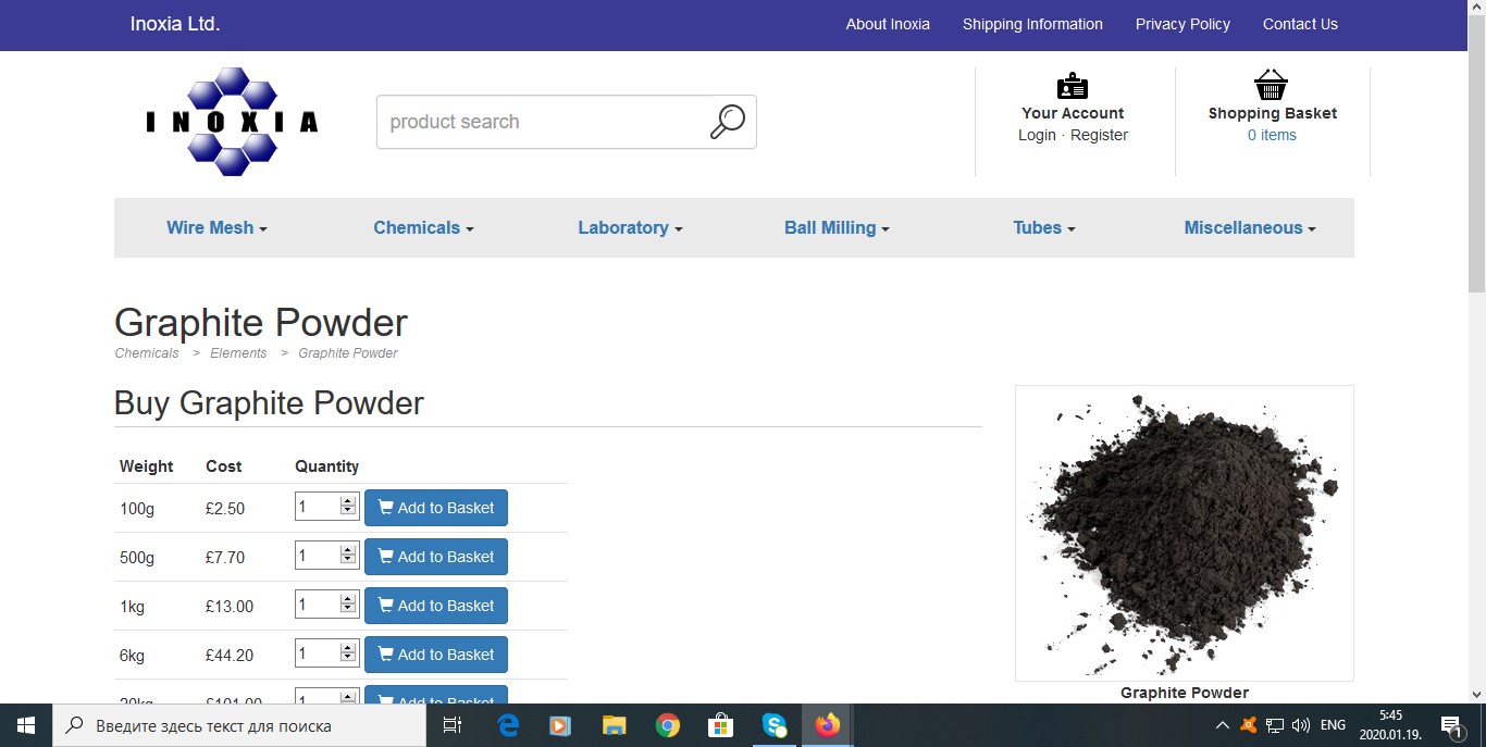

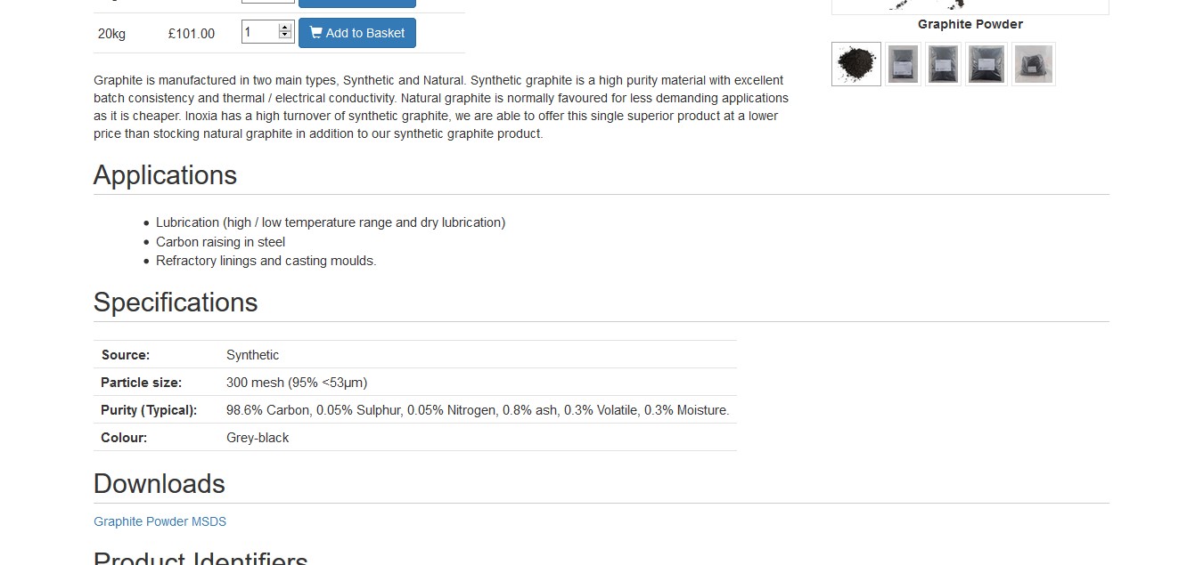

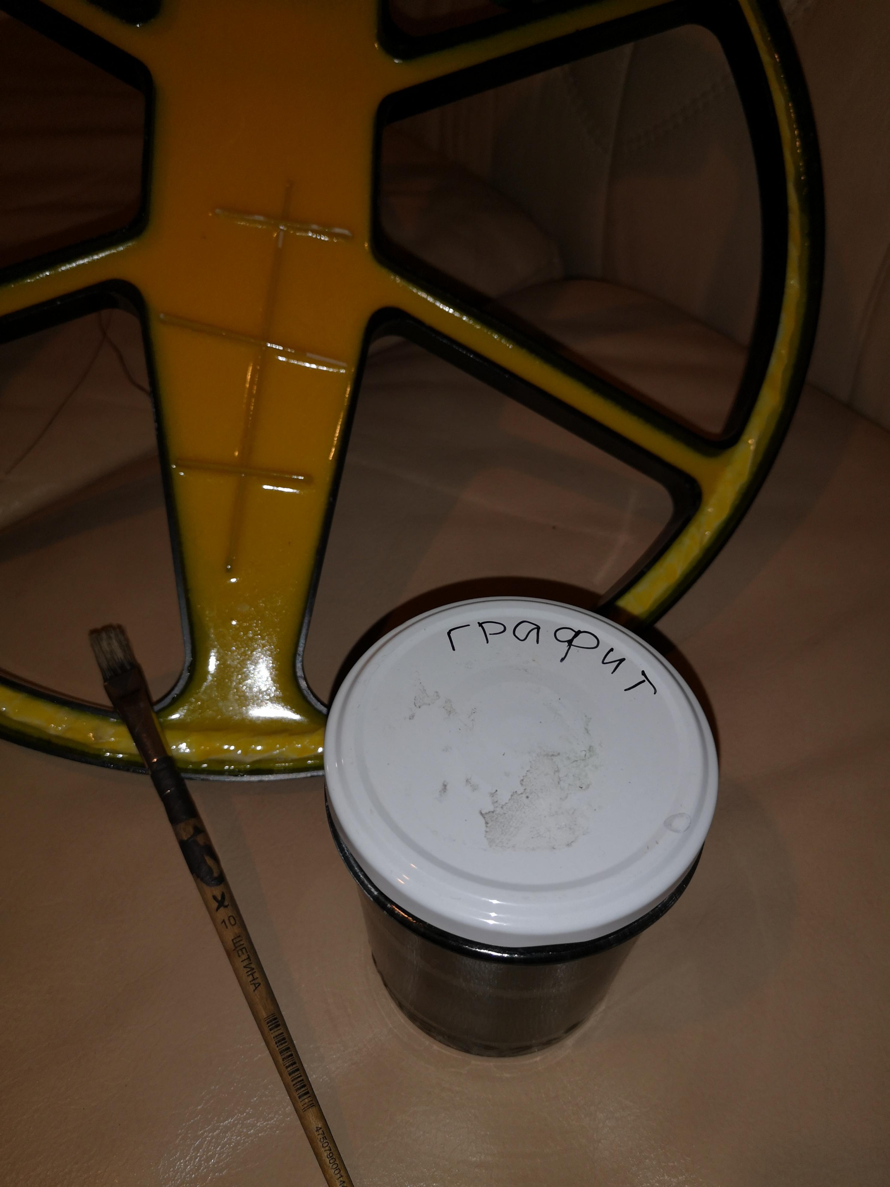

                        • What graphite product are you useing ?
                          • I take from England.https://www.inoxia.co.uk/products/ch...raphite-powder
                            • Originally posted by Myntmaster View Post
                              [ATTACH]49231[/ATTACH]
                              [ATTACH]49232[/ATTACH]
                              [ATTACH]49233[/ATTACH]
                              Thank you, what are you mixing it with and what ratio, what resistance do you get ? thanks
                                Hi.
                                I make a graphite coating based on PVA glue B3 or B4.
                                After drying, the layer is completely water repellent. There are no special proportions. I take 100 ml. glue in a separate jar with a lid.
                                I sprinkle three teaspoons of graphite. Add one spoon, stir every time. Mixing thoroughly, I make control smears on paper.
                                It is necessary to measure after complete drying. If the resistance is in the range of 400-600 Ohms per 1 cm, then this is normal.
                                If the resistance is large, I add more graphite. If the mixture is thick or then slightly thickened, it can be diluted with acetone or solvent 646.
                                Store the finished mixture in a tightly closed jar. Stir well before each use.
