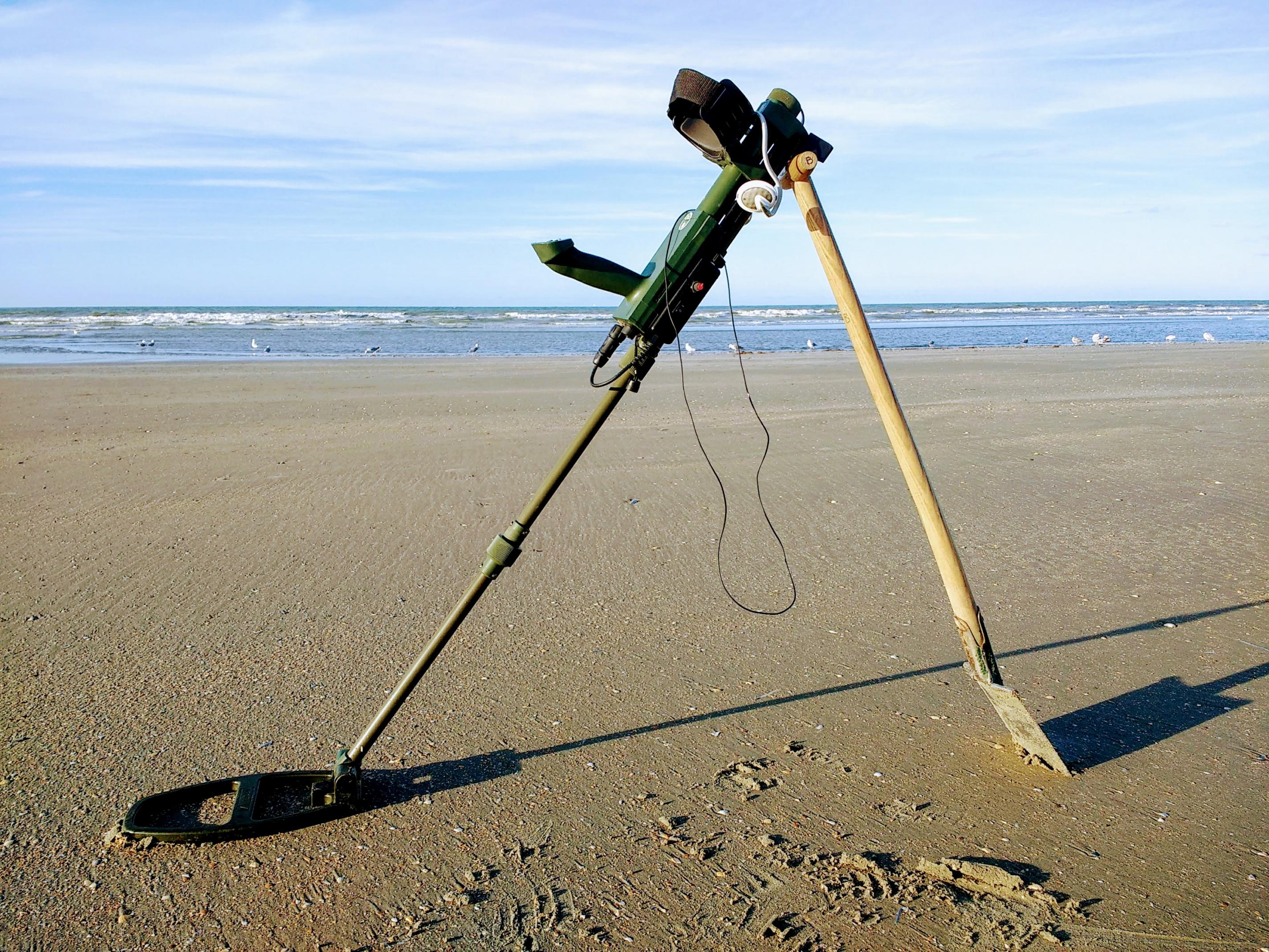

              • Hello Gents, new guy here. I started detecting a year ago so I'm still quite new at this.
                I've read through many pages and I'm fascinated. I currently own an Equinox 800 and I predominantly hunt the beaches of Long Island NY. I haven't read through the entire thread, so I don't know if my question has already been answered. How's the Vallon's depth on the beach compared to the Equinox. Reason I ask is because I'm interested in a buying a PI machine that can go deeper than my current detector but I'm on a budget and the Vallon would be great, if it can go deeper than my Equinox.
                Thank you!
                • The Vallon is a Great machine on the beach. It picks up Everything. And this is also its weakness as a hobby detector.
                  I don't have an Equinox, but the Vallon goes way deeper than my XP GoldMaxxPower eg.
                  When you are looking for a beach detector with great depth, the VMH3CS is the machine for you.
                  However, it is a PI detector without discrimination. You will dig a Lot of trash ! It was designed to detect a small firing pin of an anti-personnel mine.
                  This, combined with great depth may lead to magnificent finds of long buried items, but also to pain in the back after having dug a hundred holes with rusty nails, cans, ... and other trash.
                  I would never use the Vallon on farmland, but on the wet beach, this is definitely a winner and for me personally, this is the only machine I use on the beach.
