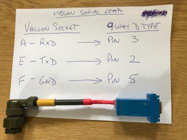

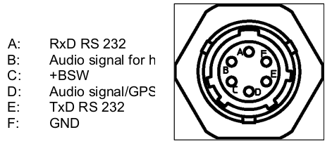

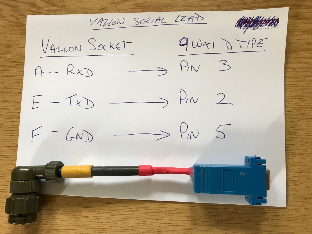

                            Can anyone explain how to link a regular 9 pins DB9 RS232 plug to the six pins plug on the vallon ?
                            FRom : ... to...

                            • Something like this.
Name:	Vallon serial lead and pin outs.jpg
                              • Love it. Thanks a lot !
