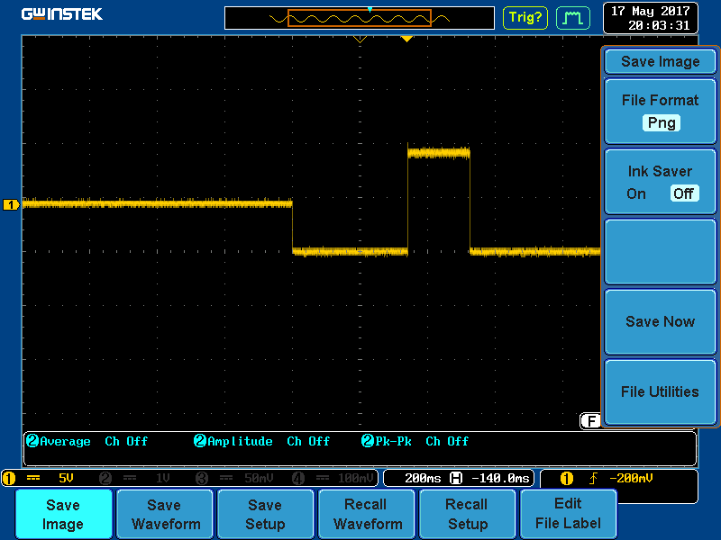

                  • I fixed the twisted housing issue quite easily thanks to Eric's suggestion, looks much better.
                    Had the scope out for another project so thought I would take a peek at the serial data lines to see if they were active.
                    I didn't connect to RS232 port on my computer as it was getting late and I have no idea if the boot loader is active and didn't want to chance corrupting program memory.
                    However, A quick look at the TX line, at power up, it pulls up to roughly 5v then a few ms later pulses low then returns to 5v.
                    no other activity.
                    Ill setup with a terminal program and proper connections when I get time and try a few things out

                        • I had another quick look a the RS232 communications IO tonight and there is not much to report unfortunately.
                          The TX pin just cycles once on switch on as per attached pic.
                          After switch on, pin toggles to -5v for 340ms then pulses to +5v for 180ms and returns to -5v and stays there.
                          I did try a few different combinations of baud rates etc but no change.
                          Even tried holding down different push button and combinations on power up but still the same.
                          Ill try a few more options but without a protocol or sequence its going to be difficult.
                          It may be this particular unit, might be this series does not have RS232 enabled.
                          If someone else could try and have a look at the waveform, see if it matches then it would help narrow things down.
Name:	Vallon TX_RS232.PNG
                          Brian
                          • Apologies, should have said, RS232 voltages are correct so nothing wrong with the port.
                            Essentially, it transmits 0 and waits...for what character(s) that is the question
                            Brian
