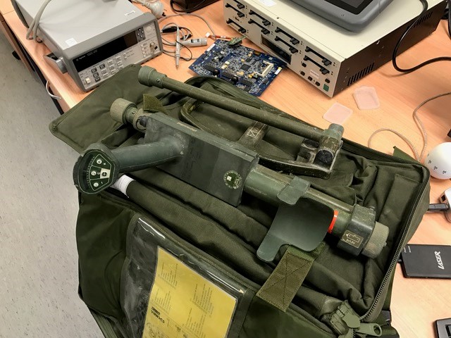

                    Well the unit arrived today, packed well, looks well used, even has a funny hand written message for one the operators...

                    • Originally posted by Mdtoday View Post
                      [ATTACH]39738[/ATTACH]
                      What does the message say????

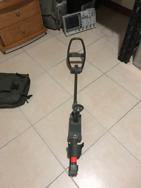

                      • I gave the Vallon a quick air brush, purchased some batteries, switched it on and followed instructions to adjust sensitivity etc, took it out side and gave it a quick test.
                        It all works as I thought it would, no problems electronically so that's a great start.
                        The only thing I'm not certain of, is that the electronics housing seems to be offset or twisted on the shaft, I don't think it is normal.
                        It looks like you could loosen the bottom housing screws and twist it back to be more central to coil but not sure? see attached pic.
                        The thing is quite stable even at high sensitivity, yeah it chirps around at the high settings and I don't think you would run it this high all the time BUT.. it appears to be a very stable detector all the same.
                        I will give it a good clean as per Eric's suggestions and do some investigations on the signals with the scope, just so I know for future reference, what things should look like.
                        I'm particularly interested to see if the serial data stream is active, what data is sent, what format it is and what handshake (if any) is required.
                        Not sure how useful it would be but have to have a look. I'll post up findings once done.
                        So anyway, first impressions, yeah, its a great piece of kit, I'm happy with it but I can see a lot of holes being dug for small junk iron so Ill have to learn to tune into this beast.
                        Ill take it out to the diggings on the weekend, see if i come home with a sore back or some booty

                        • Originally posted by kingswood View Post
                          Haha, yeah, the message says " This ones only for the strong, so not for you Turner $$&&$?$$ "
                          Guess the last word
                              Hi Brian,
                              Yes, slacken off the 3 screws under the housing. On some I had to clean out compressed dust from the screw head. The screw at the coil shaft end should have a black plastic key in the gap which engages with a groove in the shaft to stop any relative rotation. I had a unit with this missing which caused the coil to be out of line. Worse still, one had the bottom of the key sheared off by that strong soldier. If the complete key is there then there is sometimes a bit of slack to stop it aligning properly.
                              What I do is to get a flat level surface and stand the detector on it with the coil at right angles to the shaft and pointing upwards. Put a spirit level across the top of the main case and adjust until level by rotating the body, with the screws just slightly slackened off. When the bubble shows that the box is level, tighten all screws.
                              Eric.
                              • Eric: Did you notice the clean spot on the body of Brian's detector body? Also the red lable on the battery tube. Could this be a UXO?
