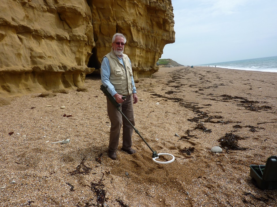

                    Last Friday morning I took the Vallon to a local beach for tests. It is not the best beach as it has quite a slope with little difference between high and low tide. A storm the previous day left the surf rough and generating a lot of noise. It also piled the sand up close to the cliffs. We went to the waters edge at first to test the effect of a wet beach. On the default high sensitivity, non-mineralised setting, the detector worked fine with no false alarms. The first signal dug was a small copper item shaped like a bead and about 4mm diameter. Various other small bits of metal, some lead fishing weights etc, but nothing significant. We retreated higher up the beach as the noise of the surf made it hard to hear the built in speaker. Headphones would be best in this situation, but the one piezo phone on a headstrap as supplied is not the best to wear. I need to fix up a proper set of piezo phones for the Vallon.
                    The next task was to bury coins and the first was a UK 10p buried in the wet gravelly sand at 10in. No doubt at the strong response from that, both with the stock coil and my 11in one. We then raised the head five inches and the 10p was still audible. The sensitivity was raised to max. and with my coil we got 17in and Vallon coil 16in.
                    Using a US nickel; we recorded 13in with Vallon coil on default sensitivity and 15in on highest sensitivity. My 11in coil gave an extra inch on both sensitivity ranges.
                    Back home the Vallon coil would not detect a 1in square of aluminium baking foil but would detect a 1.5in square at 8in. My 11in coil would only detect the 1.5in square at 3in. The detection of low conductors seems to fall off very sharply and seems more dependant on coil size than I have noticed before, with other PI detectors. It will however, easily detect a 4mm diameter phosphor bronze ball and a 0.3gm gold nugget with the Vallon coil but the 11in coil gives less range on those targets.
                    It is early days yet and I need to go to a better, flatter and sandier beach. Also, I need to compare the Vallon with a couple of my other detectors such as the TDi and Goldquest SS.

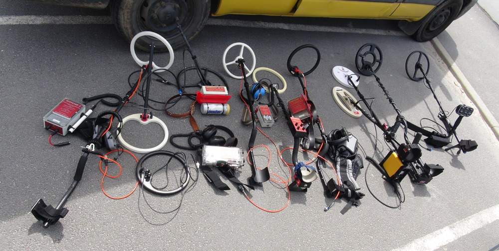

                              Aquastar & DeepStar 3 have the same card, 100us TD WIDTH for 3200 PPS.
                              Goldquest SSV3 have a 10 000 PPS for 30us TD WIDTH.
                              Goldscan 5c issue 2 or 4 100us TD WIDTH for 3200 PPS. (but not the same amplification stage than deepstar 3)
                              TDI pulsescan is basically the same as the "goldscan 5c" but this is only theory. The reality is that there are many little secret goldscan that have not been included in the TDI.
                              After having spent several years develop and test the equipment across the French coastline with passionate people of eric materials, we can talk a little about that. Click image for larger version
                              For french beachcomber is the 5c goldscan is best but can not be found, The sound is better thanks to its VCO and stability of the treshold. (2 analog channels for treshold),
                              The VCO also helps to feel the deep targets. There are a few more Current that is transmitted into the ground and the magnetic field is stronger!
                              The goldquest SSV3 has the advantage of many pulses, which allows for excellent integration, and to be sensitive to small constant target time.
                              However the disadvantage is that the differzential integrator window of noise and the Earth's magnetic field is very close (because the pulses are closely spaced).
                              Causing decrease signal to the targets of higher time constant (coins, big ring etc)

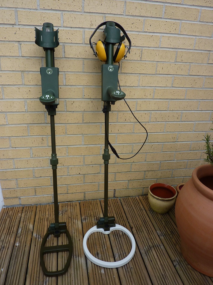

                                After the beach trip with all the surf noise, I fixed up a pair of old piezo phones for the Vallon. The audio was much too loud and raucous using a straight connection so I built an inline attenuator and filter to knock off the corners of what is almost a triangular waveform on the scope. You can of course turn the audio up or down with the + and - buttons, but when you switch off it defaults to loud when you come back on again. It is nice and sweet now. When the phones are plugged in, the internal speaker is muted.
                                To make the phone connection, I cut off and used the connector and 10in of lead from the single headstrap phone supplied. Then I made a housing with strain relief glands each end and two resistors and a cap. inside. The single phone won't be wasted as I will modify it into a bone phone for a diver held version I am planning.
                                The unit on the left in the photo has an improved armrest although they are both 2010 models.
                                The Vallon beats my Goldquest SS V3 hands down on a nickel but the Goldquest has no trouble seeing the 1in kitchen foil with 10uS delay The foil disappears at 25uS delay, so I figure the Vallon must be at least that figure, which is good for the wet beach and underwater.
