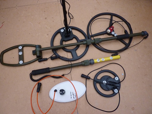

                I decided to test the various coils I have made for the Vallon to see what the spread in resistance, inductance, and resonant frequency is. Coils tested were (1) the stock 6 x 10 inch truncated elliptical that comes with the Vallon. (2) 15 inch, (3) 12 inch, (4) 7 inch, (5) 9 x 4.5 elliptical and (6) the ferrite cored probe.
                Resistance ohms------- Inductance mH------- Resonant f kHz.
                (1) 3.5------------------- 1.473------------------162.06--------- Full length Vallon cable to electronics input.
                (2) 3.9------------------- 1.506------------------207.66---------RG58 coax.
                (3) 3.4------------------- 1.455------------------183.49---------RG58
                (4) 3.2------------------- 1.512------------------174.45---------RG58
                (5) 3.7------------------- 1.435------------------173.97---------RG58 with orange polyurethane outer. (underwater version).
                (6) 4.2------------------- 1.798------------------179.36---------RG58
                The Vallon coil (1) has the lowest resonant frequency and I wonder how important this is. Also, it is the only coil that uses Scotch 24 wire mesh as a shield, as seen in a cross section from a broken coil, whereas all of mine use woven copper, or nickel plated copper, fabric tape. The Vallon also has a long length of coiled thin coax which would add to the capacitance.
                The probe (6) inductance is rather high and it only worked with the addition of 1 ohm in series with the winding. Very stable and low noise pickup as a result.
                The new mystery is that the Vallon coil will not detect a 1" square of kitchen foil anywhere, but my 12" coil does. No great range, but a definite 1" on the coil axis and also signals positive adjacent to the coil edge. It is a true mono and not wound as a dual field as the shell might suggest.
                Eric.

                  (1) calculates 750 ohm Rd, (3) calculates 839 ohm Rd. (pi*L*F res) KingJL schematic reply#1749 has Rd at 800 ohms. Would that difference be enough to cause (1) to not detect the foil?
                    Actually it is 820... look on the bottom side of the damp MOSFETs.
                      "... and also signals positive adjacent to the coil edge...
                      Eric."
                      I noticed this same effect on my 10 1/4".

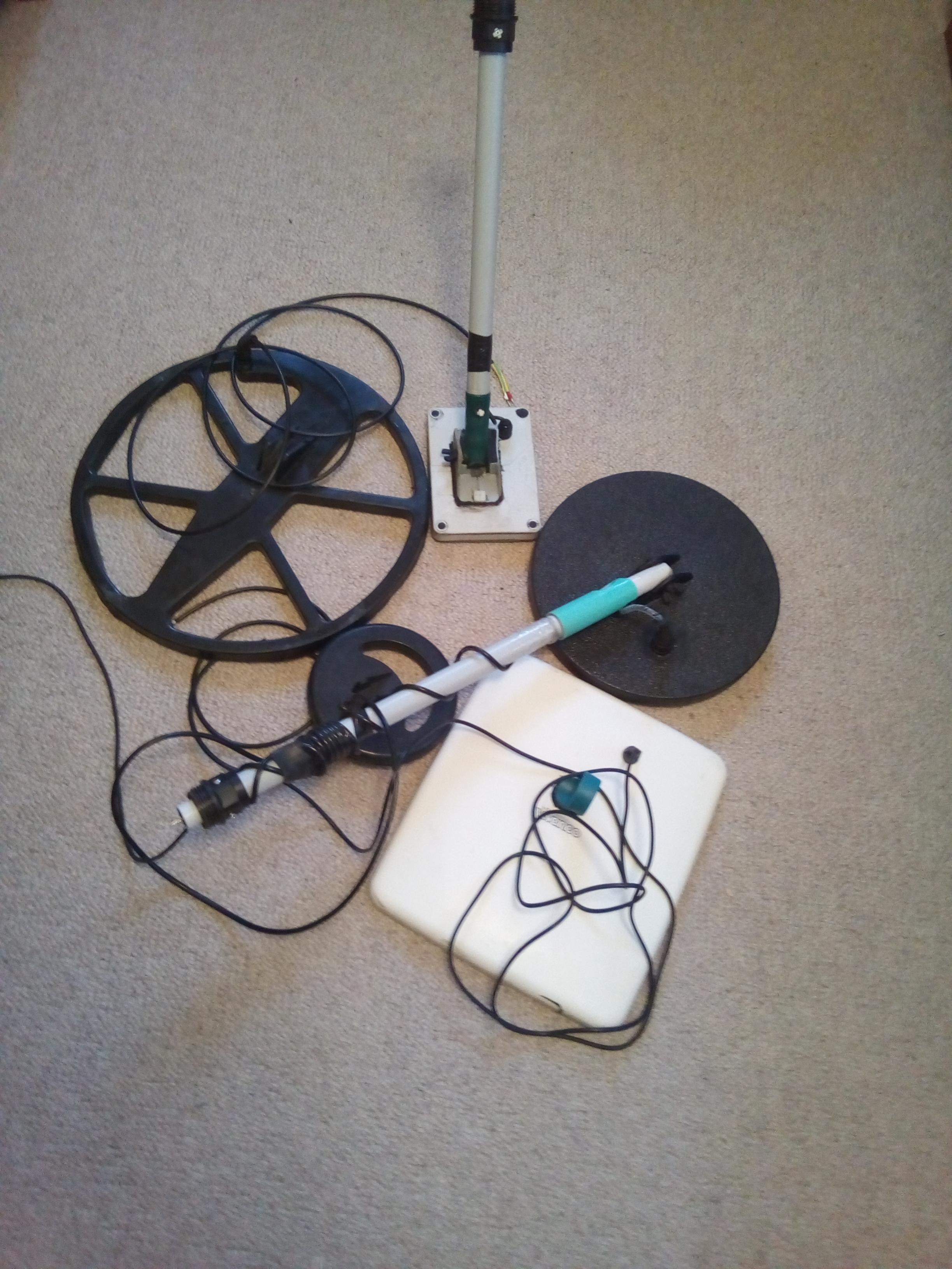

                            • I use helical wound 5mm copper tape with conducting adhesive and soldered wire lead. No overlapping.
                              Measurements:
                              5x6 rectangular teflon 7/0.22 1.14 mH added 1ohm resistor at connector 3.6 ohm supper quiet rg58
                              4 inch round enameled 0.4 0.8 mH added 1ohmresistor to get 3 ohm noisy, but works rg58
                              10 1/2 inch round teflon 7/0.22 1.26 mH 3.3 ohm rg58
                              12 inch rectangular 7/0.22 1.56 3.6 ohm rg58
                              15 inch round 7/0.22 1.36 3.3 ohm rg58
                              Measurements without factory cable in Vallon. I use original Vallon. 2008 Vallon will work with all custom coils. 2009 I have will not work with 10 inch and 15 inch.
