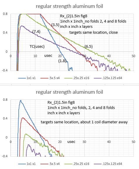

                            Charted some data to see if I could understand why 1x1 inch foil not detected when folded pieces could be detected. When you first replied that 1x1 inch foil wasn't detected(earlier in the thread) I guessed it was because the coil TC(L/Rd) was greater than the foil TC. Probably not correct if ferrite cored probe has the same TC as normal vallon coil. Except for amplitude the two charts(different target distance) look similar. Thinking might need to try with a 8inch coil. With each double fold the TC should double, Not to far off with 2 and 4 folds. Like you I had a hard time with 6 folds. Any thoughts other than trying with a 8inch coil? Not sure my tester would act similar to vallon, don't know why it wouldn't.
                            Forgot to label chart Y axis, log scale .4v/decade, 25mv in=0v out
                            Duh, 6folds not 8folds(chart)

                              Saw your post and quickly tried a 7in coil that I had previously made for the Vallon using a Whites shell. One inch square foil detected at 2.5" with two LEDs lit. I'm surprised the stock coil did not detect it at all. Will test again tomorrow.
                              Eric.

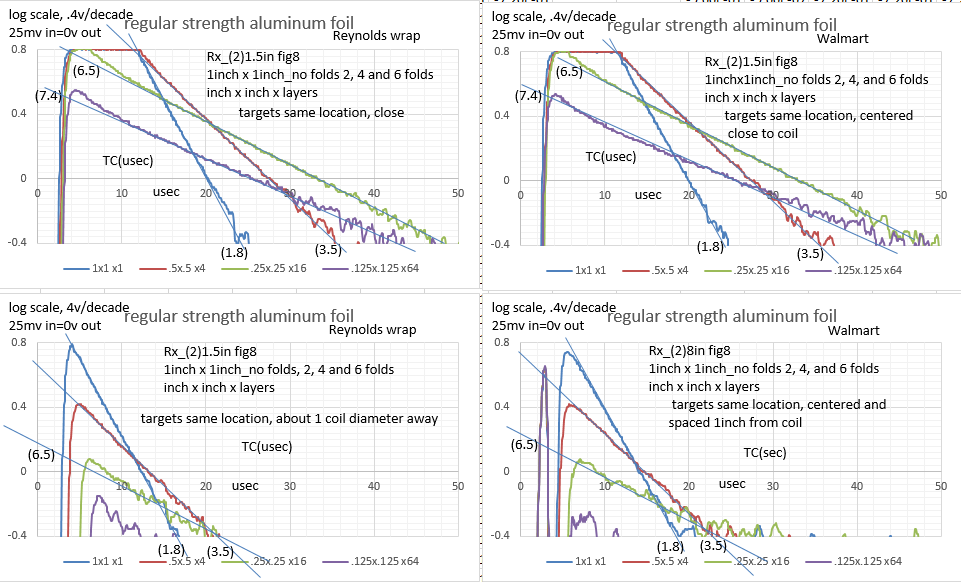

                              • Tried the 8in fig8. Thinking the slopes should stay the same, amplitude difference for the targets might be different for the 1.5 and 8inch fig coils. Corrected charts reply#1648(Reynolds wrap) and added two more charts. Upper right, repeat of upper left chart using Walmart brand foil, target distance might be slightly different than upper left. Lower right repeat of upper right with Rx_(2)8in fig8 coils. Decay slope lines(same for each chart)were added to each chart, decay slopes fairly close. Amplitude difference between targets for 1.5in and 8in coils are similar. Can see a signal for the 1/8 square 64layer target with the 8in coil but noise effects it too much to see slope. Charting log signal at amplifier out, integrator would reduce the noise.
