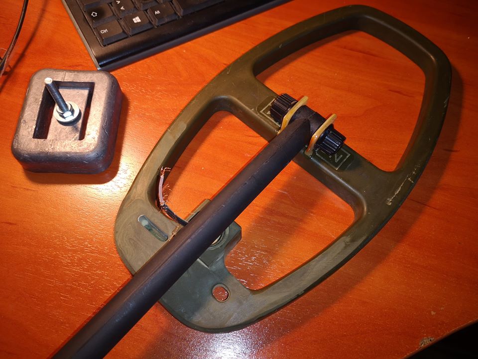

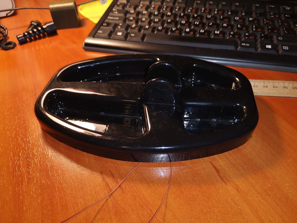

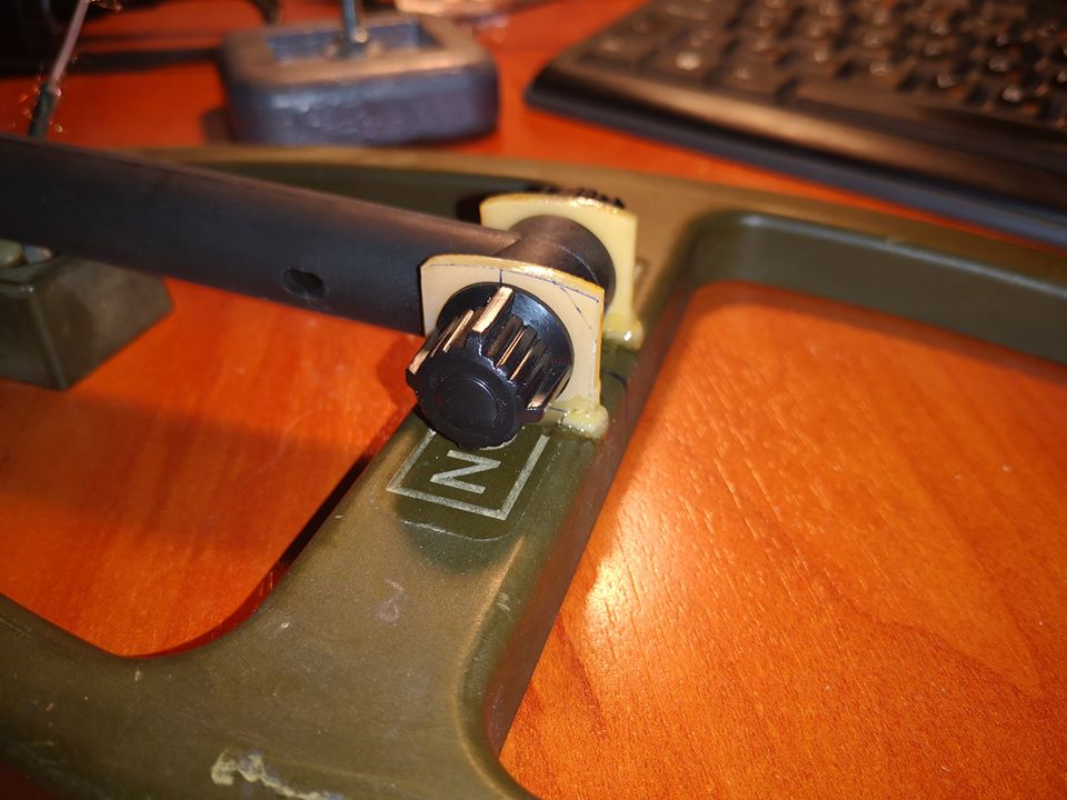

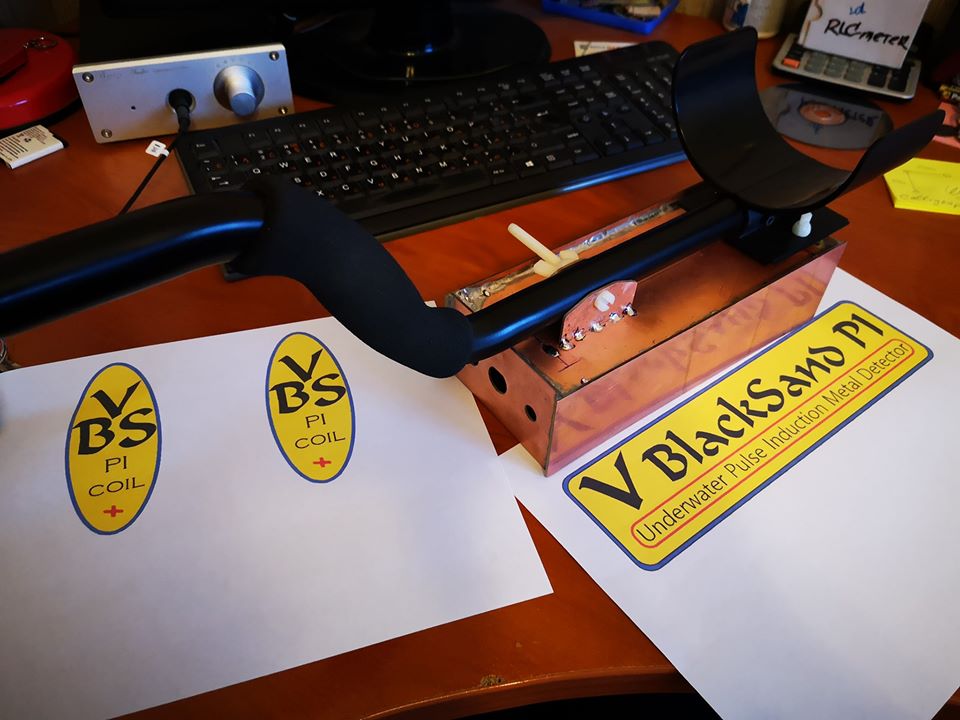

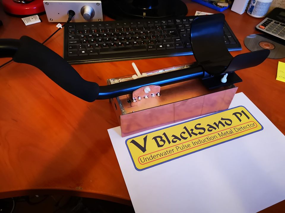

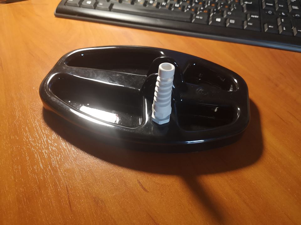

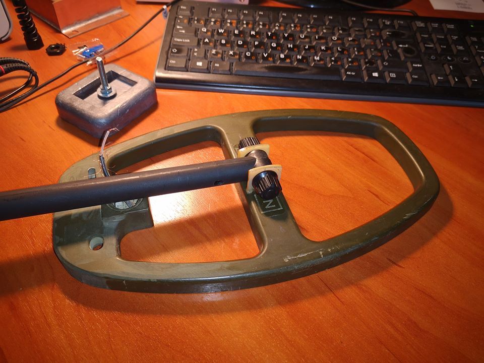

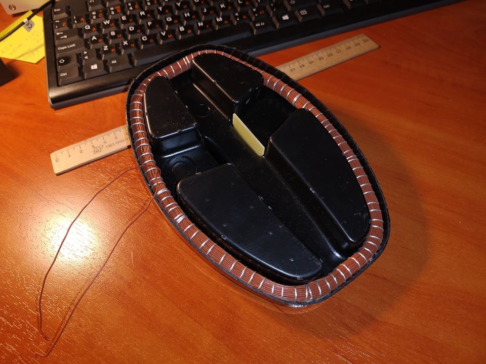

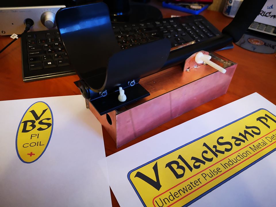

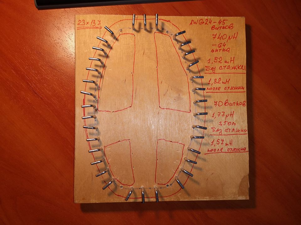

                            • I construct my underwater Vallon
                              Hello. I am slowly making my detector Vallon.
                              It will be used under water at sea, we still have a lot of gold jewelry under the sand, still with the whole USSR.
                              I chose all the electronics. I will install it in a waterproof case. There will be another detector rod. Power supply 7.2 volts 12A lithium.
                              I will make three more coils of different diameters. I will redo the original and will also use it.

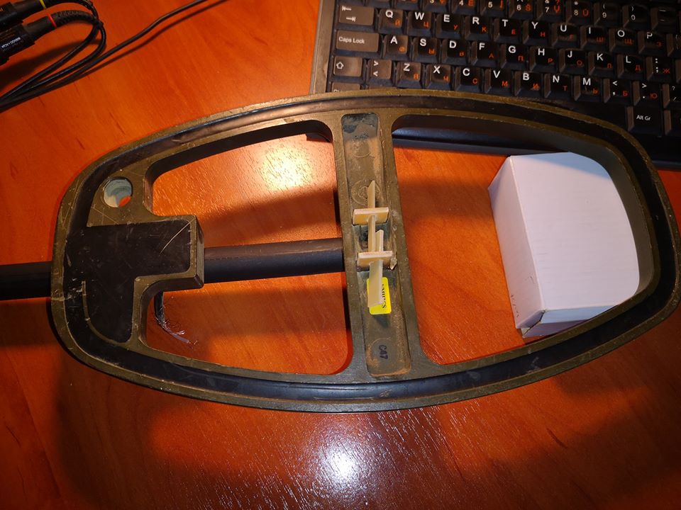

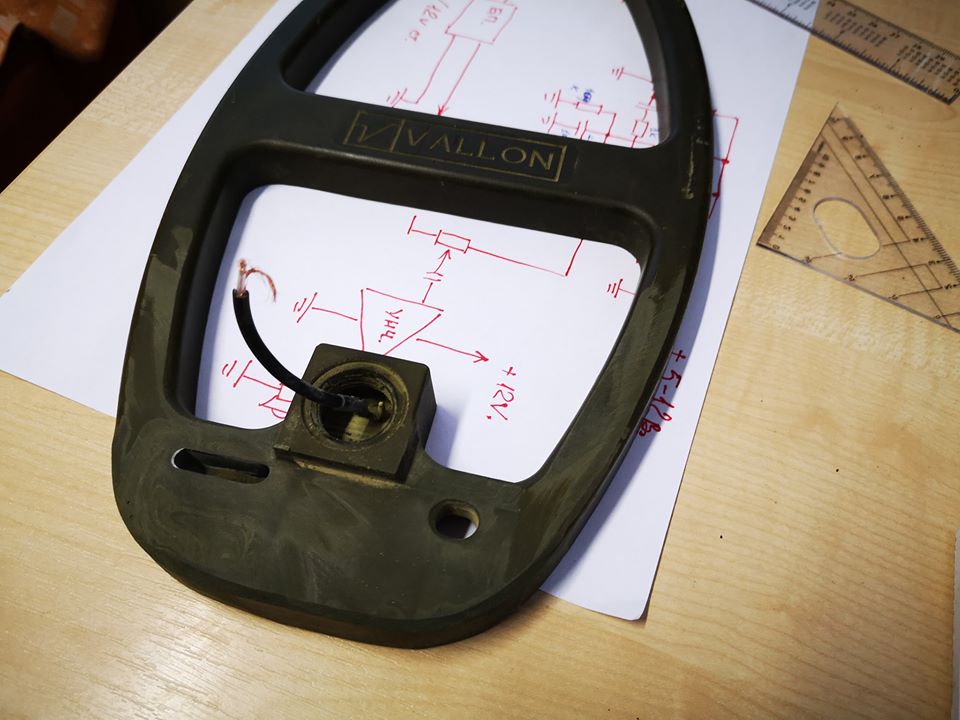

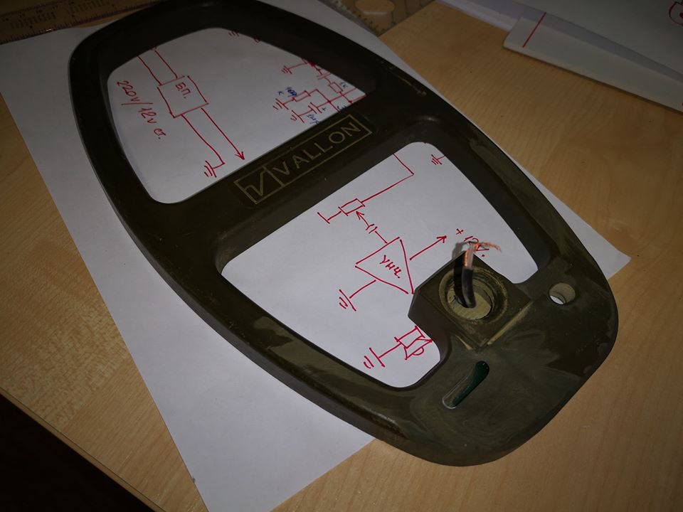

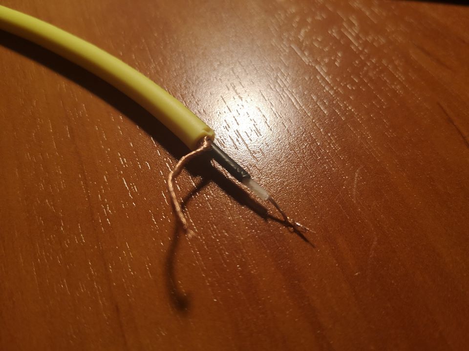

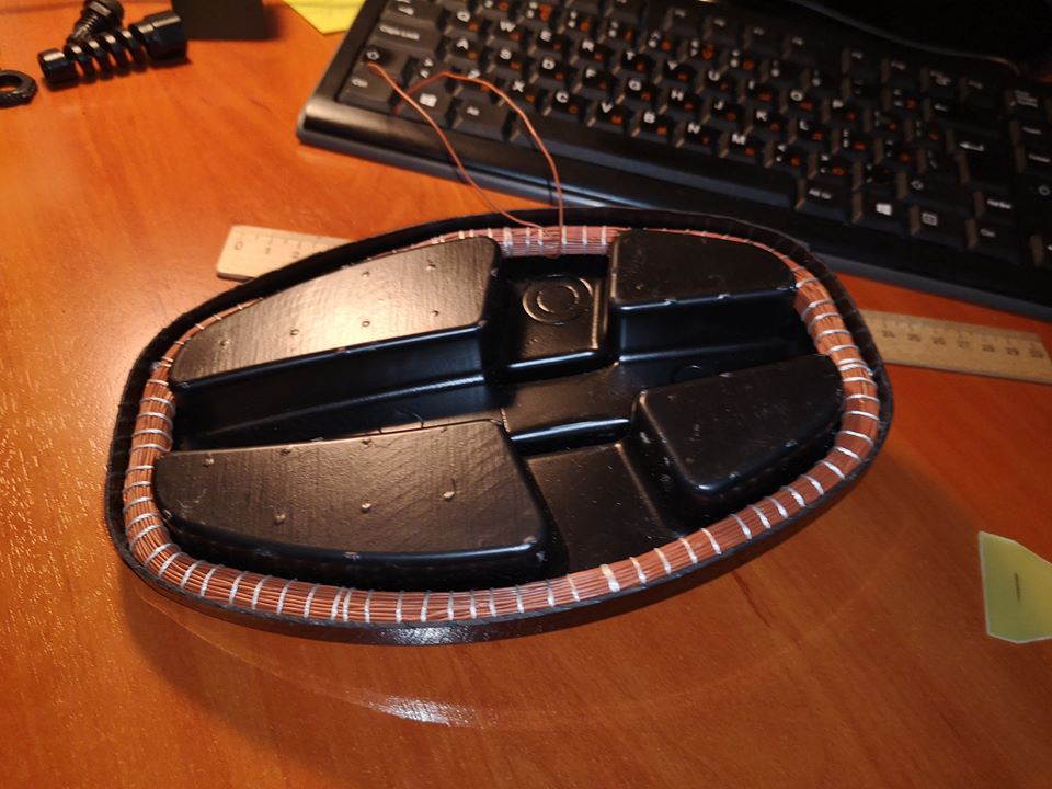

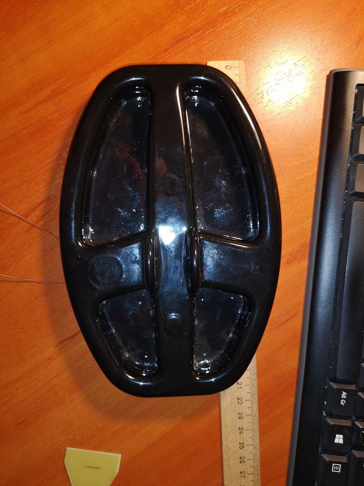

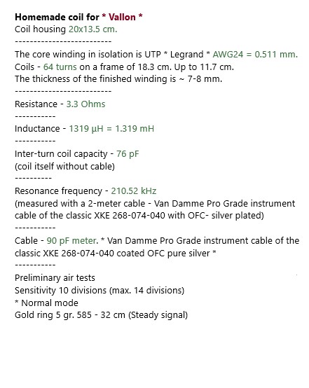

                              • Homemade coil for Vallon. Case cut-off size 20x13.5 cm. ~ 8x6 inches. Preliminary measurements.
