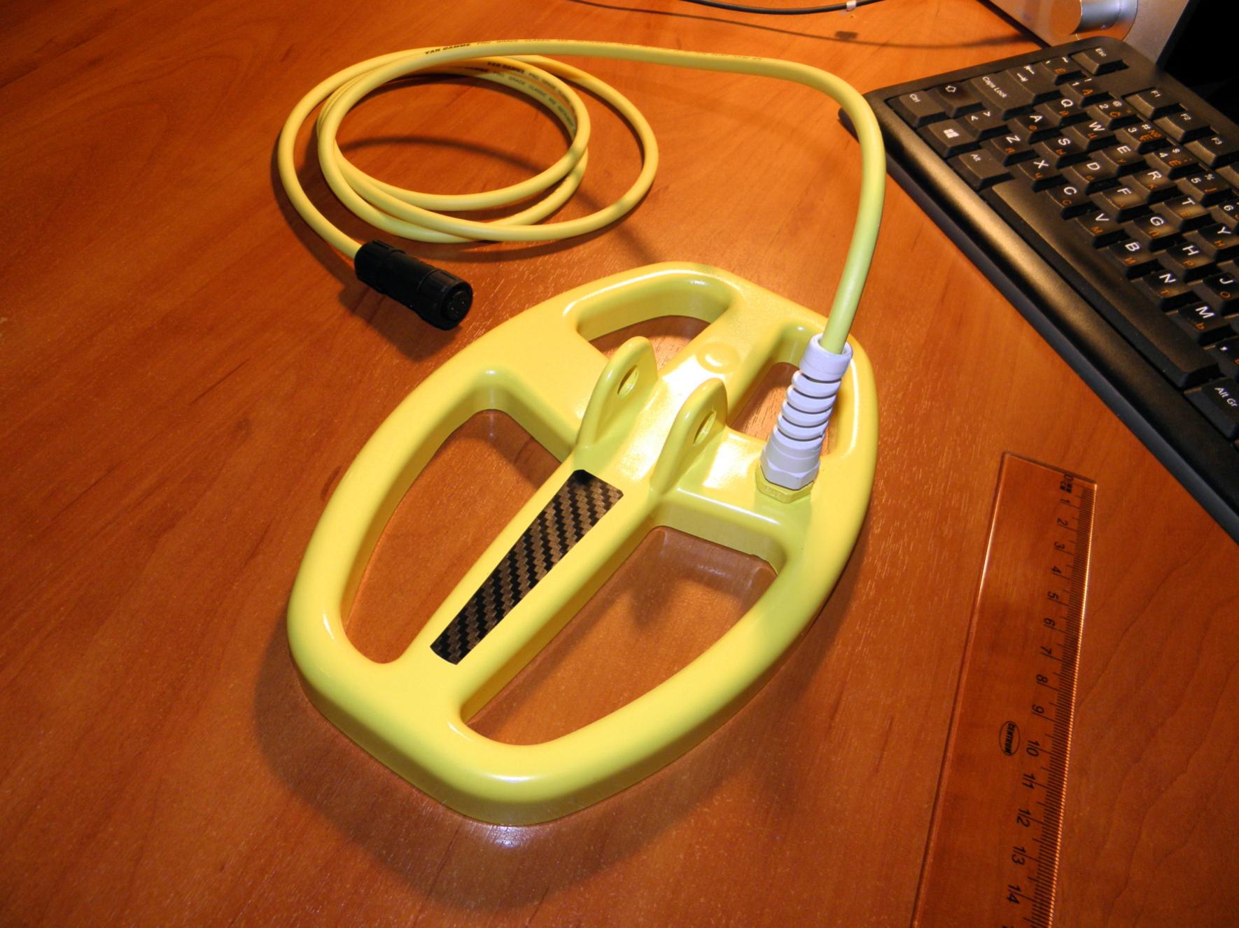

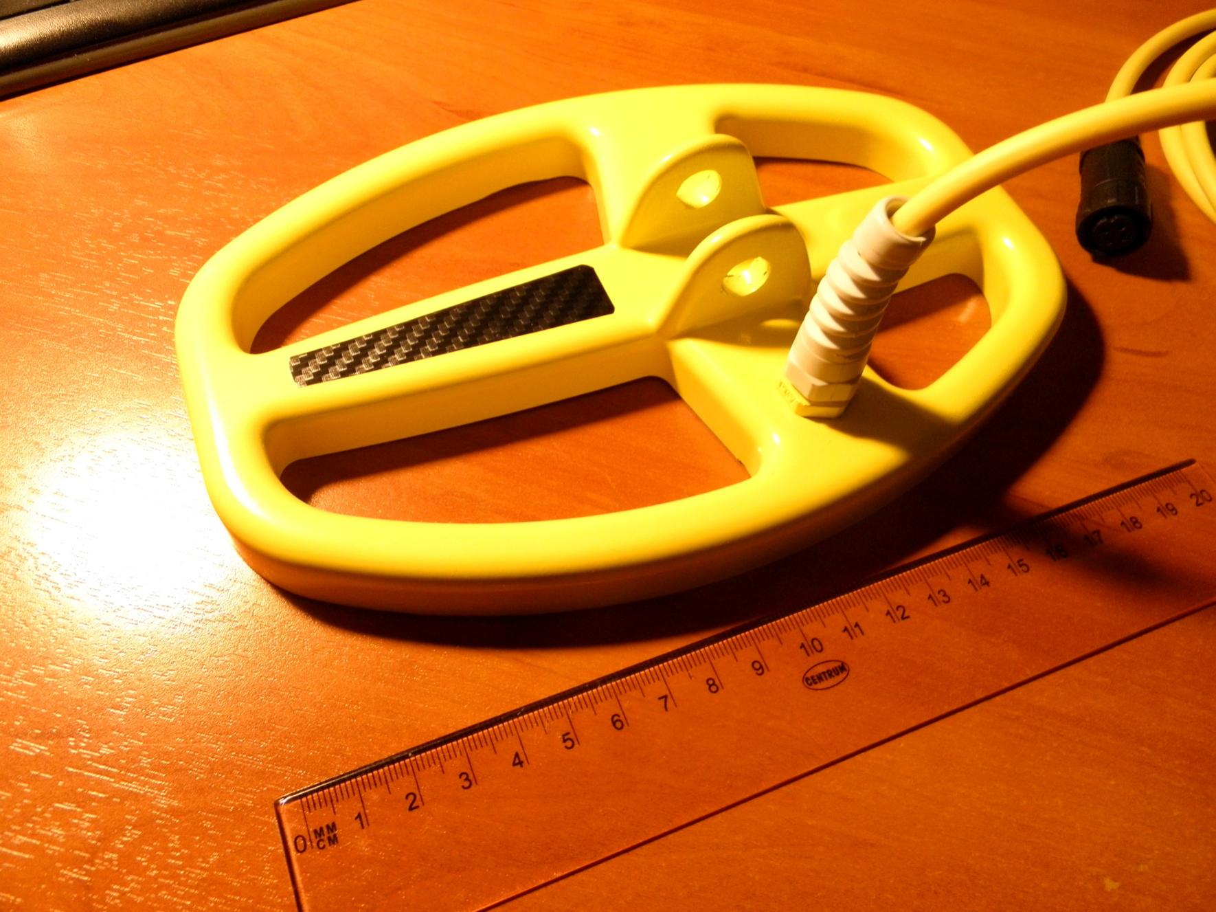

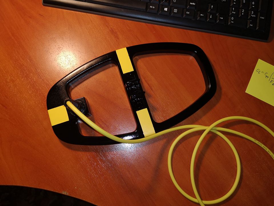

    Homemade coil for Vallon.
    Case cut-off size 20x13.5 cm. ~ 8x6 inches.
    Preliminary measurements.
    Good work. Pro look.
    Shown very clearly procedure used.

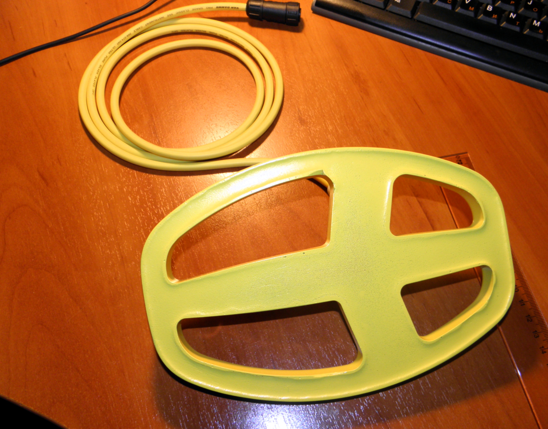

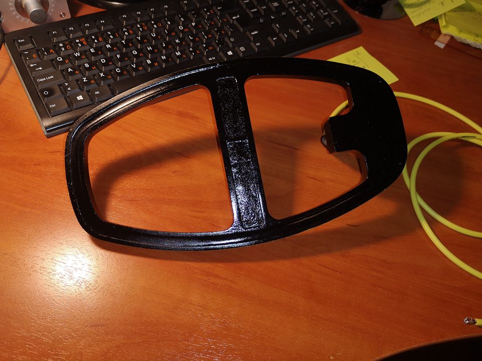

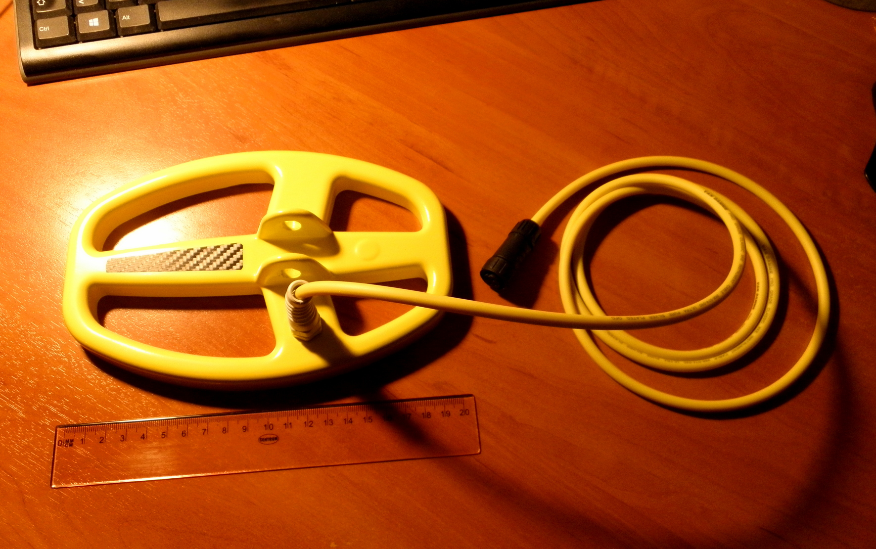

      Thank you. The original coil from Vallon, after alterations and painting. It remains to put the plug.

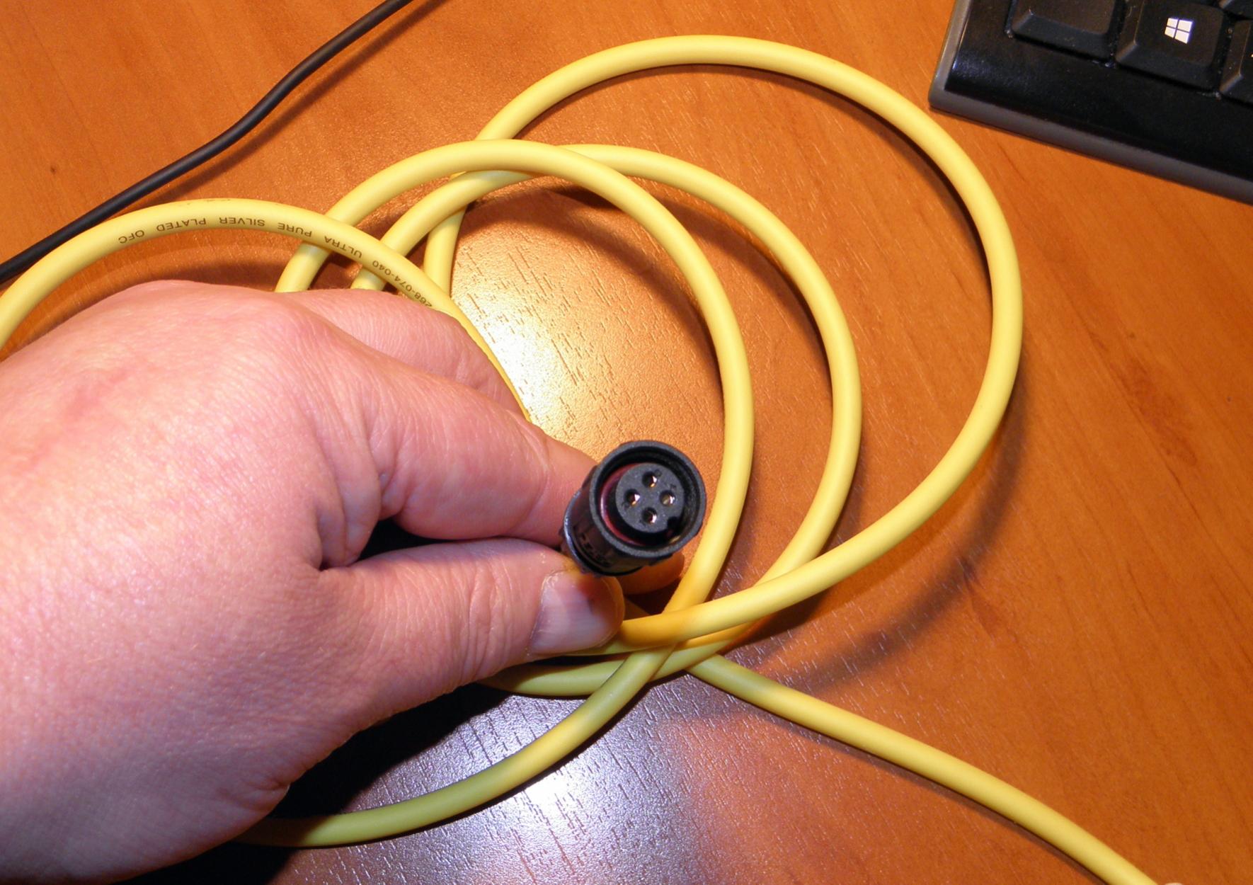

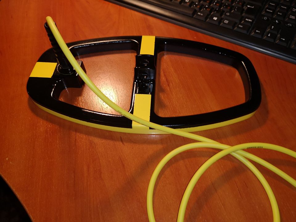

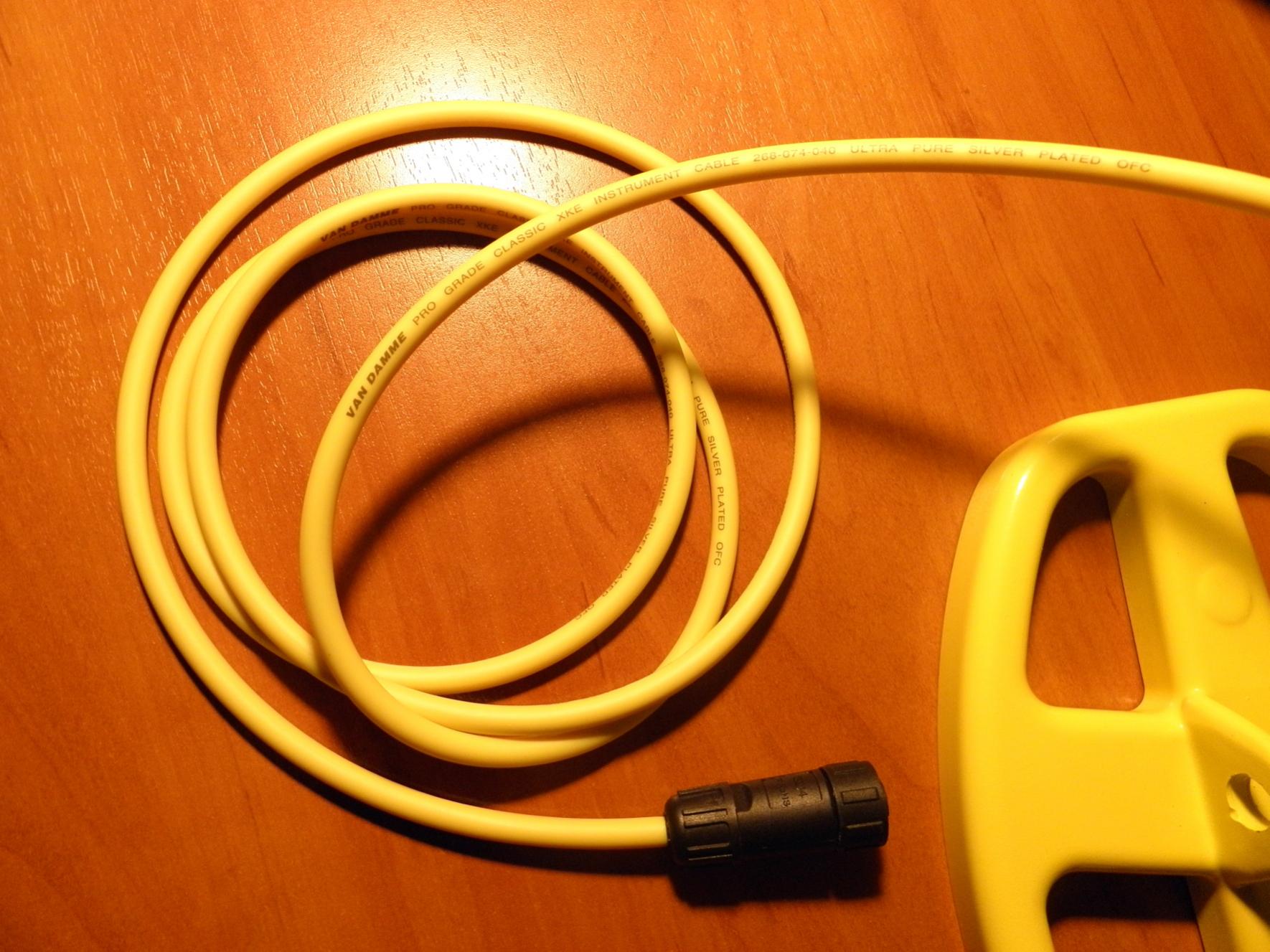

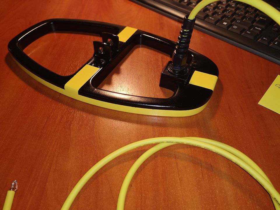

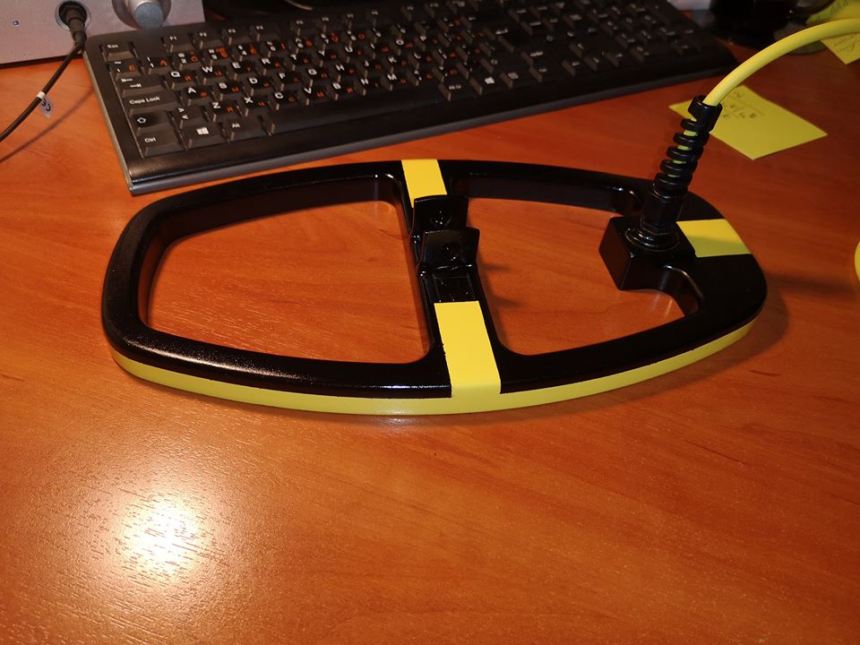

      • Finished coil for Vallon
        Fully finished and tested coil. The size on the plastic is 20.4x13.5 cm. = 8x5.31 inches.

        • Good work
          • Thanks.

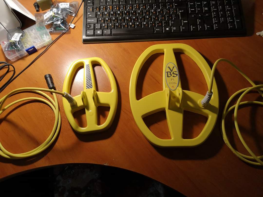

            • Air test of a homemade coil 20.4x13.5 cm. for gold jewelry and 5 rubles 1898.
              * Normal * mode, sensitivity 10.
              https://www.youtube.com/watch?v=rt-oq_S3lNQ
              • Very good videos, I appreciate. Your coil is performing very good.
                • Thank you.
                  There is still a lot of work.
                  We need to finish two coils of 27x21 cm and 38 cm. I hope that they will also be good.
                  It is necessary to catch the spring. The sea must give its treasures.

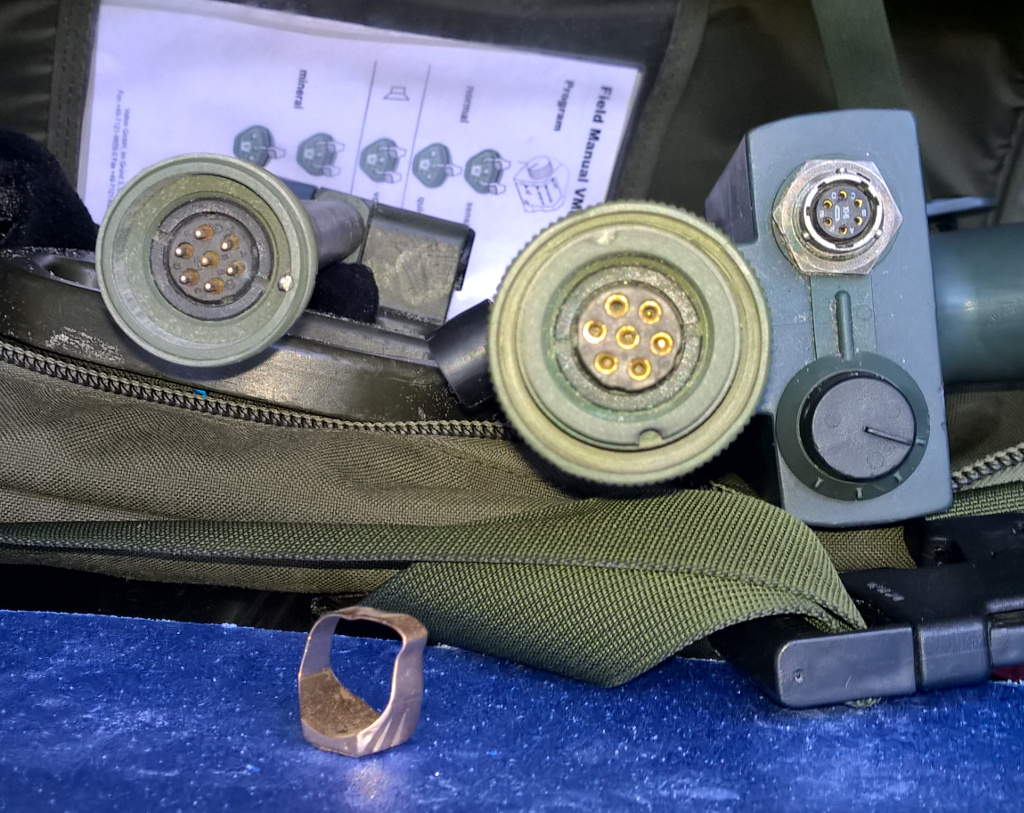

                  • Hello,
                    Lonf time since I did post here. Amazing finds with my Vallon. Love it. But it has now a wobble in the lower shaft. No matter how tight I screw it, the lower shaft will wobble. The worse is that this wobbling generates crackling, due to I guess, the movement between the male and female part of the 7 pins plug.
                    I'm a bit worried. Did I lose an O-ring ? I guess not - Can't remember if there was one when I bought it. Is the screw worn out ? Has anyone here experienced the same problem ? Here is a close up of the two plugs.
                    I hope I do not have to dismount the plugs to check for broken soldering...

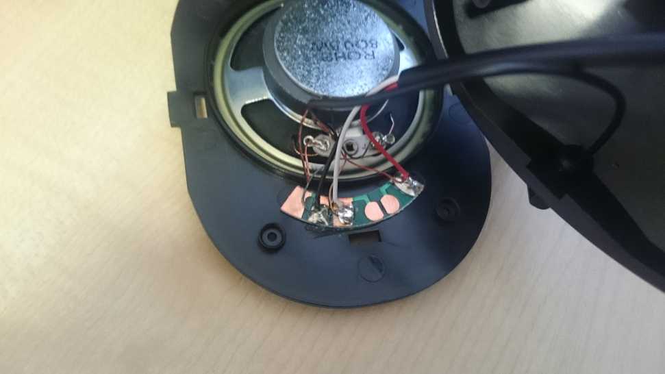

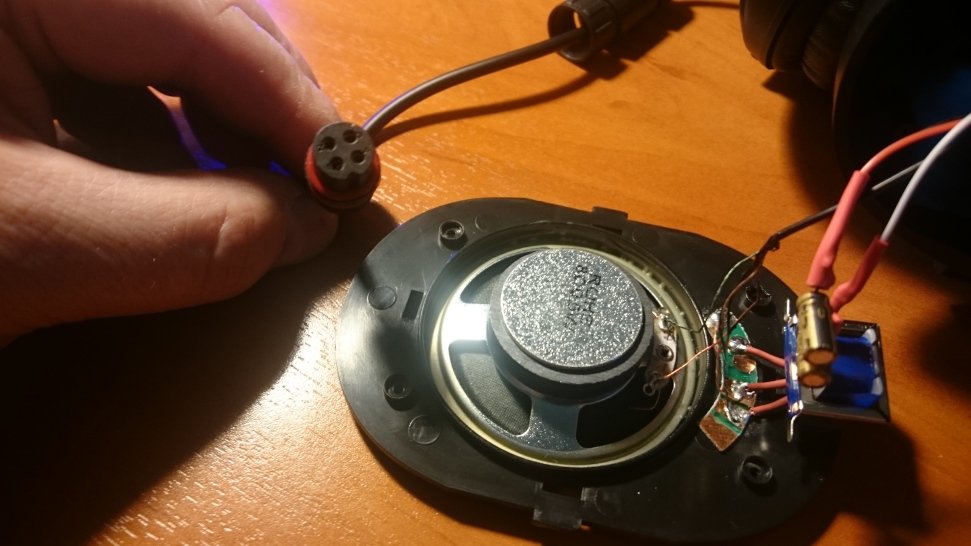

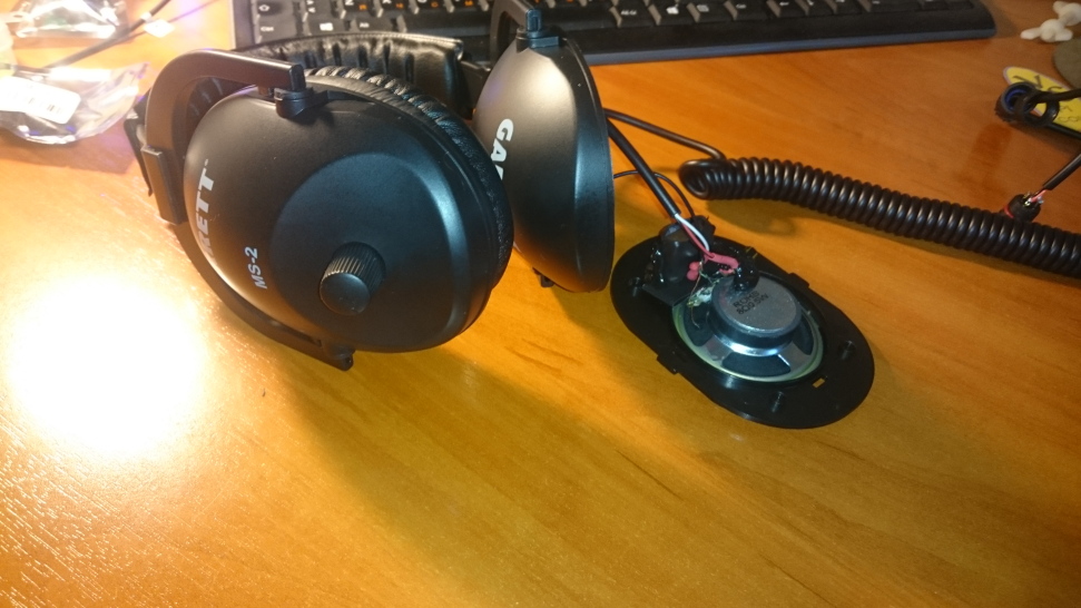

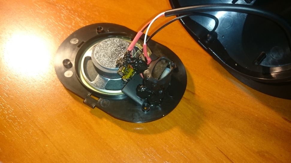

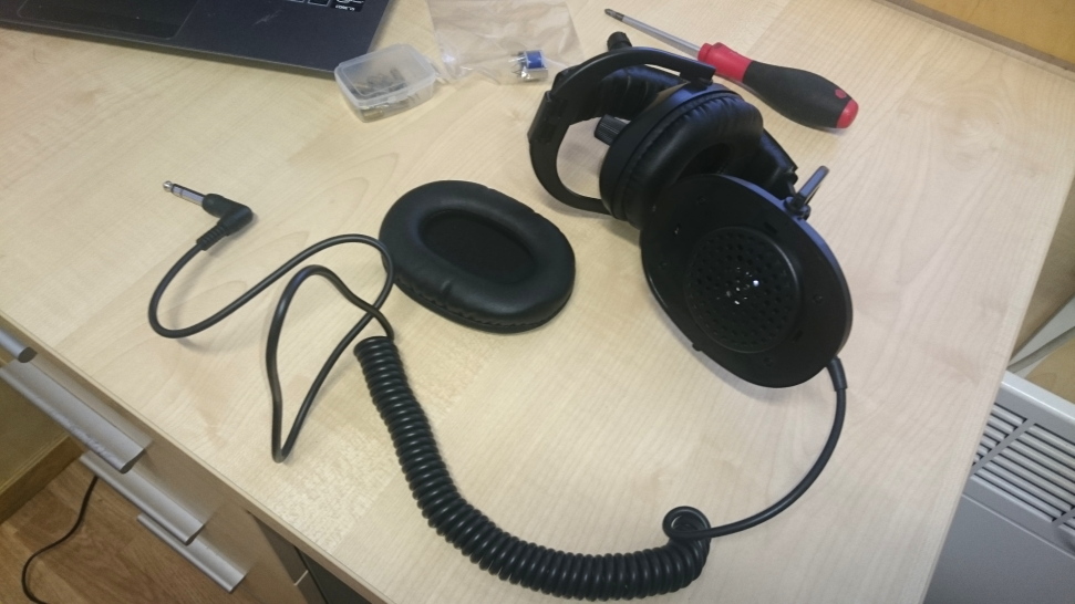

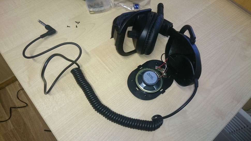

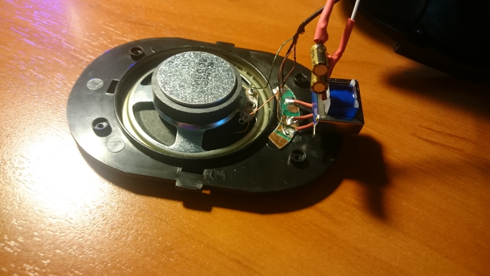

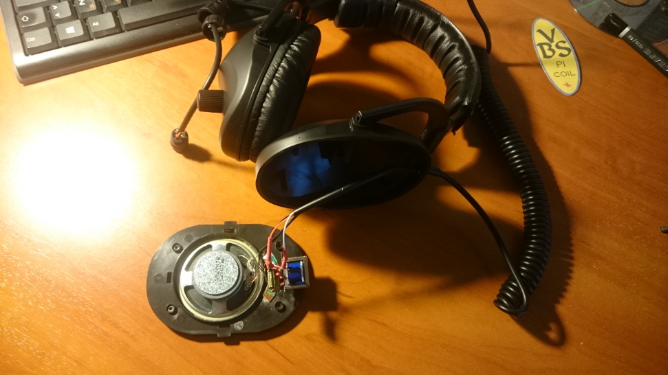

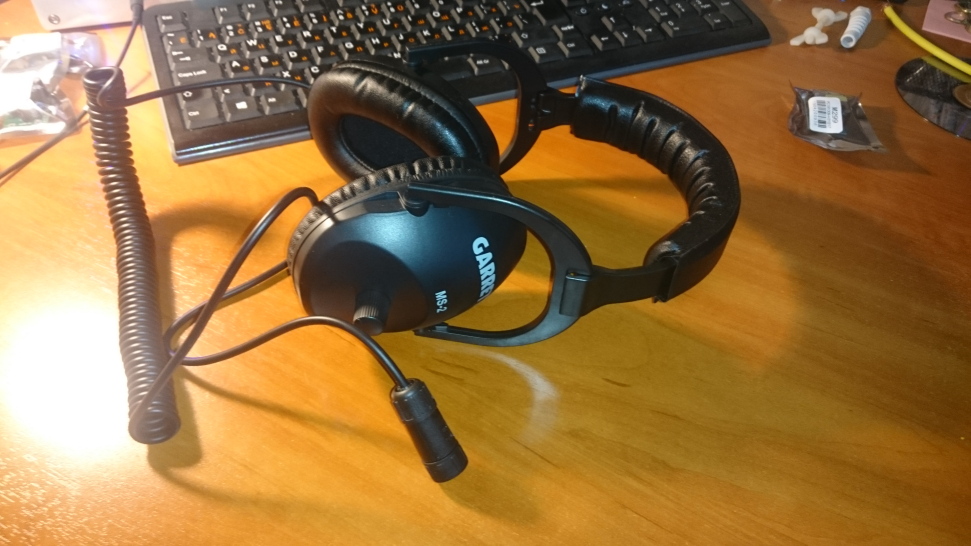

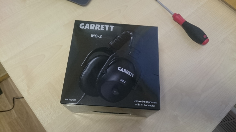

                    • Installing the LT-44 transformer in Garrett MS-2 headphones for direct connection to Vallon.
                      Headphones are terrible junk. The only plus is a lot of empty space in them.

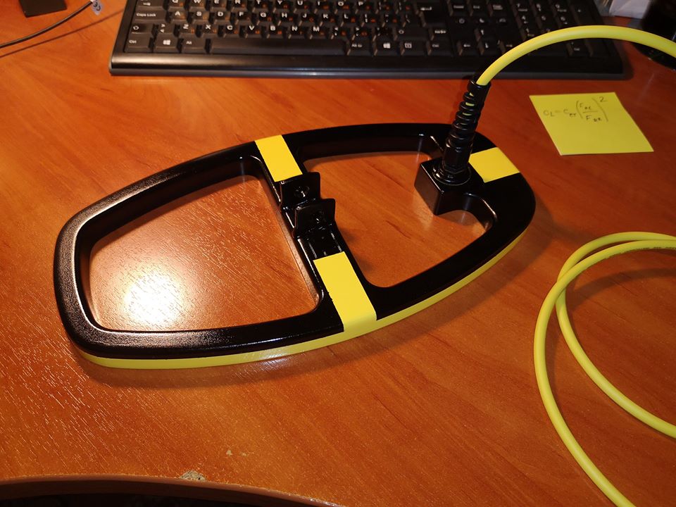

                      • Second larger homemade coil for the Vallon 27x21 cm.=
                        10.6x8.26 inches.

                        • I've tighten the screws that hold the male plug on the upper shaft. The wobble has lessen, but the cracklings are still there. In fact they are not cracklings, but like a weak signal when the coil change direction when searching. Any one has a clue about it ? The coil seems OK, as the machine would give an error message if faulty.
                          Also, I'm looking for a manual to disassemble the Vallon. If someone could provide a link...
