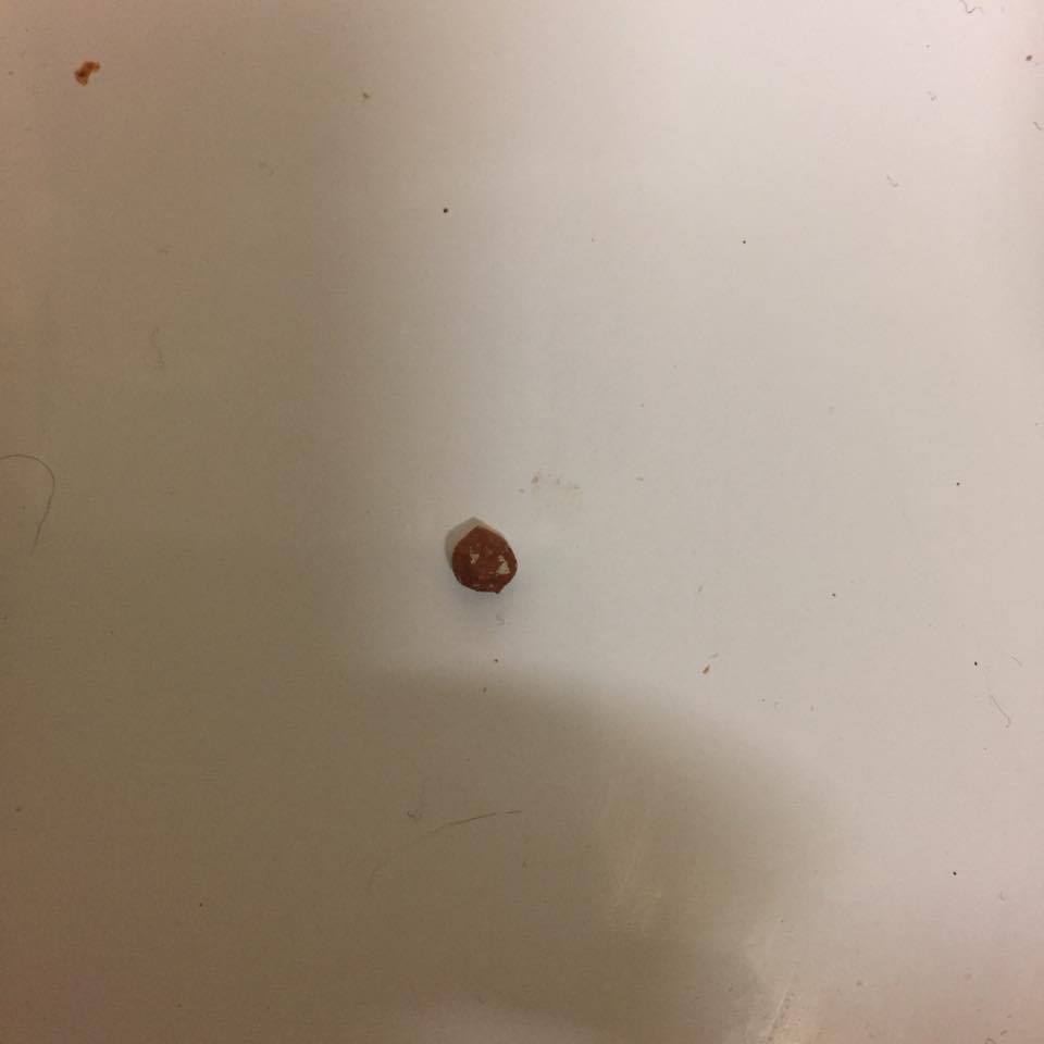

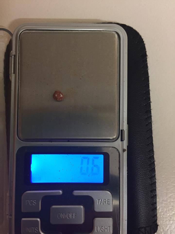

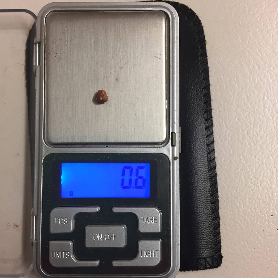

      I have attached pics of the 0.6g bit I was just walking along swinging the Vallon and had the faintest noise.....I have learnt thru experience that any response from the Vallon, no matter how faint the signal, may be a target This one gave the smallest signal. Scraped down and got it out. It made a very little signal near the coil, but a better response when passing the scoop thru the coil. I have also worked that out!...Some targets that I am trying to locate actually dont really respond very well when I wave the scoop in front of the coil, but do when I pass the scoop actually thru the coil....I dont know why !!

      If you want to experiment with the bit, PM me your postal address and I am happy to post it you

        Maybe you or someone with a Vallon could try a test with aluminum foil. Reply #159, Eric stated he could detect a 1.5in square at 8in. and couldn't detect a 1in square. Maybe some could try a 1in, 1.1in, 1.2in, 1.3in, 1.4in and a 1.5in square to see when it is first detectable and at what distance. Close or a fair distance. Might learn something.
        The signal should be a little higher passing thru the coil vs waving in front of the coil.
