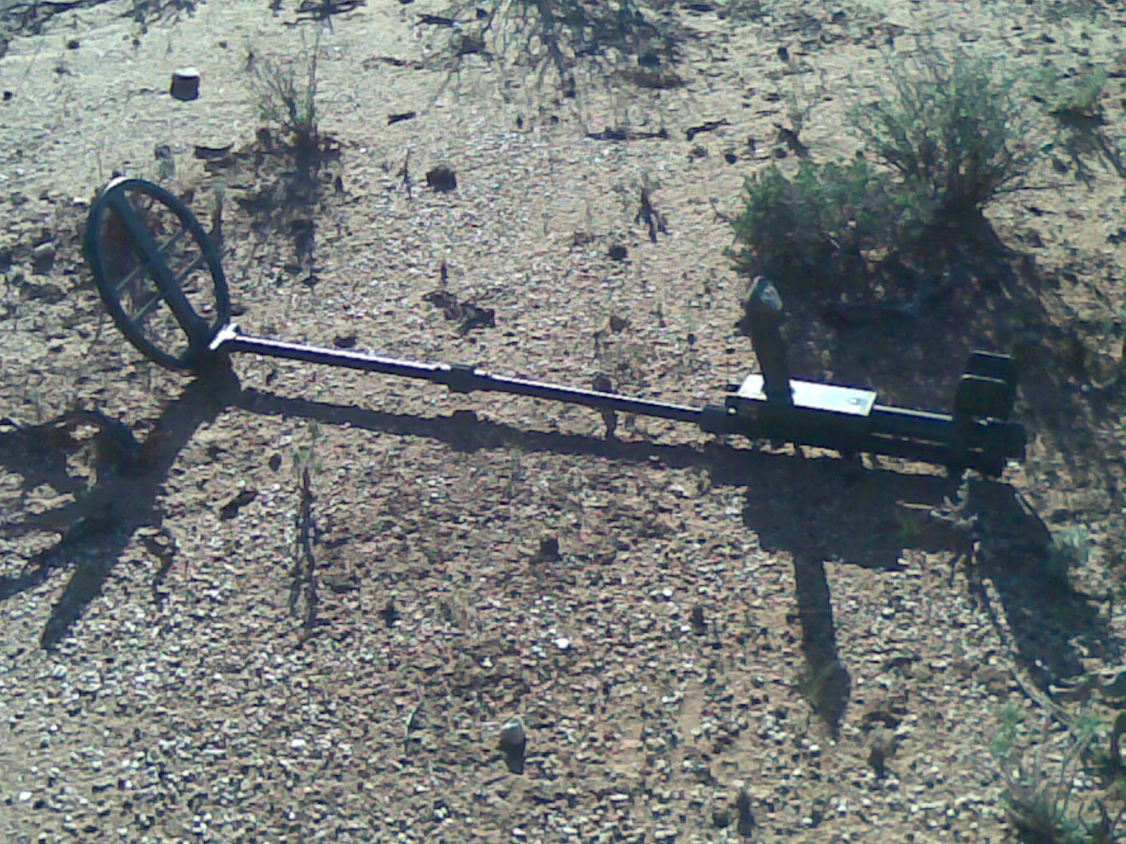

          • Out on my own as the wife was home with the sick kids !...hence, apologies in advance for the crappy video, as she has the iphone and I dont ha ha
            So Australian 5 cent piece just dropped on the ground is easily detected at about a foot with the standard coil (mineralized mode, sensitivity on 12). The 30cm coil with the same settings screeches at about 18-20 inches. Not the most accurate testing in the world though! And sorry about the thumb https://www.youtube.com/watch?v=kpIS...&feature=share
            Didnt try with a 2 dollar coil as I seriously could not find one anywhere in the house or car ha ha....Will have to withdraw some cash to buy something to get some change
            Now I did use the 30cm coil for a while this morning....took longer to GB than the standard coil and I had a lot of false alarms....grass rubbing the bottom of the coil set it off on numerous occasions. I also found that if I raised the coil, it sounded off. In regards swing speed, if I swung the coil to fast, I got false alarms...Literally was standing still and sweeping from side to side, then moving a step forward. I will have to practise more with it!....May well work better in an area after I have raked off the grass, rocks and twigs! I did drop the 1.8g nugget down in front off it and it signalled loudly....didnt bury it today as I was struggling (Frustrated!!) with the large coil!...once I have sort of "mastered" how to use it, I will try a few burials

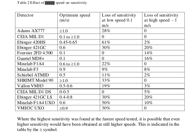

            • I did some further reading....Perhaps I was actually sweeping the coil to slowly and this was causing the false alarms!....
              Found this: Click image for larger version
Name:	Screenshot from 2017-03-19 12:52:47.png
              • Thanks for the report, reason for 5c and 2$ is the 5c has a short time constant and the $2 is a long TC, you may have to drop the sens down with big coil, interesting though.

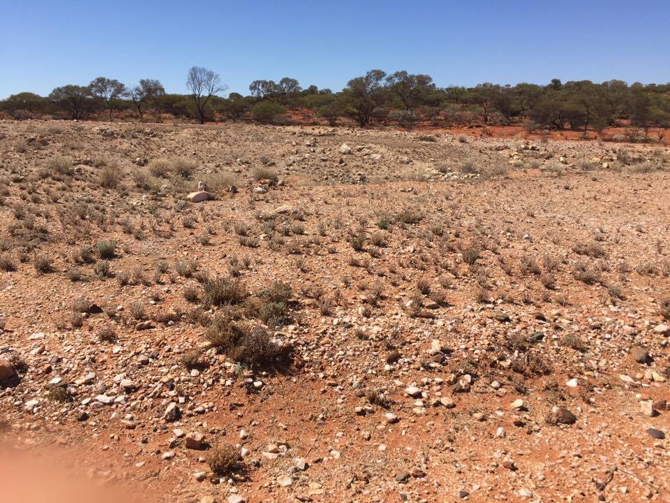

                              The grass is wild grass that grows on our gold tenement....I sure know that if the coil hits a bit of this, it false alarms....both the coils do it, but worse today with the 30cm Makes a signal noise as if you have just hit a rock or branch. Its not "regular" grass, more like this stuff: Click image for larger version
                              (The stuff in the middle, not the big bushes )
